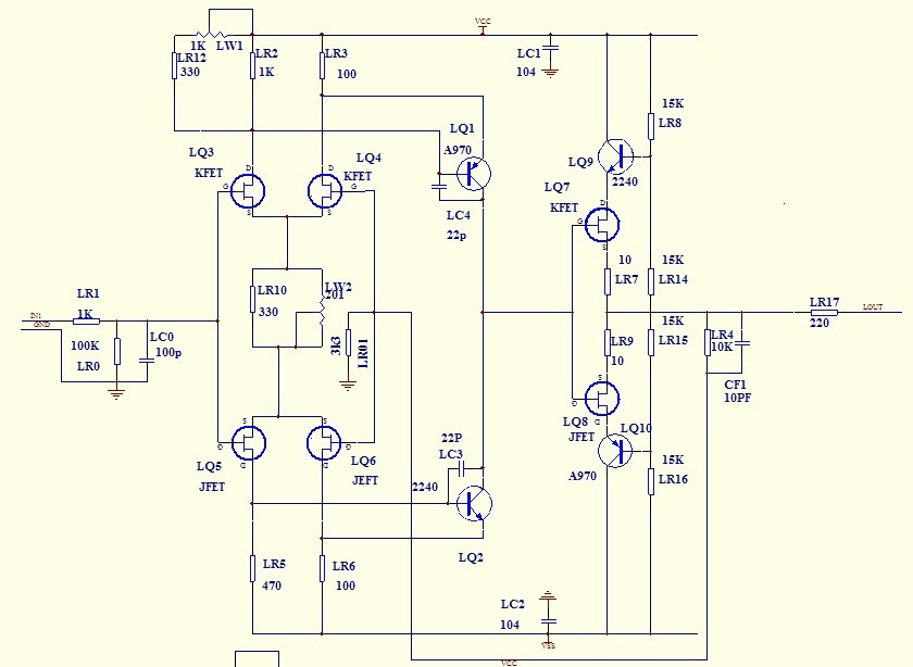

The good thing about that eBay kit is that everything is provided.
But I still want to know the schematic they use. Jim's Audio says that:
"The whole amplifier circuit is now essentially the same as JC-2, with the output stage changed from JFET to medium power NPN and PNP. We intentionally increased the quiescent current to let them work at class A. This enhances the current driving power and gives the whole preamplifier a warmer sound presentation".

Do you have the schematic?
I was interested in the kit, but Jim's Audio refused to provide one. I never buy any eBay clone without having a look at what I'm buying.

Here is a schematic from another JC-2 kit, and I would venture to say that Jim's Audio knows his stuff from email conversations. I don't think you will go wrong with his kit. For one, his command of English is perfect and he can explain his approach effectively. The transistors he uses are from Toshiba and I think are better performing than what you may normally find in the JFET/KFET positions (due to lower junction capacitance--don't ask me to explain).

Now the confusion is a bit larger...
Whaleman: did Jim's audio provide you with a schematic for the circuit you assembled? Can we see it?
That circuit you showed seems to be different from the others on this thread, because it has Fet/Bipolar output that is not on the original JC-2 line-amp or on any of the other JC2 schematics I have seen.
People from Jim's Audio refuse to provide any schematic BEFORE you buy the product, and I won't buy the product until I see the schematic. This is not a renowned product that you buy at a store, this is an eBat kit supposedly cloning a certain product. So I want to know what product is the one they are cloning and how they are cloning it. The schematic will help on that.
The circuit in #228 similar to the original circuit but with an output buffer added.

Oh, sorry. Yes, the circuit in #228 is similar, adding a cascoded buffer after it.
What I wonder is if that is what's inside Jim's Audio JC-2 clone. I can live with that if it is.
As far as I can tell, Jim's Audio JC-2 does not contain the cascode buffer at the outputs. I also asked him about posting the schematic, I think it is early morning in Hong Kong.
