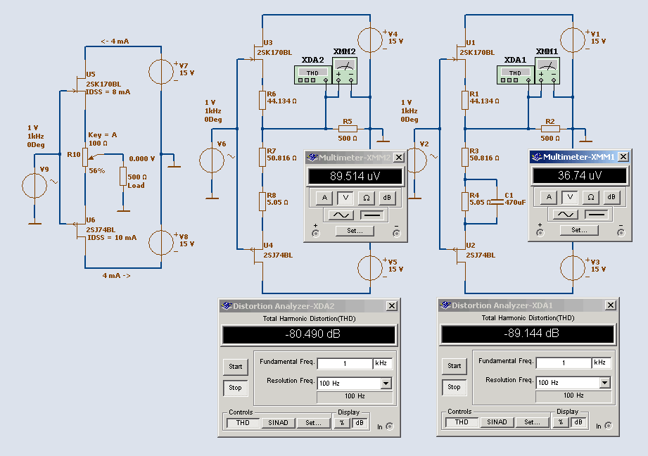

It is easier if I post some figures from my simulation works.
Here is first.
There circuits to demonstrate this fenomena.
And the one to the right, is one solution I use,
to compensate and make them N-JFET and P-JFET work in
Complementary Harmony.
I post the harmonics difference in next post.
Regars Lineup

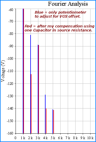

Here is my comparing FFT analys.
Before and after my Capacitor Compensation.
As I call it.
In this case was a difference of -32 dB for 2nd order harmonics!.
But quite often there are improvements at like -10 to -20dB level.
These are very high magnitudes, People!
My CapComp Trick.
This allows for ZERO DC-offset adjustment
and still cancels out even order dsitrtion.
Making the 2SK170 / 2SJ74 Complementary input/pair
work at as low distortion as possible.
