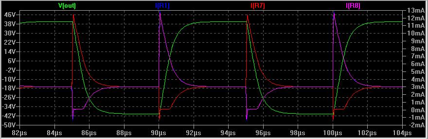

A sim of the The H-bridge currents attached below. The green trace is the VAS output, driven to 40V peak with a fast rise time 100kHz square wave input.
Purple and red traces are the currents in each half of the H-bridge.
As can be seen, the standing current is 3mA per leg (equivalent to a 6mA tail current). With such a relatively high "tail" current and 100 ohm H-bridge resistors used for emitter degeneration, linearity isn't compromised.
Under these drive conditions the "on demand" current deliverable by each LTP to charge each miller cap peaks at 13mA.

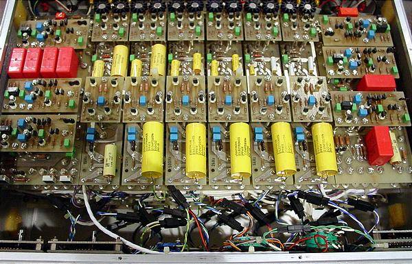

I had the chance to open up a Cello Palette with its umpteen little pcb's, with the standoffs used for power and signal transmission. I was told that it was designed by Dick.
Jan Didden
