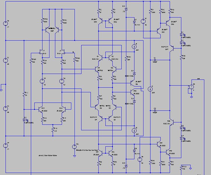

Did you (or anyone else) ever think of trying current mirrors, like in that circuit of post no1? With an "H" of resistors between the FET's you can independently control the bias and transconductance. In fact you can then tune the circuit for a whole range of GNF to almost none. It's very robust, into the 6k I can't get the distortion over -100dB for any reasonable setting.
john curl said:
Chas Hansen uses mirrors. I tend to avoid them on input stages.
Charles has been after me to try current mirrors. I have not yet done so as my current PCB artwork will not readily support such a thing. Yes, I will get to it at some point, but I've got to work out how I want to go at it, then make the boards--I've long since passed the point where I can cobble things together on a push board.

John,
Could you elaborate as to why you don't feel current mirrors are appropriate for front ends? Is it noise?

scott wurcer said:
Actually the circuit in post #1 is sort of a FET version of the "current on demand" input stage like a bipolar "H-bridge" input. The concept of slew rate gets a little fuzzy, we make 'em with inputs running at 100uA that still slew at 3000V/us. You can tilt the input and get >Idss out with almost any value for the R. BTW the Hafler style complimentary circuits (long-tailed pairs with current sources to the rails) are not current on demand and have a slew rate in the classic sense.
scott wurcer said:Did you (or anyone else) ever think of trying current mirrors, like in that circuit of post no1? With an "H" of resistors between the FET's you can independently control the bias and transconductance. In fact you can then tune the circuit for a whole range of GNF to almost none. It's very robust, into the 6k I can't get the distortion over -100dB for any reasonable setting.
Like this (front end designed for my monster class A amp)?
