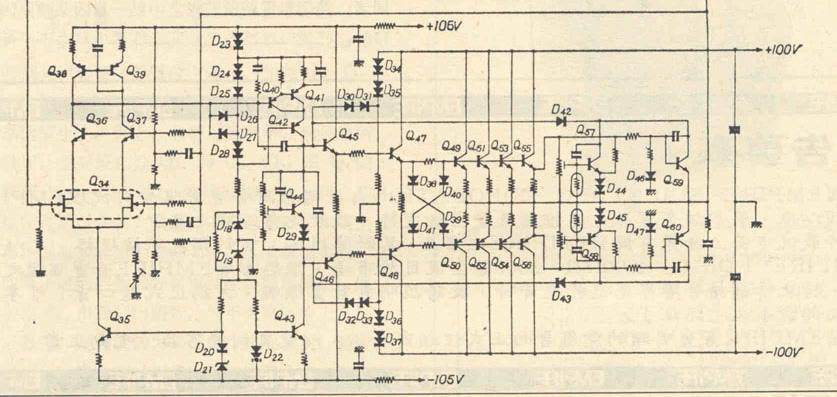

I found the dioda-resistor connection like in Cello use in this schematic : D38-39-40-41
What is the function of this Dioda-resistor?

any idea how effective the series diode thing between the driver emitters in Lumanauw's schematic is ?

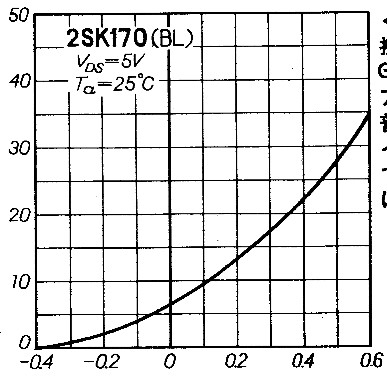

I think some people on this forum may be interested for a consequence of driving a N-ch JFET to positive bias. Here is a figure copied from Mr Toru Kuroda's book, "Introduction to Transistor Amplifier Design" 1986, ISBN 4-8443-0168, pp 187. (Unfortunately, the book is written in Japanese.) The graph displays the actual measurement of the Id for 2SK170BL.
Apparently, you can foward bias this JFET without much trouble. The problem is gate leak current (roughly 1 nA at Vgs = 0.35V at 25$B!k(BC, increases with temperature). The author recommends to use positive bias at less than 0.2V to keep gate leak current in pA range. The book also has a graph showing the actual measurement of the gate leak current. The graph proves Mr Curl's claim on JFET use is valid one, I think.

Thanks Satoru. You have been very helpful to me. I used a curve tracer to verify my results, but a real graph is much better. It is interesting that even American long gate fets can be forward biased and they will work pretty well, from a very low impedance drive. They just keep working just like transmitter tubes do.

Please clarify what I think I'm seeing in the graph.
The Idss (~=7mA) is shown when the Vgs=0 and the gate voltage can be taken up or down from the Vgs=0 bias point.
The conventional bias is negative thus turning off the FET as the gate voltage goes down.
The graph shows that when the gate is taken high it turns the FET on , to draw substantially more current.

When an AC signal comes in, the output current of JFET goes up and down, which is fed into next stage. The input range is restricted by the difference of DC bias point to Vgs(off). By setting DC bias point closer to Vgs=0, the input range can be larger, in addition to lower noise and higher gm (same thing, actually) but with higher gate excess current which may have to taken care of.

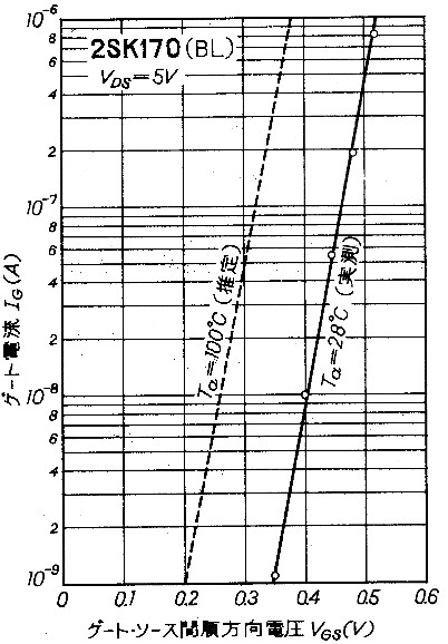

This is precisely why positive biasing the JFET gate is a bad idea. It's not necessary the gate current, but the gate current temperature dependency. The last thing you need in your amp is to care about thermal effects in the input stage.

Yeah, I recognized that we are talking two different things, too: biasing near the Vgss = zero (or near) while biasing at positive (foward) Vgss. Since the temperature issue surfaced, I'll post a graph (from the same book, same page). The solid line is at room temperature (25$B!k(BC) and the broken line is an estimate at 100$B!k(BC. Based on this estimate, the author of the book recommends occasional swing to positive side to be less than 0.2V. He also mentions that some commercial amplifiers are biased at Vgss=zero.

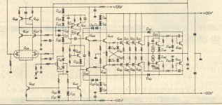

Cello Encore schematics (2 pages)
discussion on DIYAudio (starts after a couple of postings)
Would anyone tell where is the feedback network of the these Encore schematics? According to these schematics the -In is opened and has no connection to the feedback network.
