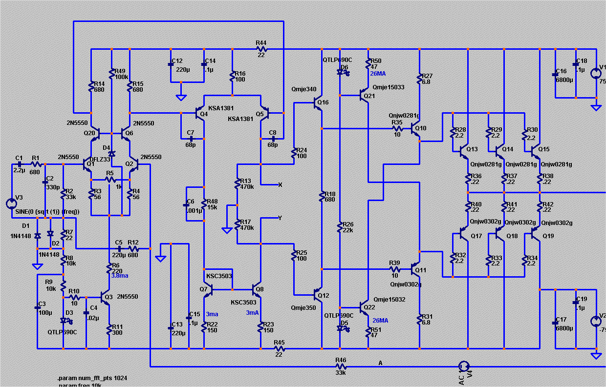

Hi OS !
I looked at that link, there are some worrying words "..and is shown, in greatly simpified form..." which means it isn't very simple ?
If I remember, you had a design with Triples which had achieved a similar 'gentle' switching result to the Krill output - where can I find this ?
Yeah , that example just shows a current mirror as a symbol (theory), leaving all the hard work for us crazy hobbyist tinkerers to design a working circuit.
Stuart's implementation is for MOSFETS ,so I can't use his exactly. The spice "guinea pig" , by the way , will be THAT triple (T3T) / symasym amp (attachment 1). The X and Y nodes will attach to a variation of E. Stuart's
(thanks !!! awesome bias page) circuit . The only worry is with the BJT's , I might have to integrate global T comp. into the circuit.
Since I already have the 2 pairs of the working amp , I might be able to go from sim to real quickly.
BTW... LTspice 4.08 (6/23/10) is out. Has more models, more verbose error log , no bugs yet.
OS

... but the posted schematic uses gnf and what I'm hoping to do is find an output topology I'm happy using without any gnf. Would your triples work without gnf - do they have that Krill soft-turnoff ?

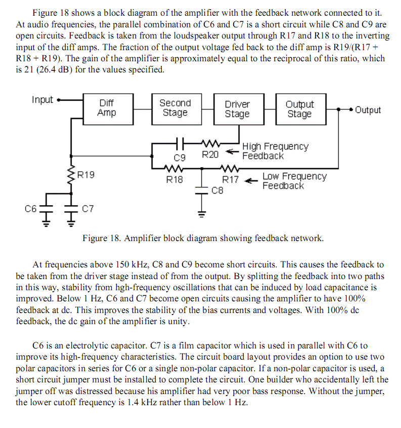

Ahh , GNF !!! The krill , if I remember right , uses GNF .. just not from the OP. instead it takes it from the VAS output. The leach triple takes FB from both the pre - driver stage AND the main OP's , the former the AC component and the latter the DC. Dual feedback paths (Attachment 1) 😀
As far as would the triple work with NO GNF ... of course it would !!
If I took the feedback off the predriver or the VAS , the OP would be out of the loop but there still would be feedback SOMEWHERE. The only drawback to this would be greater THD since the OP would no longer be corrected by GNF.
E Stuarts feedforward scheme might take the place of GNF for the OP .. I will have to complete my Simulations to see.

I too like Edmond's approach. I assume there are 3mA CCS attached to X and Y? Very elegant, hats off, Edmond.
I have used nested fb for some time. It is very helpful for stability by reducing OLG and greatly lessens the Zout of the VAS, giving greater control of the output stage.
Hugh

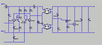

Nope... (attachment 1 ) is what goes on X and Y. First , I will merge the simulation in the attachment to a MOSFET/ IRFP240/9240 version of the above amp (supersym)to determine how this clock ticks. After that , it should be easy to port this to BJT's.
Of course , I will share the sim (file attachment) , too....
OS
No. Rather a VAS and CCS (or tow complementary VASes).
Right.

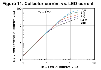

Also a 4N28 might give troubles. In the original circuit I've used MCT5211's on purpose, as these opto-couplers have a sufficient high CTR at low LED currents (<1mA).

On to comment 1 , BJT's will require some changes to the circuit. Once I see it's IRF240/9240 simulation , I will rework it. ???? do you have MTC5211 model ?? Here is the mouser page for opto's Transistor Output Optocouplers , what is CTR ?

CTR means 'Current Transfer Ratio'.
The model I've used is lost, sorry. It was a bit sloppy one. The input was just a AlGaAs IR-LED and the output was a current source, who's output was defined by means of a table, which mimicked the relationship between Id and Ic (see the graph below).
E.
