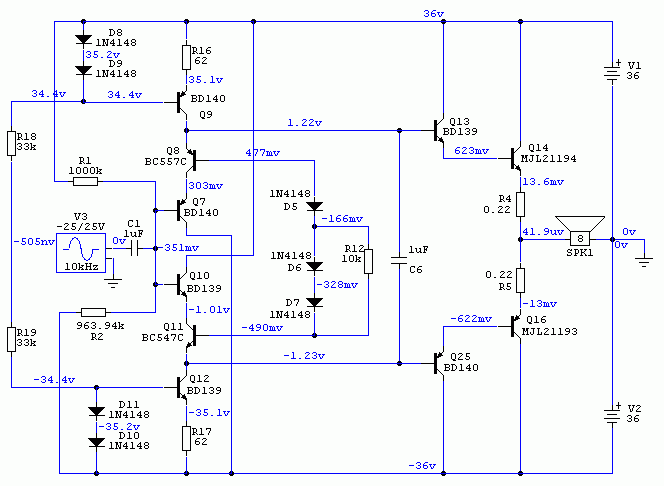

I am trying though, to sketch a simple model Lin dual-rail amplifier that will start as unbiased, traditionally named B class SS amplifier. Let's make it medium power, BJT and EF output topology. From there we can install any type of bias mechanism that permits stable operation of the amplifier.
We have discussed in general terms, quite a few schemes for controlling bias in AB and A amps but Bigun has revised his list of requirements (post 35) which seem to reduce the list to just the known methods of reducing dissipation in class A designs!
That is how I understand the progress to date. Please correct me If I'm wrong.
The Krell bias method for class A operation of the output stage is one that seems possibly suitable. I don't know the schematic well at all, much less how one should go about implementing it but I'm sure we would all like to get an amp. operating in class A with less heat, just like anyone else here.
There are, hopefully, other methods that should and probably will be be considered more carefully, even if they are not fundamentally A class. I would like to consider class "XD" as means of skirting the bias adjustment problem altogether, if that's not an oxymoron.

Anyhow, I'm trying to narrow down the field for OPS topology to look at in more depth that hold out some hope of having some evidence of low distortion due to their biassing - at least until I see more deserving candidates, to the following short list:
Steven Dunlap's KRILL - which appears to have a biassing set-up that isn't really 'variable bias' but it "lets the air out" of the transistor turning off so gently as to be benign in terms of higher order harmonics.
Nelson Pass - dynamic bias patents
Hawksford Error Correction - doesn't really look like variable biass Class A but I suspect it holds out some useful ideas
Allison-Kean - looks very promising, although Keantoken tells me it favours relatively high bias
BotchUp Diamond - I am still playing with the Diamond Buffer (also used in Pete Millet Max amplifiers) there are some ideas 'out there' on the web for 'auto bias' that I will look into
Steve Dunlap alludes to the diamond buffer structure of the Krill OPS. Perhaps he would care to comment or make suggestions. This could be well be helpful in narrowing the field a bit.

Yes, Juma posted this schematic in the Krill thread (attached)
The diamond buffer has a fancy name, but it's really just an arrangement of EFs. Broskie has recycled a few of these ideas in his blogs - his Triadtron starts off with what I and others on this forum have been called a "JLH buffer", although he doesn't use that term and then onto the Taylor topology - lots of fun with only 3 or 4 devices, reminds me of Kenpeters' and my own thoughts this past few months - but the Triadtron auto-bias falls short of what we're looking for here.
There is also the Accuphase version which allows the first pair of devices to establish bias (2nd attachment) which looks promising.

Gareth,
I'm partial to the diamond buffer, as are many.
Why don't you lash one up and try it open loop?
I recommend MJE15030/31 as drivers, btw, with high bias. Try to avoid using a bias generator between the bases of the drivers, that is, join them together.
Hugh
Hugh

DB is better than EF2 in my opinion, about the same then a properly implemented triple stage.
