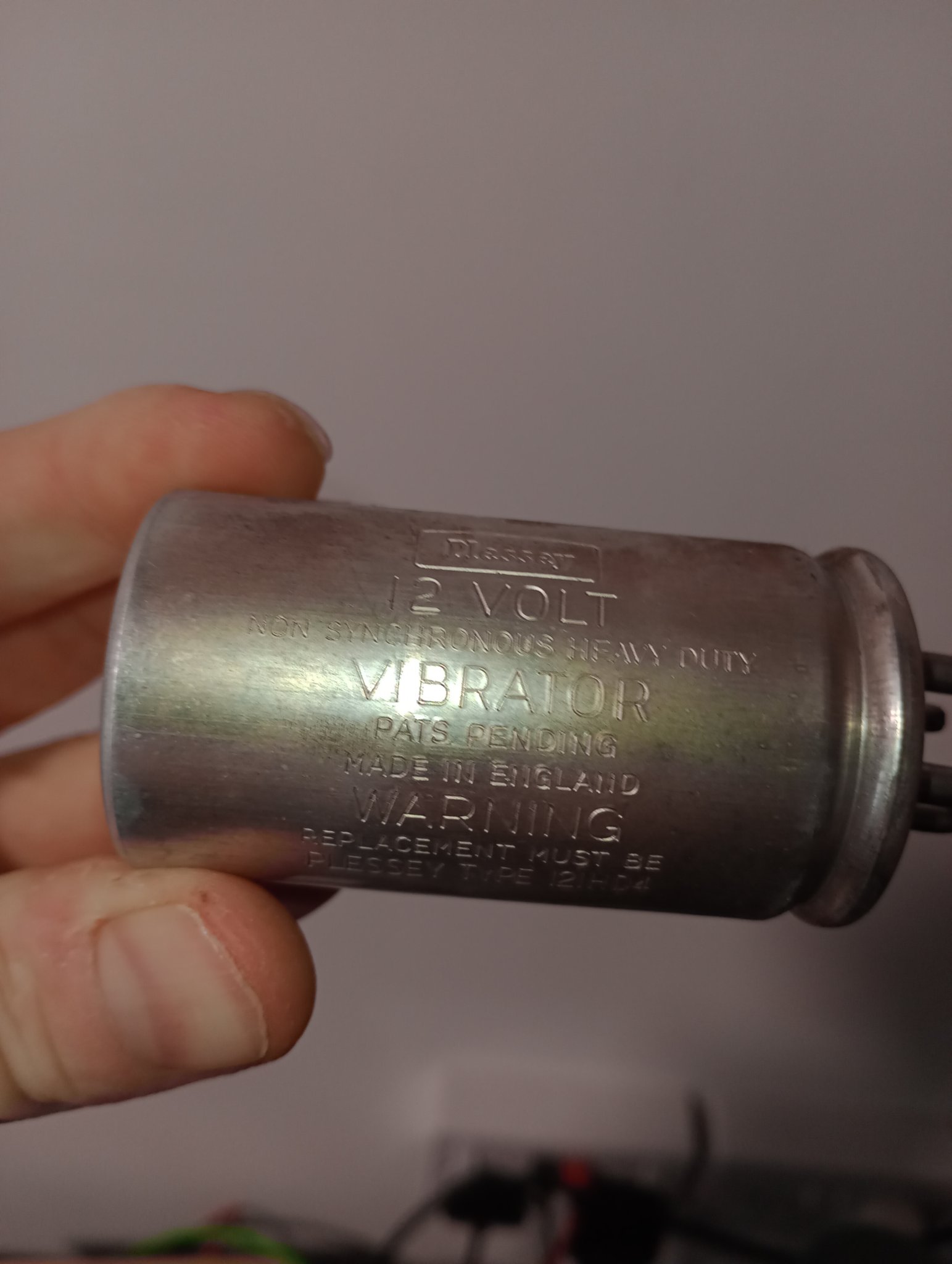

Can you identify that the 4-pin valve socket has a vibrator inserted (eg. marking on the vibrator or whatever that can is) ? Vibrators normally have more pins than 4, but I may have missed some info in amongst the photos/posts. And can you also sketch out where the 8 pins of the front panel 'Supply' socket go to, and the associated battery/standby switch ? There is a chance that 'standby' refers to powering heaters etc at 50% voltage - that is not an unexpected operation for PA gear that aims to reduce power consumption when not directly being used, but to minimise time to reach full volume, as per outside broadcast with a microphone.
It feels like the capability to work with and without a vibrator is a key element here. Compromises on both sides, possibly.
What is the RMS output of a vibrator? Is it 12V (car battery) divided by root 2? So 8 - 9 volts?
A vibrator always put out a square wave voltage. Hence, it is 12 V effectively.
Btw, vibrators don't need more than four pins: Supply voltage, ground, and two outputs.

Do we have any solid reason to believe that the vibrator was originally intended to run on 12 VDC? These were mostly in the 6 VDC era, the machine has been molested in the past, drawn schematics are shaky, etc. Do the heater dropping resistors look original? A close picture of them and their solder joints might help answer the question.
All good fortune,
Chris
All good fortune,
Chris
Has 4 pins.

Cool. The vibrator could have been incorrectly exchanged in the past, but the dropping resistors certainly look original. That removes one rabbit hole.
