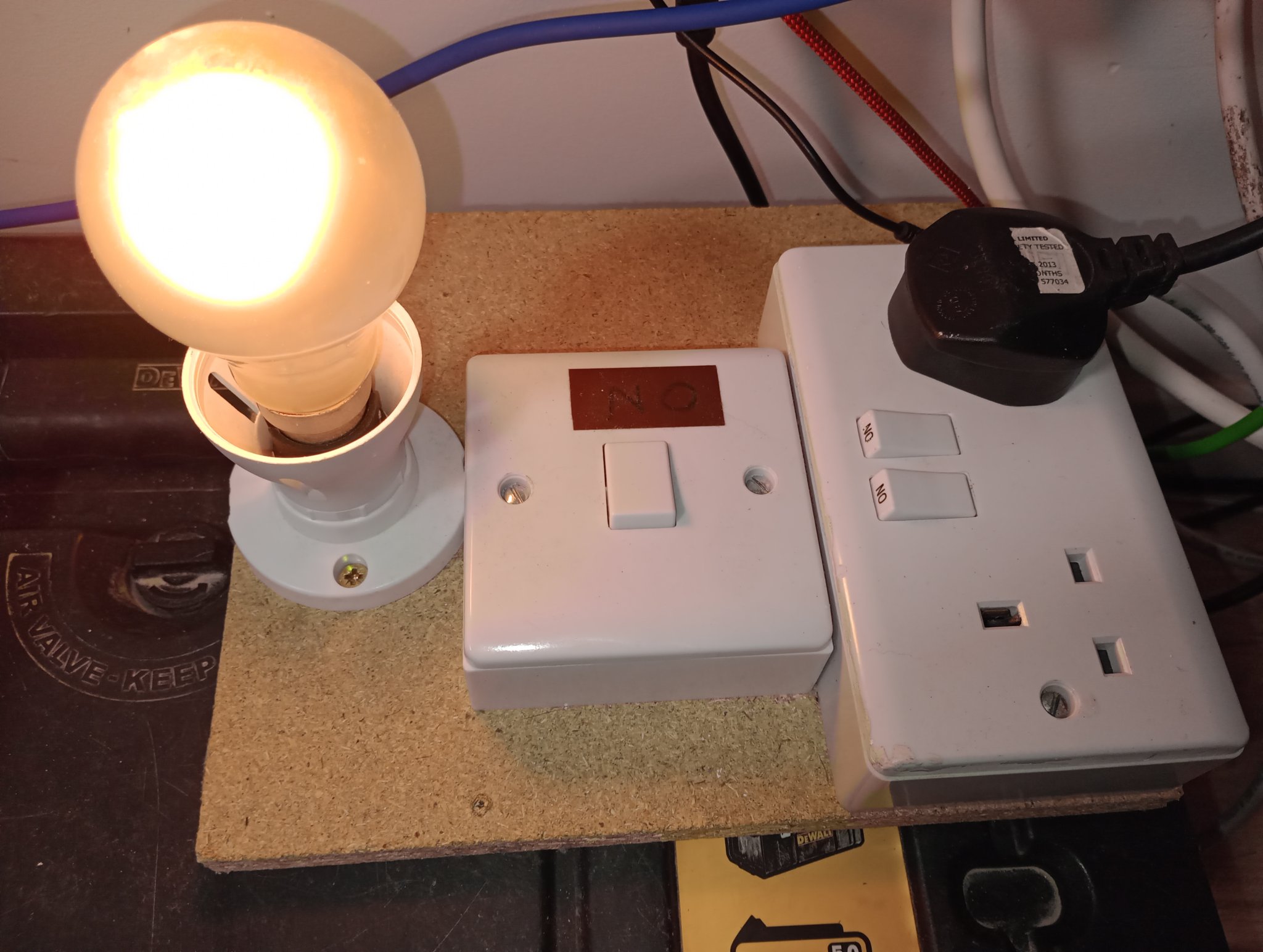

I decided to try a separate transformer I had to temporarily supply the heater circuit, it's heavy duty toroidal good for 6.5a. 2 separate 12v outputs. With the heater connections to the MT disconnected, I connected one end of 2 of the 12v windings one to ground and one side to pin 2 of the EL34. Almost straight away the heaters of the EL34 and EZ81's valves are glowing. Not the pre amp stage valves though.I
At this point I'm now seeing the bulb lighting up on my dim bulb tester. Doesn't happen when the 12v transformer is switched off, only when the heaters have power. It's a 100w bulb and I wouldn't say it's on fully, but it's lighting up.
Still no sound whatsoever from the speaker I have wired up.

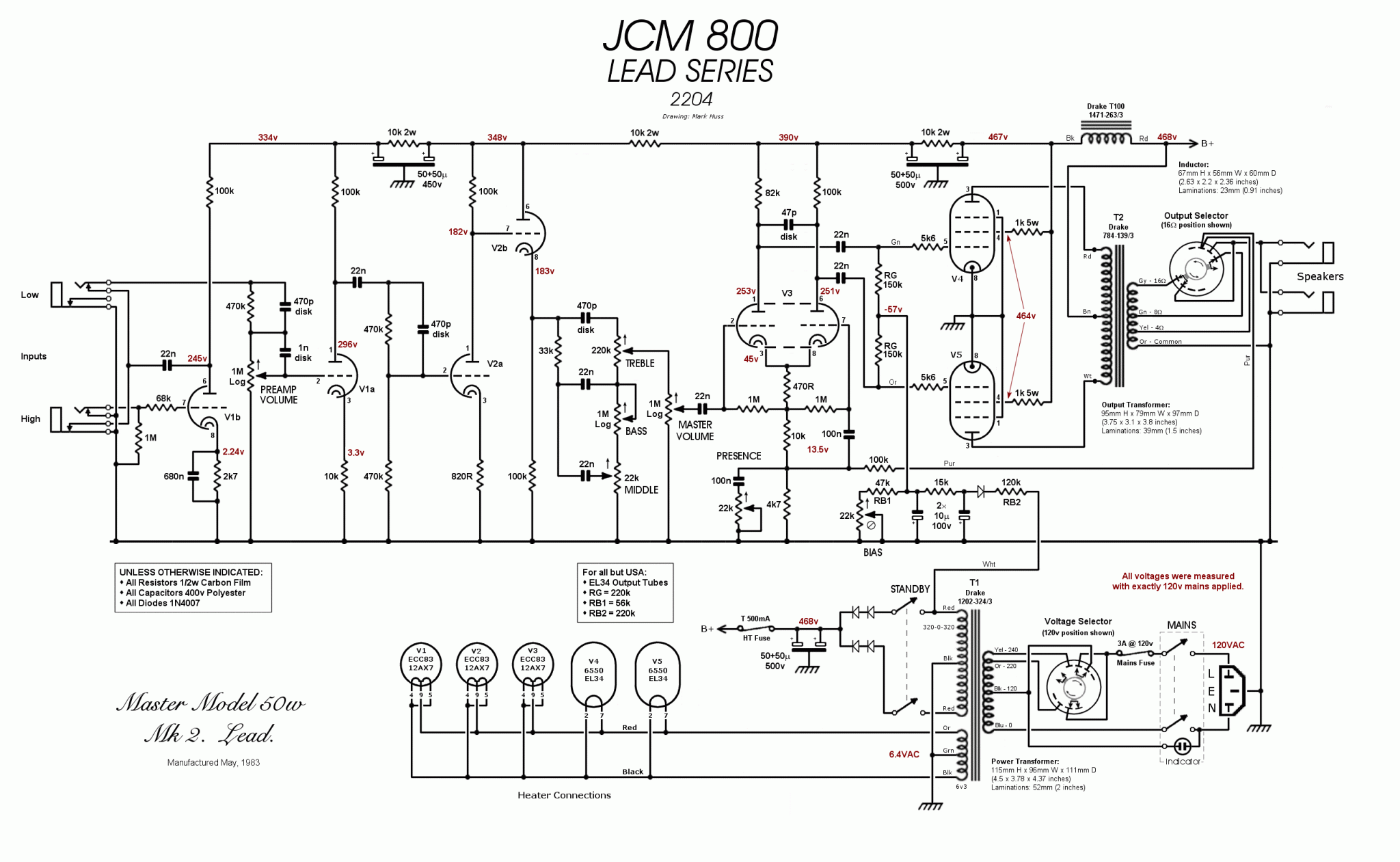

I looked at this one
It's really useful as it lists the expected voltages.

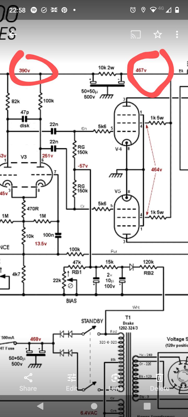

So I had a look at the voltages I have. I disconnected the pre amp stage nodes from the HT supply as measured what I had
Even before the resistors I'm only seeing 356v.
On the JCM800 schematic, the voltage at a similar point, before any dropping resistors or valve load seems to be 465v.
The EL34's circuits where still under load when I measured this but the nodes supplying all the pre amp valves where disconnected from HT supply. So I'm only getting 365v before it's seen any load from the pre amp stage.
Is the Marshall mains transformer just higher output than mine, or is there something else at play which I'm not seeing?
My MT disconnected under no load puts out >700v AC

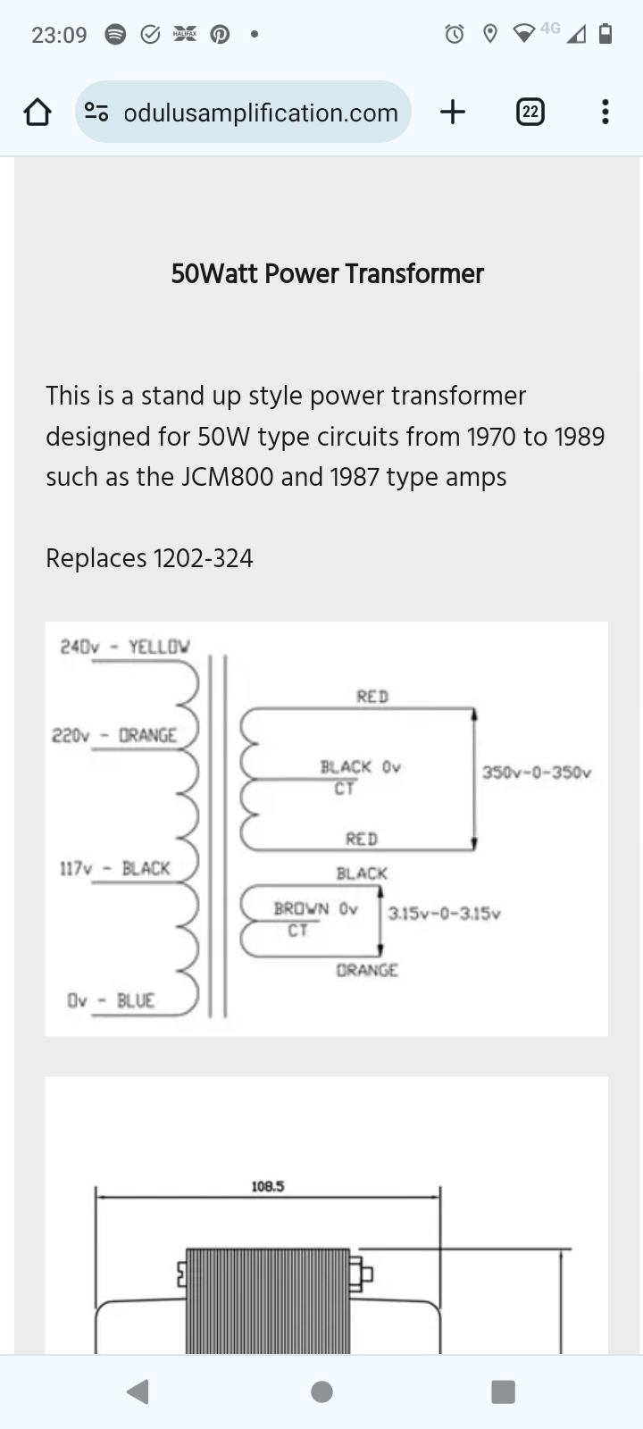

I looked at the specs for a MT designed for a JCM800 50w
Looks like the output should be pretty similar to mine? I have no idea of the power rating of my transformer though..
I see diode rectification on the marshall circuit. Am I seeing the effects of drop caused by the tube rectifiers?

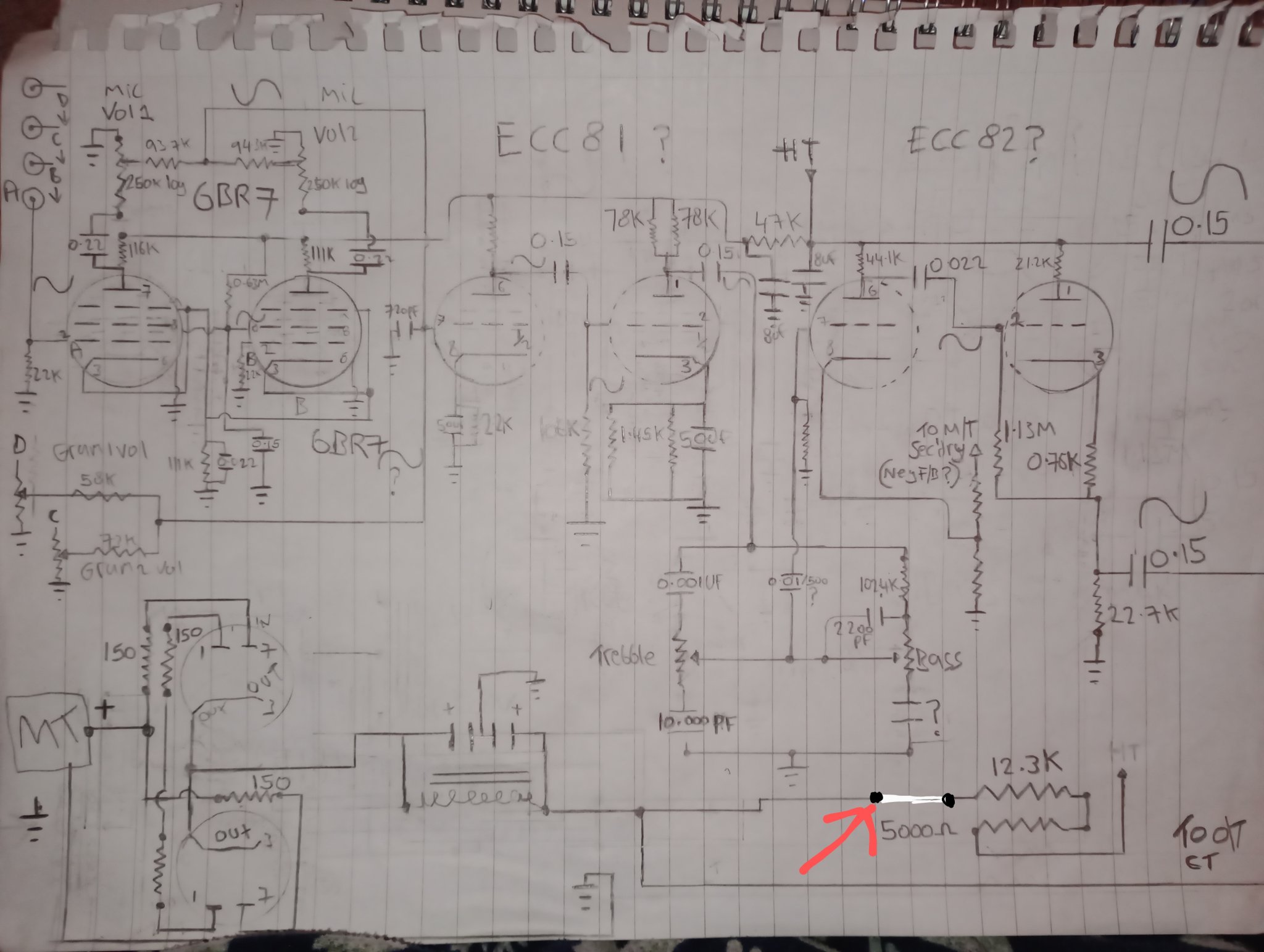

You are at a crossroads, the same one I have been on a few years ago. I tried like you to reverse engineer a PA amplifier, and by not being careful enough with my approach and pictures, I got to the point where I could no longer describe the original circuit. At that point I had to start looking at solutions for the same tubes an operating points to reuse as much as possible.
My suggestion of getting to know LTSpice earlier might have helped you capture the old circuit by being able to emulate it is that still possible?
If not then what you are doing is about the only option, i.e. start from scratch with a similar count of similar tubes.
That dual power supply and vibrator made it complicated.
