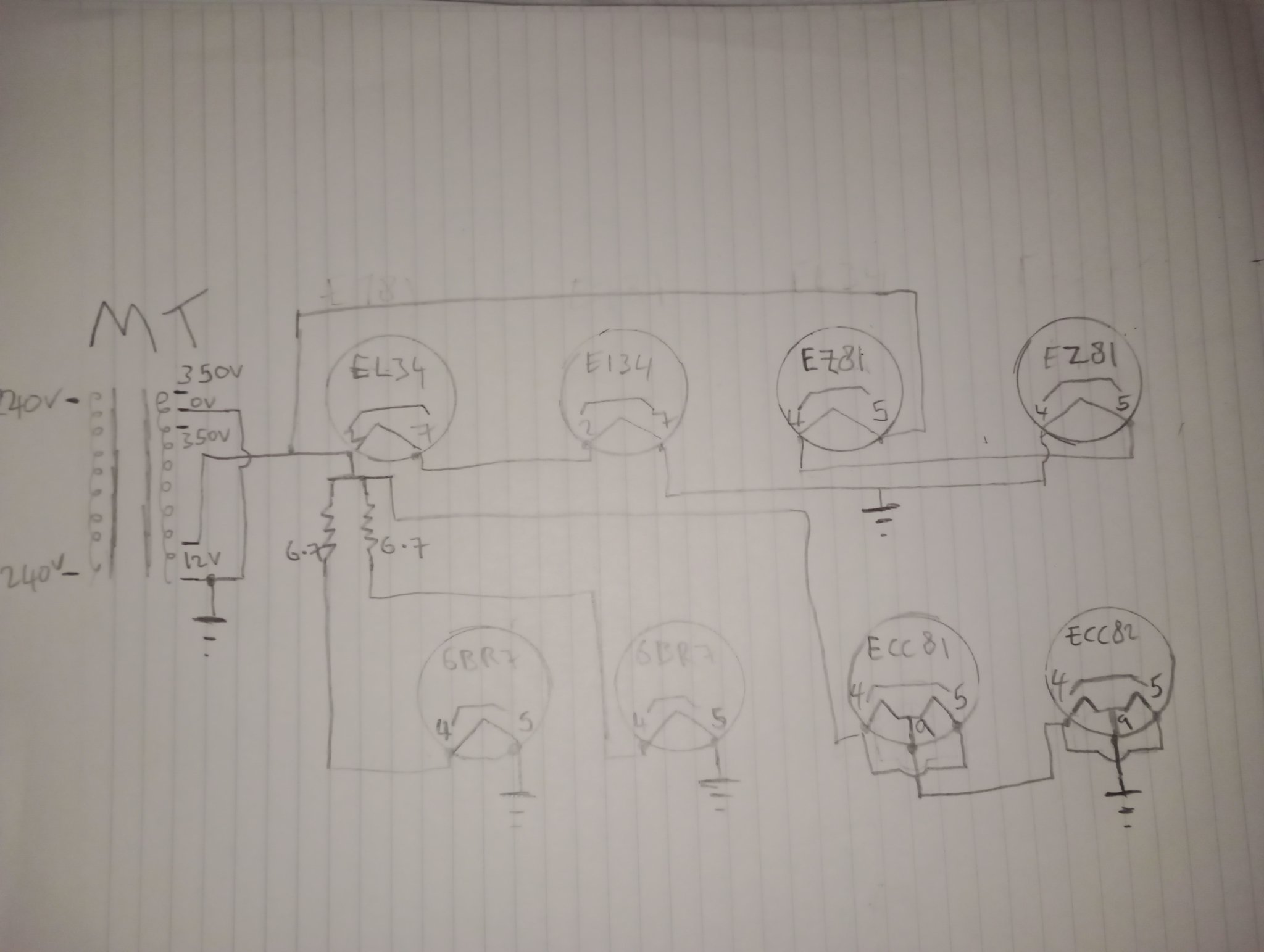

Done a quick sketch of how I think the heater wiring works.
I was going to draw out the connections to the socket pins but seems a bit pointless, might add them in later, I've drawn that part out separately already and took loads of pics. It's not going to be kept anyway.
What I'm not quite understanding is this; the drawing shows each pair of valves wired in series. That require 12v from the MT secondary to give 6v for each valve? The CT is grounded.

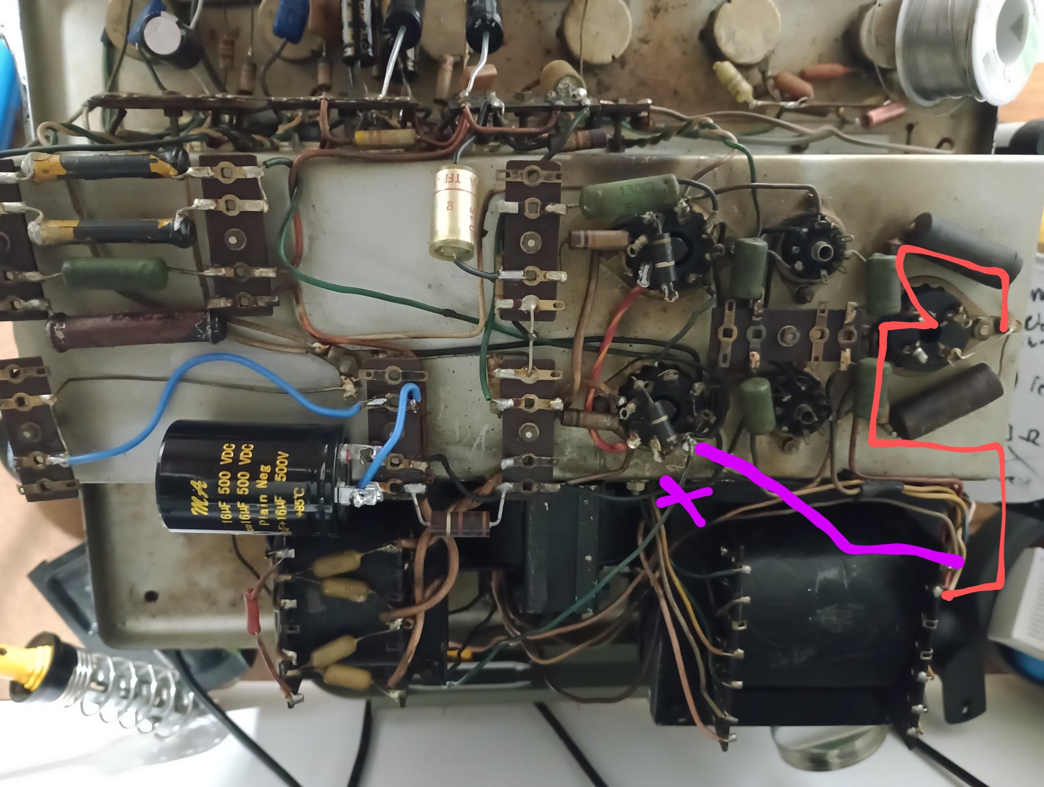

Did a bit more today. Fitted an IEC socket in the original power socket location after removing the old one and the redundant 12v wiring. Not sure if I'll keep it here but at least I've got something solid to power it up and it's properly earthed connected to the chassis
It's now been on full mains voltage with valves in. Hooked up a speaker to the 8ohm winding so the OT has a load.
Noticed none of the tubes are glowing. Except the EL34's, which I can see a tiny bit of glow from.
So some further investigation is needed....

The 6BR7's are wired parallel, there's a feed from the positive heater pin of the first EL34 which then forks off between 2 resistors. I assume these are to reduce the 12v down to 2 lots of 6v as they're not wired in series pairs like the other valves. Used a voltage drop calculator and it came out at 38ohms resistance to drop 12v to 6.3v with a 0.15a load. There's no markings on them unfortunately as it's peeled off!

My previous heater circuit sketch was wrong and didn't show the preamp stage valves so I've done another one.

You are definitely measuring AC on the heaters, and not DC? You mentioned 'positive heater pin' above?
It is not optimal leaving the EL34s with series heaters. They were not designed for that and it could cause one to hog more current than the other, maybe related to the issue you have?
It is not so clear in the schematic, but there are 5 parallel lines of series heaters; EL34s on one, EZ81s on the other, ECC81s on another and 6BR7's on the other two, with dropping resistors.

The whole heater circuit is AC, the only rectified voltage is HT. Ignore 'positive pin', I just meant this is where the 6BR7 pair appears to be supplied from.

Just to be clear on what I've done so far with the heater wiring, the red drawn line shows one pin goes to ground via a vibrator pin and some resistors, this is untouched and was originally like that. The purple cross shows a blue wire which went to a power input socket pin. I've removed this and made a connection from the neighbouring pin at the MT to the heater pin EL34, which in turn feeds the other heater lines.
This shows the wiring to and from the vibrator socket a bit more clearly

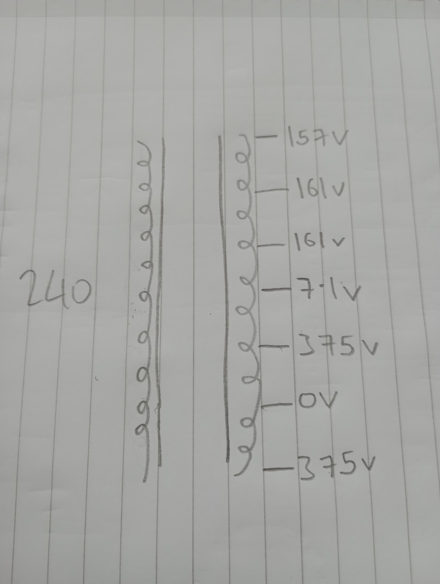

I measured the voltages on the secondary side off load, these are all relative to the 0v CT pin.
I guess those 161 V terminals are symmetric wrt CT. Where are they connected to? What's the voltages from 157V to both 161V terminals? Finally, where are the heaters connected to? Is there another winding?

From 157 (I'll call this pin 7) to pin 6, 5.3v. pin 7 to 6 is 5.6v.
7 was grounded via a 60 ohm resistor (measured) and a 0.5uf capacitor in series.
6 went to the original 10 pin socket, there was a wire going from the socket to the heater pin of the first EL34 where it branched off to the rectifiers heater pins and the input stage valves
The measured transformer secondary voltage are ambiguous as shown. It may all become clearer if we can sort out the transformer secondary winding configurations 🙂
Can you confirm all those secondary taps are galvanically connected by DC resistance measurements ? If so, then can you determine if the 0V tap has a similar dc resistance to each of the 375V taps, and similarly to each of the 161V taps? Additional energised measurements would then be needed to confirm if the 375V taps had 750Vac from tap to tap (ie. a 375-0-375V centre tapped winding configuration for full bridge rectification), and similarly if the 161V taps had 322Vac from tap to tap. Measurement of the 157V tap to other taps may indicate if it is part of a winding with other taps (eg. 375-0-157-375) or perhaps just a separate winding with only one end connected to anything else (eg. the 0V tap). Similarly for the 7V tap.
