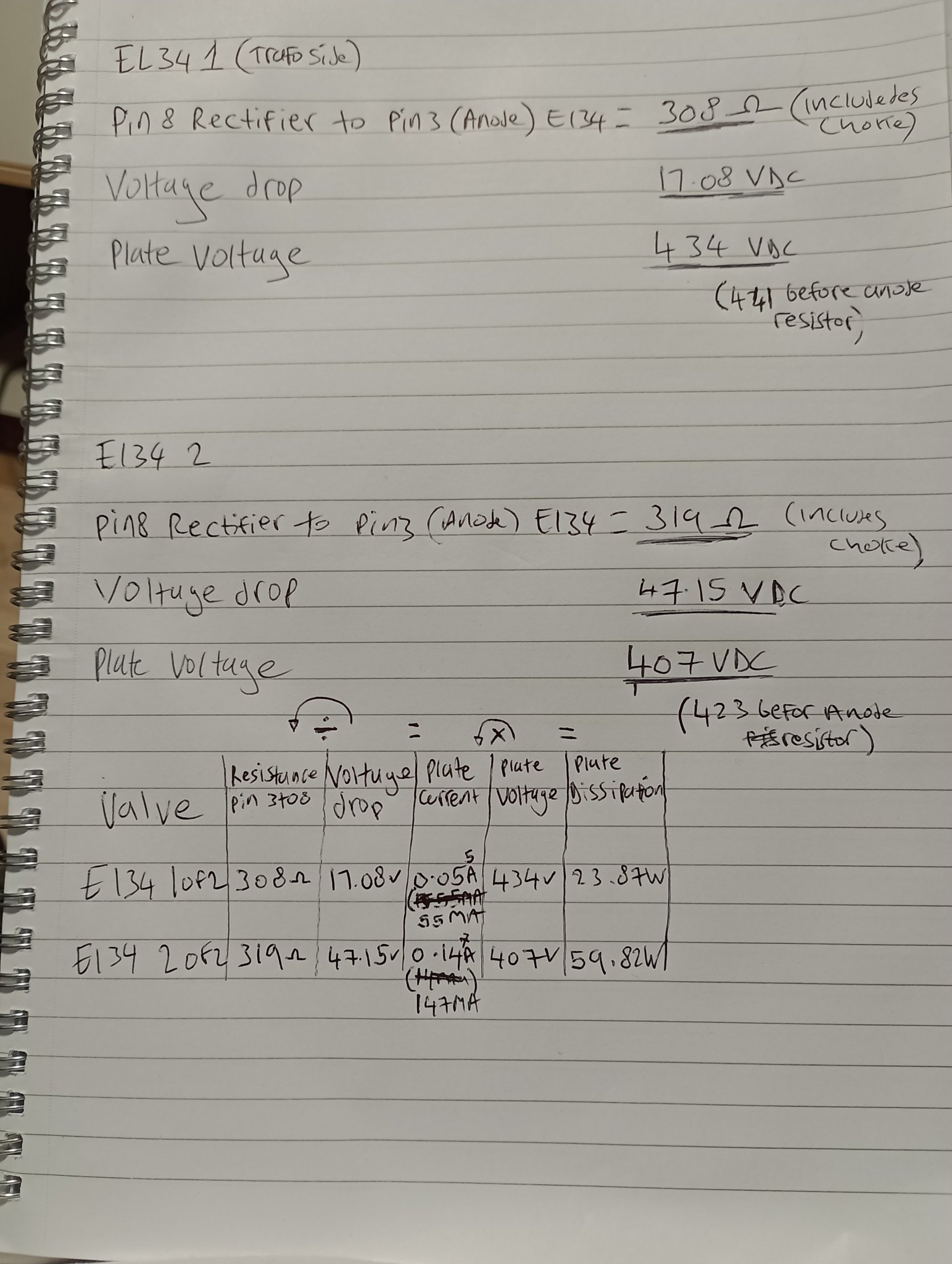

Staying with the 220-230 primary then, I did the bias measurement for the EL34's.
The 2 EL34's are way apart. The plate current for one works out at 147ma! There's a 30ish voltage difference between the plate voltage of each, the one with the higher voltage has 9ohms less resistance to the OT CT when measured.
I'm guessing the anode resistor of the valve with the higher anode voltage could be adjusted to bring the plate voltages closer together?
The voltage drop measurements are miles apart, tube 2 17.08v Vs tube 2 47.15v.
Tube 1 = 23.87w plate dissipation
Tube 2 = 59.82w plate dissipation
The Cathodes have a shared 130ohm resistor (tests ok for resistance) the anodes each have their own a 100ohm resistor between themselves and the O/T HT supply.

Repeated the biasing measurements again with the valves in these positions. One thing I've noticed is that the voltage of the anode, and the reading for the voltage drop jumps around quite a lot. Say the plate voltage reading for EL34 2/2 as seen bellow at 392, I seen this as low as 382. It fluctuated quite a lot up and down on all the voltage measurements for both valves, even after 'warming up'. Would this point towards rectifier valves playing up? Or is this sort of fluctuation expected?
Anyway, here's the bias measurement procedure repeated:
Way over maximum plate dissipation of 25w, assuming I've measured and calculated it properly?

You need to subtract the cathode resistor voltage to calculate the real plate voltages, and you'd also subtract the screen current from the total cathode current.
Anyway, it's better to provide individual cathode resistors for each tube. Double the value of the common resistor. And if you intend to go for Marshall or Hiwatt, provide fixed bias to achieve »the« sound.

It is often not practical to measure the anode voltage, for the purposes of calculating idle power dissipation, due sometimes to noise, and the risk of high voltages if the valve itself is noisy and causing the anode voltage to fly around. Imho, it is better to measure the output transformer DC resistance from B+ (primary CT) to each anode tap, and then calculate the nominal voltage drop across each anode winding at the measured cathode current (from the cathode sense resistor). Then subtract the cathode and anode related voltage drops for the B+ voltage to give a nominal operating anode-cathode voltage for calculating power dissipation.
The advantage of using a variac is that EL34 power dissipation can be assessed before it damages the EL34. If in fact your EL34's were dissipating upwards of 45W, and for more than a few seconds, then you may well have caused them some damage, although it is likely they were degraded already, and any path you want to take with the amp needs to cover either the purchase of replacement EL34, or a changeover to other valve types (for whatever reason, such as you have some others, or they are cheaper etc). Damage occurs within an EL34 due to the plate structure temperature rising above nominal (the red-plating affect), which then causes the metal to 'out-gas' molecules that affect the vacuum and cause various forms of damage that may or may not be recoverable with time.
There could also still be other faults in parts that are causing gross over-bias of the EL34, which is an advantage of going through what I would call an early testing phase of all parts and operation (compared to gutting the amp for starters) so that you better appreciate what gremlins exist.
If the EL34 were each dissipating 45W, then that would also grossly suppress your B+ voltage, and so misguide your comparisons.

Thanks, Trobbins. Would it not make sense, seen as these have already been subjected to an unsafe plate dissipation to get them within range? Any damage is already done so I'm not worried about them now. Is there any chance they may be ok by the way?
What I mean is, if it's likely they're toast, no harm keeping them in while I fault find? Would be nice if there's a possibility they might be usable in the long run but I'm willing to replace obviously 👍
I'm just giving you a heads-up about their possible condition. If you have a variac, then bring them up such that their their cathode current is not excessive, as that also avoids stressing the power transformer and output transformer from excessive current levels.
Faults that could cause excessive output stage current include leakage through the coupling caps, or bad grid leaks, First check the value of the grid-leaks (value is not shown in post #42 schematic). Checking for leakage through the 0.15uF coupling caps is best done with a variac, and removing the EL34's and measuring the dc voltage across the grid leaks as B+ is increased - but be mindful not to let any power rail voltage rise to a level to stress any filter cap voltage rating. The dc voltage across the grid leaks will rise as the B+ rises (as the coupling caps are charging through the grid leaks), but after a minute perhaps should be well below 100mV. A leaky coupling cap will bias an EL34 on and cause excessive idle current.

I just followed a guide which give a method of calculating dissipation by measuring the impedance between the EL34 anode and pin 8 on the rectifiers. This does incorporate the choke, yes.Is it difficult to measure the voltage drop across the 100R resistor on each EL34 anode? You can set up the measurement, switch on the amp and switch off again to be safety conscious. This isn't the whole picture because the screen also has a contribution to dissipation, but it will get you in the ball park.
I can measure the drop across the anode resistor, I may do as you've suggested with the Variac? If I set it to 120v perhaps?
It has to be full B+ otherwise you are not measuring at the operating point.
Be prepared to turn off if the voltage drop is much more than expected. If the anode current should be 60mA, then the voltage drop across 100R is (from I = V / R), 100 x 0.06 = 6v.
