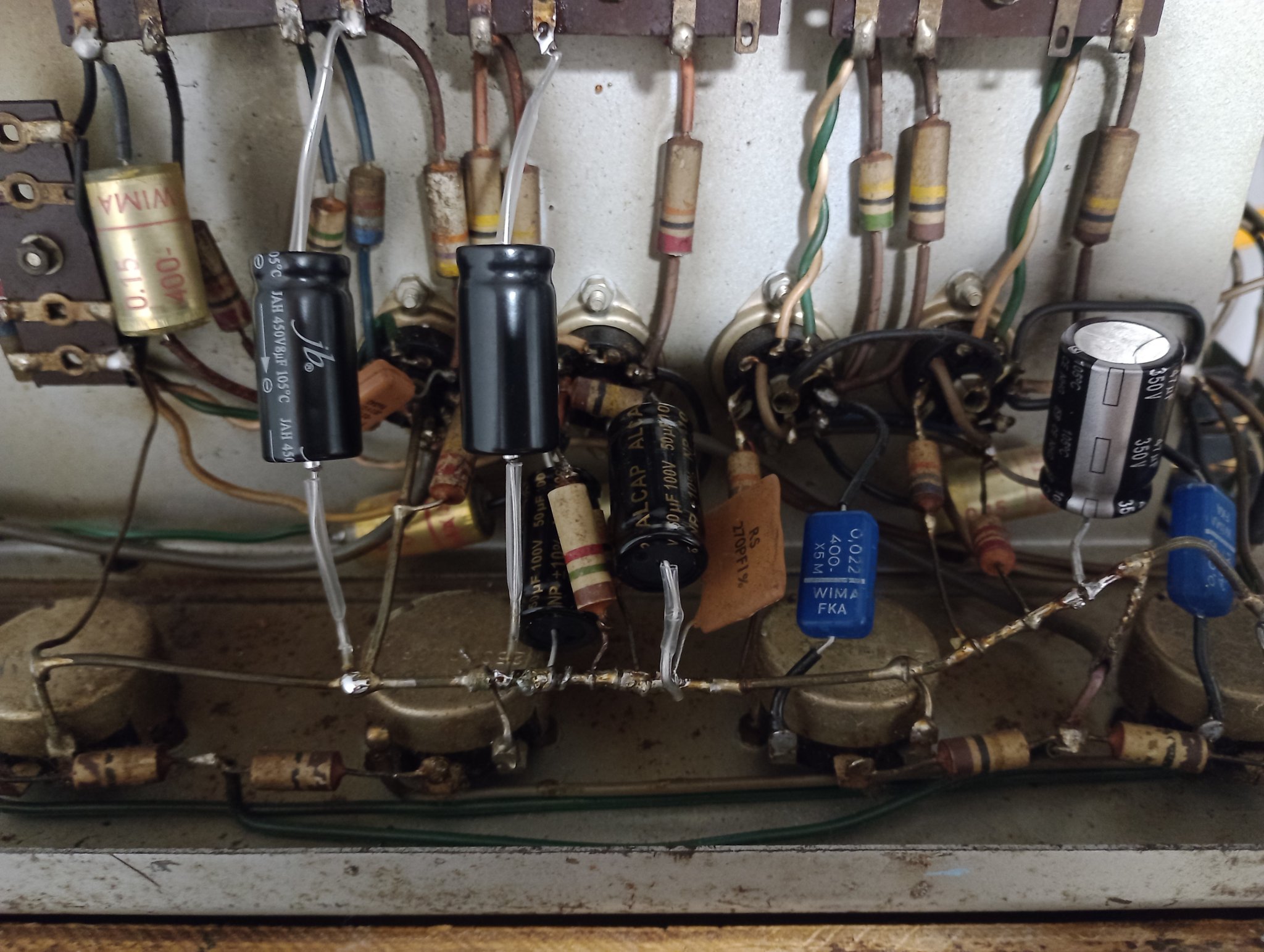

Exactly my thoughts also. First of all, and as yet mentioned by trobbins in #43, I'd replace both the EL 34 plate resistors and the common screen grid resistor before ever powering the unit again. Hopefully the EL 34's aren't damaged already by the missing anode load, and the burnt screen resistor is just a follow-up.Lots of old equipment has a hard wired plug lead, though, so I don't think it has to be top of the list of enhancements.

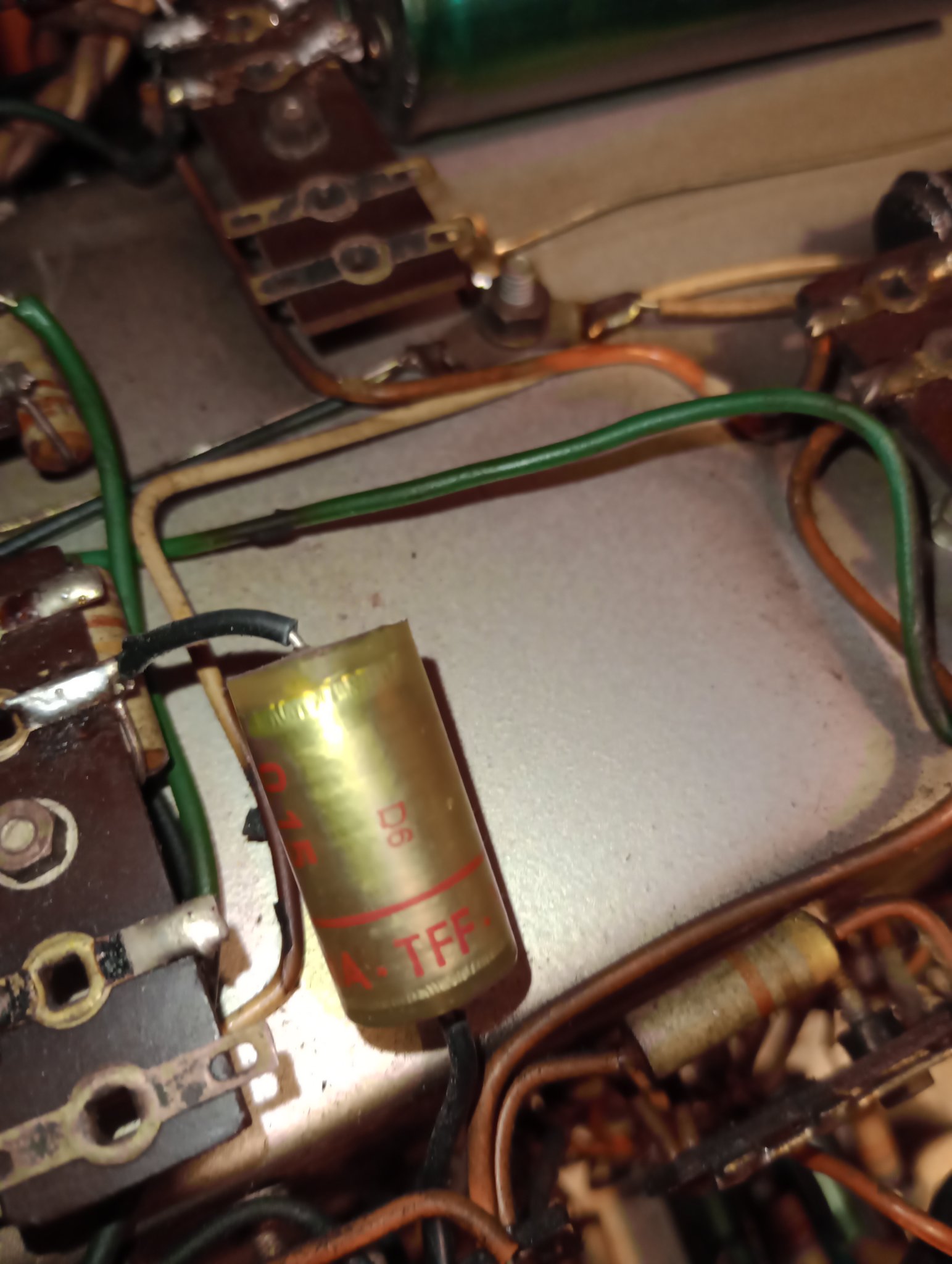

Then take a closer look at that yellow WIMA capacitor from #49. Gently turn it's body, or better lift one leg, and read what's written after that WIMA acronym: If it is Durolit, replace this capacitor. Durolits are paper capacitors that by experience get soaked with moisture over the decades. If there's written anything else, the capacitor is not that suspicious - as is the blue prismatic WIMA.

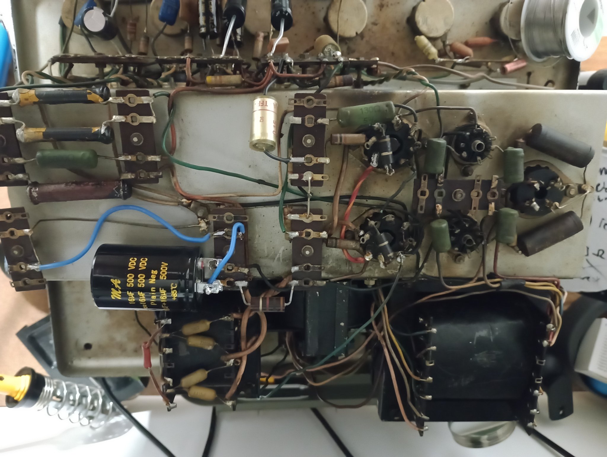

Waiting for my replacement capacitors to arrive. These include a pair of 16uf 500v electrolytic's for the power supply to replace the big old original combined one that's in there now.

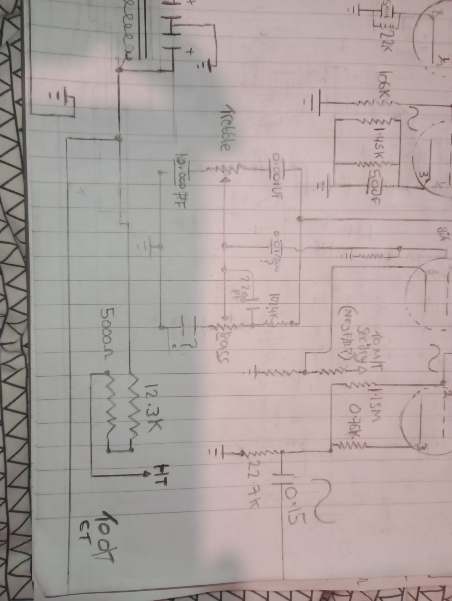

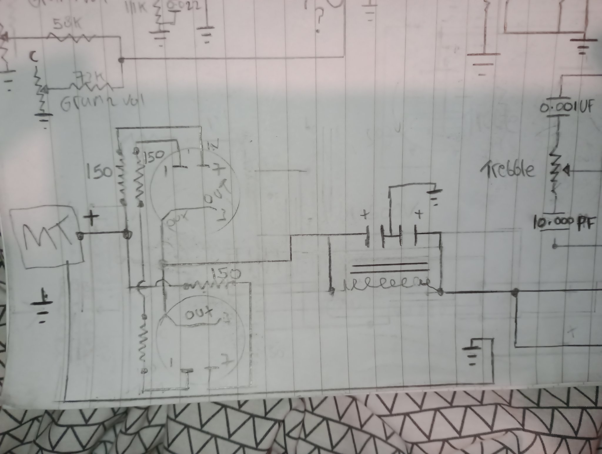

So I've drawn out the power supply again, hoping it's right this time... Done it with 2 separate caps this time as it makes more sense to me that way. Hoping it's right this time!. Would be real grateful if someone could clarify whether it looks correct.
I've missed a connection which connects one of the caps to the power valves screens via a resistor.

Just says 'TFF' as far as I see ..
I don't know what exactly TFF means, perhaps Therephtalate Film Foil, but I guess this isn't a suspicious capacitor.

It’s a polyester derivative. Falls in the same class. Will almost never give any trouble. More dissipation factor than MKP, but whose counting here?

One quick method to get the resistor values back to 'normal', is to parallel another resistor so that the final value is sort of what you want, The advantage is you don't have to unsolder the old resistor and even if it has drifted high over 4-5 decades, it is not going to change markedly over the next few years. The disadvantage is you need to have a calculator or webpage for parallel resistor calculation, and access to resistors. If aesthetics or morals nag you then you can replace with a single new resistor once all operation is settled. Or you can solder a new resistor across the old resistor and snip out the old resistor - to avoid having to unsolder tags with multiple wires wrapped around the tag. For old vintage aesthetics a small modern resistor can even be 'hidden' underneath an old dogbone style resistor and you wouldn't know it was there.
The schematic change for the two filter caps in the same can is correct.

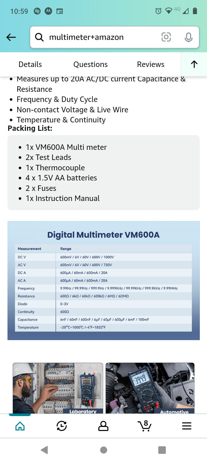

Do you have a meter that suits valve circuits? Eg. a meter with high input resistance so that it doesn't load down a circuit, and one that can measure Vac when there is Vdc, and vice versa, and an extra benefit is one that can measure low ac and dc voltages. It's worth checking out a meter's detailed specs, as even some Flukes can be a bit limiting.

To your power stage schematics: I guess the upper 0.15 µF capacitor is connected to the other side of the 22k plate resistor, i. e. to the tube's pin 1 instead of the plate supply voltage. Only this connection would make sense, as the last triode works as a Concertina phase splitter.

Not too bothered about aesthetics for this.If aesthetics or morals nag you then you can replace with a single new resistor once all operation is settled. Or you can solder a new resistor across the old resistor and snip out the old resistor - to avoid having to unsolder tags with multiple wires wrapped around the tag. For old vintage aesthetics a small modern resistor can even be 'hidden' underneath an old dogbone style resistor and you wouldn't know it was there.

I'm not sure, it's just an Amazon one. It's got a lot of features, I had a Screwfix (think Bunnings...) own brand one before this which was dreadful. I'm not entirely sure of the input resistance.Do you have a meter that suits valve circuits? Eg. a meter with high input resistance
Might be time for an upgrade?

Meter should suit - but only accurate from 10Hz to 1kHz, so keep that in mind for some tests and use other methods to confirm the amp isn't accidentally oscillating.
My caps arrived. Annoyingly I'm a 50uf Axial electrolytic short 😞. I had 47uf or 100uf caps to hand, I fitted a 47uf polerised electrolytic where a 50uf is supposed to be wired in parallel with the 6BR7 cathode/G3 bias resistor. Not sure what effect , if any, this will likely have. The 6BR7's are the mic stages. I thought for initial testing I'd probably use the Gram inputs anyway. I can always order another 50uf. I'll likely be making a few changes to the input stages as others have suggested if all goes to plan.
Bought another combination can 16uf+16uf for the power stage. I've taken a wire over to a connection point for the neutral which is connected coming back to the star point right below the capacitor! Which will work obviously but a bit daft. This connection originally was for the shared ground at the opposite end of the old cap. It serves nothing else. I will amend this tomorrow. Time to stop when you're tired.... 😴.

Aim to take the CT of the HT winding direct to the neg terminal of the 16+16uF combo can, as that constrains the charging pulses to just the CT loop and the first 16uF of that combo. That combo neg terminal can then go to the 0V of the output stage cathodes, as that is the main load on the second 16uF cap. I couldn't easily see where the wires are going from that second photo.
The cathodes of the 6BR7s and ECC81s are close to 0V, so likely than any bypass e-cap from 16V up would be fine - they function as a short circuit to signal voltages which then achieves maximum signal gain from each of those stages.

Checked the screen resistor again tonight, it actually measures 416 ohms. Don't know where I got 44k from!The EL34 anode resistors are likely failed if they measure 99k and 65k, as they were likely circa 100 ohm and used as an 'anode stopper' to avoid parasitic oscillation. The 44k screen dropper for the EL34's seems a little high for practical use, so that resistor may have degraded.
I've replaced the anode resistors as well with 100ohm resistors
