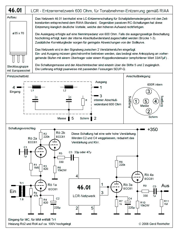

I've read some posts about 600 ohm LCR implementation in this circut.
As wrote It's anoter circuit but what do you think about this:
http://emisukeaudio.sakura.ne.jp/EM-TUBE_EQ3_Ver2_KAI.pdf
Can be used a similar solution in the valve-itch-phono

Hmm it uses a Mosfet follower to provide the drive and back to back 2200uF couplers because of 600 Ohm impedance network. Certainly adaptable but it would need that Mosfet and big lytic caps in the signal too. Also remeasuring curve compliance of course.
It doesn't thrill me, but if you want to try adapt it and listen nothing's stopping you.

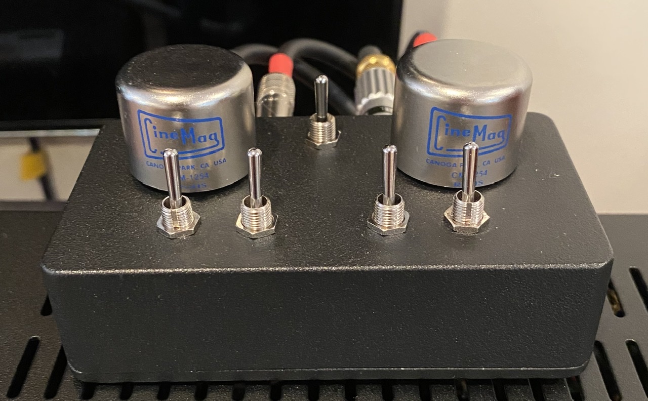

So now that I've added a LOMC to my turntable, I'm planning to integrate a SUT into my Valve Itch. My Benz Micro Wood SL has an output of .57ma, so I'm leaning toward a Partridge 977 1:6 SUT. I'm not concerned about wiring the SUT into the signal chain, but I am concerned about grounding. See, I'm using a Rega tonearm, which does not have a dedicated ground wire. With all Rega tables, the tonearm is shielded through the left channel return.
Without the tonearm shielded to the chassis, am I likely to induce hum if I ground the Partridge cans to the chassis? If so, should I shield the cans through audio ground?
Chassis should be referenced to the Itch's circuit GND. Rega are mysterious. You would probably get hum if you wouldn't. But you will try both ways to know.
Okay — now the SUT is up and running. Ended up going with a pair of Cinemag CM-1254. Integrated into this little box with four switchable step up ratios between 1:10 and 1:40. Signal grounds are floating and this little guy adds no additional noise to the system. Now ready for a UFSP shootout with my Benz Wood SL.
Thanks — yeah, while I was thinking of getting something more exotic, these are easily sourced here in the States, and the switchable gain options should allow me to use the same unit with a wide range of carts.

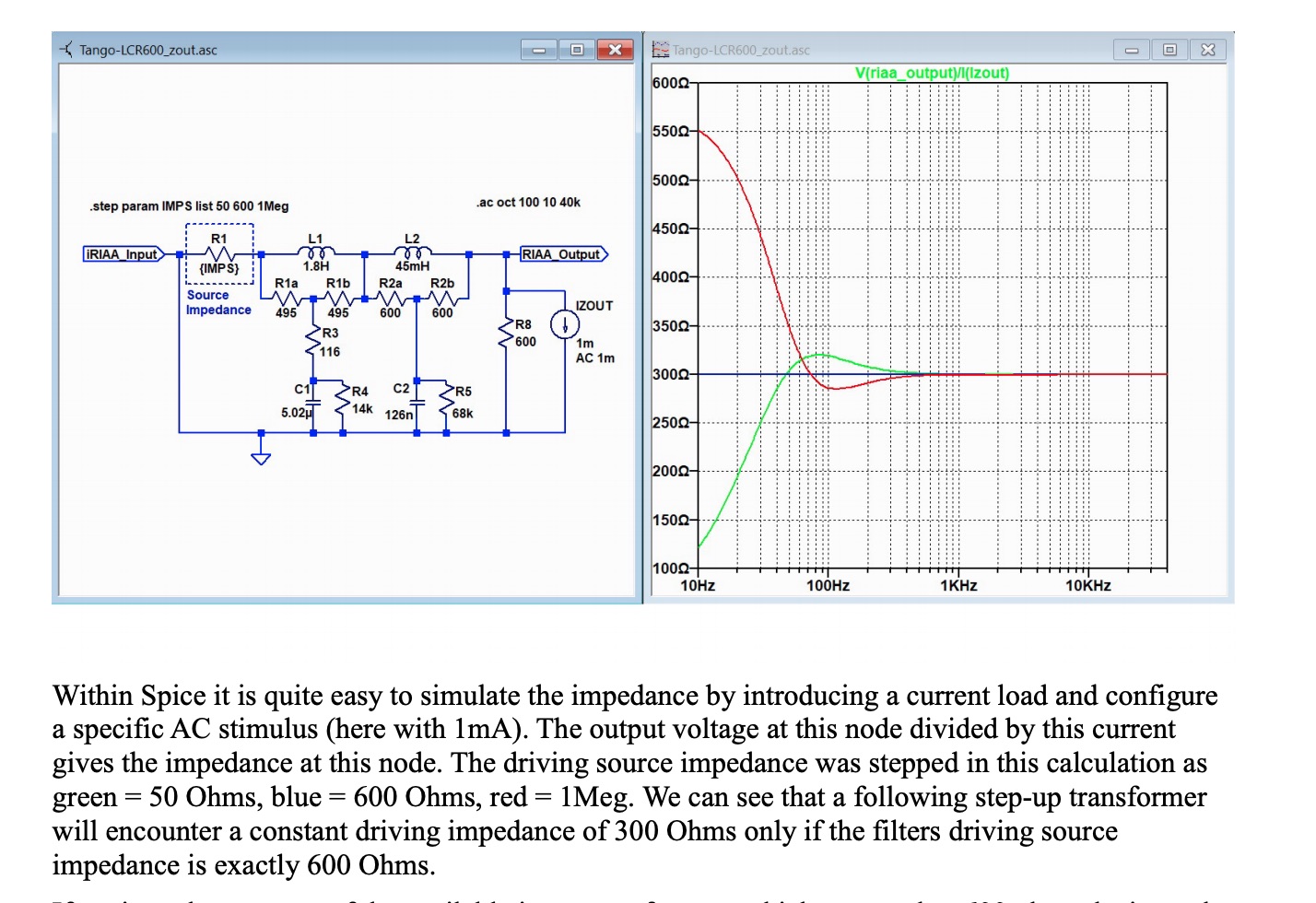

According to LCR-RIAA, "the output impedance of which should be 600 ohms, is important for adhering to the target curve."
In the posted design, Ecc81 output impedance is 267, so there is 330 in series to match up.
With 6N2P-EV in valve itch, the output impedance is 1000/2.25=444, does that mean it's good enough to drive the LCR directly?

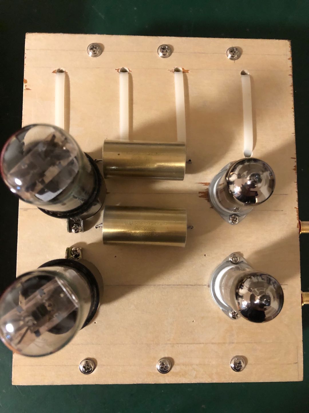

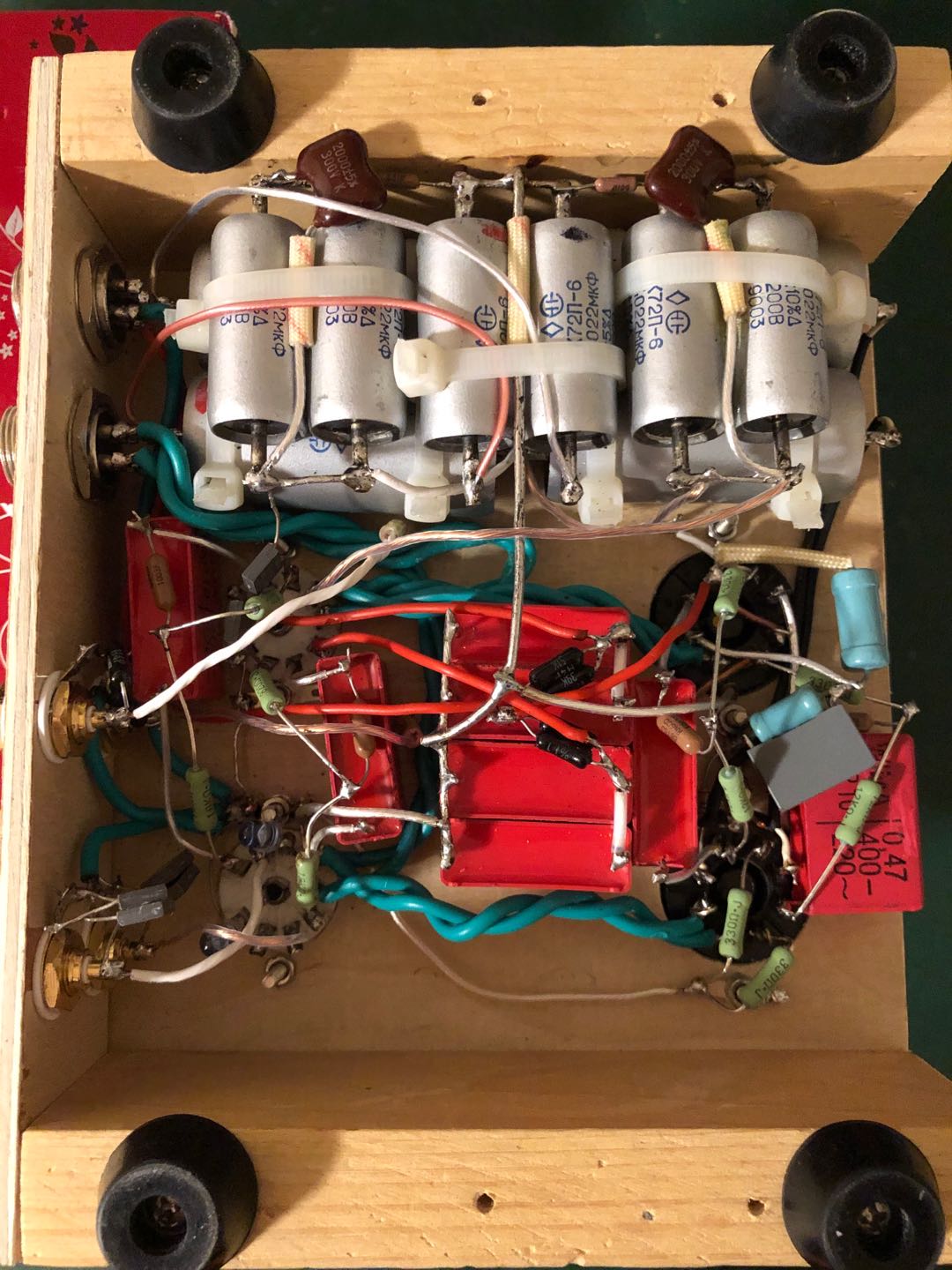

By the way I just built the phono with K72 teflons no other fancy components, initial impression is a bit better than Bench's RIAA5 (with premium parts).
Just quickly built for eval 🙂, very quiet to my surprise
