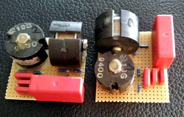

Here is my DIY LCR attemptI'm interested in the DIY LCR units about SQ & price, could you let me know more information?
Sounds good to me
Total cost around 70 EUR for the pair 😉
Just need to invest in some mu metal case
got them 10 years ago from local audio builder "Solaja Audio"Where did you bought the EQ LCR units?
Absolutely. Hum can be its Achilles' heel.
