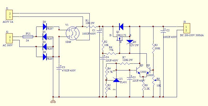

It is Kubota HV

Flash inspection says TL431 referenced long tail pair error amp and MOSFET series pass element. Pretty typical. Do you listen with the same HV PSU the LCR Riaa one too?

Kubota

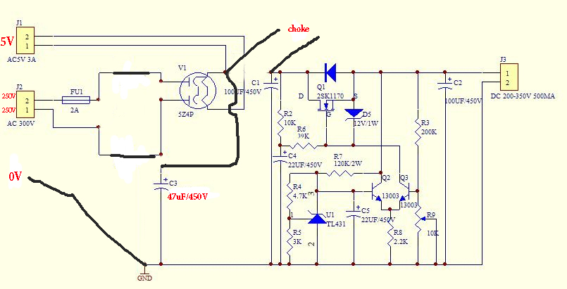

there is error in that rod dot on last rectifier diode

U just skip those diodes and made some changes in the PCB to make standard tube rectifier
something like this
Much better now IMO
