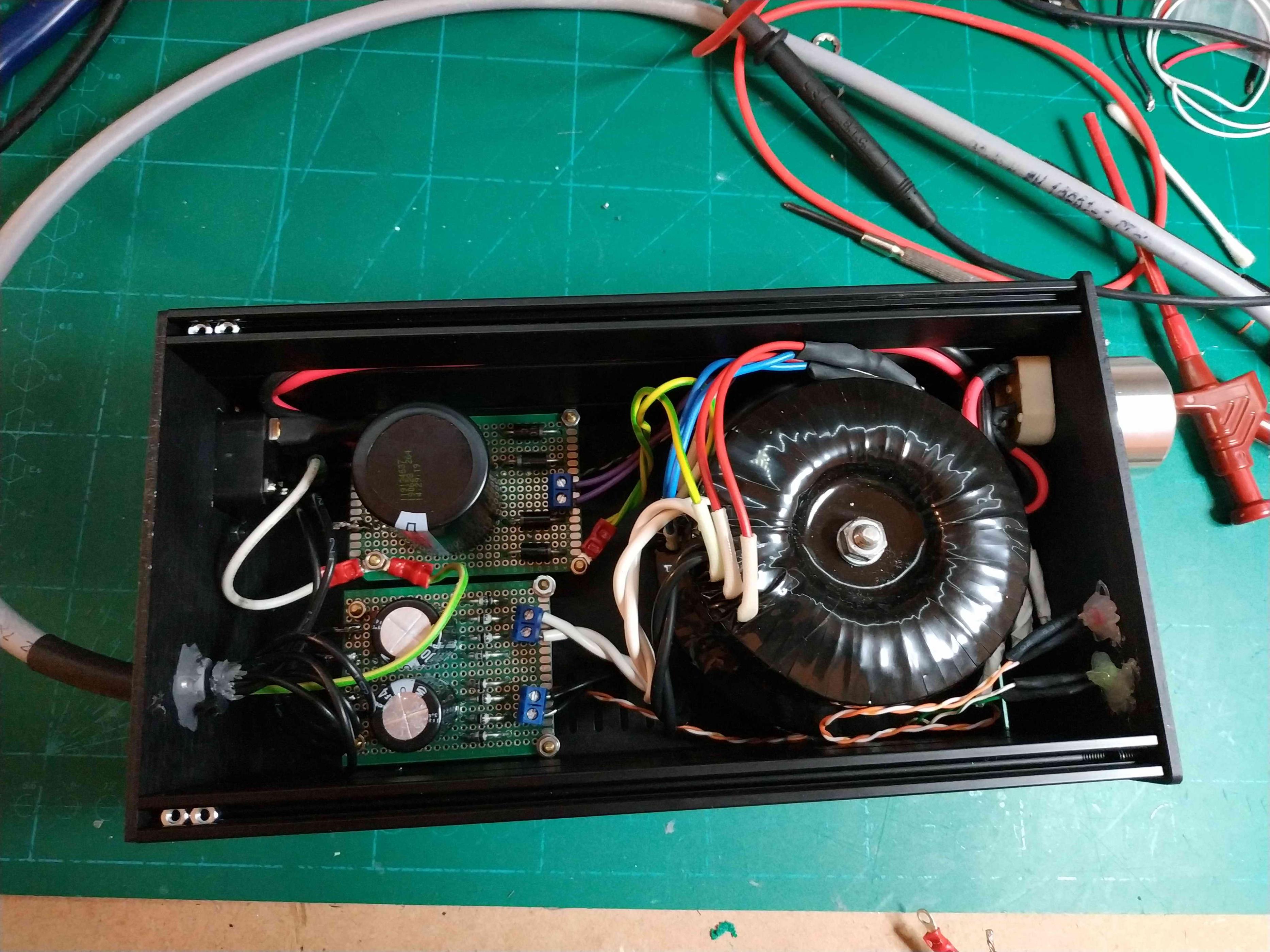

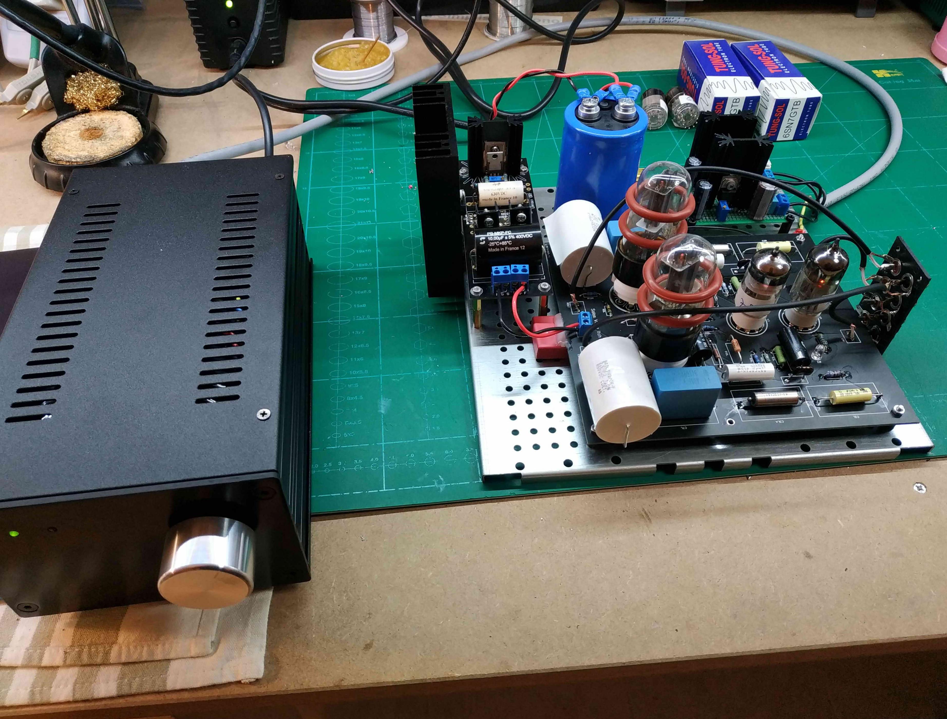

Took me some time, but finished assembly my itch too. Only power supply has a box for the moment and have to find a nice one for the main amp in the future.

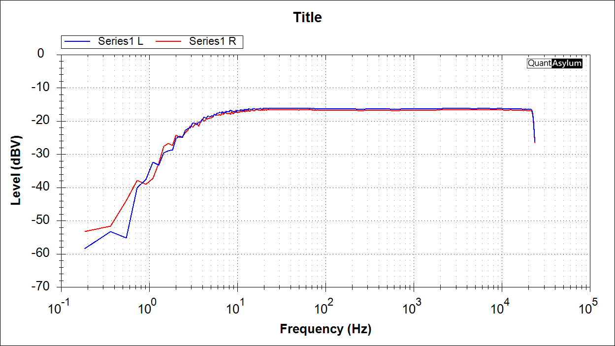

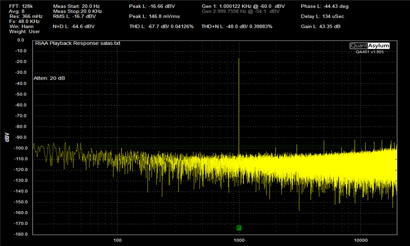

I attach also some measurements I took, a zoomed RIAA response and an FFT.
THD+N drops about tenfold if you up the output voltage to one volt.
Also at the end I had to shield the small tubes and C4 capacitor for a cleaner FFT. Some spikes at the top will be dealt with when in a proper box.
Hopefully will have a listen with a shure V5 type III with a generic needle (no Jico for the moment!) the next few days.

Very good noise floor and excellent RIAA tolerance for measuring an open plan tube phono build George. Congratulations.
Your little HF spikes to the right of your yellow FFT chart should be bench interference picked by either input valves or most likely by the inter-stage capacitors. Boxing and/or close shielding may eradicate them. Hum related needles at the lows are already almost absent. Excellent result in that commonly troublesome area. Jphabc54's remarks on surprising quietness and response accuracy to the ear you backed them up with some measurements now.
Do you have an up close 0dBV (1VRMS) 1kHz FFT so we could maybe discern the real THD spikes coming up from the noise floor?
By the way, in case you did, don't use the anti-Riaa software filter for evaluating response when doing the 1kHz THD FFT.

Because such a software filter in order to evaluate response against an EQ standard (Riaa) shows the phono noise flat on the display without being there as such in reality. The mid & lows grass should be getting gradually higher than the highs grass, roughly following the Riaa curve as noise floor when measured untouched by software EQ.
Its not working like a hardware anti-Riaa that prefilters the test signal to the phono's opposite way. It simply plots the phono's internal Riaa deviations vs a mathematically perfect phono EQ filter. Your test source signal is still flat.

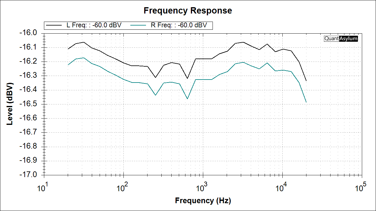

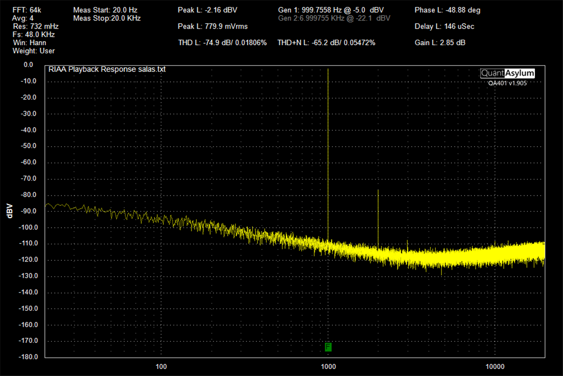

I took some more measurements, this time with a 40dB resistor attenuator.
I noticed that the generator of the QA401 is not so clean to 5mV and absolute useless at less than 1mV to measure MC preamplifiers. That' s also the reason for the low gain shown.
The spikes are gone and everything looks as it should and keep in mind that the pre is not boxed yet.
There is an anti RIAA software filter though.
I will have a listen soon. What loading do you suggest for a Shure V15 type3?
Very clean Itch noise floor output now with a hardware attenuator used. Divides the digital generator's noise as much as its amplitude. Test signal got cleansed, doesn't add nasties.
Yes, it should fool the software by missing 40dB from reported gain at the top left corner. There is 1/100 signal drop happening in your L-Pad it doesn't know about. Thinks test signal remains 500mV as it sends it out to the phono but its cut down to 5mV along the way. Still all the other numbers shown in the screenshot are valid because only relevant to what it sees back from the phono.
The THD profile is dead giveaway tube by the way. All things as expected.

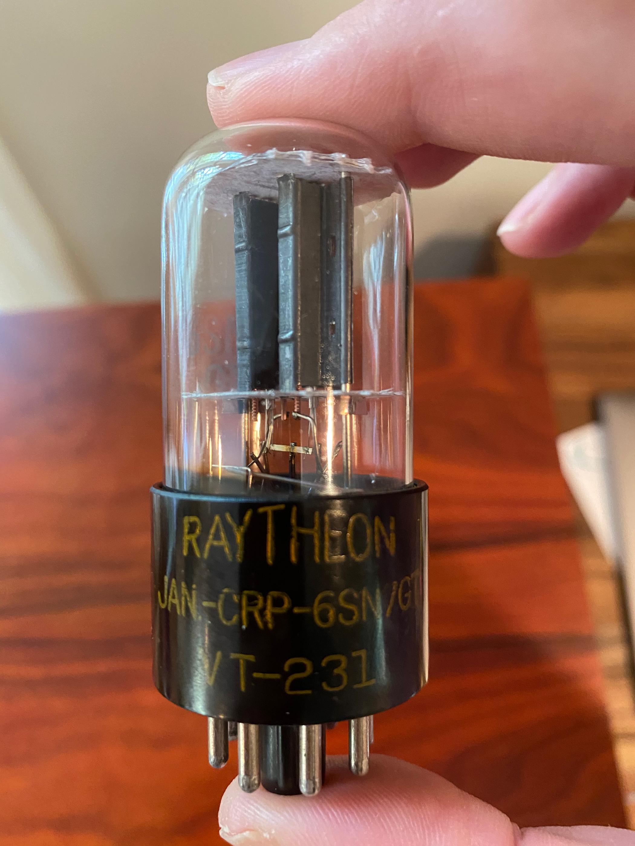

Among the best NOS for the type. Some samples could even go back to WWII vintage. Do they have an anchor logo at the other side?
