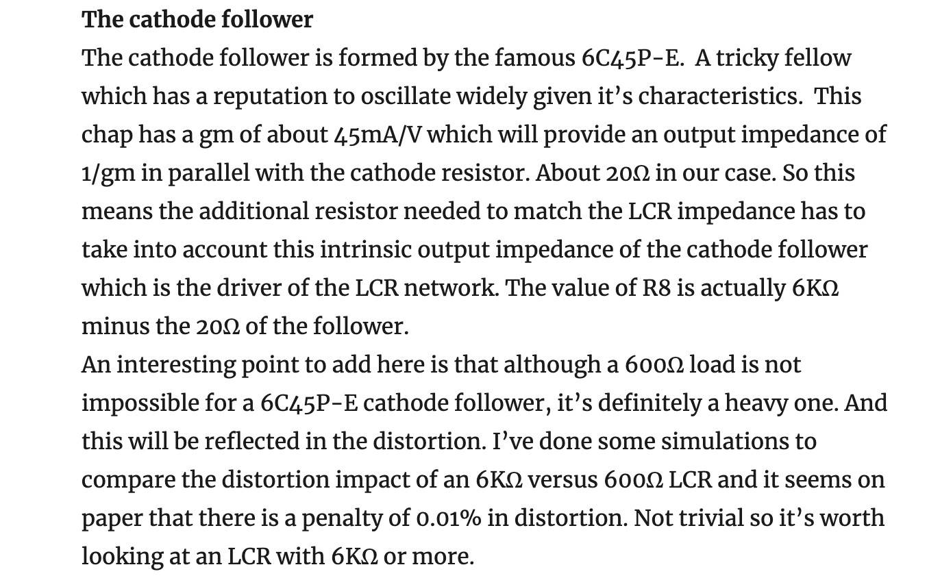

I don't think it's good idea to drive LCR 600ohm load directly after first stage, not even for 6c45p according to following,
LCR Phono: design notes (Part II) – Bartola(R) Valves
