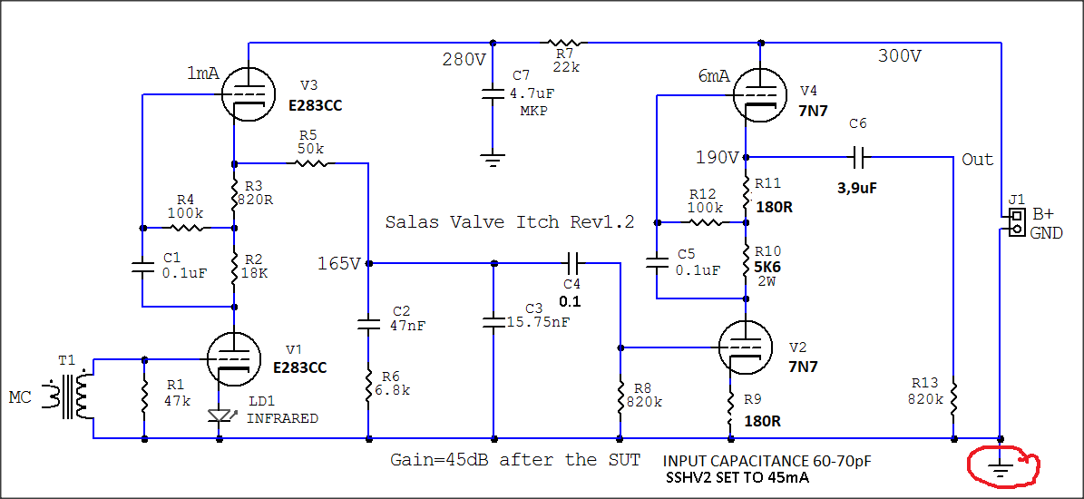

I built my valve itch waaaaay back in 2011, pretty much stock build, and I learned a huge amount during the build about grounding and more. Anyway, roll forward years and I've experimented with other phono stages (I can't help it, I'm phonostage curious 🙂). Anyway, after a period of not using the valve itch I dug it out to try out with a few different turntables I have set up here. I hit an issue where the MC input (vintage partridge step-ups) sounded good, but the MC input was really dull. This really had me scratching my head, and I did a bit of looking around, checking voltages etc to see if something was wrong.
Then I came across this post Valve Itch phono
Which gave me exactly the solution. Right enough, there was higher DC offset than I would like on the inputs. I decided to implement the capacitors on the inputs and everything now is bang on - and it allows me to swap 6n2 easily in the future without testing for optimal grid leak.

You are welcome. And nice to hear from you again. You meant the straight MM input sounded dull due to DC offset input bias? 2014 1.2 Itch version has an infrared LED as standard to lift the input tube's cathode a bit for grid current to remain low across tube samples. There is also a rare radiation rated version called 6N2P-ER with even lower grid current spec than 6N2P-EV. And it sounds very good.

You can calculate grid current of a valve in your now circuit by measuring DC offset across the 47K input load resistor. With no cart or SUT attached. Then solve Ohm's law for current. 0.47V on 47K meaning 10uA leak for instance. Say you managed to bring it down at 47mV by selecting valves and/or lifting with an IR LED. That's a ten fold grid current improvement. 1uA. Surely less problematic. And so on and so forth.
Some 6n2p-er are ordered, we will see if they are real. Seller has good feedback so we will see. I had roughly 0.5V across the 47k resistor....... and yes adding a 1n4148 brought that down to 70mV or so. I still left in the capacitors though, the just give me peace of mind.

Yes same, try ECC88 that has μ=33. Or some comparable μ spec type. Arrange R9, R10, R11 resistors for about equal voltage across V2 V4 (anode to cathode DC). Around 100V on each. You should gain +6 to +7dB in total.
