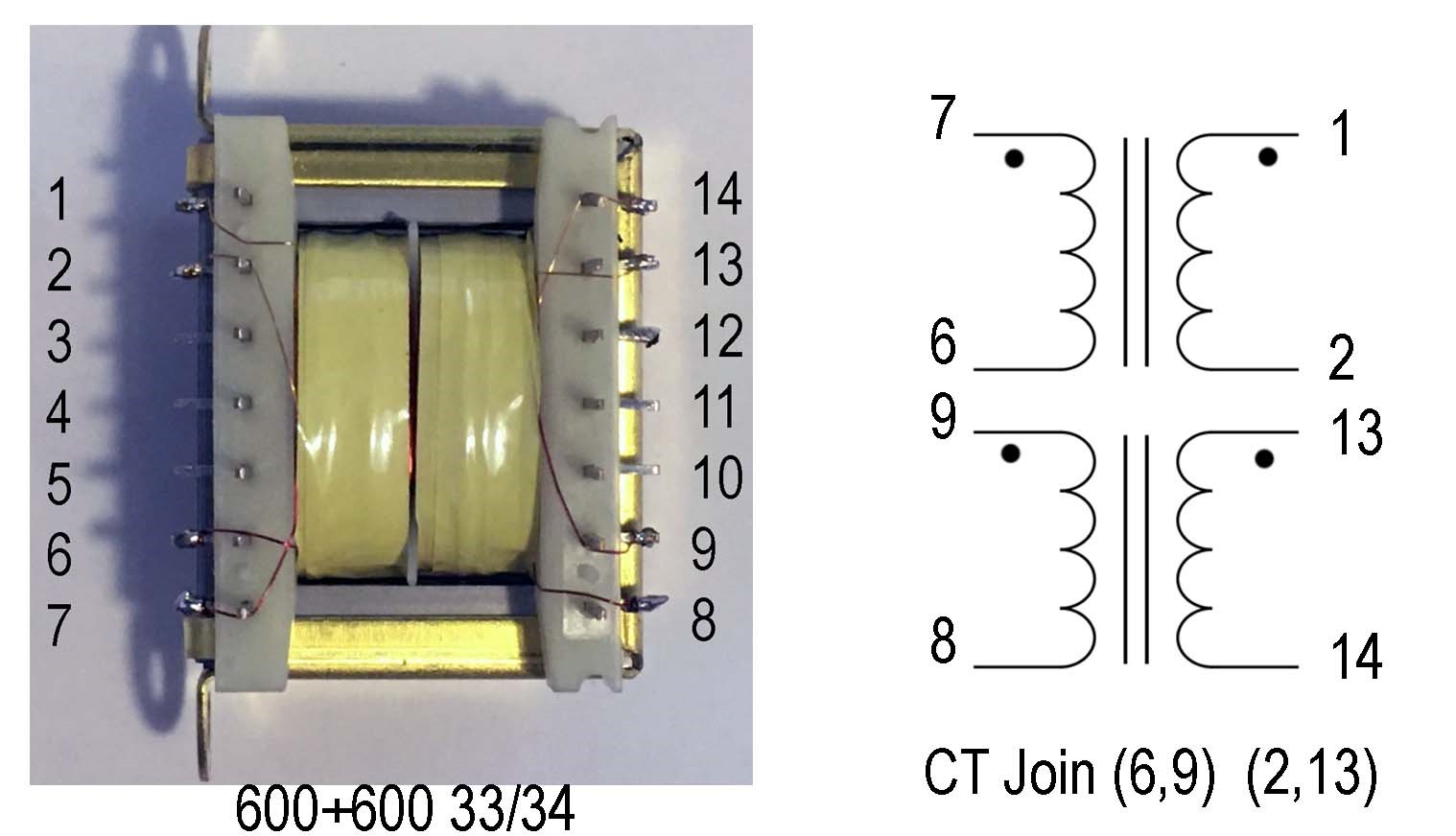

On the subject of iron, Dave Slagle has posted the custom ValveDac output transformers today, wound on 82% nickel cores. It should not matter in terms of performance, but in my experience those nickel cores just sound better than anything else I have tried. There is Slagle iron in my valve LCR phonostage, preamplifier and the midrange channel of my power amplifiers, and soon the ValveDac.
Price is good too.
Price is good too.
Do you have a link? I checked and could not find it in the intact forum.
I just did what I normally do, sent Dave an email with the schematics, back-and-forthed a bit about about what I am trying to do and the specs it needs to hit and he talks me back to reality and then custom winds exactly what is required. If you send him an email I am sure he will be aware of the project and the transformers...the ones made for Anthony and the ValveDac.
Price is comparable to the Jensens. I think Dave might want to see how mine work out before winding too many more, not sure.
