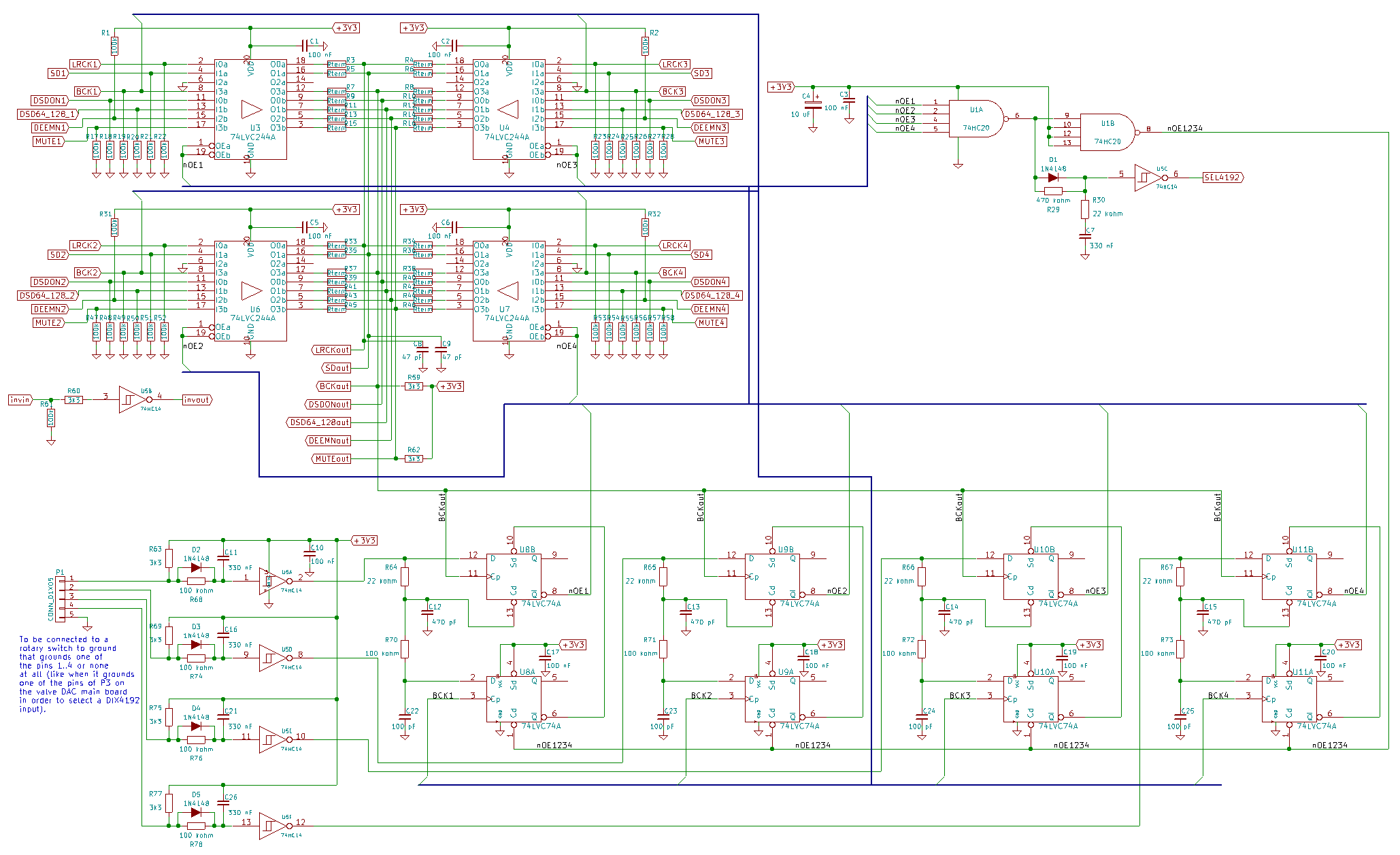

This is my proposal for a 4:1 I2S multiplexer, version with only 3.3 V CMOS inputs. It can be changed into LVDS for BCK, LRCK and data (SD) by replacing the A sections of the 74LVC244As with a quadruple LVDS receiver with three-state CMOS outputs, such as the SN65LVDT390ADBT. The 74LVC74A's are meant to ensure safe clock switching for the bit clock. The 74HC14 debounces the signals from the switch. C8 and C9 are meant to prevent hold time issues. Use at your own risk, as the circuit has not been tried, tested or simulated.
  • I2Smux.pdf
    I2Smux.pdf
I forgot to mention explicitly that the circuit of post #1347 is meant for the original valve DAC, where the signal first goes into an FPGA module, then into an asynchronous sample rate converter, then back into the FPGA module, then gets reclocked twice by flip-flops and then gets retimed by a current-steering valve logic gate.
For the raw DSD valve DAC, I would recommend a clearer separation between the data handling and the clock handling part. Unfortunately that would probably lead to a larger skew, as the data and bit clock or master clock can't be buffered by the same ICs when you want to keep them well-separated. It may then be necessary to add extra delay circuits and/or reclocking flip-flops to solve hold time issues.

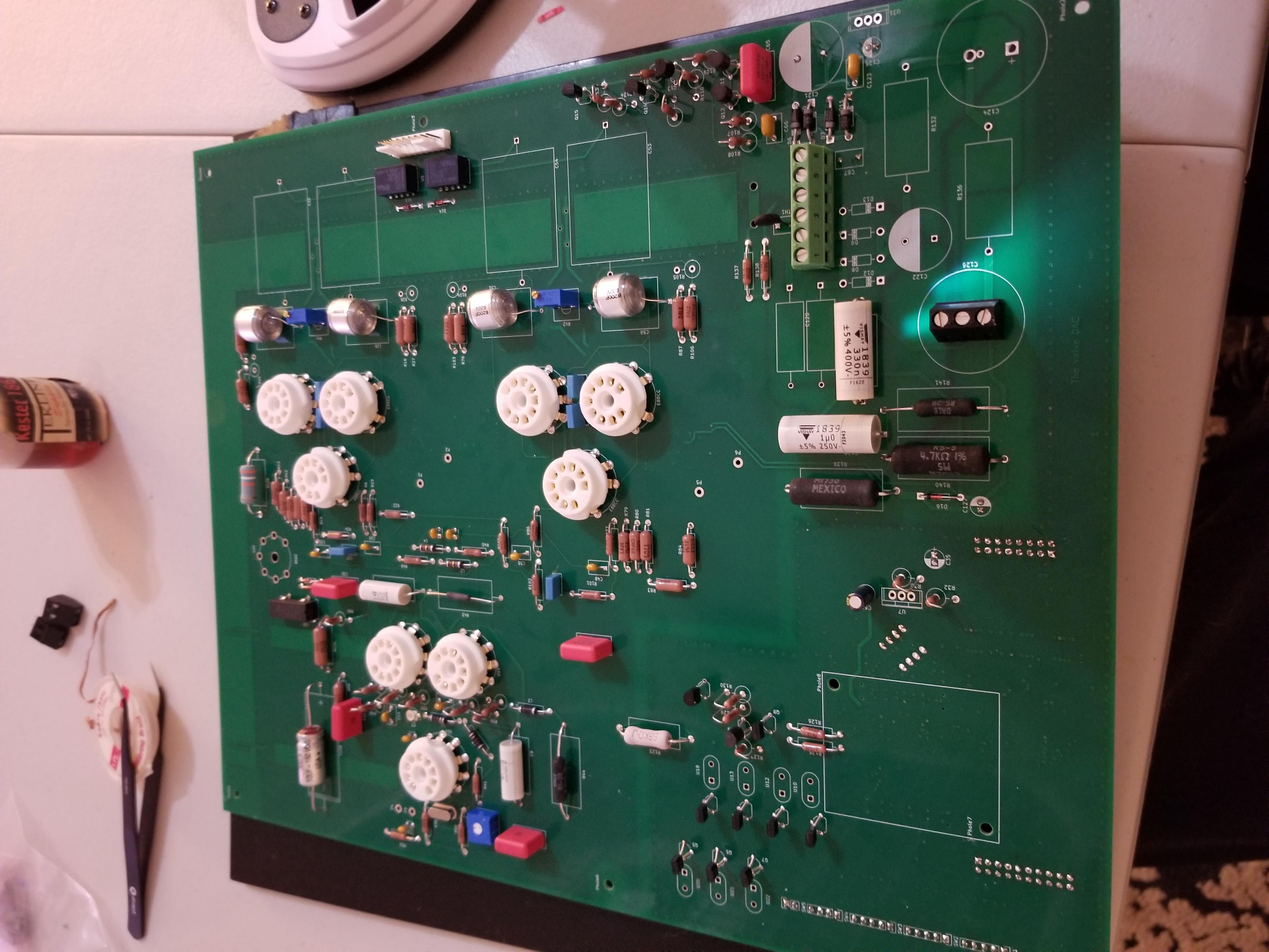

Making some progress! Everything installed other than output caps, the voltage regulators, and the lights (since I need to decide how to do those).
I've got a Maida PSU and a Pete Millett supply for the 6.3V. Just need to get the transformers, cases, and FPGA.
Might have wasted money on a voltage regulator, because I forgot that the FPGA will increase the power draw on the 5V rail. Went with this regulator, but it's max current is only 500mA. Will probably just go with the L4940V5 and save the fancy once for something else.

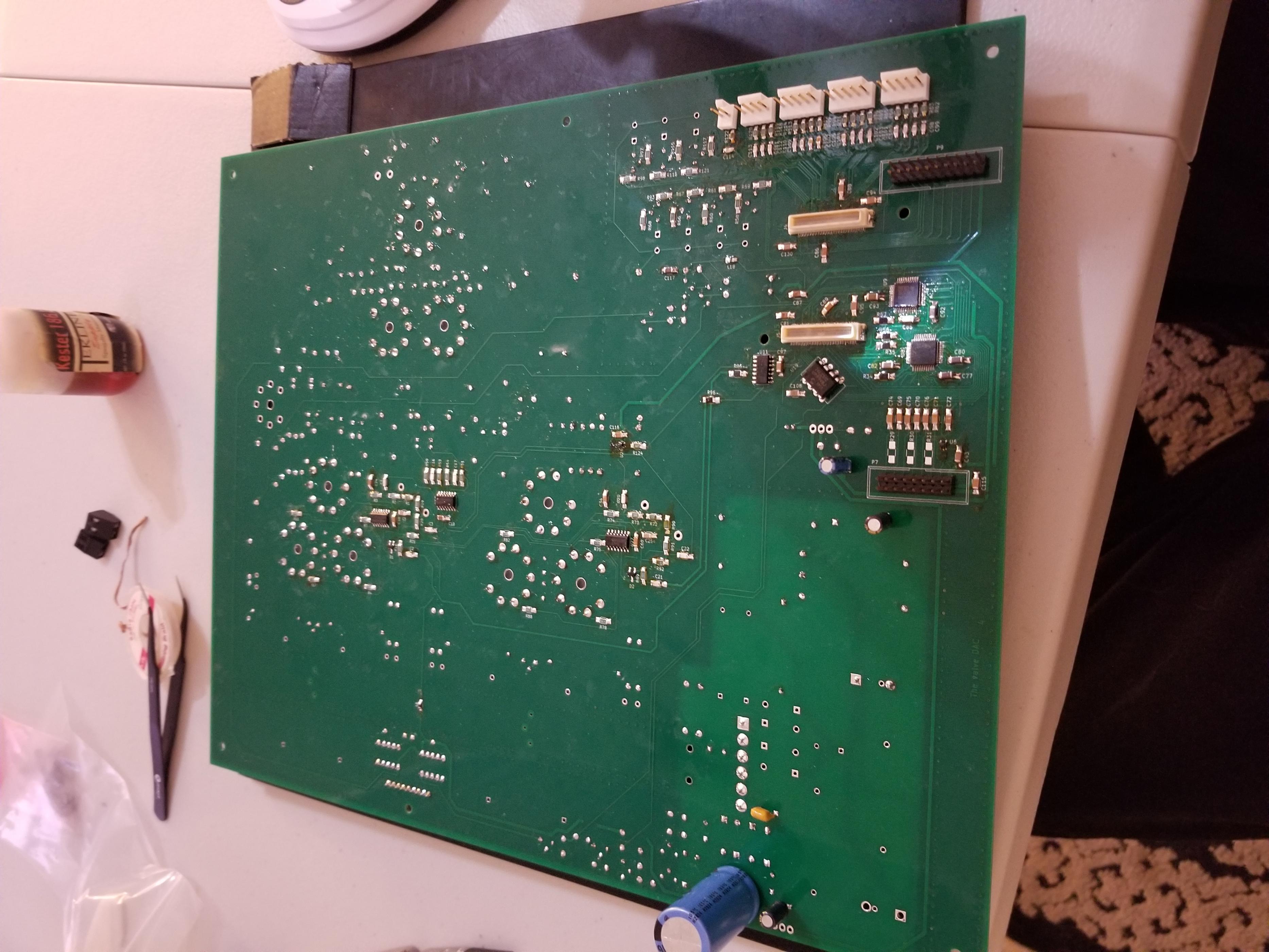

Looks great! How did you do the fine-pitched SMD soldering?
I oversized the 5 V supply a bit, because I didn't know what would happen when I changed the configuration file or how much sample-to-sample spread there would be. The last time I measured it, the current drawn from the 5 V supply was three hundred something milliamps if I remember well, but that was several configuration file updates ago. So your LT3045's current handling may or may not be sufficient.
Looking good Sonny! This is the first I've seen the pcb up close with some bits on it. Interesting to see just where the vertical resistors and some of the other taller components are located on the board.
You've not soldered on the 7 pin valve socket yet...perhaps you purchased a rubbish one like me where the pin sockets are too tight to push in the valve pins.
That was not by choice lol, I ordered it with the others and the seller must have forgotten it. I'll order one when I get my tubes. Four resistors are also missing because I messed up when ordering. I also did not install the 75 or 110 ohm resistors yet, because I'm not sure what my input configuration will be.
I used a magnifying glass and a conical tip on my iron. Put some flux down, then put a tiny bit of solder as close to the tip as I can, and barely touch the pads one at a time. They are so small, they heat up quickly, and the solder fills up the pad easily. Just had to watch for bridging, which I did have one but resolved it.

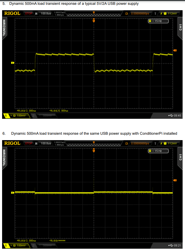

I remember reading about the PSAudio Directstream Dac years ago and that the FPGA was considered a major source of noise within the unit, a significant contributor to its relatively pedestrian noise measurements. I may be wrong, or mis-remembering, but perhaps some of that FPGA noise in the ValveDac could be pacified with a power supply capable of reacting well to rapid current fluctuations...something with a large ultracapacitor at output. I remember seeing a scope reading showing the effect of an ultracapacitor filter at the output of a LDO that was subjected to rapid current pulsing...it looked to have made a significant improvement.
