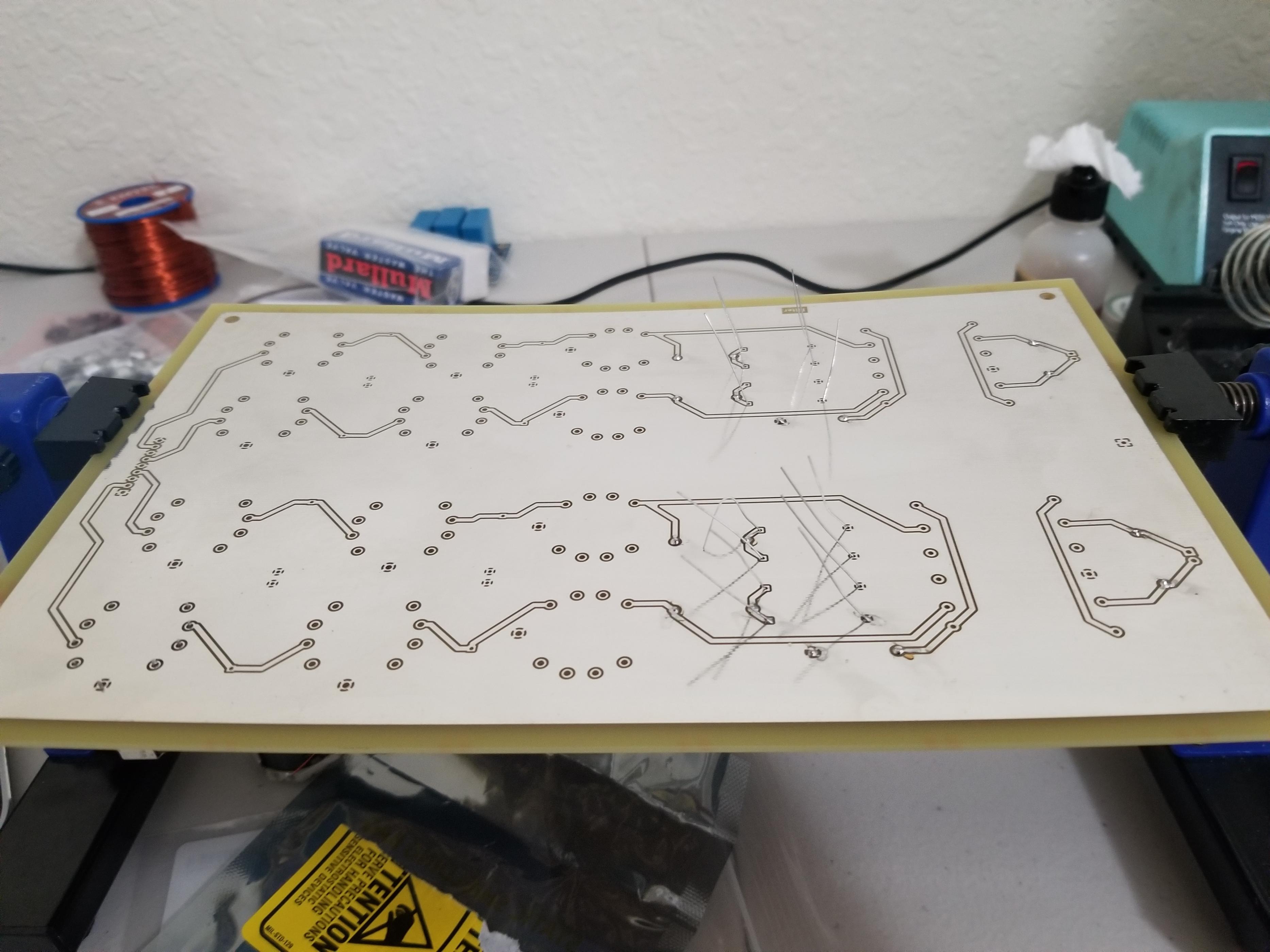

That looks great! I should have gone with the pin headers like you did with the plastic guide (eg P7). I've attached a picture of my filter board, there's not much around the unused pins.

Thanks Sonny, your filter pcb looks the same as the ones I have here...not a lot of metal for the solder to cling to.

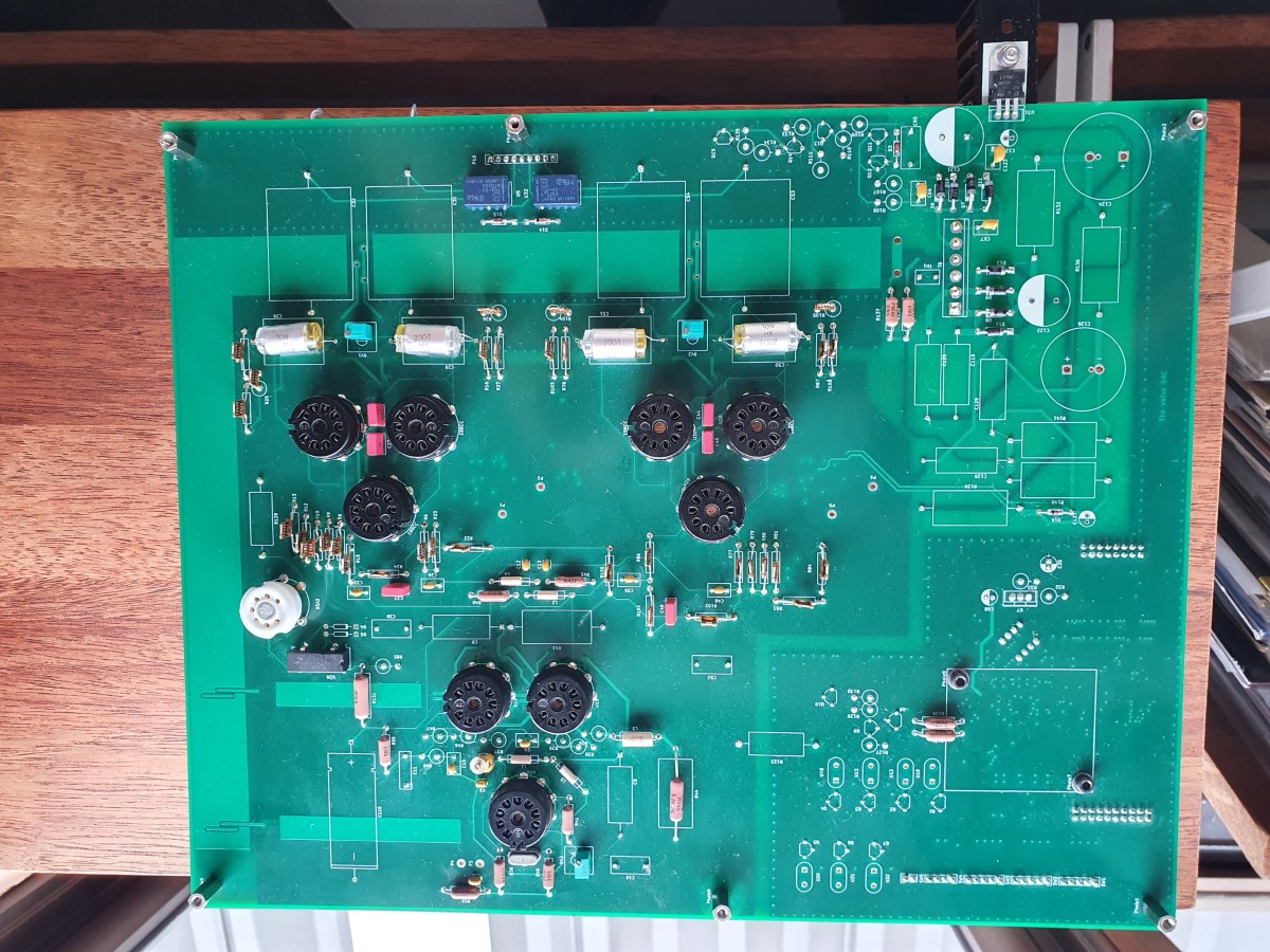

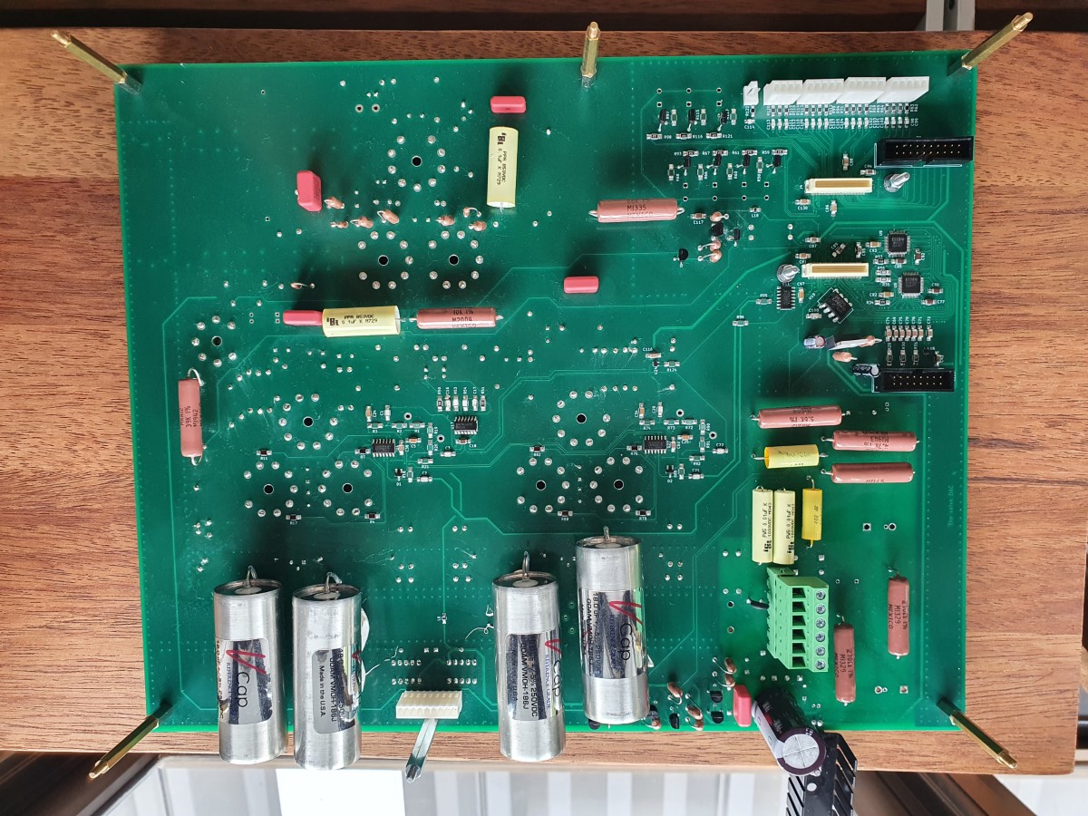

Two days of soldering and everything is populated apart from a handful of power supply caps that are yet to arrive. Went a bit stupid ordering resistors but in the pre and power amps I've built any resistor or capacitor on the grid/anode/cathode of the valve makes a difference to the sound and I have no reason to believe it would be any different in the ValveDAC.
Have put any of the taller through-hole components underneath the pcb so I can maximise the height of the valves protruding from the top of the case. Basically started with the necessary parts such as the trimpots and anything taller had to go down below.
I'm sorry I have to write this, but putting through-hole parts on the bottom side may or may not worsen crosstalk between the digital and analogue/mixed-signal parts of the design and affect the noise floor. It depends on what parts and how close they get to the digital sections. For example, I don't expect any problems when the big DC blocking capacitors are on the back side, as Ray mounted them, but I'm not so sure about the 1.82 kohm tail resistors, particularly of the right channel.
In any case, I have no way to predict how big this effect is, so it could very well be that it works just fine like you mounted it.

Many thanks Marcel. In anticipation I did those and some extra last night. Was a bit concerned about some of the other caps and larger resistors as well but did not move them.
