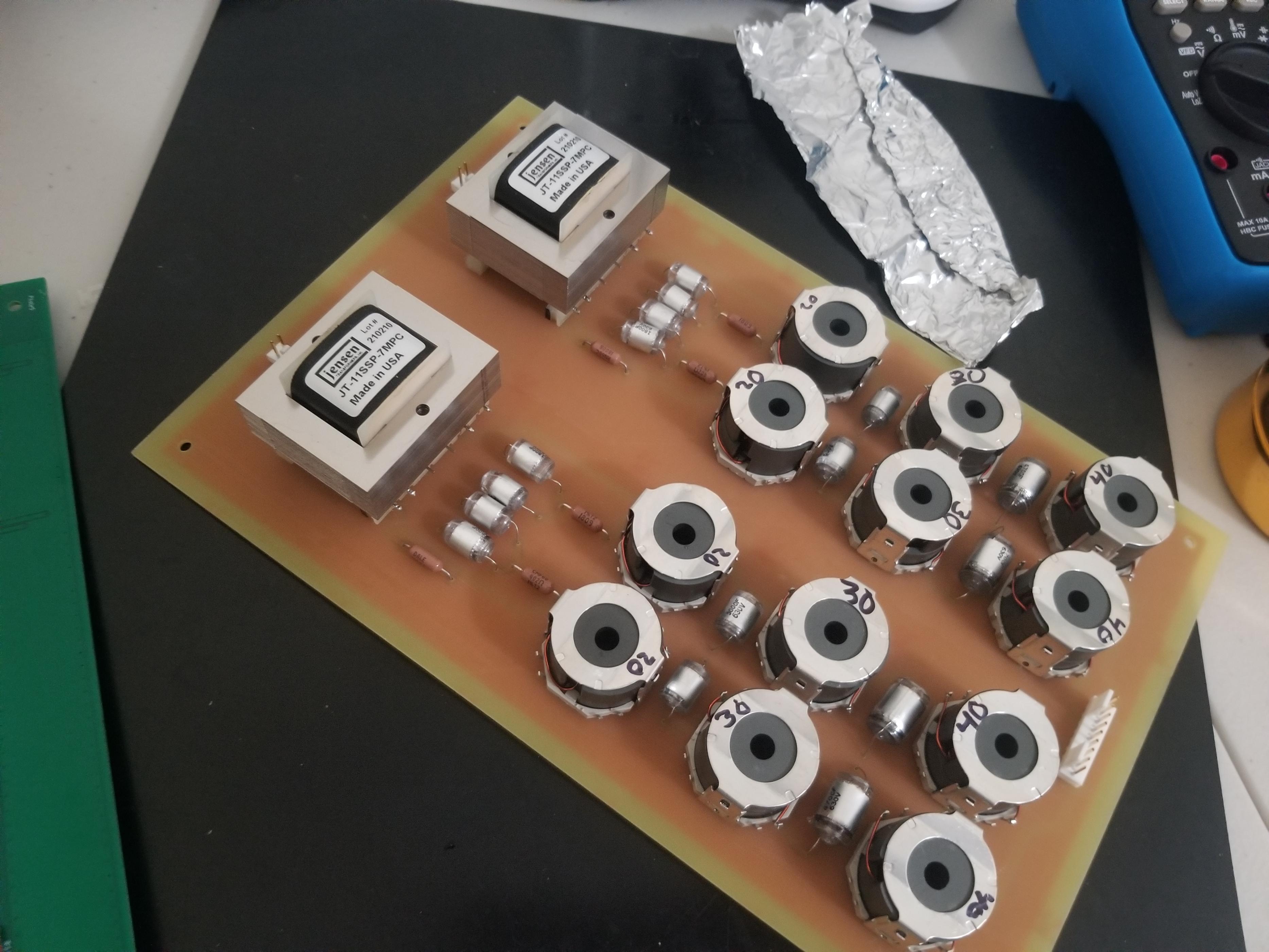

Is this a suitable trimmer capacitor for C7?
https://www.mouser.com/ProductDetail/768-JZ150/
The Multicomp mentioned in one of the PDFs is rated at 200V but seems to be unavailable in the US. My concern is that the Multicomp is rated for 200V, and the one I used is only 100V. I've found a higher-voltage replacement if needed.
100 V should be more than enough, so if it fits on the PCB, it is suitable.
