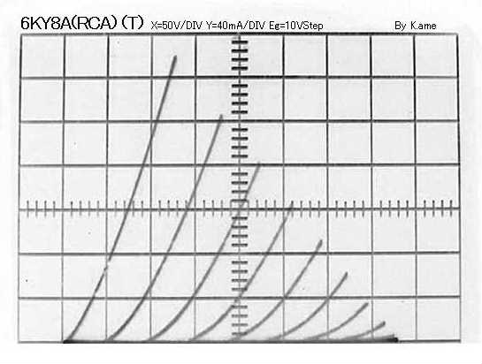

Hello jazbo8, I wonder do you have time to create a LTspice model for 6KY8a. I have the triode-connected curve for 6KY8a beam power section as shown below.
Your 6DS5 model worked great, I used it simulating a SE amp (using 6j6 as Voltage amp). I am going to build it as part of my Summer project. Thank you again!
6KY8A Pentode Section SPICE Model
Please be aware that this model was built using the triode-connected data that you provided, and it unfortunately did not match the pentode characteristic shown in the RCA datasheet, so bear that in mind when you use it.

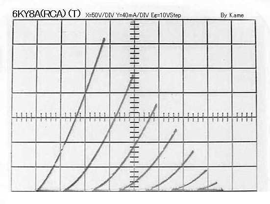

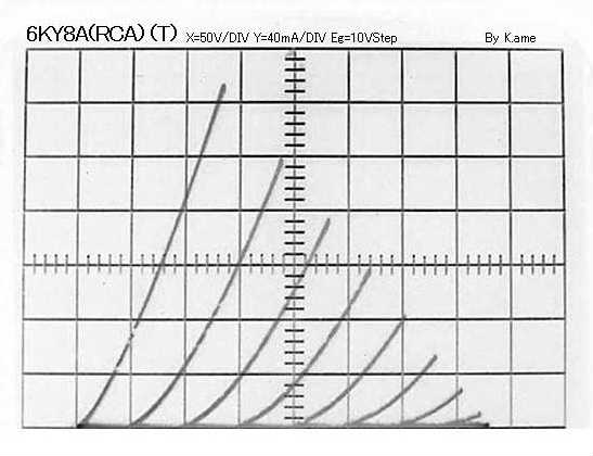

Hi jazbo8, thank you!
I have three sets of the triode-connected data here, would you please to check out which one can get better match with the RCA datasheet?
Thanks again!
Unfortunately, none of them is close to the datasheet, the mis-matches are the greatest at higher bias voltages (Eg1 > -10V), the datasheet shows lower current than the samples. In any case, the tubes can work over a wide operating range, so the model that I provided should suffice for now until a better sample comes along.would you please to check out which one can get better match with the RCA datasheet?

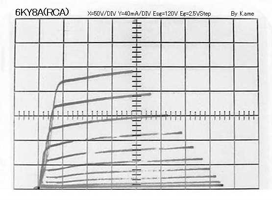

Hello jazbo8, thank your so much for your helps!Unfortunately, none of them is close to the datasheet, the mis-matches are the greatest at higher bias voltages (Eg1 > -10V), the datasheet shows lower current than the samples. In any case, the tubes can work over a wide operating range, so the model that I provided should suffice for now until a better sample comes along.
I got the curves from this website "http://homepage2.nifty.com/Kame/6KY8Asyu.htm",
I simulated your model using "DC sweep" in LTspice, the results matched well with their Ip vs Vp curves (@Vsc=120V). Please see the attachments.

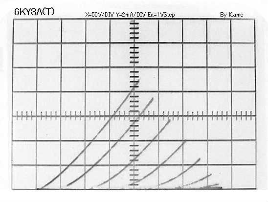

I also attached the curve of 6ky8 triode section, is the triode section the same as 12AT7 or similar?
Thanks again!
Good to see that the model matches up with the pentode characteristic on the Japanese site, since that was the sample used to build it in the first place (or close to it). Also the triode section appears to be very different from the 12AT7, not sure of what the closest equivalent might be...the results matched well with their Ip vs Vp curves (@Vsc=120V). Please see the attachments. I also attached the curve of 6ky8 triode section, is the triode section the same as 12AT7 or similar?
No, it's very different from 12AT7. A 6SL7 would appear to be the closest match with a slightly lower mu and Rp. Remember, you must take into consideration Rp and transconductance along with mu. 😉I also attached the curve of 6ky8 triode section, is the triode section the same as 12AT7 or similar?
