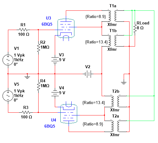

If it's an ultralinear transformer, you have two such units with their primaries connected in series and their secondaries in parallel. Here's a PP 6Bq5 example. Let's guess that the Z impedances are 4,000 and 8 ohms, for each such that the N ratio is SQRT(Zp/Zs)= 22.3. One primary Ratio is 13.4, the second is 8.9:
