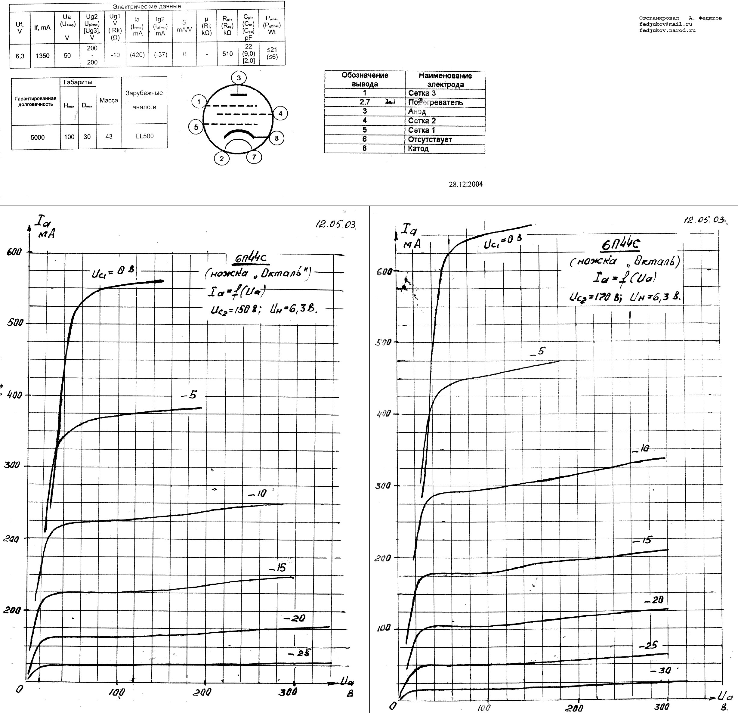

I am looking for a spice model for the soviet 6P44S. I've just ordered 4 new pieces from ebay, and would be interested to see how they perform in my amp instead of the good ol' 6P36S.
Thank you in advance!

Hello,
This seems to be equivalent to 6P36S, EL500, PL504 etc.:
Do you have the LTspice model of 6P36S ?
No, because the Rydel model would be a terrible fit for those triodes. 😉 Have a look here for the 12A*7 and 6SN7 models.Alain,
Hi Arto, I have the model for 6P36S, but this tube is different. The heater is lower power, but the anode and G2 dissipations are higher. Pa is almost double, or at least as the datasheet says. Could this be a modern construction, to replace the 6P36S?
6P36S can be used well with 25 W anode dissipation. It's specification is just very "gentle", Pa = 17 W and Pg2 = 5 W.
The real potential of 6P36S can be understood when comparing it's size with EL34 and 6L6 for example. Also the 6,3 V / 2A heater gives some idea of the current handling capacity of the cathode.
Anyhow, the curves of 6P36S and 6P44S are identical. The real differences of their performance can be observed only with actual tests, not with similations.
