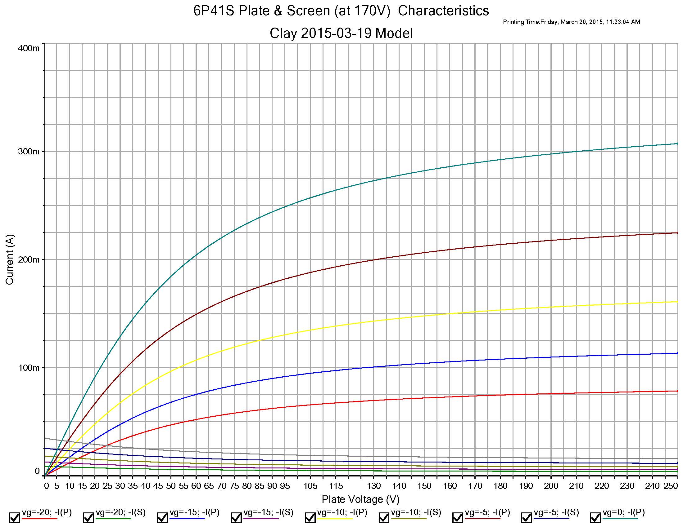

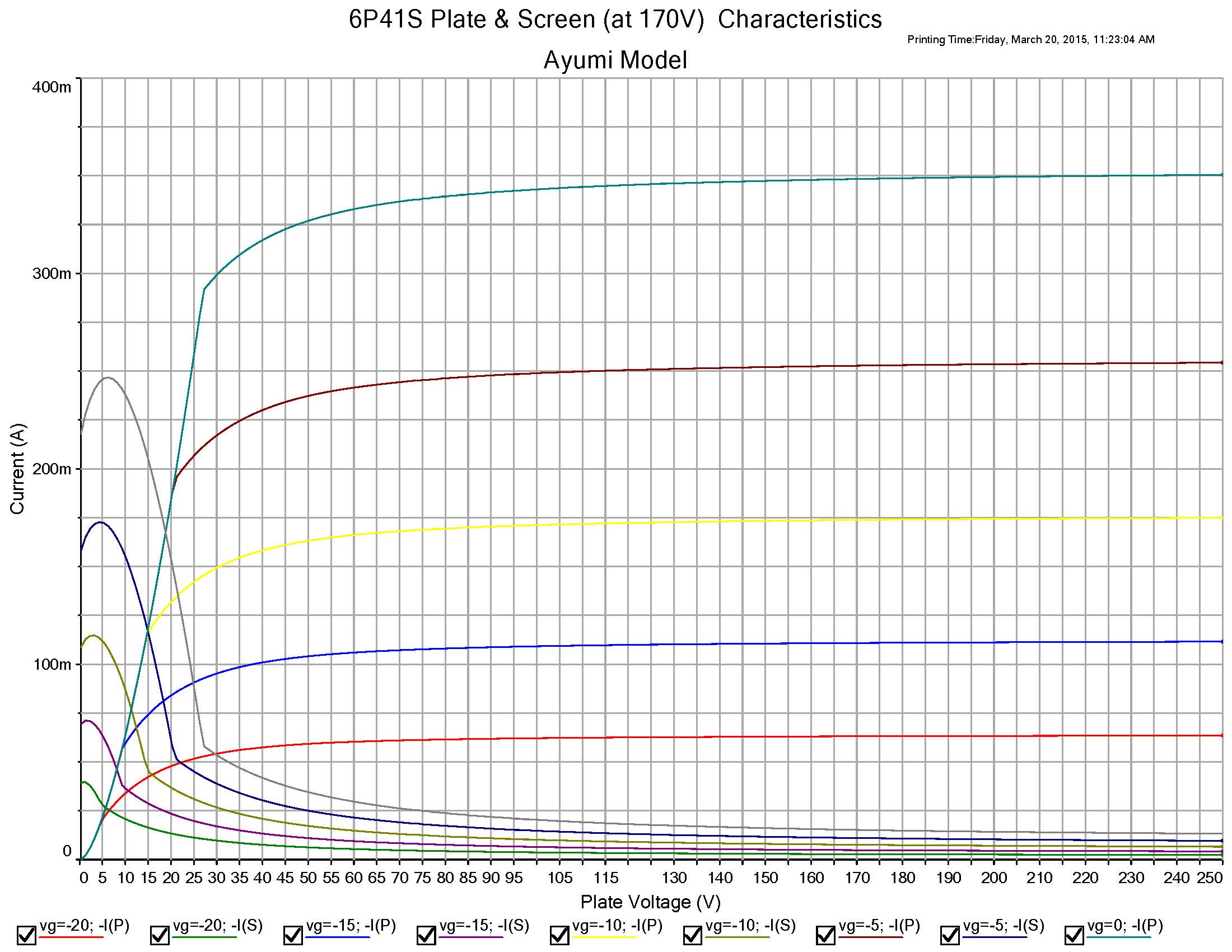

I tested your pentode model and it works fine. The results are very similar to my 6P41S SE_UL I have built (attached).
But what is the sense of triode model of a pentode ?
When I build or simulate by using triode connected pentode, I put a resistor between g2 and anode and fine tune this to best linearity.
This can not be done when simulatin with triode model, but in practise that resistor must be there.
Does your pentode model with g2 connected to anode give identical results with triode model ?

For the 6P41S, the triode-connected model is redudant and can be discarded, but for many pentodes if you simply connect the screen to the plate using the pentode model in the sim, it will not give you the same characteristic as the triode-connected model, i.e., you will not get the same triode curves shown in the datasheets, this is because many datasheets contain errors, so I have to make some adjustments when using the Ayumi method to build the pentode model. Anyway, for convienence, I make both models available depending how the tube is used in the circuit.But what is the sense of triode model of a pentode? Does your pentode model with g2 connected to anode give identical results with triode model?

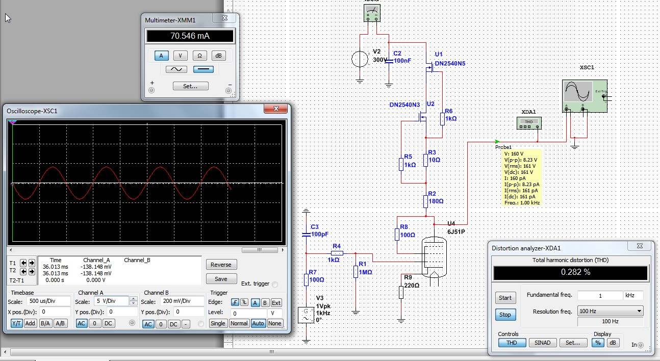

I did this really quickly, seems to be fairly close for screen current and I can't read Cyrillic very well... 😀
Code:.SUBCKT 6P41S 1 4 2 3 ; P G2 G K + PARAMS: CCG=3P CGP=1.4P CCP=1.9P RGI=2000 + MU=91.184 EX=1.3719 KG1=275.0 KG2=4500.0 KP=10.65 KVB=45.0 ; Vp_MAX=420.0 Ip_M AX=0.256 Vg_step=1.0 *-------------------------------------------------- RE1 7 0 1MEG ; DUMMY SO NODE 7 HAS 2 CONNECTIONS E1 7 0 VALUE= ; E1 BREAKS UP LONG EQUATION FOR G1. +{V(4,3)/KP*LN(1+EXP((1/MU+V(2,3)/V(4,3))*KP))} G1 1 3 VALUE={(PWR(V(7),EX)+PWRS(V(7),EX))/KG1*ATAN(V(1,3)/KVB)} *G2 4 3 VALUE={(EXP(EX*(LN((V(4,3)/MU)+V(2,3)))))/KG2} G2 4 3 VALUE={(PWR(V(7),EX)+PWRS(V(7),EX))/KG2*(2.5708-ATAN(V(1,3)/KVB))} RCP 1 3 1G ; FOR CONVERGENCE C1 2 3 {CCG} ; CATHODE-GRID 1 C2 1 2 {CGP} ; GRID 1-PLATE C3 1 3 {CCP} ; CATHODE-PLATE R1 2 5 {RGI} ; FOR GRID CURRENT D3 5 3 DX ; FOR GRID CURRENT .MODEL DX D(IS=1N RS=1 CJO=10PF TT=1N) .ENDS

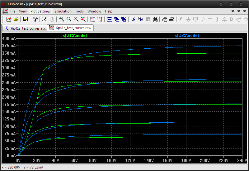

Thanks, I have tryed it and it do work quite accurate when compare sheet.

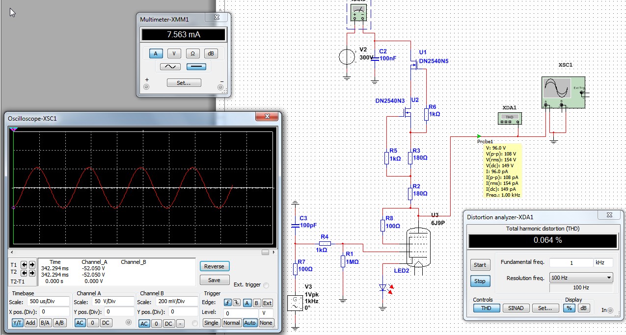

But I need a model for the 6J51P who is a small penthode, and I do not now much about make models, however yours can easely be changed? if I have datasheet of tube.
The 6J41 is a powertube, and the 6J51 a voltage amp. Picture two is de sim with a 6J6P tube who work fine in triode connection.
Thanks for the data.
kees

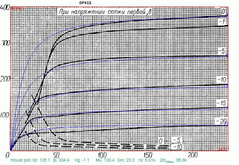

Hmm, how can it be close to the datasheet when cogsncogs already told us that the currents are way off...Thanks, I have tryed it and it do work quite accurate when compare sheet.
It is far from this specs: https://www.dropbox.com/s/9pjwtmosyk09xdk/6p41s.pdf?dl=0
But the model jazbo8 posted is very accurately according to attached 6P41S specs.
Thanks again.
It looks like my use of 300V on the screens yesterday (like in the RCA 7868 data sheet) was misguided. Here's how the two models compare with 170V on the screens (like your data sheet's, right?) The Ayumi does look significantly more accurate.
Thanks again.
I did look at the sheet and it was close, or I did miss something.
Okay, this is as close as I'm going to get matching a Koren model to the plate curves from the data sheet using Model Paint Tools at least for now. 😛

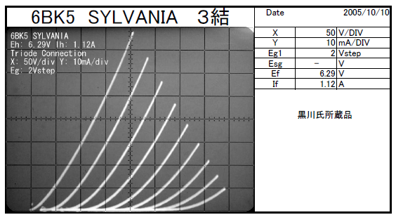

If you can provide the triode-connected curves, I can take a crack at making the models for them.Hello guys,
I am looking for LTSpice models for 6BK5, 6AS5, 6DS5, 60FX5 and 6EM5.
Is anyone able ( and kind ) enough to make LT Spice model for those tubes ?
Many thanks!
6BK5 SPICE Models
Triode-Connected (based on the Sylvania data supplied):
Pentode (adjusted to the GE datasheet):

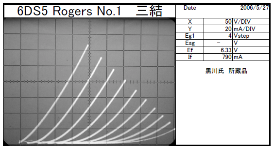

6DS5 SPICE Models
You are welcome, here is another one...
Triode-Connected:
Pentode:
Triode-Connected:
