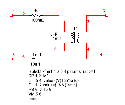

Why would you want to run them faster? Seriously, please show us how you would build the models...🙂
I tried making the following models based on the datasheets, hopefully they are close enough...
How did you arrive at the different coupling values?
