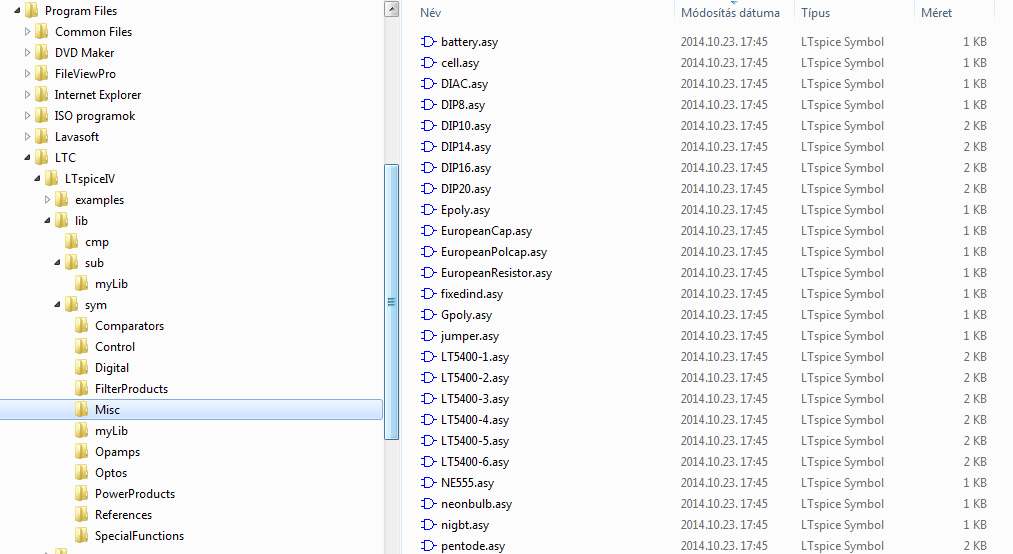

Figured out how to add the files. I have the trim pot issue fixed but no its saying cant find triode model
I the tube symbols are missing in your LTSpice since euro21 already included the models in his zip file. If so, please unzip the attached file into the LTC\LTSpiceIV\lib\sym\Misc sub-directory and re-start LTSpice again.
https://dl.dropboxusercontent.com/u/1326040/tubesym.zip
how do you add the files to ltspice?
Simple create directory (for example 'Misc' ) under ...\lib\sym directory, and copy here *.sym symbols.
For example potentiometer.asy (which is editable simple text file, with .asy extension):

This symbol file refers to 'potentiometer', which is located in "potentiometer.lib" file.
If you use many own (created) symbols (as I) I recommend create own directories (in my case 'myLib') under ...\lib\sym, which contains symbol files, and the other (for example 'myLib') which contains *.lib files.
