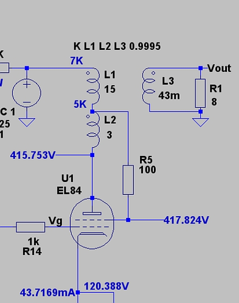

Just the pentode model, but you can use it with an UL OPT or VCVS to get the UL curves.

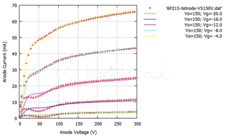

hi all,
Here are some models I developed with ExtractModel for the 6P21S tetrode with some feedback from Derk regarding issues on the tool which fixed yesterday.
6P21S tetrode curves and model | Bartola Valves
There is also a quick test of the Schade feedback trace mode which I insisted Ronald for quite a while and helped implementing 🙂
Cheers
Ale
Cheers
Ale
hi all,
The model generated curves do not match up with the datasheet when Eg2=200V. Shouldn't the model itself scale up/down when different Eg2 is applied?
Jaz, the model matches the curves traced. I have several 6P21S around but didn't pay too much attention on the sample variance. The model scales up/down with different Ug2, see the other graphs at different Ug2 (i.e. model versus traced):
Ale
Ale
Ale
Like you said, it could be just due to the wide sample variance... I have asked about this before, but shouldn't the traced models be re-adjusted to matched the commonly available datasheets, i.e., a "bogey" tube? Otherwise, we run the risk of having a bunch of "one-off" models, which may cause some confusion for those that aren't aware of the origins of those models. Sorry to sound like a broken record...😛
I should have aimed to find a valve that matched closer to the datasheet. I may do that and rerun in future but don't have too much time unfortunately. At least here is a model that is within the specs. I'm fine with the variance and can work with this on my simulations 🙂
I think a built-in "fudge" factor in Extract Model would do the trick, i.e., trace any tube on hand, then bring the model in line with the datasheet "bogey" with a bit of fudging et voila, you got a well matched model...😛I should have aimed to find a valve that matched closer to the datasheet. I may do that and rerun in future but don't have too much time unfortunately. At least here is a model that is within the specs. I'm fine with the variance and can work with this on my simulations 🙂
I'm sure you will put in the good word, I don't even have the uTracer yet 🙁That would be nice. Perhaps something to suggest to Derk?
