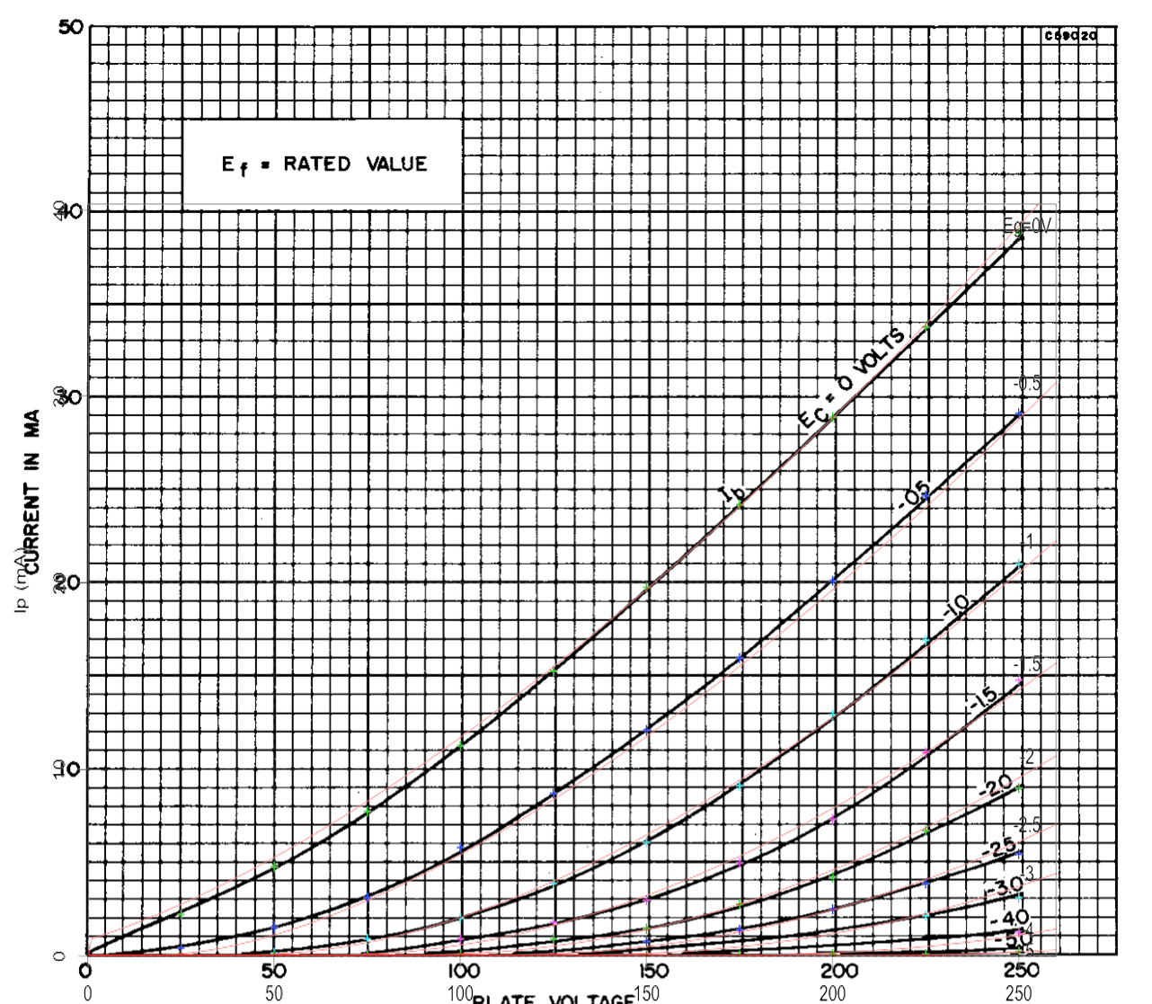

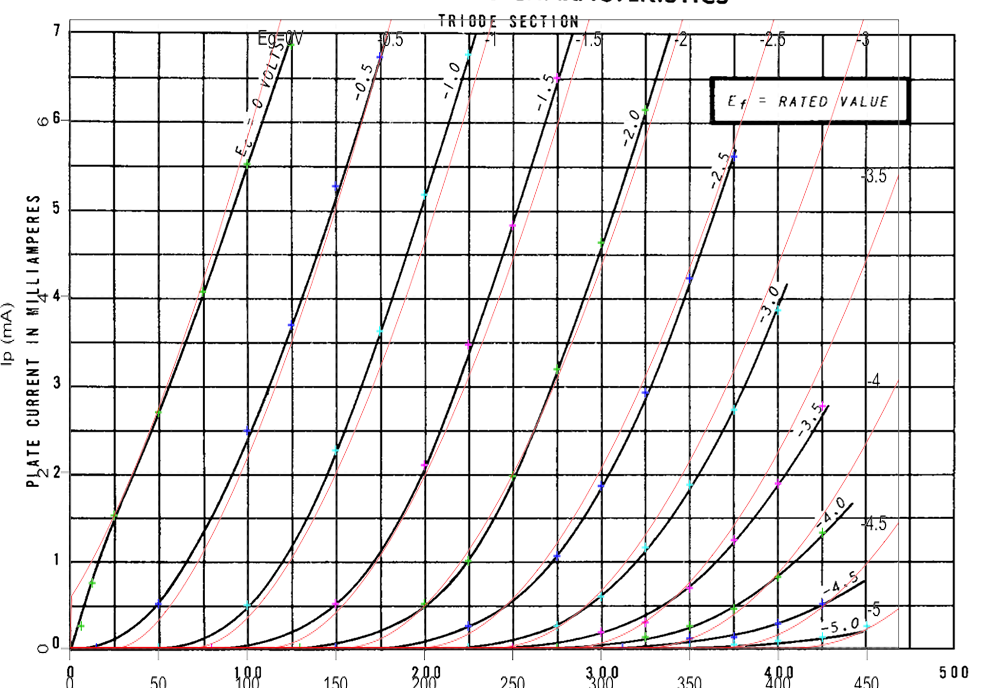

I've created a model for the triode of the 6KT8.
Could anyone create a model for the pentode? I can't get the knee sharp enough with Ayumi's method.
Code:
* Generic triode model: 6KT8-Triode
* Copyright 2003--2008 by Ayumi Nakabayashi, All rights reserved.
* Version 3.10, Generated on Tue Jul 29 15:14:00 2014
* Plate
* | Grid
* | | Cathode
.SUBCKT 6KT8-Triode A G K
BGG GG 0 V=V(G,K)+0.21127936
BM1 M1 0 V=(0.0039561161*(URAMP(V(A,K))+1e-10))^-0.75363001
BM2 M2 0 V=(0.66559284*(URAMP(V(GG)+URAMP(V(A,K))/84.529157)+1e-10))^2.25363
BP P 0 V=0.0058042243*(URAMP(V(GG)+URAMP(V(A,K))/126.9983)+1e-10)^1.5
BIK IK 0 V=U(V(GG))*V(P)+(1-U(V(GG)))*0.0034550891*V(M1)*V(M2)
BIG IG 0 V=0.0029021122*URAMP(V(G,K))^1.5*(URAMP(V(G,K))/(URAMP(V(A,K))+URAMP(V(G,K)))*1.2+0.4)
BIAK A K I=URAMP(V(IK,IG)-URAMP(V(IK,IG)-(0.0029708017*URAMP(V(A,K))^1.5)))+1e-10*V(A,K)
BIGK G K I=V(IG)
* CAPS
CGA G A 3p
CGK G K 3.2p
CAK A K 1.6p
.ENDS

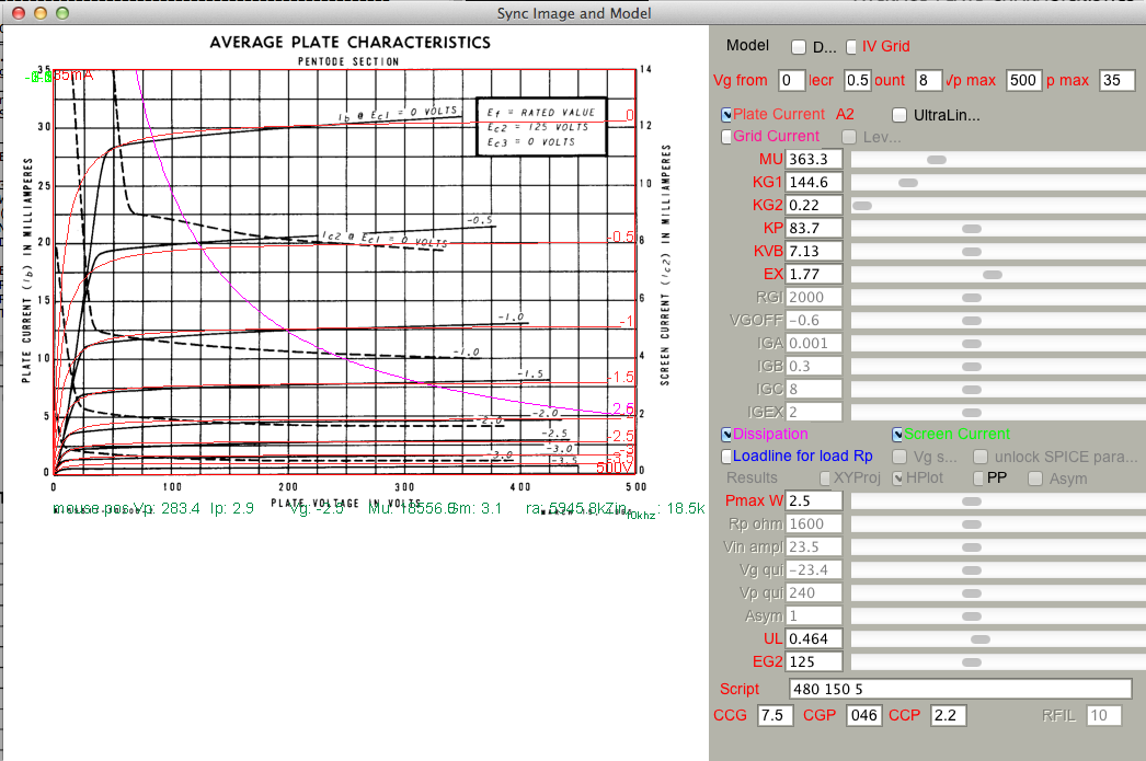

Do you have triode-strapped curves for the pentode section? If not, you can't make the SPICE model using Ayumi's method.I can't get the knee sharp enough with Ayumi's method.
I believe I have a good model for the pentode 6KT8
This first two bias lines aren't exactly on, but I think it looks decent enough (though I'm still pretty new at this so I could be totally wrong.) 😛
Code:
**** 6KT8P ******************************************
* Created on 07/31/2014 13:59 using paint_kit.jar 2.6
* www.dmitrynizh.com/tubeparams_image.htm
* Plate Curves image file: 6KT8P.png
* Data source link:
.SUBCKT PENT_6KT8P 1 2 3 4 ; P G K G2
+ PARAMS: CCG=7.5P CGP=0.046P CCP=2.2P RGI=2000
+ MU=363.3 KG1=144.6 KP=83.7 KVB=7.13 EX=1.77 KG2=0.22
* Vp_MAX=500 Ip_MAX=35 Vg_step=0.5 Vg_start=0 Vg_count=8
* Rp=1600 Vg_ac=23.5 P_max=2.5 Vg_qui=-23.4 Vp_qui=240 UL=0.464 EG2=125
* X_MIN=45 Y_MIN=40 X_SIZE=531 Y_SIZE=370 FSZ_X=1044 FSZ_Y=696 XYGrid=false
* showLoadLine=n showIp=y isDHT=n isPP=n isAsymPP=n isUL=n showDissipLimit=y
* showIg1=n gridLevel2=n isInputSnapped=n
* XYProjections=n harmonicPlot=y harmonics=y
RE1 7 0 1MEG ; DUMMY SO NODE 7 HAS 2 CONNECTIONS
E1 7 0 VALUE= ; E1 BREAKS UP LONG EQUATION FOR G1.
+{V(4,3)/KP*LOG(1+EXP((1/MU+V(2,3)/V(4,3))*KP))}
G1 1 3 VALUE={(PWR(V(7),EX)+PWRS(V(7),EX))/KG1*ATAN(V(1,3)/KVB)}
G2 4 3 VALUE={(EXP(EX*(LOG((V(4,3)/MU)+V(2,3)))))/KG2}
RCP 1 3 1G ; FOR CONVERGENCE
C1 2 3 {CCG} ; CATHODE-GRID 1
C2 1 2 {CGP} ; GRID 1-PLATE
C3 1 3 {CCP} ; CATHODE-PLATE
R1 2 5 {RGI} ; FOR GRID CURRENT
D3 5 3 DX ; FOR GRID CURRENT
.MODEL DX D(IS=1N RS=1 CJO=10PF TT=1N)
.ENDS

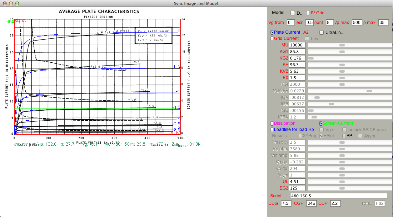

Turns out the model I posted yesterday was actually pretty crappy lol. It didn't simulate in LTSpice at all and I had to tweak the subckt because the nodes didn't match up with the pentode/tetrode symbol I have. The model below is the tweaked one from the LTSpice picture, but I've attached the file that was generated by Paint_Kip if anyone wants to tweak it further.
Code:
* Created on 08/01/2014 09:21 using paint_kit.jar 2.6
* Data source link:
+ MU=10000 KG1=86.8 KP=96.3 KVB=5.63 EX=1.5 KG2=0.176
* Rp=7680 Vg_ac=5.88 P_max=2.5 Vg_qui=-0.292 Vp_qui=204 UL=4.51 EG2=125
* X_MIN=45 Y_MIN=39 X_SIZE=531 Y_SIZE=370 FSZ_X=1254 FSZ_Y=696 XYGrid=false
* showLoadLine=n showIp=n isDHT=n isPP=n isAsymPP=n isUL=n showDissipLimit=n
+{V(2,4)/KP*LOG(1+EXP((1/MU+V(3,4)/V(2,4))*KP))}
G1 1 4 VALUE={(PWR(V(7),EX)+PWRS(V(7),EX))/KG1*ATAN(V(1,4)/KVB)}
G2 2 4 VALUE={(EXP(EX*(LOG((V(2,4)/MU)+V(3,4)))))/KG2}
RCP 1 4 1G ; FOR CONVERGENCE
C1 3 4 {CCG} ; CATHODE-GRID 1
C2 1 3 {CGP} ; GRID 1-PLATE
C3 1 4 {CCP} ; CATHODE-PLATE
R1 3 5 {RGI} ; FOR GRID CURRENT
D3 5 4 DX ; FOR GRID CURRENT
.ENDS
Besides the screen current this new model seems to be a keeper. 😀

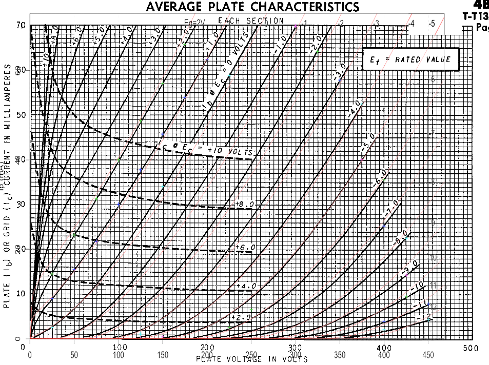

6ER5 Triode
Code:
* Generic triode model: 6ER5
* Version 3.10, Generated on Fri Aug 1 15:09:59 2014
* Plate
* | Grid
* | | Cathode
.SUBCKT 6ER5 A G K
BGG GG 0 V=V(G,K)+0.20684562
BM1 M1 0 V=(0.017253359*(URAMP(V(A,K))+1e-10))^-2.6665979
BM2 M2 0 V=(0.36000594*(URAMP(V(GG)+URAMP(V(A,K))/37.093881)+1e-10))^4.1665979
BP P 0 V=0.0091669979*(URAMP(V(GG)+URAMP(V(A,K))/103.03686)+1e-10)^1.5
BIK IK 0 V=U(V(GG))*V(P)+(1-U(V(GG)))*0.042512831*V(M1)*V(M2)
BIG IG 0 V=0.004583499*URAMP(V(G,K))^1.5*(URAMP(V(G,K))/(URAMP(V(A,K))+URAMP(V(G,K)))*1.2+0.4)
BIAK A K I=URAMP(V(IK,IG)-URAMP(V(IK,IG)-(0.0047172745*URAMP(V(A,K))^1.5)))+1e-10*V(A,K)
BIGK G K I=V(IG)
* CAPS
CGA G A 0.38p
CGK G K 4.4p
CAK A K 3p
.ENDS
6BS8
Code:
* Generic triode model: 6BS8
* Version 3.10, Generated on Fri Aug 1 16:29:30 2014
* Plate
* | Grid
* | | Cathode
.SUBCKT 6BS8 A G K
BGG GG 0 V=V(G,K)+0.1396991
BM1 M1 0 V=(0.010461639*(URAMP(V(A,K))+1e-10))^-0.68684648
BM2 M2 0 V=(0.6859192*(URAMP(V(GG)+URAMP(V(A,K))/30.02214)+1e-10))^2.1868465
BP P 0 V=0.0046594327*(URAMP(V(GG)+URAMP(V(A,K))/43.769207)+1e-10)^1.5
BIK IK 0 V=U(V(GG))*V(P)+(1-U(V(GG)))*0.0027247899*V(M1)*V(M2)
BIG IG 0 V=0.0023297163*URAMP(V(G,K))^1.5*(URAMP(V(G,K))/(URAMP(V(A,K))+URAMP(V(G,K)))*1.2+0.4)
BIAK A K I=URAMP(V(IK,IG)-URAMP(V(IK,IG)-(0.0024903068*URAMP(V(A,K))^1.5)))+1e-10*V(A,K)
BIGK G K I=V(IG)
* CAPS
CGA G A 1.15p
CGK G K 2.6p
CAK A K 1.3p
.ENDS
