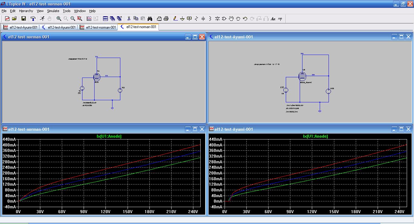

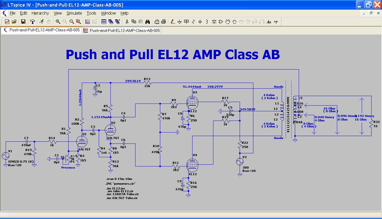

My setup would be something like below
I tied to simulate with the Ayumi model but this is not workin
I changed the ^ into ** but no luck
I made a model according to Koren models and this seems to work

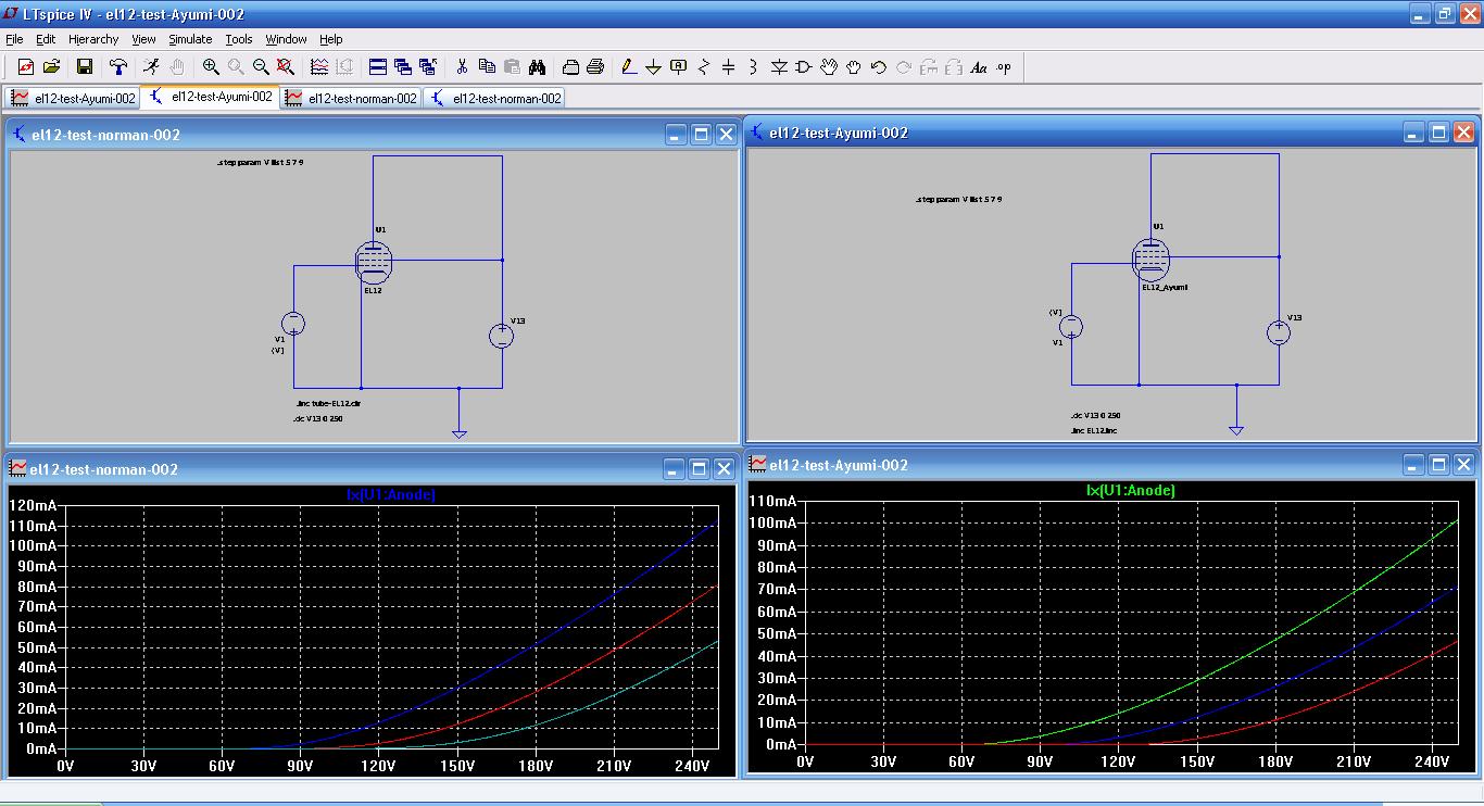

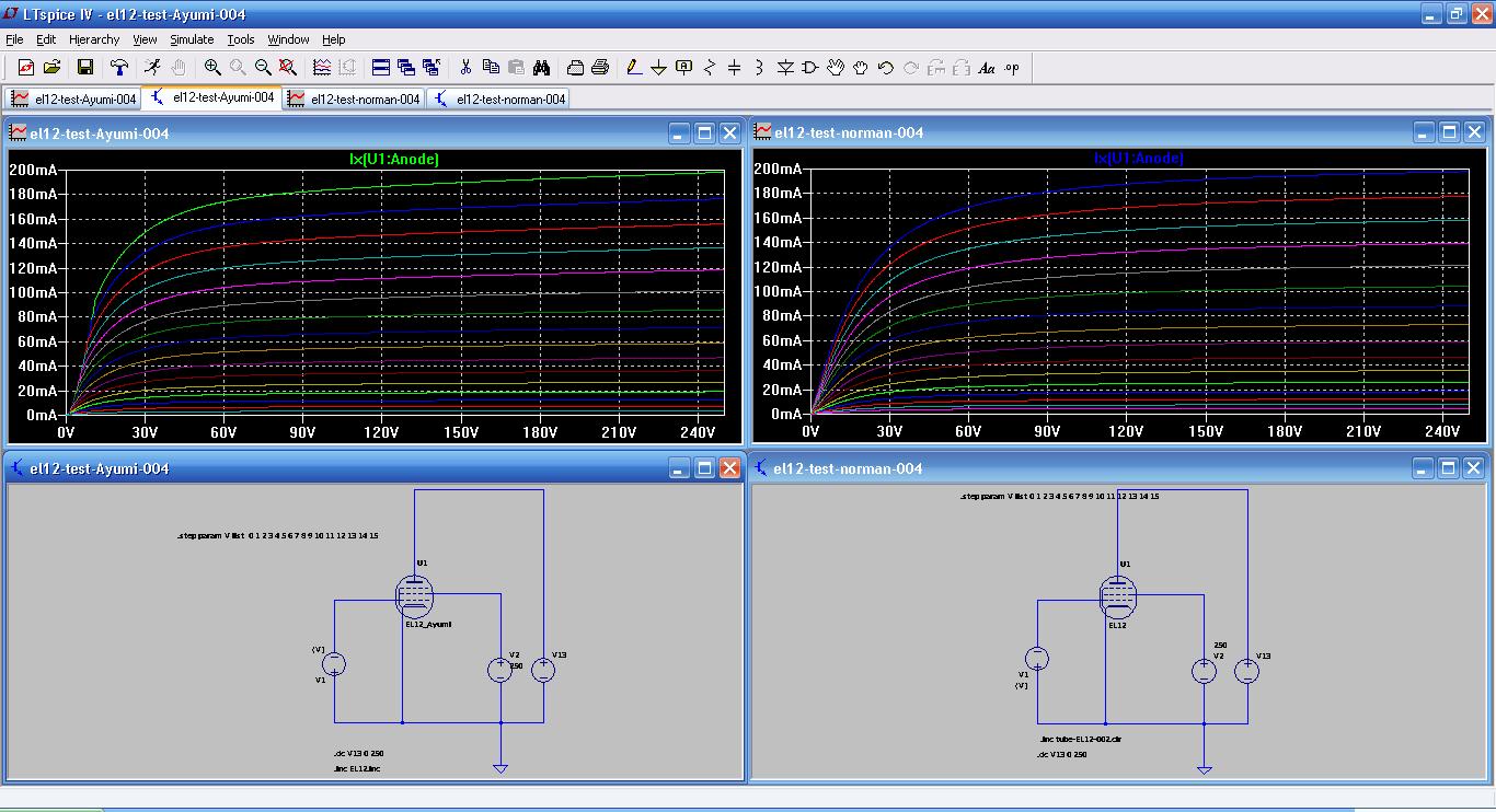

Ayumi's model works fine in LTSpice... while the EL12 Koren model you posted seems to deviate from the datasheet quite a bit.😕
Try the tests with Eg2=250V, then you can see Ayumi's model is more accurate than Koren's (which is usually the case).
I'm sorry but it is still quite a bit off from the datasheet (particularly the upper traces), for comparison Koren's model on the left and Ayumi's model on the right:

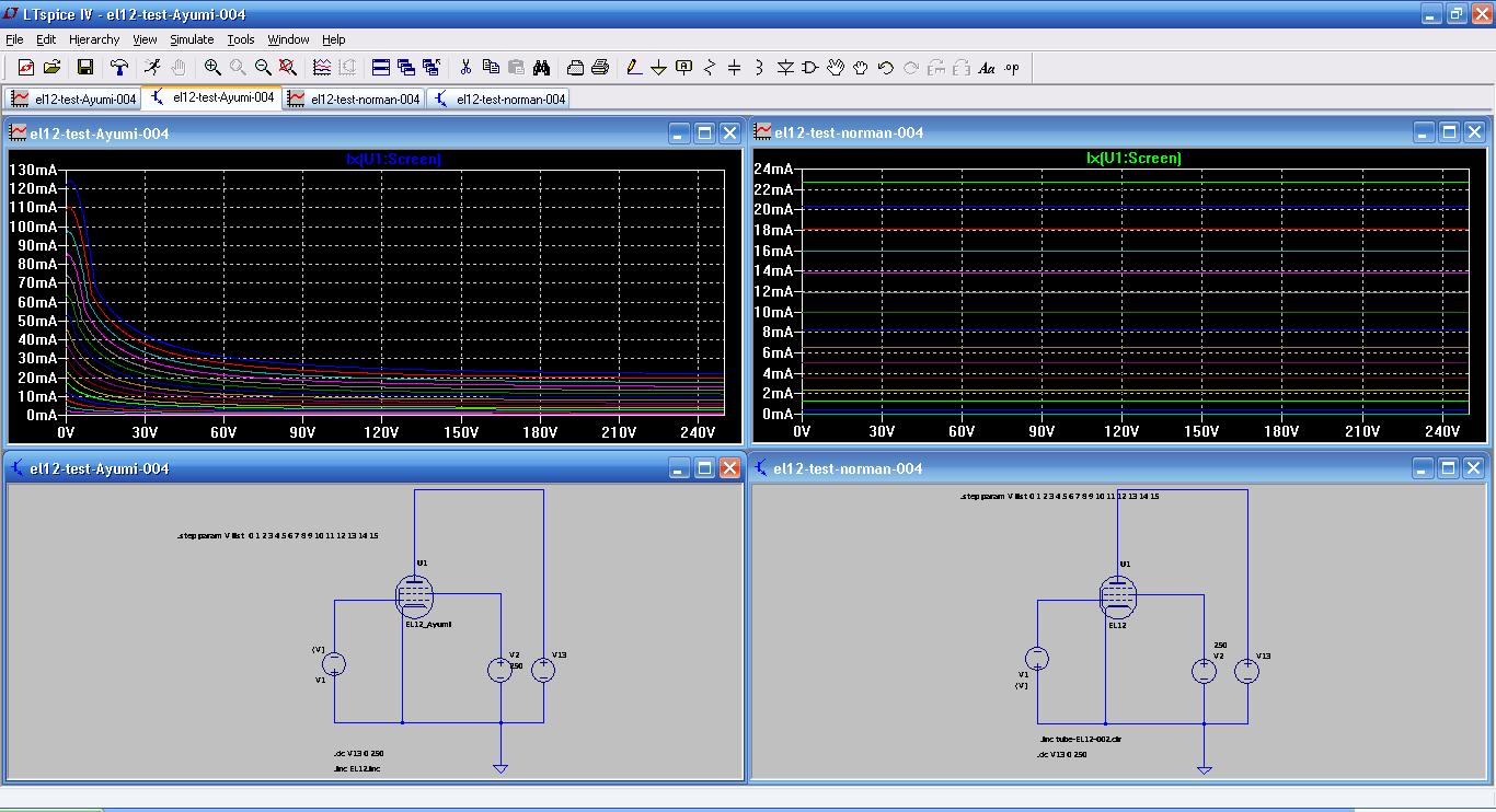

I dit found out somthing else when you look at the G2 they react different
while the Norman models react liniar the Ayumi is not.

Sorry to sound like a broken record, but the screen current is poorly modeled using the Koren method. It could be improved, please refer to Dr. Gurskii's article in AA (just a bit better) or Dr. Reefman's improved methodology (great improvement), which requires the uTracer to really take advantage of it.

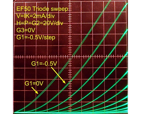

Is there any reason why the triode models would fail to work in inverted triode circuits? The generic TRIODENH model works fine, but my specific tube models fail miserably.
