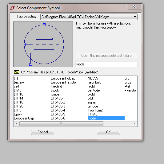

Sorry to bother you all again. But if I copy the above code how do I convert it to a spice model? I know nothing about computer programming. I'm assuming I must paste it into a particular type of file?
From what I can glean from spice help I need to use an existing triode symbol. Then edit that and insert the above .subckt text. But when I try the triode models I have say they can't be edited? Is there a generic triode model/symbol?
Unless you add that subckt to your existing library and add a triode ASY file named ECC99 you will need to use the .inc command and rename the subckt file as an .inc file.. You cannot edit or modify the symbol or file associated with it from the simulator directly.
