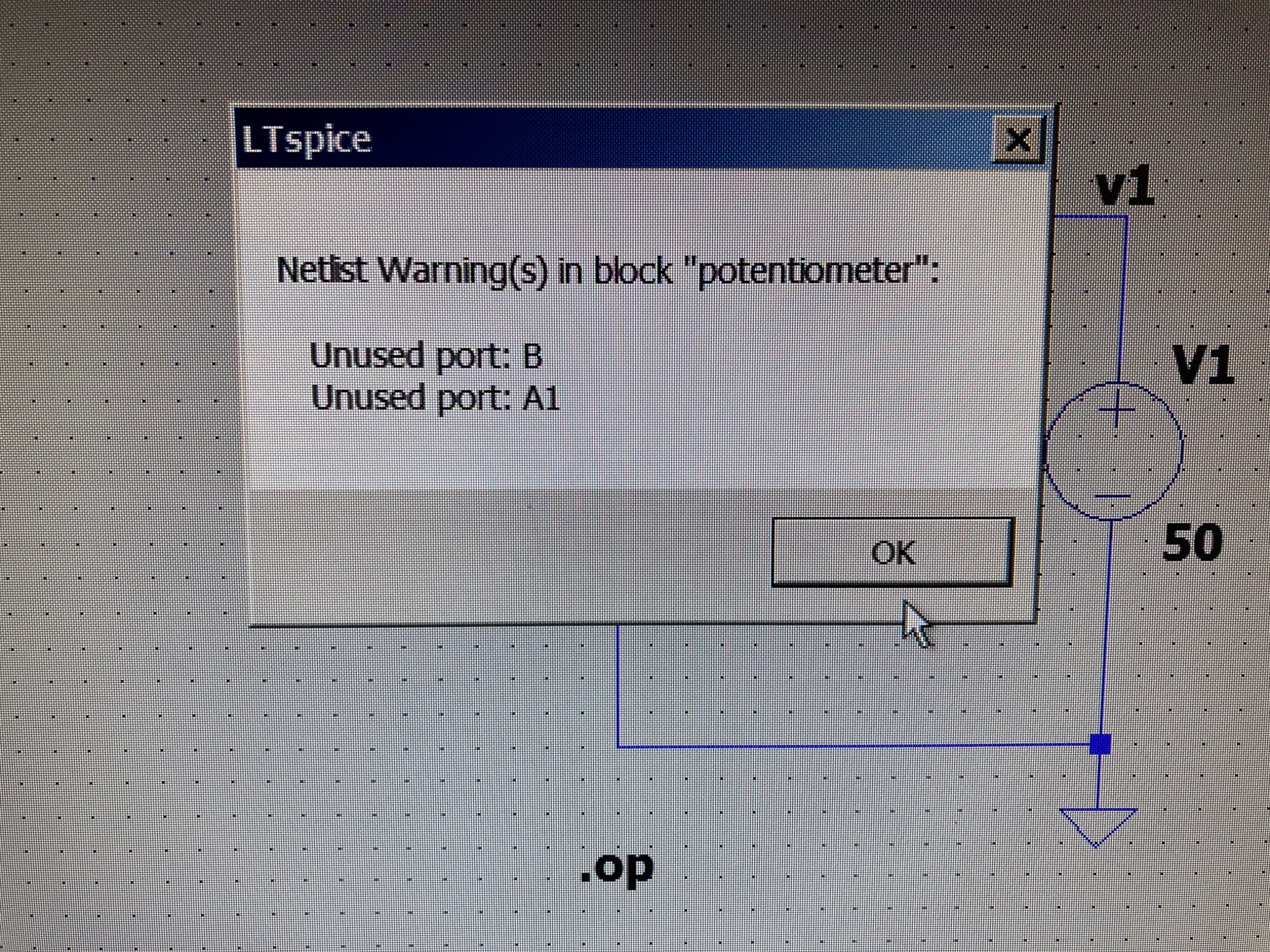

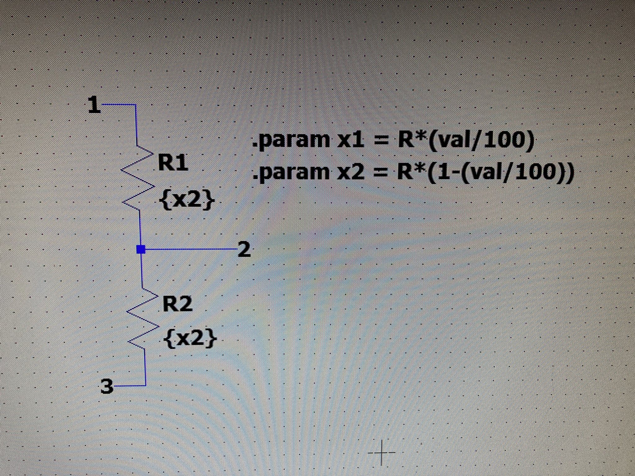

I looked, though not finding, a source for potentiometers. I followed the instructions, but...
Here are the original formulas, suspect where the fault is as all the nodes are connected in the above test circuit.

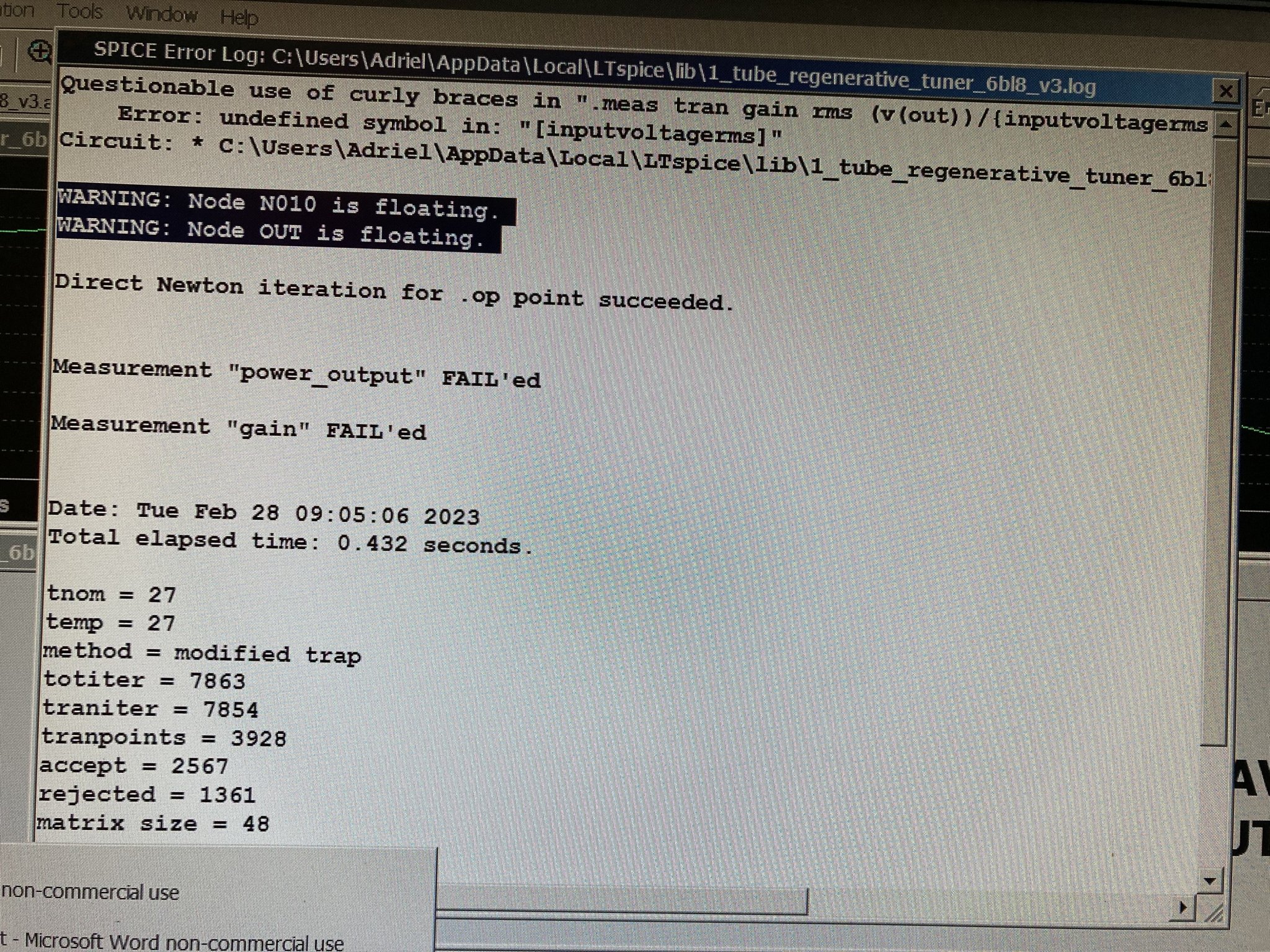

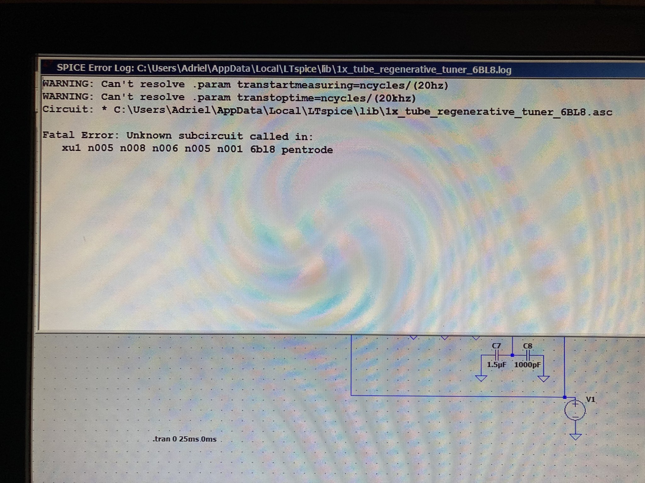

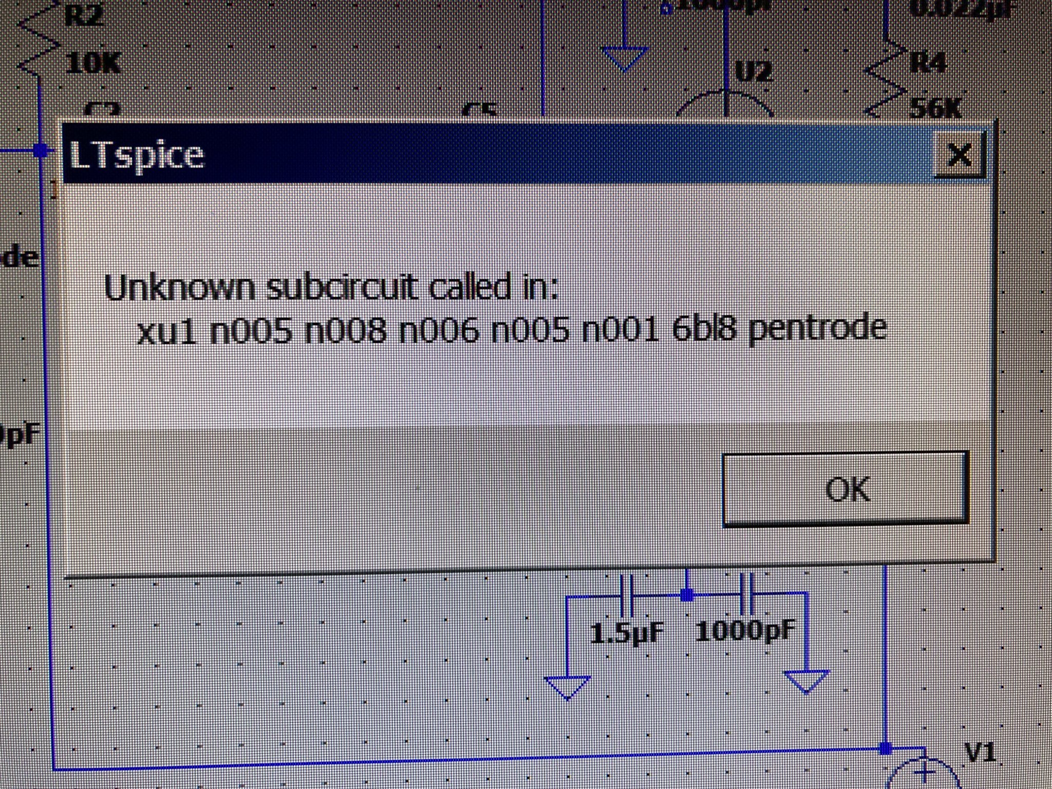

Tried placing a tube from scratch, rather than copy and paste (diagram on the schematic didn't match what a previous model had), and seems made a mistake. How do I fix this, please?

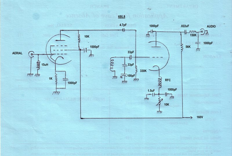

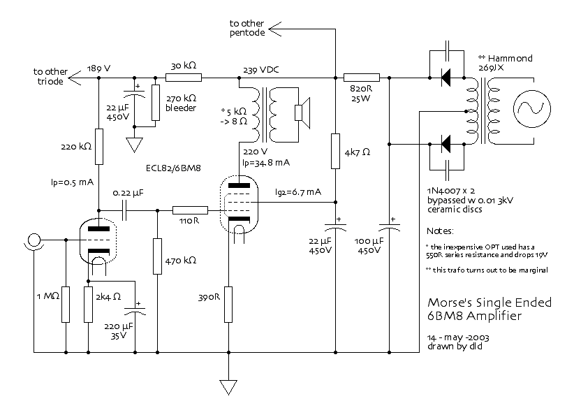

In case helps, here is the schematic (not mine). Used this because super simple and only one tube, was concerned about my ability.

SPICE models are just text files. As such, these files often have a .txt extension, although you'll see others like .sub for subcircuit, .lib for a library file, etc. The forum doesn't allow uploading files with certain extensions so it's common for a lot of model files uploaded here to carry the .txt extension.
To attach these files to your schematic you need to "include" them in your .asc file. This is just a matter of adding a statement like ".inc model.txt" somewhere on the schematic. Then store this model file in the same folder as your .asc file so that LTspice can find it. There are other locations that will work but if you are just starting out with LTspice it might be best to keep things simple at first.

Can they be in the folder with the schematic of the circuit? I am unable to open the tube directory as a .mdb file extension.To attach these files to your schematic you need to "include" them in your .asc file.
You mean a Spice directive?This is just a matter of adding a statement like ".inc model.txt"

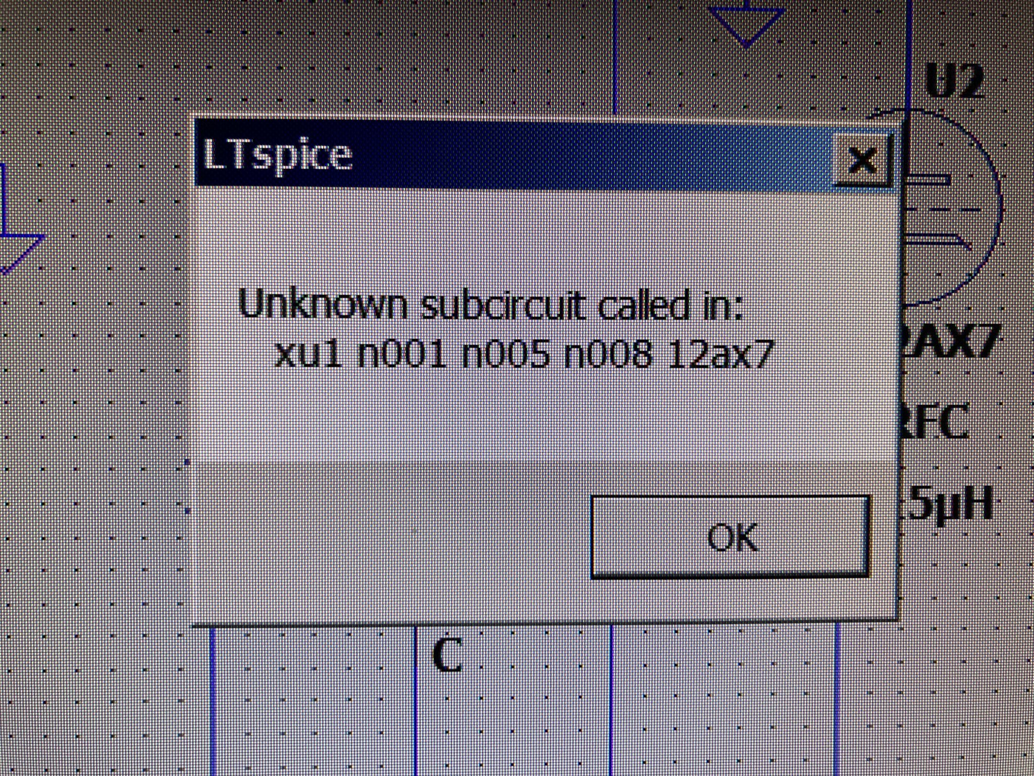

Still have the bug even with tubes that work fine in the schematics José (@jcalvarez ) generously gave me, so something other then the individual tube (successfully tube rolled in other schematics).I hope this helps a little.
Yes, I believe I said that in my post.Can they be in the folder with the schematic of the circuit? I am unable to open the tube directory as a .mdb file extension.
Yes, an .inc statement is a SPICE directive.You mean a Spice directive?
I don't understand the question. If you have an appropriate tube SPICE model which is in the same folder as the schematic file, and have "included" it in the schematic, LTspice will be able to use it.Still have the bug even with tubes that work fine in the schematics José (@jcalvarez ) generously gave me, so something other then the individual tube (successfully tube rolled in other schematics).
To offer any more help, we will need to see both your .asc file and your tube models, as Sorento pointed out.

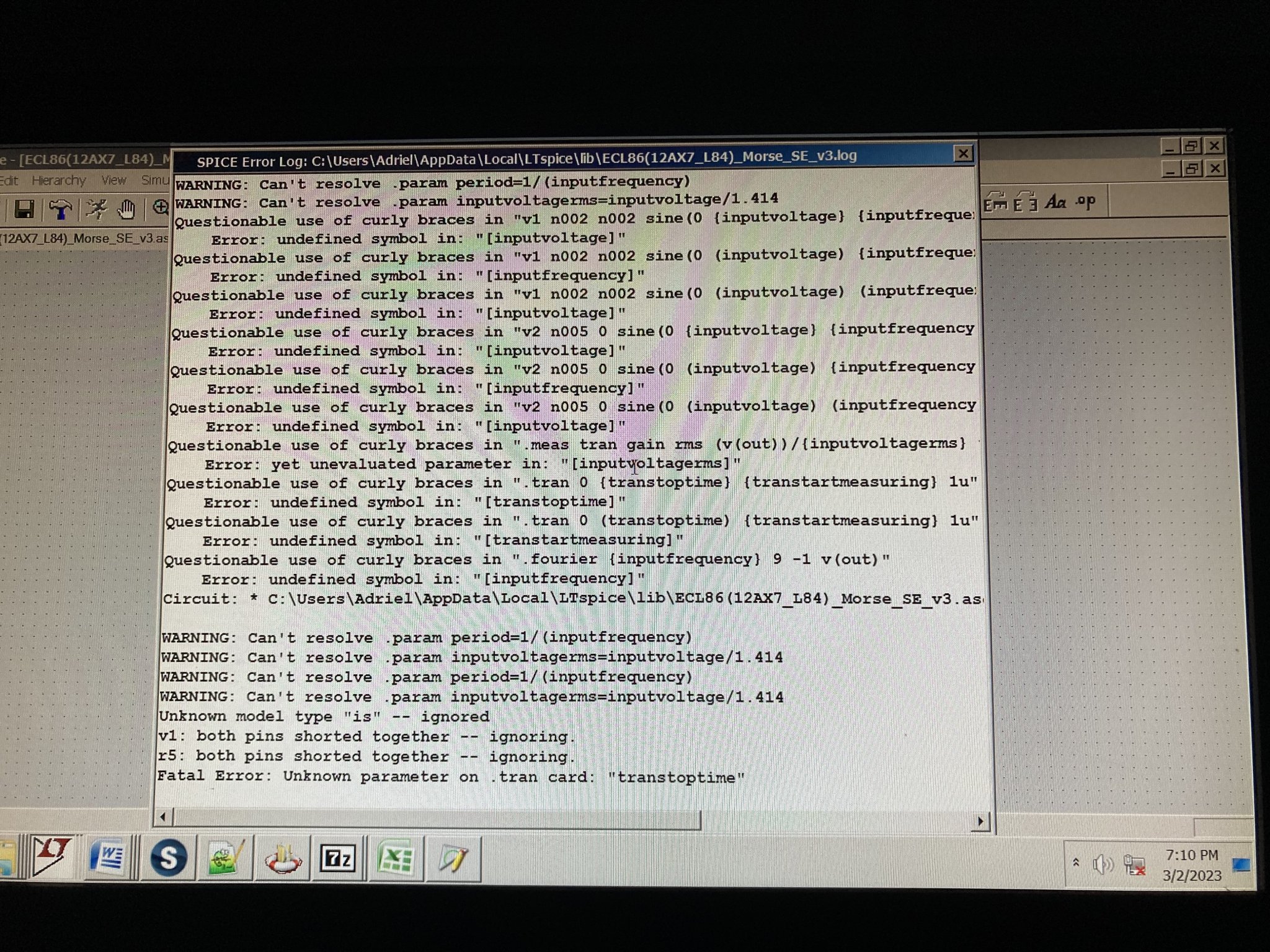

I apparently forgot the picture, though the same error as above.
I could change tubes, with the .inc statement, until I was blue in the face and get the same error.

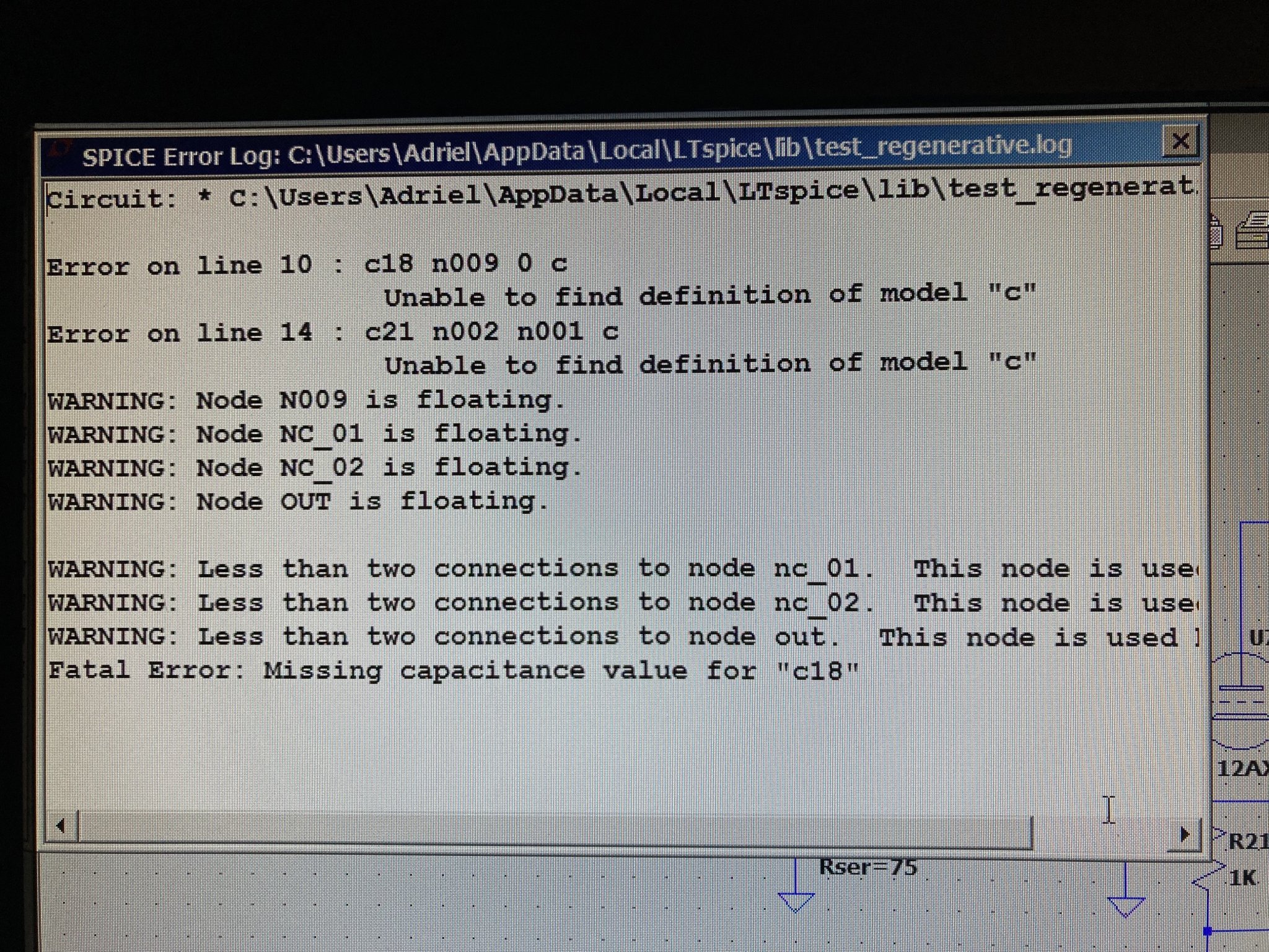

Had an idea to copy and paste it into the working file and turns out the file is corrupted as now not getting the tube error message, just this.
Just hit me to use Google Drive, duh. https://drive.google.com/drive/folders/1eMlMXz1M48sJj-likAcRgOdKwL_cz5LW?usp=share_link
Included all three corrupted schematics to demonstrate the error has continued with each save as.

I have edited asc so it runs without errors. In order for receiver to work you need to mutual coupled inductors using K statement (K1 L1 L2 0.9) with a suitable coupling factor. So that will make it regenerative that radiate at certain frequency you can actual pickup by radio. If you can point to website that explain how it works we may help with you more.
Found it: https://www.cool386.com/12v_6BL8/12v_6BL8.html

Interestingly it corrupted in the file transfer, though still runs.I have edited asc so it runs without errors.
I would love to know what "floating" means, please. We have had this before and puzzling as the wires are all connected, no floating in my understanding of the word.

Incorrect, it is the 160 volt version: https://www.cool386.com/6BL8_srrx/6BL8_srrx.html.

This seems to be working, no errors generated. There is also a model done in 2013, post number 5 which didn't use.This model is traced by me using CurveCaptor, Koren8 model, pretty close, maybe you like to use it, there is more than one way to get the model, included also the marker and data file for reference.

Here is the website and no, I don't speak French (few words of manners I somehow learned): https://sites.google.com/site/france5ndl/recepteur-a-reaction.

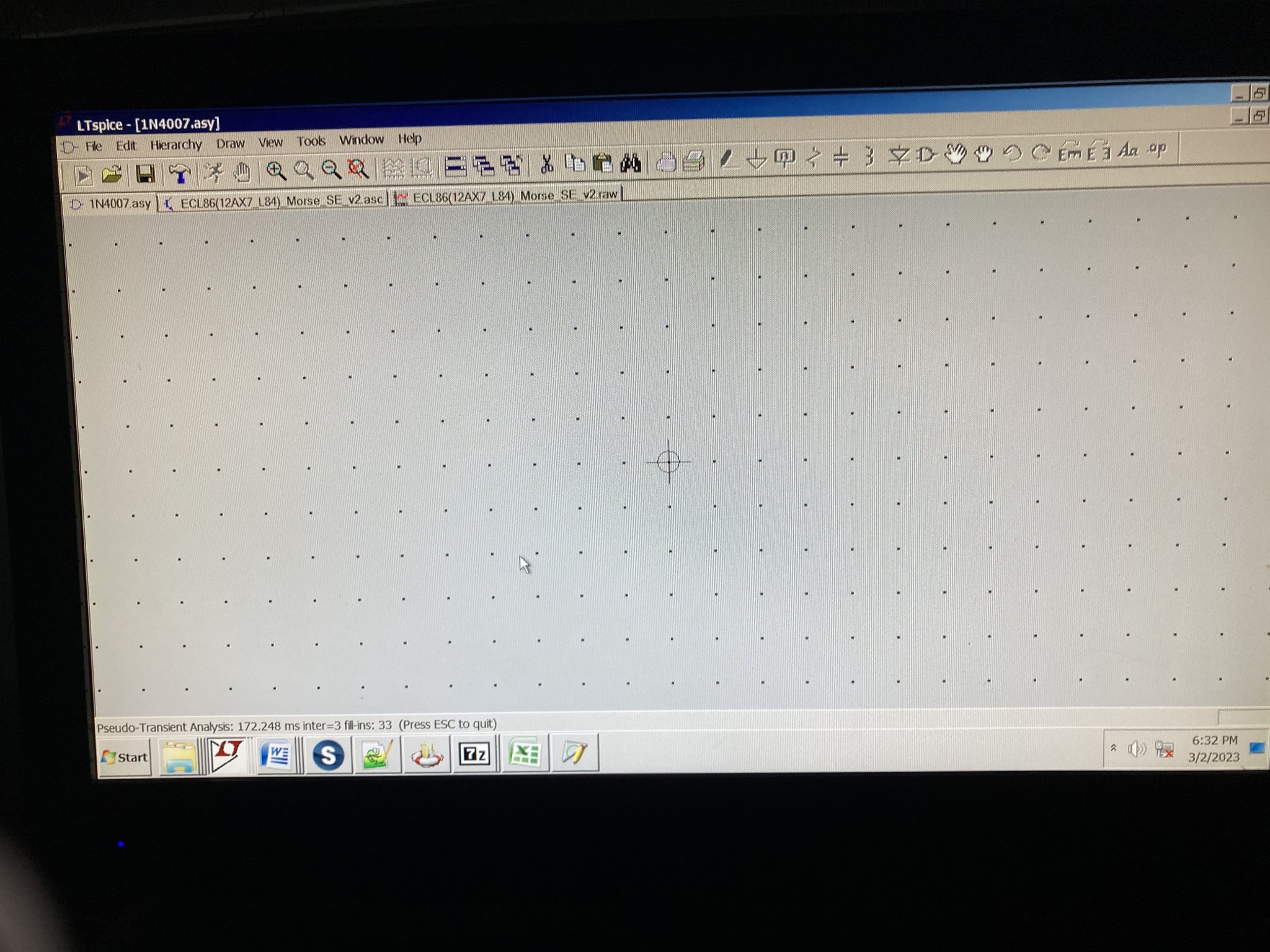

Why are 1N4007 diodes not in the list under diodes? Are they not common?
Additionally, tried to find the file to add the 1N4007, however, both hidden in the interface and in file explorer.
Also, tried inserting a diode, labeling it with the model script, added the model script, however generates an error code saying can't find "D." Tried several times to edit the script and make it happy to no avail.
The reason I was doing it this way as the .asy file of the 1N4007 degenerated.
And not showing up when selected.
Since present a significant challenge, is there a direct equivalent to use in LTSpice to achieve an accurate model?
In case matters, attaching the .asc file along with the schematic. This is a schematic that was provided and modified to a Morse SE.
I warn those who attempt to run the file (it is only included to show the diode situation) there are a few errors.
