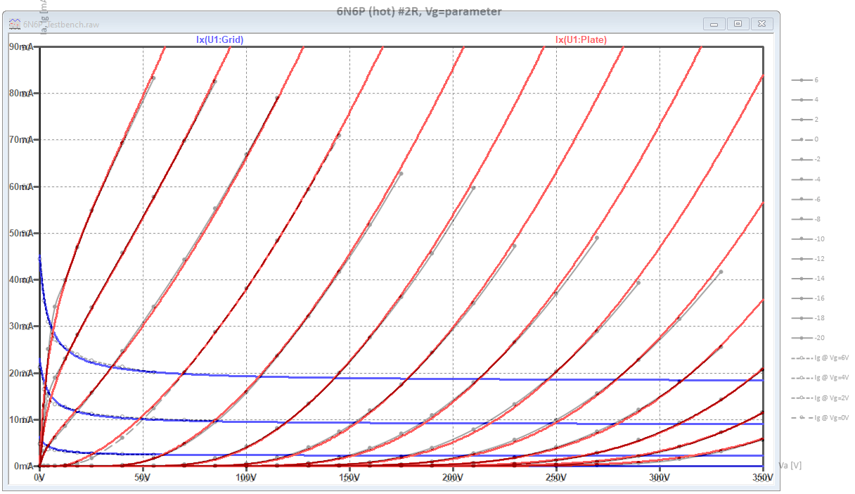

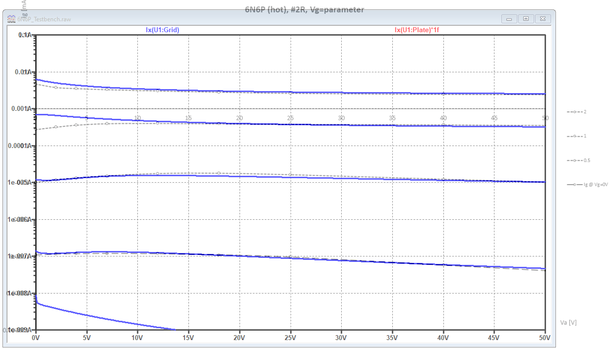

It took some days due to heavily limited free time, but now I coped to create a new version of the 6N6P. I repeated also the measurements, this time with hot plate, as I have learned that triodes sometimes show different curves when hot.
But the 6N6P seems to be a very good construction - there was almost no difference between hot and cold tube.
BR Adrian

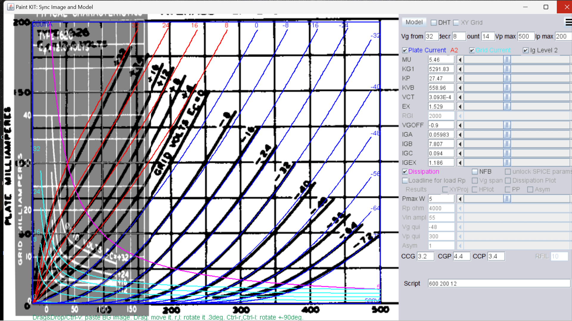

https://www.dmitrynizh.com/tubeparams_image.htm
Due to my lack of a tool similar to Dmitry's (but with my model behind), I overlay the measured curves as a half-transparent picture over the curves generated in LTspice. As you can imagine, this workflow is as convenient as landing the Apollo Lunar Module on the moon! 🙄 So, If you can live without g1 grid current, better try it with the Model Paint Tool.

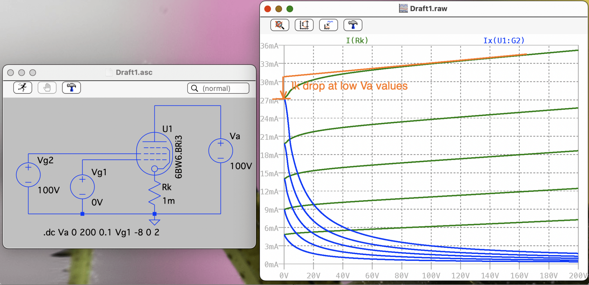

Hi @Adrian Immler
Thanks for the reply, I have just been trying your 6BW6 in LtSpice, it looks very close to these specs http://www.r-type.org/pdfs/6bw6.pdf
I have noticed the screen grid current is different when Va < 15. I see a kink upward in the Screen current (green) and it crosses the axis at 95mA where the data sheet is at 60mA. Would this be due to what you call the "Va independable ig2 part"?

Nice observation that the 6N6P measures very nearly the same heated up as when just powered on. I've been using this double triode for at least 10 years now, and it's always worked well in circuits. I think it's a good one.
Just tried out the new 6N6P.i6 model in a few simulations that had convergence problems with the i4 model, and the problems are now gone. 👍
Hi AdrianRHi @Adrian Immler
No, this is something different. For tetrodes/pentodes, the total amount of emitted current is somehow "constant" for a given g2 voltage, especially for signal pentodes. Derk Reefman used this law for his pentode models. However, some pentodes differ from that rule at very low Va values: The cathode current drops short before Va approaches zero. This Ik drop effect is also present in triodes.
My models, for triodes as well as for pentodes, are able to mimic this Ik drop effect up to a certain amount only. If the effect is too strong, and I would force the model to mimic that in full amount, the model would suffer under convergence issues. Something I want to avoid! That is why the 6BW6 model shows a deviation for Ig2 at very low Va values.
BR Adrian

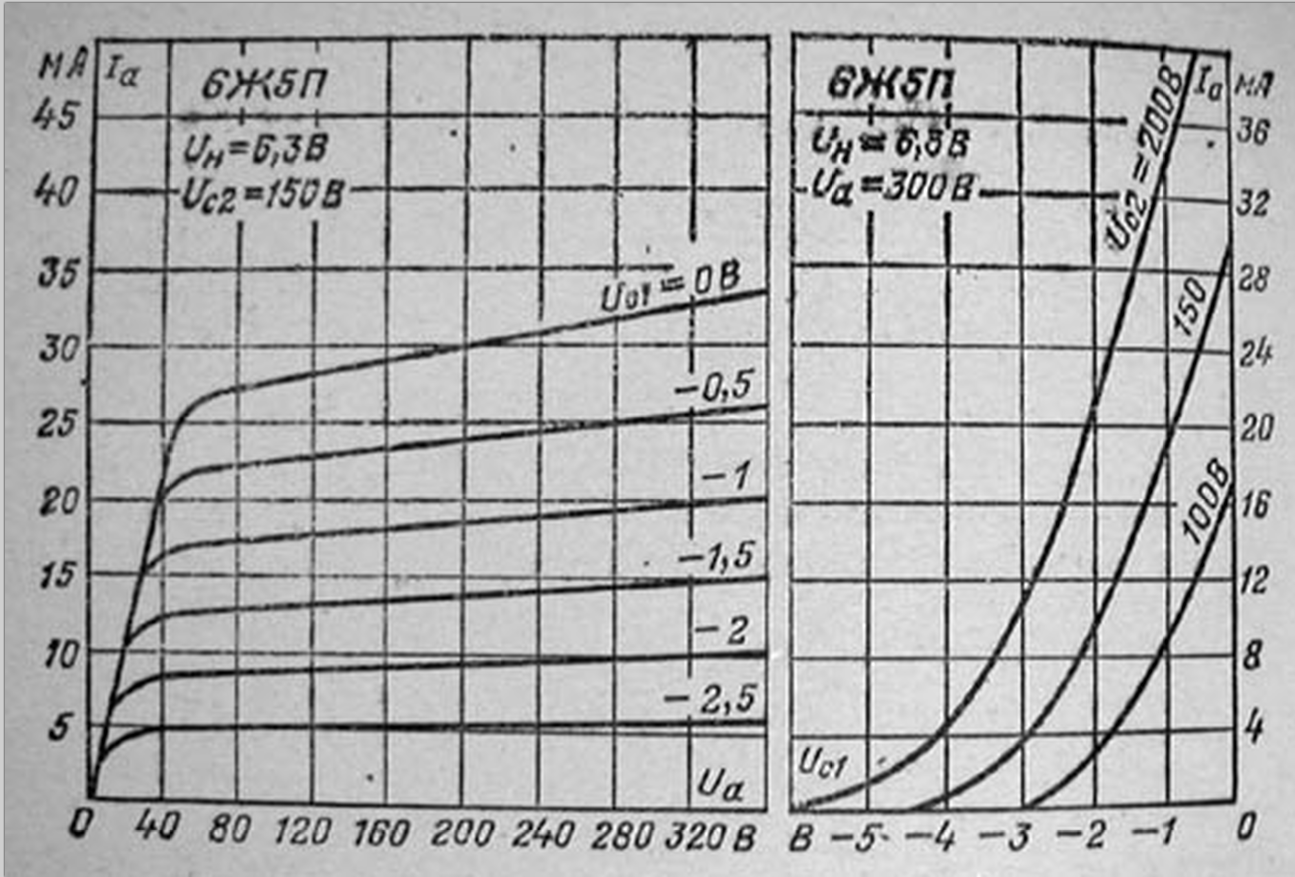

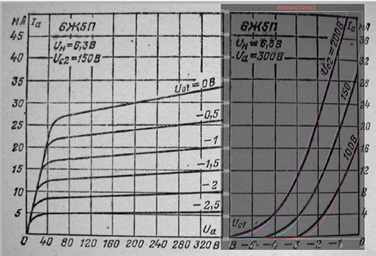

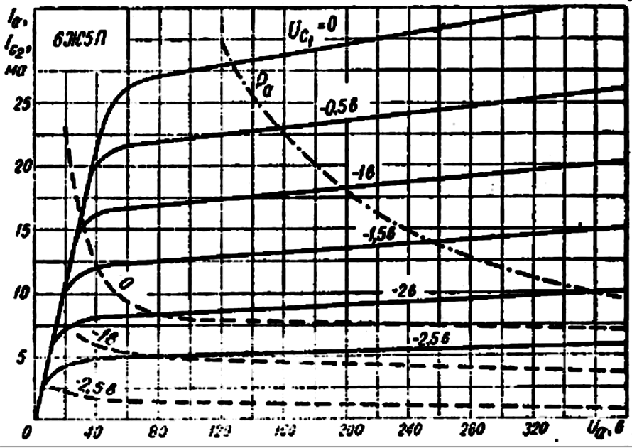

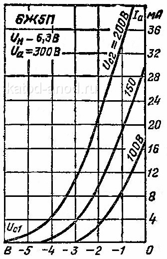

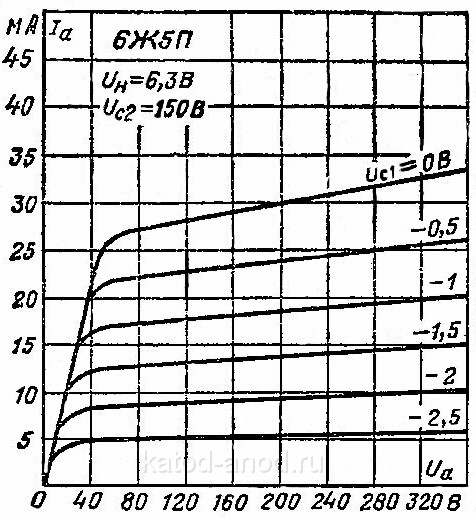

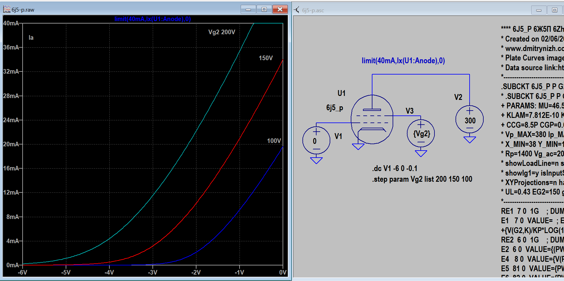

Try this model:
Code:
**** 6J5_P 6Ж5П 6Zh5P ******************************************
* Created on 02/06/2023 16:16 using paint_kip.jar
* www.dmitrynizh.com/tubeparams_image.htm
* Plate Curves image file: 6J5-P.png
* Data source link:https://voltradio.ru/6zh5p
.SUBCKT 6J5_P P G2 G K ; LTSpice tetrode.asy pinout
* .SUBCKT 6J5_P P G K G2 ; Koren Pentode Pspice pinout
+ PARAMS: MU=46.57 KG1=606.96 KP=267.79 KVB=1039.94 VCT=0.0987 EX=1.4 KG2=715.36 KNEE=1 KVC=2.179
+ KLAM=7.812E-10 KLAMG=7.546E-4 KD=51.39 KC=0.0035 KR1=0.1939 KR2=0.00992 KVBG=0.2112 KB1=0.1375 KB2=1.96 KB3=2 KB4=0.74 KVBGI=2.734E-7 KNK=-0.06776 KNG=0.006 KNPL=50 KNSL=11 KNPR=120 KNSR=29
+ CCG=8.5P CGP=0.03P CCP=2.2P VGOFF=-0.6 IGA=0.001 IGB=0.3 IGC=8 IGEX=2
* Vp_MAX=380 Ip_MAX=35 Vg_step=1 Vg_start=0 Vg_count=9
* X_MIN=38 Y_MIN=12 X_SIZE=835 Y_SIZE=578 FSZ_X=1296 FSZ_Y=736 XYGrid=true
* Rp=1400 Vg_ac=20 P_max=3.8 Vg_qui=-4 Vp_qui=300
* showLoadLine=n showIp=y isDHP=n isPP=n isAsymPP=n isUL=n showDissipLimit=y
* showIg1=y isInputSnapped=y addLocalNFB=n
* XYProjections=n harmonicPlot=y dissipPlot=n
* UL=0.43 EG2=150 gridLevel2=y addKink=y isTanhKnee=n advSigmoid=y

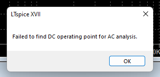

I'm having trouble using this model.Try this model:
Code:**** 6J5_P 6Ж5П 6Zh5P ****************************************** * Created on 02/06/2023 16:16 using paint_kip.jar * www.dmitrynizh.com/tubeparams_image.htm * Plate Curves image file: 6J5-P.png * Data source link:https://voltradio.ru/6zh5p *---------------------------------------------------------------------------------- .SUBCKT 6J5_P P G2 G K ; LTSpice tetrode.asy pinout * .SUBCKT 6J5_P P G K G2 ; Koren Pentode Pspice pinout + PARAMS: MU=46.57 KG1=606.96 KP=267.79 KVB=1039.94 VCT=0.0987 EX=1.4 KG2=715.36 KNEE=1 KVC=2.179 + KLAM=7.812E-10 KLAMG=7.546E-4 KD=51.39 KC=0.0035 KR1=0.1939 KR2=0.00992 KVBG=0.2112 KB1=0.1375 KB2=1.96 KB3=2 KB4=0.74 KVBGI=2.734E-7 KNK=-0.06776 KNG=0.006 KNPL=50 KNSL=11 KNPR=120 KNSR=29 + CCG=8.5P CGP=0.03P CCP=2.2P VGOFF=-0.6 IGA=0.001 IGB=0.3 IGC=8 IGEX=2 * Vp_MAX=380 Ip_MAX=35 Vg_step=1 Vg_start=0 Vg_count=9 * X_MIN=38 Y_MIN=12 X_SIZE=835 Y_SIZE=578 FSZ_X=1296 FSZ_Y=736 XYGrid=true * Rp=1400 Vg_ac=20 P_max=3.8 Vg_qui=-4 Vp_qui=300 * showLoadLine=n showIp=y isDHP=n isPP=n isAsymPP=n isUL=n showDissipLimit=y * showIg1=y isInputSnapped=y addLocalNFB=n * XYProjections=n harmonicPlot=y dissipPlot=n * UL=0.43 EG2=150 gridLevel2=y addKink=y isTanhKnee=n advSigmoid=y *---------------------------------------------------------------------------------- RE1 7 0 1G ; DUMMY SO NODE 7 HAS 2 CONNECTIONS E1 7 0 VALUE= ; E1 BREAKS UP LONG EQUATION FOR G1. +{V(G2,K)/KP*LOG(1+EXP((1/MU+(VCT+V(G,K))/SQRT(KVB+V(G2,K)*V(G2,K)))*KP))} RE2 6 0 1G ; DUMMY SO NODE 6 HAS 2 CONNECTIONS E2 6 0 VALUE={(PWR(V(7),EX)+PWRS(V(7),EX))} ; Kg1 times KIT current E4 8 0 VALUE={V(P,K)/KNEE/(KVBGI+V(6)*KVBG)} E5 81 0 VALUE={PWR(V(8),KB1)} E6 82 0 VALUE={PWR(V(8),KB2)} E7 83 0 VALUE={PWR(V(8),KB3)} E8 9 0 VALUE={PWR(1-EXP(-V(81)*(KC+KR1*V(82))/(KD+KR2*V(83))),KB4)*1.5708} RE4 8 0 1 RE5 81 0 1 RE6 82 0 1 RE7 83 0 1 RE8 9 0 1 RE21 21 0 1 E21 21 0 VALUE={V(6)/KG1*V(9)} ; Ip with knee but no slope and no kink RE22 22 0 1 ; E22: kink curr deviation for plate E22 22 0 VALUE={V(21)*LIMIT(KNK-V(G,K)*KNG,0,0.3)*(-ATAN((V(P,K)-KNPL)/KNSL)+ATAN((V(P,K)-KNPR)/KNSR))} G1 P K VALUE={V(21)*(1+KLAMG*V(P,K))+KLAM*V(P,K) + V(22)} G2 G2 K VALUE={V(6)/KG2*(KVC-V(9))/(1+KLAMG*V(P,K)) - V(22)} RCP P K 1G ; FOR CONVERGENCE C1 K G {CCG} ; CATHODE-GRID 1 C2 G P {CGP} ; GRID 1-PLATE C3 K P {CCP} ; CATHODE-PLATE RE23 G 0 1G GG G K VALUE={(IGA+IGB/(IGC+V(P,K)))*(MU/KG1)* +(PWR(V(G,K)-VGOFF,IGEX)+PWRS(V(G,K)-VGOFF,IGEX))} .ENDS *$
I get error:
"Failed to find DC operating point for AC analysis."
I'm using the above code in subcircuit file 6J5P_KW.inc, but with the text "6J5_P" changed to "6J5P", with symbol file 6J5P_KW.asy:

I've attached the .asc to this post so you can see.
If I use the 6J5P Ayumi model the .asc runs to completion. But if I use this new 6J5P model I get the above error. I get the same error if I use your earlier 6AC7 model.
I'm wondering if I'm doing something to produce this failure, and if so, what is that?
I'm running the .ac directive (AC analysis), not a transient analysis.
Thanks!
Thanks.
Look at log you see what LTSpice is hinting, the first 2 options can resolve the following errors, and third is required but with reduce number of (SRC) steps to resolve convergence issue because the knee of pentode curve is sharp when Advance Knee option is used by the Paint Tool, the step can not be to large (big number, smaller steps better but slower). You can set these options permanently in LTSpice-> Tools->Control Panel-Spice.
Even LTSpice said it's (Gmin) successful, you should look at other results such as Fourier THD, is it garbled? Somethings maybe compromised, some accuracies maybe scarified, but far better than getting confusing results. If you have mixed models (AYumi and others) then Gmin will affect Ayumi models I noticed.
Early termination of direct N-R iteration.

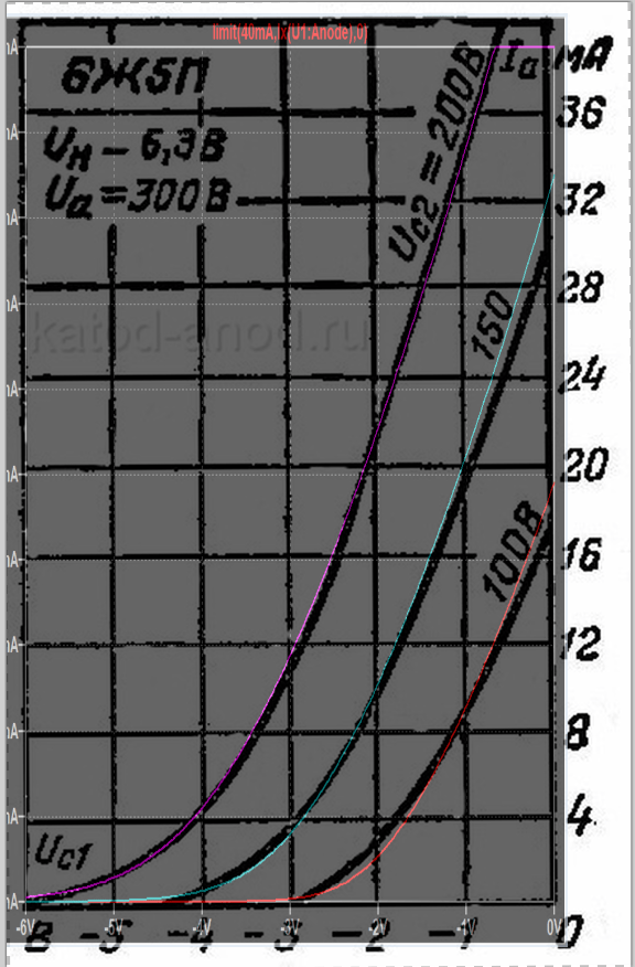

https://katod--anod-ru.translate.go...tr_sl=ru&_x_tr_tl=en&_x_tr_hl=en&_x_tr_pto=sc
These curves are in much better shape.

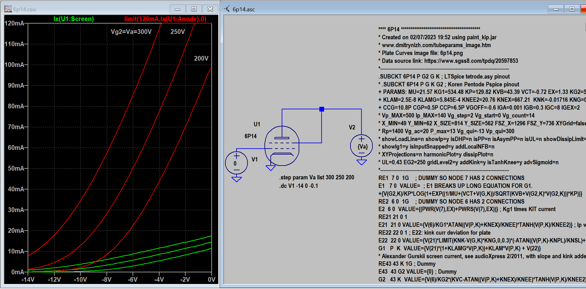

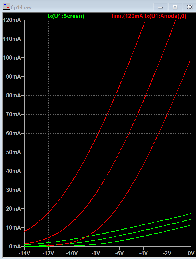

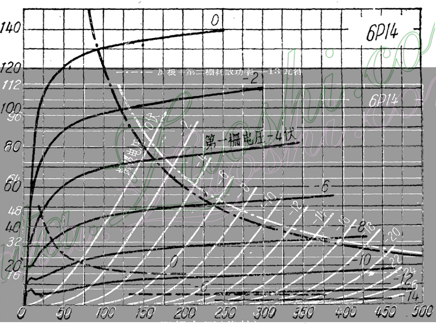

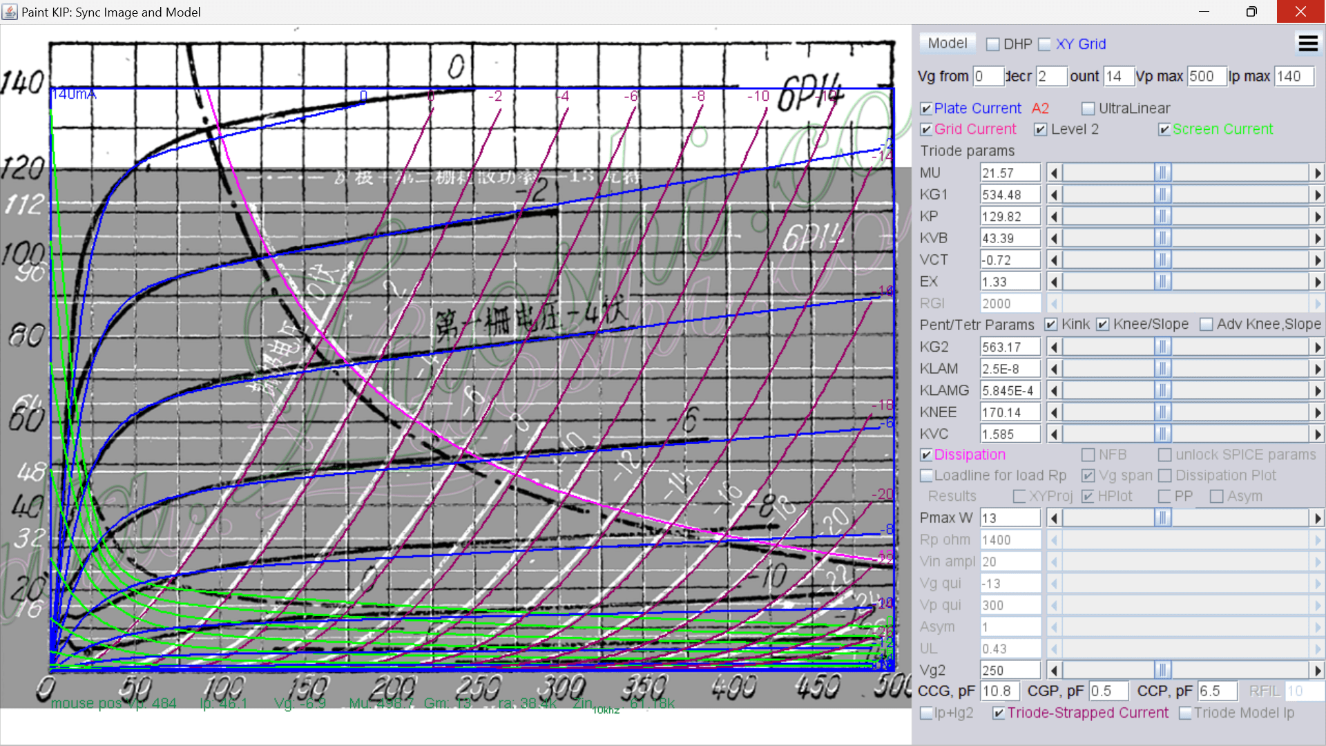

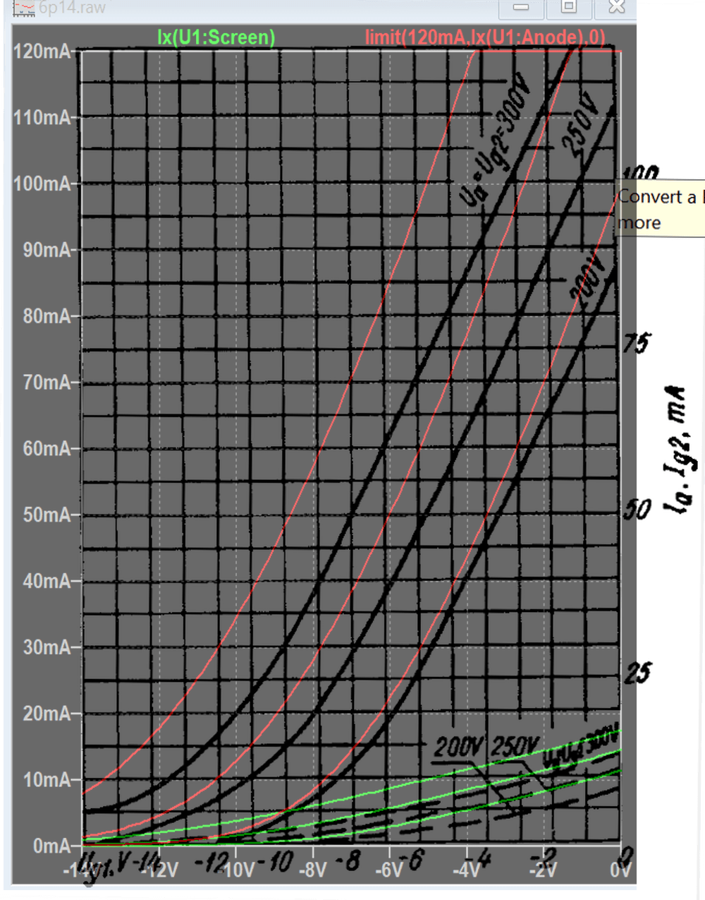

Here is the 6P14 (Chinese ver) pentode model. As no transfer curve is found, it's compared to a Russian's instead:
Code:
**** 6P14 ******************************************
* Created on 02/07/2023 19:52 using paint_kip.jar
* Plate Curves image file: 6p14.png
* Data source link: https://www.sgss8.com/tpdq/20597853
.SUBCKT 6P14 P G2 G K ; LTSpice tetrode.asy pinout
* .SUBCKT 6P14 P G K G2 ; Koren Pentode Pspice pinout
+ PARAMS: MU=21.57 KG1=534.48 KP=129.82 KVB=43.39 VCT=-0.72 EX=1.33 KG2=563.17 KNEE=170.14 KVC=1.585
+ KLAM=2.5E-8 KLAMG=5.845E-4 KNEE2=20.76 KNEX=667.21 KNK=-0.01716 KNG=0.01932 KNPL=0.625 KNSL=0.1375 KNPR=38.4 KNSR=29
+ CCG=10.8P CGP=0.5P CCP=6.5P VGOFF=-0.6 IGA=0.001 IGB=0.3 IGC=8 IGEX=2
* Vp_MAX=500 Ip_MAX=140 Vg_step=2 Vg_start=0 Vg_count=14

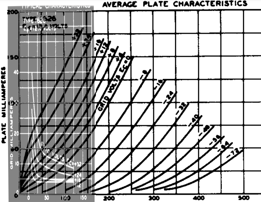

Try this 1626 model:
Code:
**** 1626 ** Advanced Grid Current **********************************
* Created on 02/13/2023 00:27 using paint_kit.jar 3.1
* Plate Curves image file: 1626.png
* Data source link:
.SUBCKT 1626 1 2 3 ; Plate Grid Cathode
+ PARAMS: CCG=3.2P CGP=4.4P CCP=3.4P
+ MU=5.46 KG1=5291.83 KP=27.47 KVB=558.96 VCT=3.093E-4 EX=1.529
+ VGOFF=-0.9 IGA=0.05983 IGB=7.807 IGC=0.094 IGEX=1.186
* Vp_MAX=500 Ip_MAX=200 Vg_step=8 Vg_start=32 Vg_count=14
* Rp=4000 Vg_ac=55 P_max=5 Vg_qui=-48 Vp_qui=300
* X_MIN=65 Y_MIN=18 X_SIZE=778 Y_SIZE=631 FSZ_X=1296 FSZ_Y=736 XYGrid=false
* showLoadLine=n showIp=y isDHT=n isPP=n isAsymPP=n showDissipLimit=y
* showIg1=y gridLevel2=y isInputSnapped=n
* XYProjections=n harmonicPlot=n dissipPlot=n
E1 7 0 VALUE={V(1,3)/KP*LOG(1+EXP(KP*(1/MU+(VCT+V(2,3))/SQRT(KVB+V(1,3)*V(1,3)))))}
RE1 7 0 1G ; TO AVOID FLOATING NODES
G1 1 3 VALUE={(PWR(V(7),EX)+PWRS(V(7),EX))/KG1}
RCP 1 3 1G ; TO AVOID FLOATING NODES
C1 2 3 {CCG} ; CATHODE-GRID
C2 2 1 {CGP} ; GRID=PLATE
C3 1 3 {CCP} ; CATHODE-PLATE
RE2 2 0 1G
EGC 8 0 VALUE={V(2,3)-VGOFF} ; POSITIVE GRID THRESHOLD
GG 2 3 VALUE={(IGA+IGB/(IGC+V(1,3)))*(MU/KG1)*(PWR(V(8),IGEX)+PWRS(V(8),IGEX))}
.ENDS

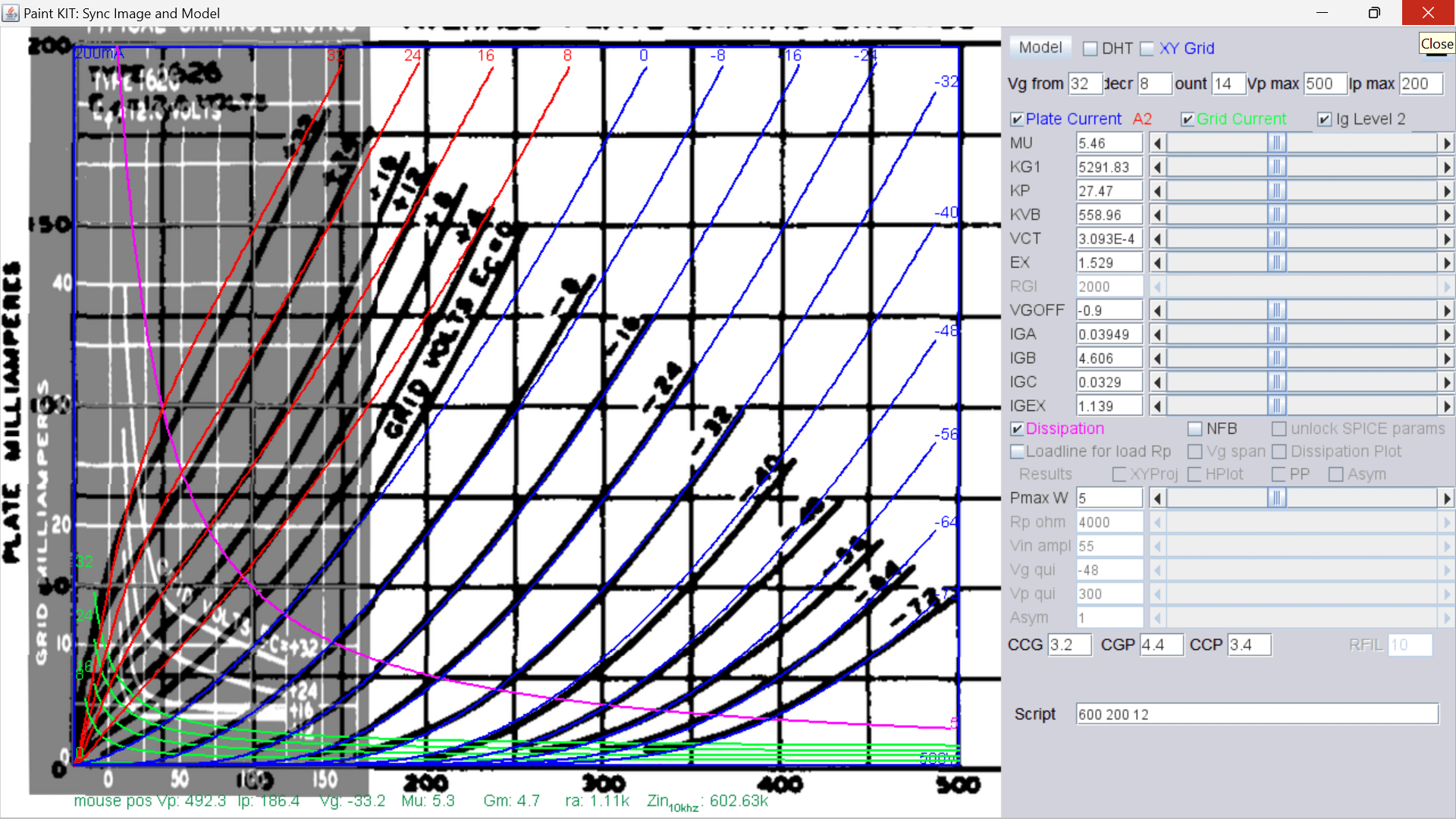

There is a small alignment error in the grid current of 1626. Here is the correction code:
Code:
