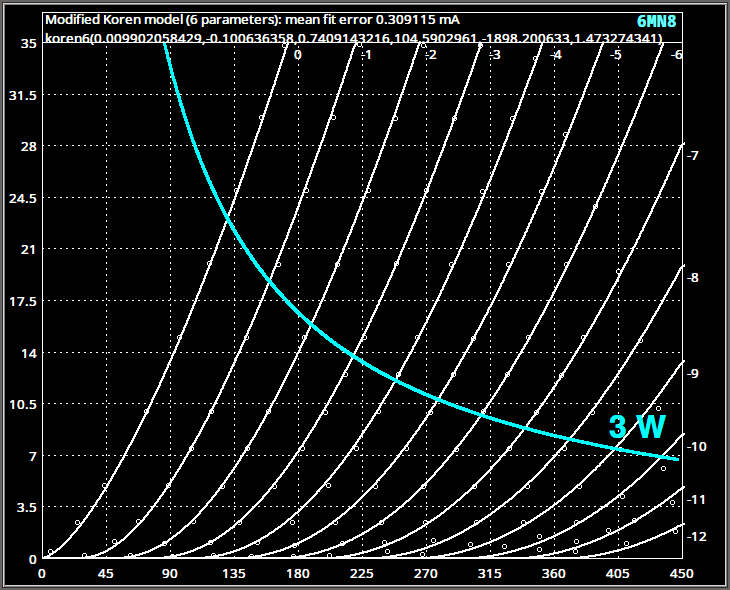

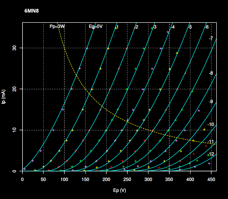

6MN8 spice model
6BM8 Koren and Ayumi Nakabayashi models fresh out of the oven:
Code:
* 6MN8 LTSpice model
* Modified Koren model (6 parameters): mean fit error 0.309115mA
* Traced by Wayne Clay on Feb 23, 2021 using Engauge Digitizer 10.10
* and Curve Captor v0.9.1 from General Electric data sheet
.subckt 6MN8  P G K
    Bp  P K  I=(0.009902058429m)*uramp(V(P,K)*ln(1.0+(-0.100636358)+exp
+ ((0.7409143216)+(0.7409143216)*((104.5902961)+(-1898.200633m)*V(G,K))*
+ V(G,K)/V(P,K)))/(0.7409143216))**(1.473274341)
    Cgp G P 2.6p
    Cgk G K 4.6p
    Cpk P K 0.33p
    Rpk P K 1.0G ; to avoid floating nodes in mu-follower
    d3  G K dx1
.model dx1 d(is=1n rs=2k cjo=1pf N=1.5 tt=1n)
.ends 6MN8
Code:
* Generic triode model: 6MN8_AN (General Electric data sheet)
* Copyright 2003--2008 by Ayumi Nakabayashi, All rights reserved.
* Version 3.10, Generated on Tue Feb 23 19:45:32 2021
*               Plate
*               | Grid
*               | | Cathode
.SUBCKT 6MN8_AN A G K
BGG   GG   0 V=V(G,K)+0.18085853
BM1   M1   0 V=(0.01611335*(URAMP(V(A,K))+1e-10))**-1.2587337
BM2   M2   0 V=(0.54372773*(URAMP(V(GG)+URAMP(V(A,K))/28.316413)+1e-10))**2.7587337
BP    P    0 V=0.005418531*(URAMP(V(GG)+URAMP(V(A,K))/52.078295)+1e-10)**1.5
BIK   IK   0 V=U(V(GG))*V(P)+(1-U(V(GG)))*0.0043452991*V(M1)*V(M2)
BIG   IG   0 V=0.0027092655*URAMP(V(G,K))**1.5*(URAMP(V(G,K))/(URAMP(V(A,K))+URAMP(V(G,K)))*1.2+0.4)
BIAK  A    K I=URAMP(V(IK,IG)-URAMP(V(IK,IG)-(0.0028660811*URAMP(V(A,K))**1.5)))+1e-10*V(A,K)
BIGK  G    K I=V(IG)
* CAPS
CGA   G    A 2.6p
CGK   G    K 4.6p
CAK   A    K 0.3p
.ENDS

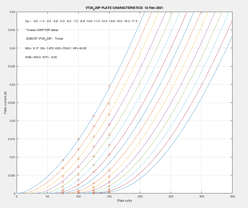

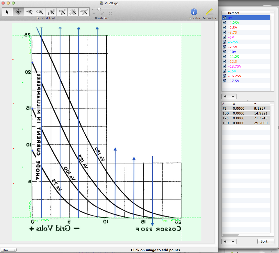

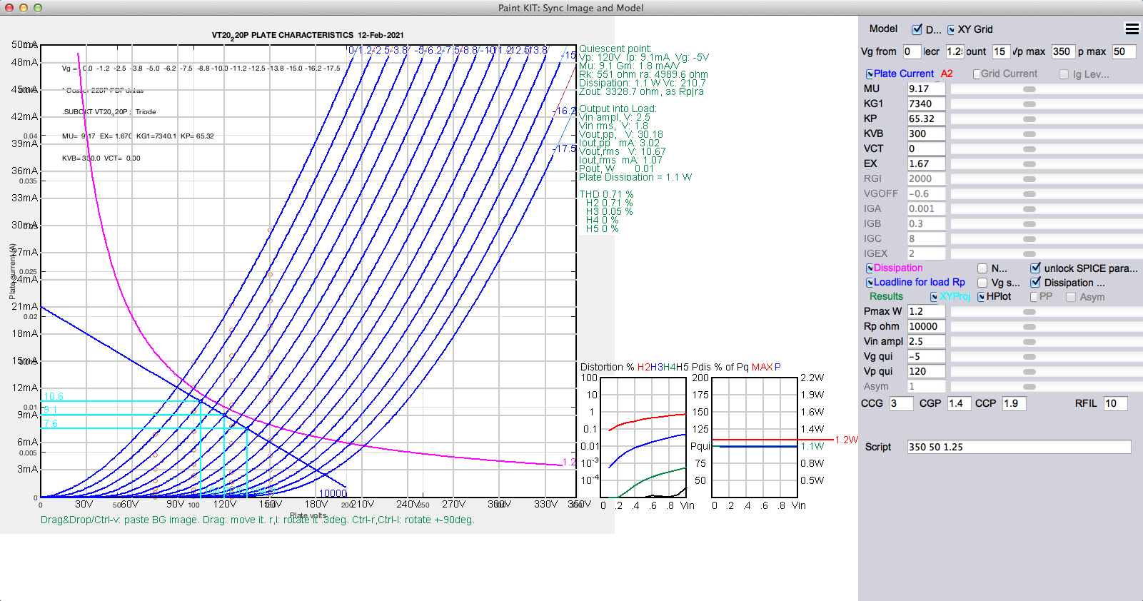

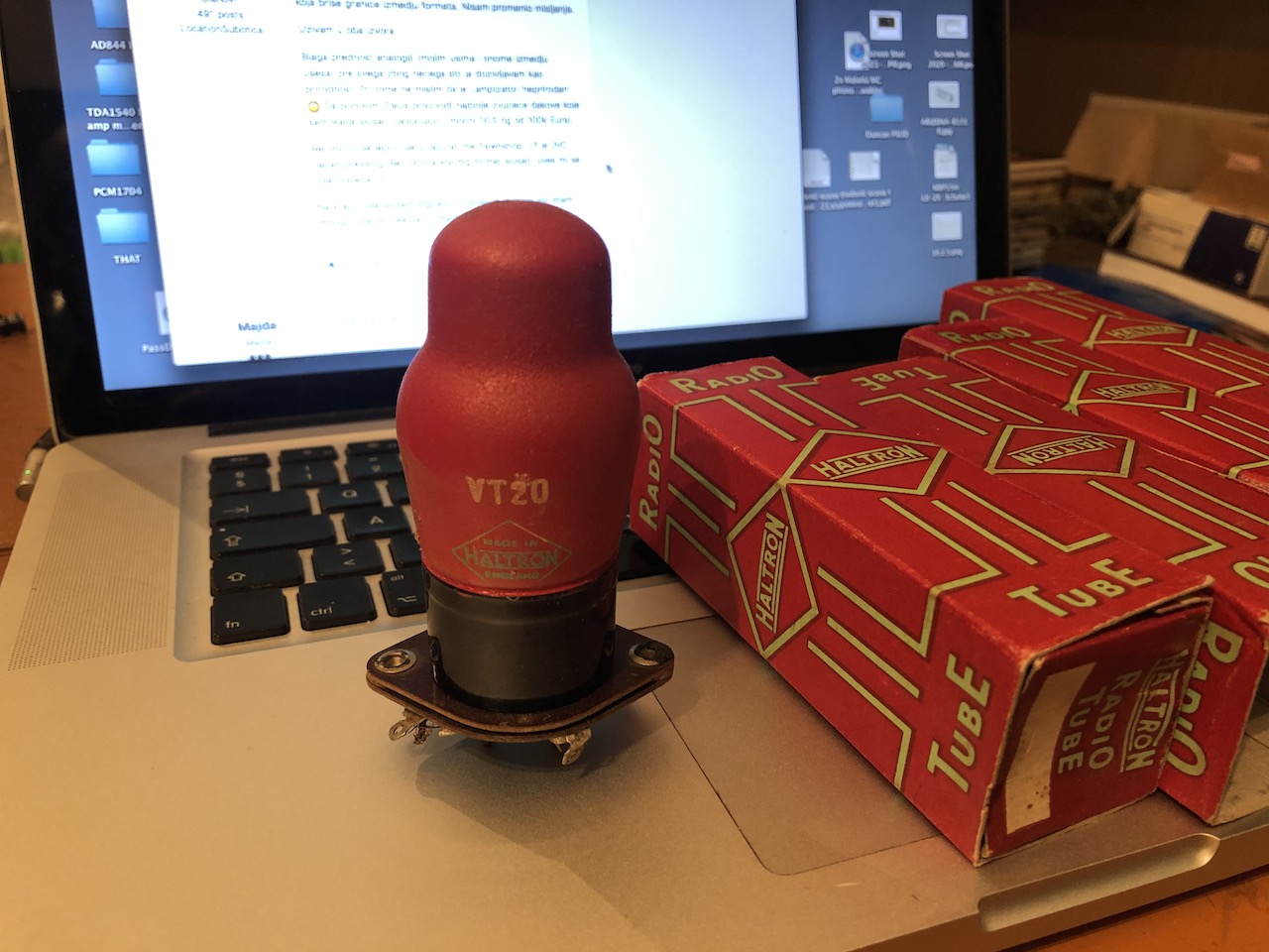

VT-20 DH triode Spice model
Hi
I have some datas about this ancient tube. 🙂 I will try some preamplifier with VT-20.
Hera are some datas: Equivalents are 220P Cossor And CV1020 tubes. I transcribe Cossor datas from Cossor 1935 PDF (very good, informative and educational...) https://frank.pocnet.net/other/Cossor/Cossor_ValveManual_1936-6.pdf
Inside is page with 220P datas.
1. Extracted data points from graph of the 220P with Graph click soft.
2. Rearanged and prepared datas for Matlab sheet (Norman Koren method)
3. I check the PSpice paramethers with Model Pain tools and etracted DHT model
4. Defined 2 pspice models, booth working with cadence orcad win soft.
cheers
  • 220P Cossor graph click datas.txt
  • 220p cossor.pdf
    220p cossor.pdf

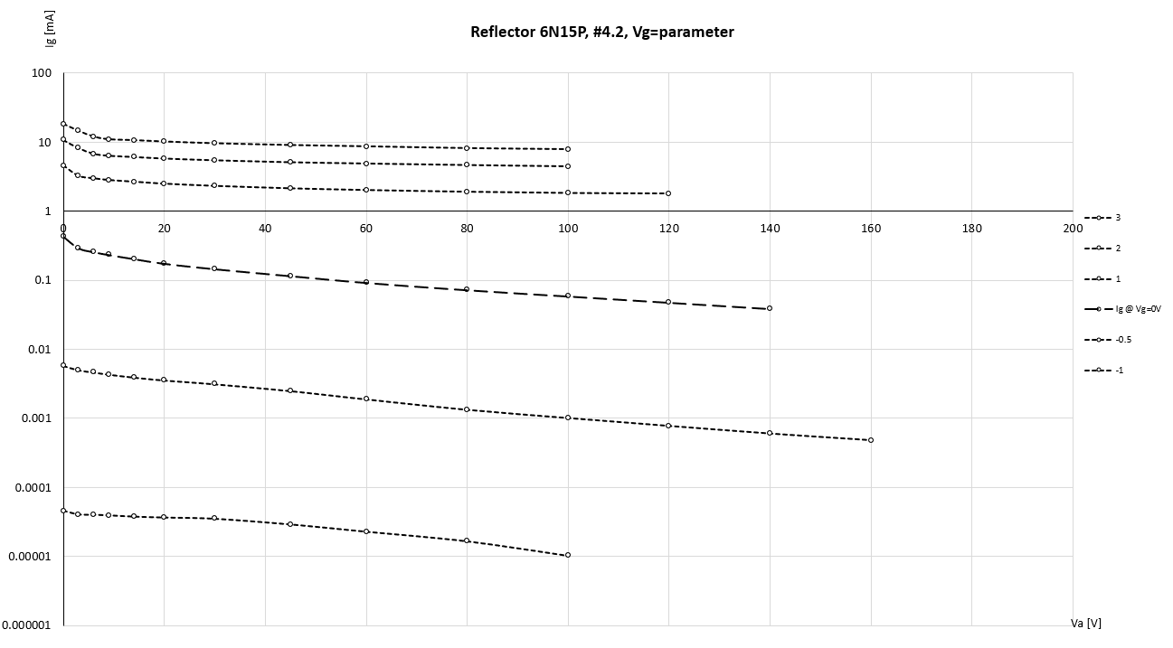

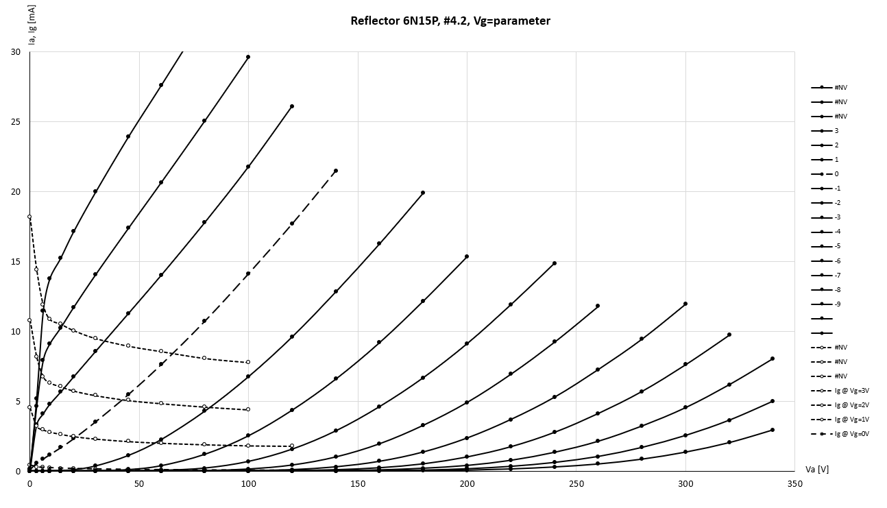

Hi all
please note my latest spice model: The 6N15P!
It is based on the most representative triode out of 10, after 100h burnin.
Be aware that this tube disclosed some surprisings regarding tolerances:
+ Simply the Best in terms of contact voltage
- the opposite in terms of plate resistance & grid resistance
However: If wished, plate & grid resistance may be easy adapted with the models "os" parameter to tune the model to your sample. Doubling the os value means half plate resistance.
regards, Adrian

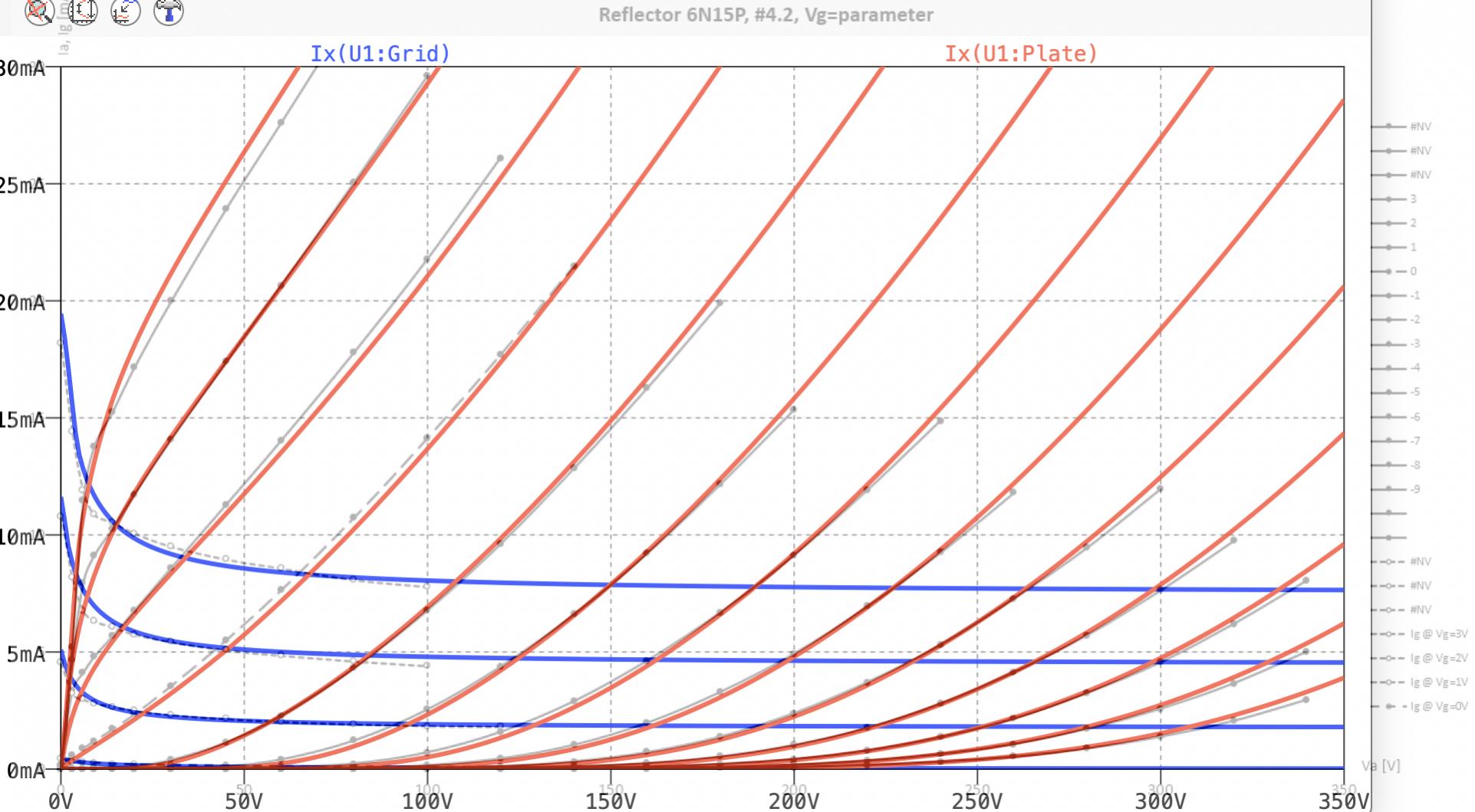

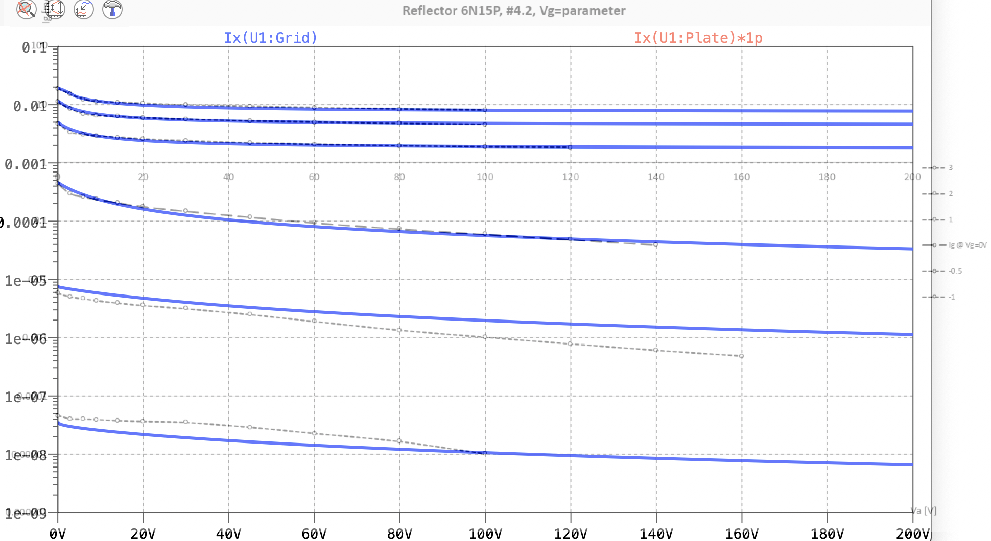

... I just realized that I posted the wrong pictures (measured curves only, but not with the model curves added)
So, here are the right diagrams, showing both, measurements and spice model curves.
regards, Adrian
