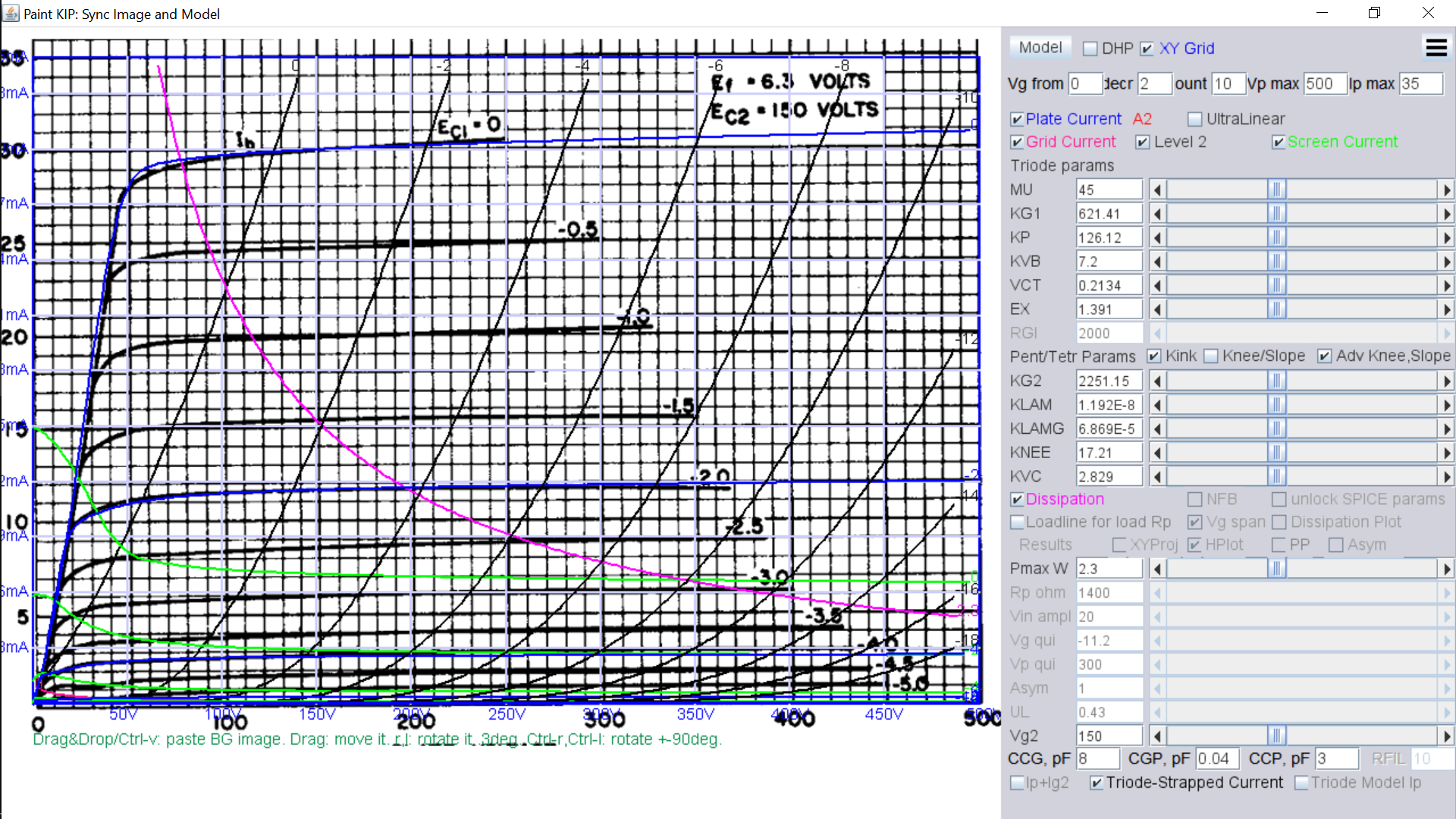

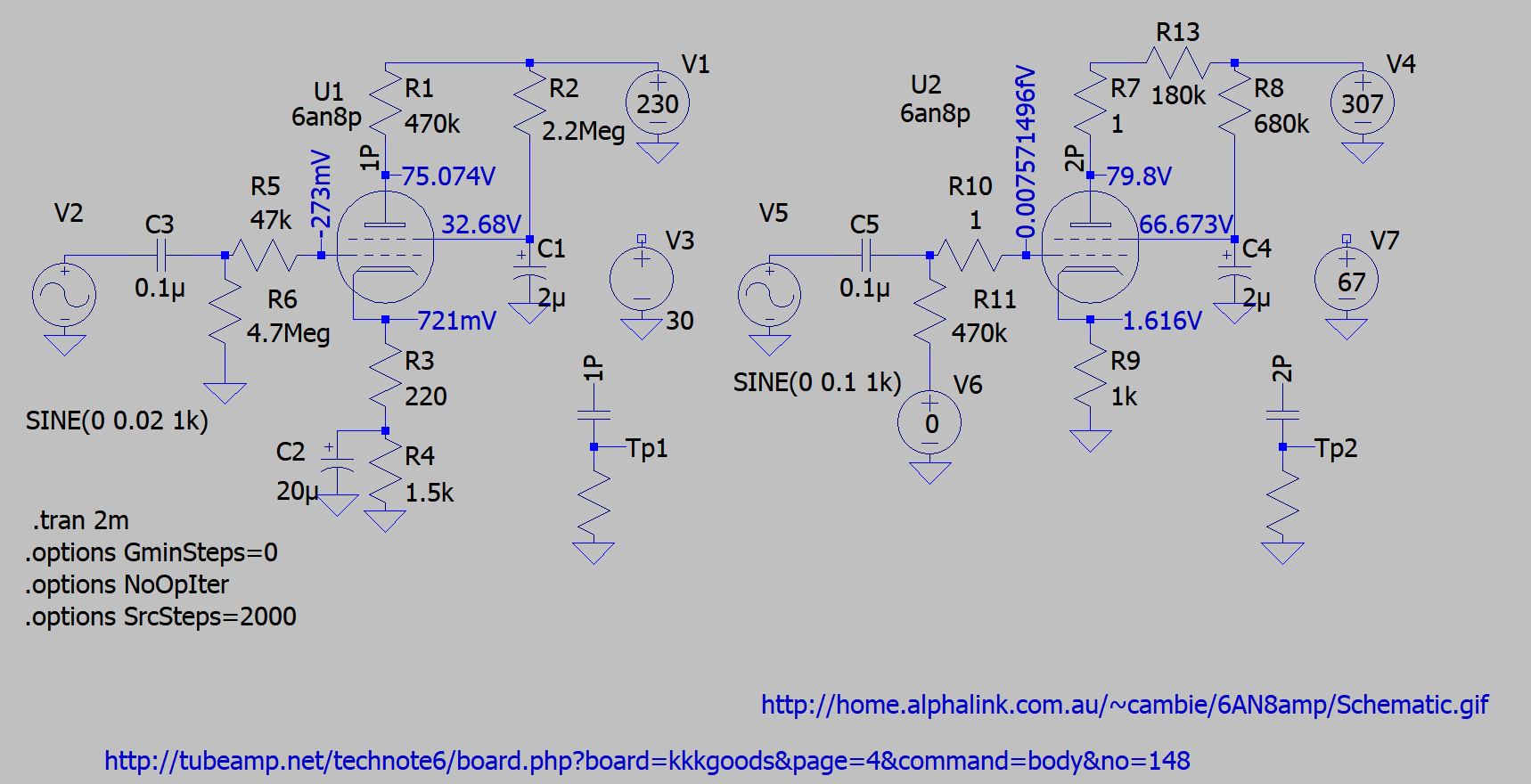

This is 6AN8P model that meet operating points in sch below:
http://www.tubeamp.net/technote6/data/board/kkkgoods/file_in_body/1/magnavox_amp_169aa_286v6_pp29.jpg
http://home.alphalink.com.au/~cambie/6AN8amp/Schematic.gif
Code:
* [URL="http://www.dmitrynizh.com/tubeparams_image.htm"]Model Paint Tools: Trace Tube Parameters over Plate Curves, Interactively[/URL]
* Plate Curves image file: 6an8p.png
* Data source link: <plate curves URL>

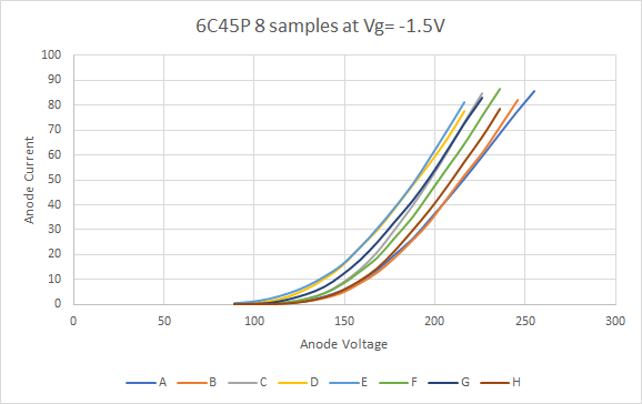

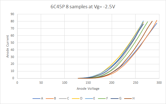

This is everything I've collected for 6C45P (6S45P). I don't have any of those tubes, so I can't tell you which (if any) of these are particularly accurate. I understand the tubes themselves have quite variable characteristics, which would make it difficult to create a one-size-fits-most model. Hopefully one of these models will work well enough for you.
No wonder Eli Duttman called it a "firecracker" tube.
Well, in defense of the 6S45P, any good one will have very high gm, so any sample should make a very good cathode follower or concertina/cathodyne. Right?
Thanks for those curves!
The spread is large at 60mA and 250 to 275V.
But that is 15 to 16.5 Watts, great for transient conditions like curve tracing.
When I used them, it was at 10mA, and the plate voltage spread is about 25 Volts with fixed bias.
I used self bias, and it was close to 2.5V.
I either used them as a self biased single triode gain stage,
Or as a cathode coupled phase splitter with a current source to the cathodes.
They worked real good in those 2 applications, but for the phase splitter, you need to find a matched pair.
I did not use them as cathode followers.

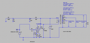

I'm starting to get to grips with ltspice and trying to use it to fill in some question marks in the schematic of a 1940's PA amp I'm trying to get operational again.
The amp looked deceptively simple, and I made notes regarding the connections between the subcomponents, but must have screwed up somewhere because the schematic does not make a lot of sense.
Anyway, it uses a triode wired EF12 for the first stage, an EF12 pentode as driver, and EL11 single ended output.
I think I can use an EL41 model for the EL11, and I have that, but I cannot find models for the EF12's. They are not a million miles from an EF86, so I've tried that, but cannot get the operating point correct.
Is there a method to approximate the operating characteristics in a model to adapt it to another tube? I've been looking today, and it is not as obvious as I hoped.

Building up a model to emulate an existing circuit
Plea for help!
Recently I modelled a Consonance T1 preamplifier in LTSpice, and was very impressed when I managed to get almost identical operating data from the amplifier as was predicted in the model.
As mentioned in an earlier post, I was a bit hasty dismantling an old PA amplifier, and I would like to rebuild it with the same operating points, but there are some aspects of the schema I derived that don't appear to make sense.
The more I look into these old circuits from the 40's, many of them seem to have additional complexity to overcome weaknesses in the components that were being used. For instance, fixes for stability due to poor quality output transformers, and subtle forms of feedback to improve linearity.
I would very much like to be able to understand this old circuit from the 40's, and coming from an IT background, that means I need to be able to model it so I can emulate the contributions of the different design elements.
The output tube is a single ended EL11, which is identical to an EL41 in characteristics. I have sourced a model for the transformer, and I am trying to build the model up from the ground up.
What I am aiming for is a model of the output stage, where I can emulate the signal to the grid of the output tube, and measure the voltage on the speakers.
I cannot get the model below to work, and I know I am missing something obvious in my basic understanding of LT Spice. Not being an electronics engineer, the effects of impedance and reactance are not as obvious as resiatance and capacitance, so I think it is highlighting my general lack of understanding of circuitry.
However, the models I am using are also untested in some ways, so I also lack a bit of confidence in relying too strongly in the modelling.
Below is the model I am using. Any pointers greatly appreciated!

Thanks for that! I managed to emulate the input stage, but now I am struggling linking stages together, as described in my post earlier today.
Grid resistor 1m, you meant 1Meg. You need to paste the model file into the tube.lib or working space as directive, oh the input level should be same as bias level.
Hallelujah! Thanks so much - it was the writing of the 1meg resistor as 1m that stopped me in my tracks.
Now I have a nice signal voltage at the anode of the output tube, and I can start to build on my understanding again.

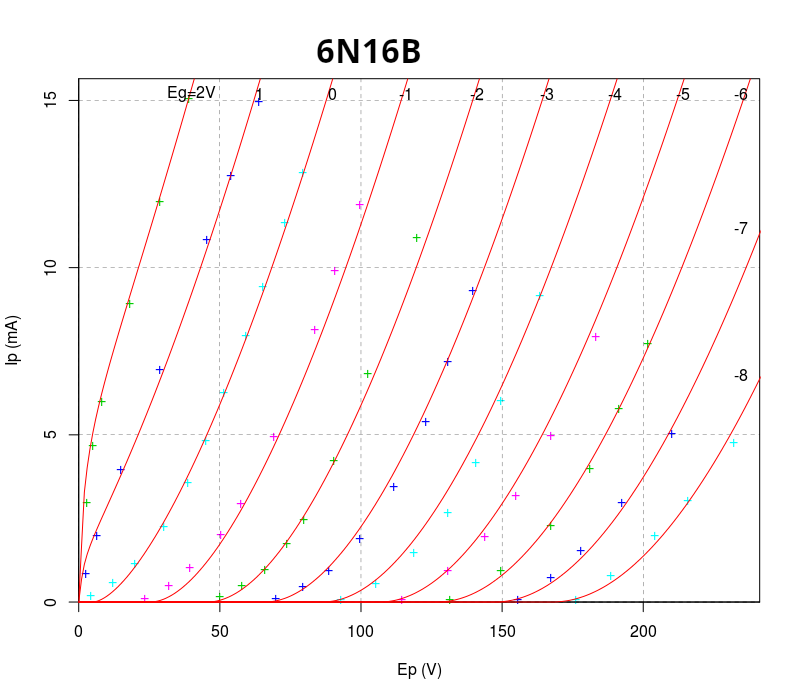

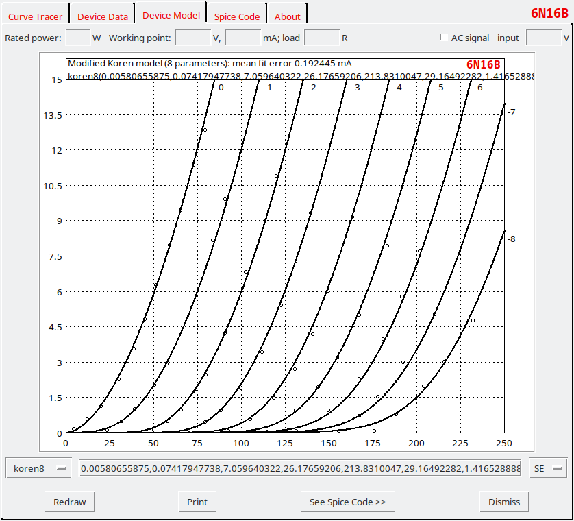

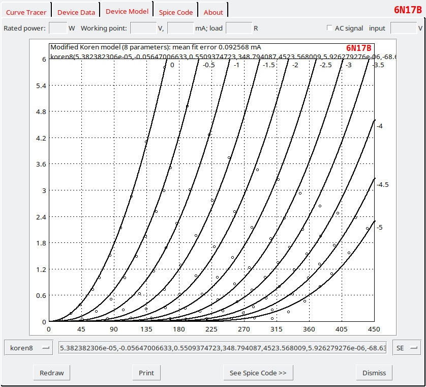

A new member, pcardoso73, posted a request for LTspice models for the following tubes: 6N16B, 6N17B, 6N21B and 6S31B here. I would much rather post them here. I don't have the model for 6S31B, but I have the others. Here we go...
Code:
* 6N16B LTSpice model
* Modified Koren model (8 parameters): mean fit error 0.192445mA
* Traced by Wayne Clay on 09/19/2018 using Engauge Digitizer and
* Curve Captor v0.9.1 from Soviet data sheet
.subckt 6N16B P G K
Bp P K I=
+ (0.005806558558m)*uramp(V(P,K)*ln(1.0+(0.07417944543)+exp((7.059640136)+
+ (7.059640136)*((26.17659172)+(213.8309805m)*V(G,K))*V(G,K)/sqrt((29.16492618)**2+
