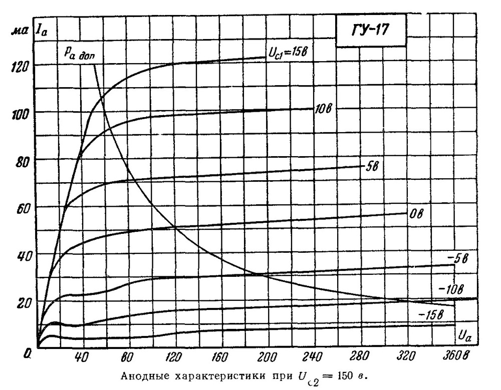

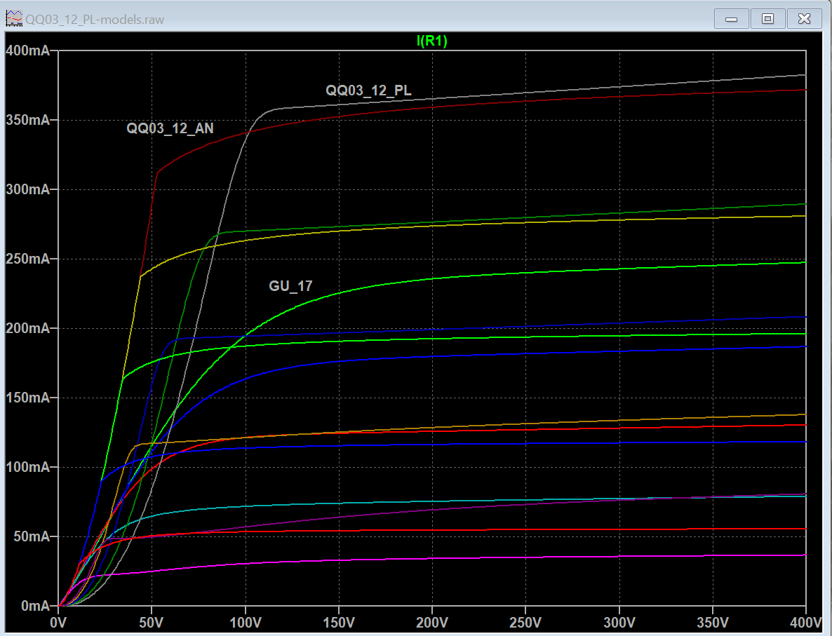

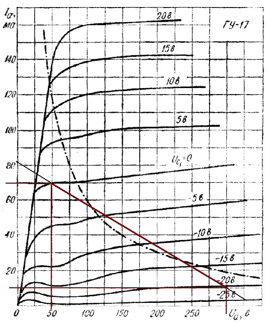

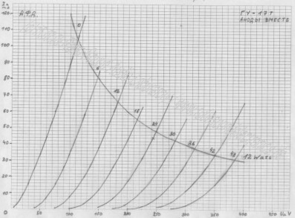

It looks like this model does not work correctly in both triode and pentode modes. Does anyone have any real curves in these modes? I have curves for the Soviet analogue GU17, but I'm not sure if they are correct either.

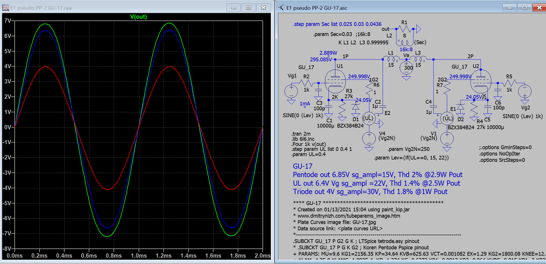

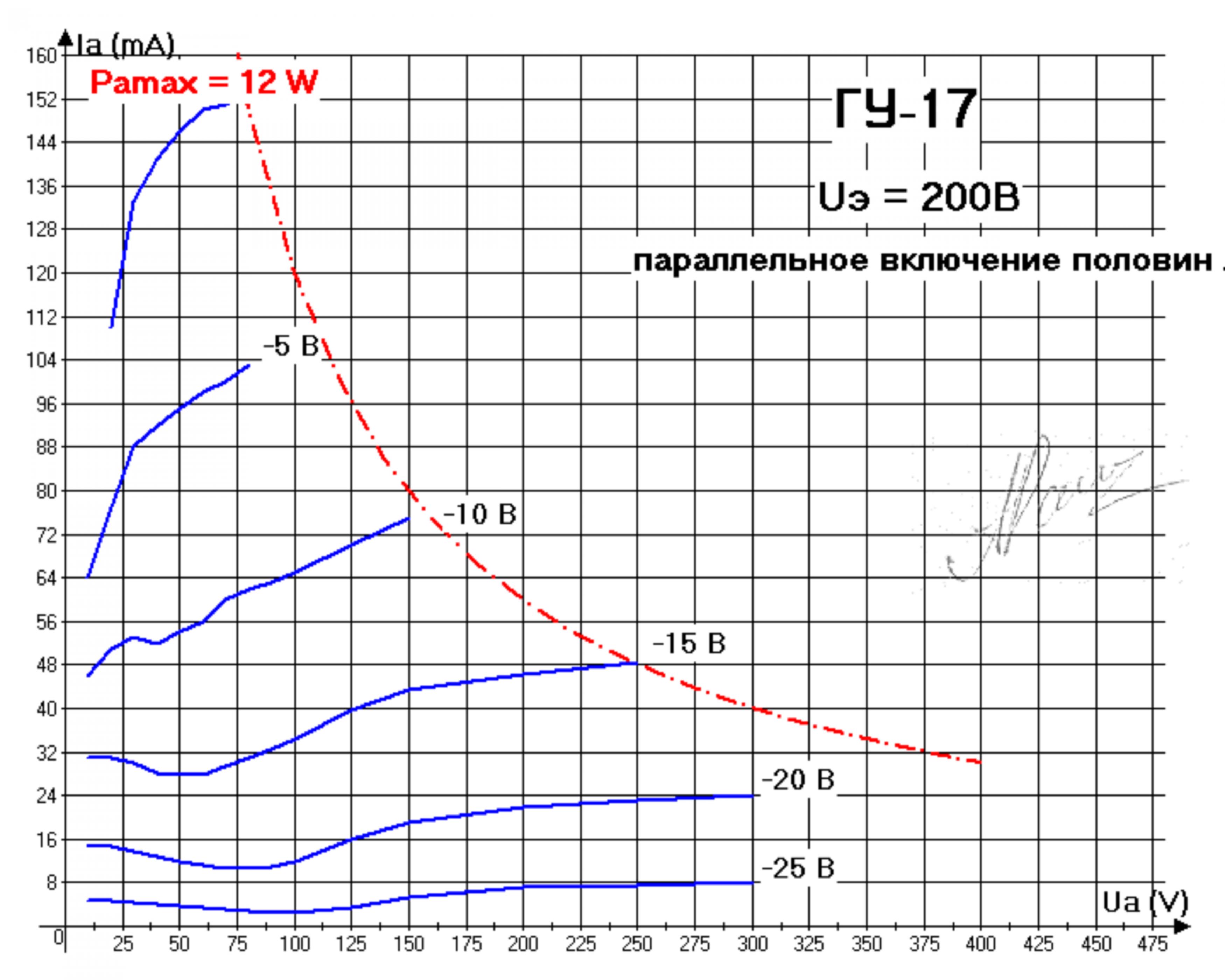

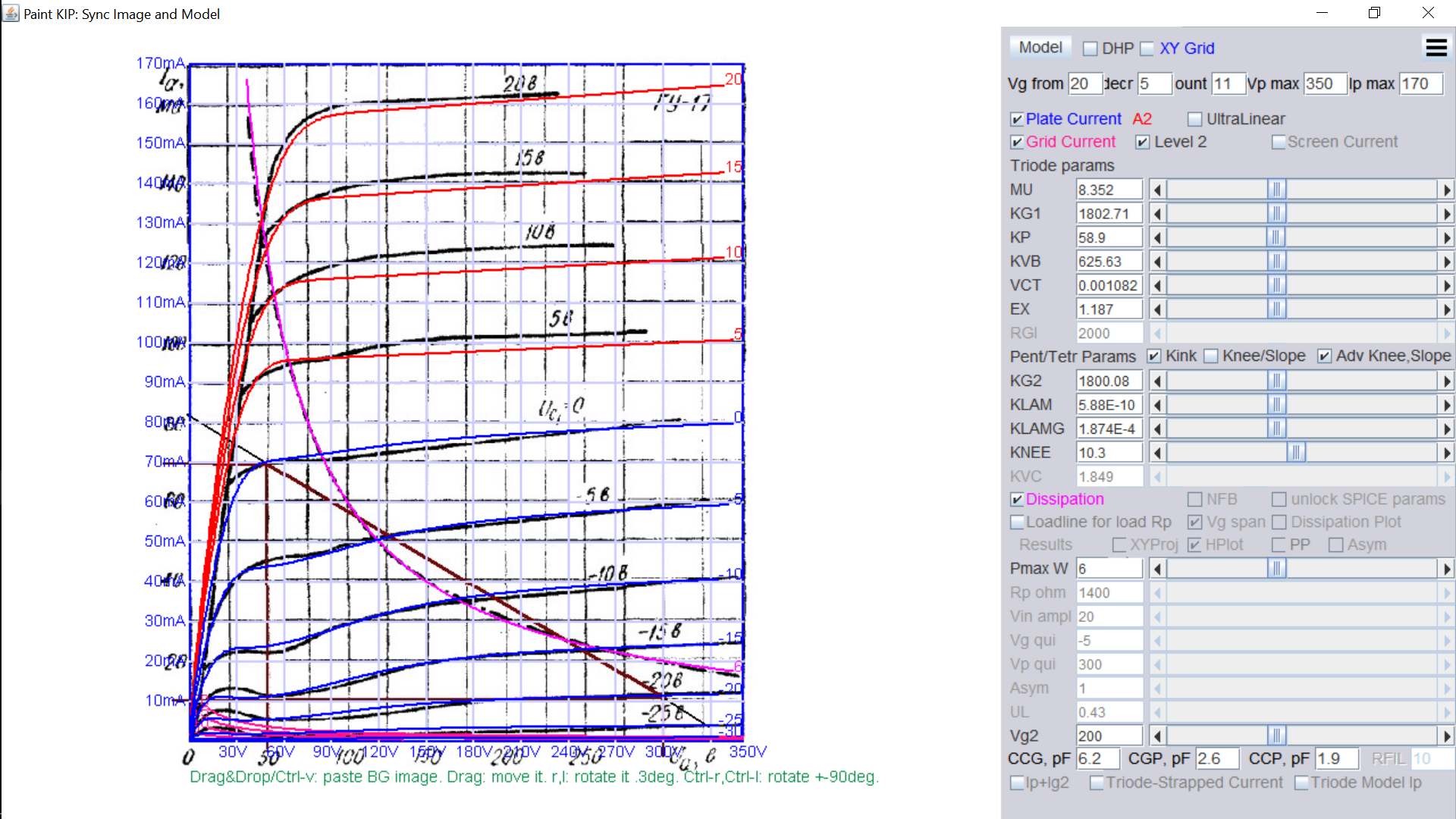

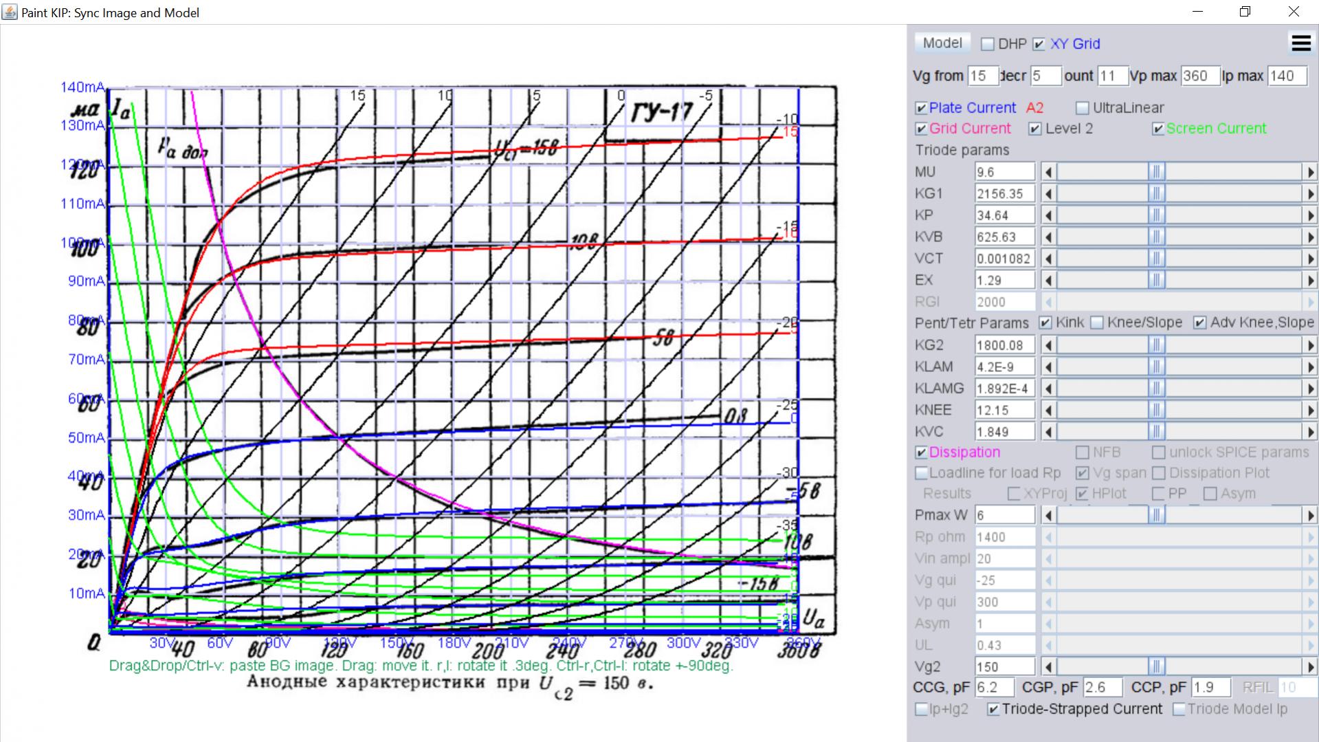

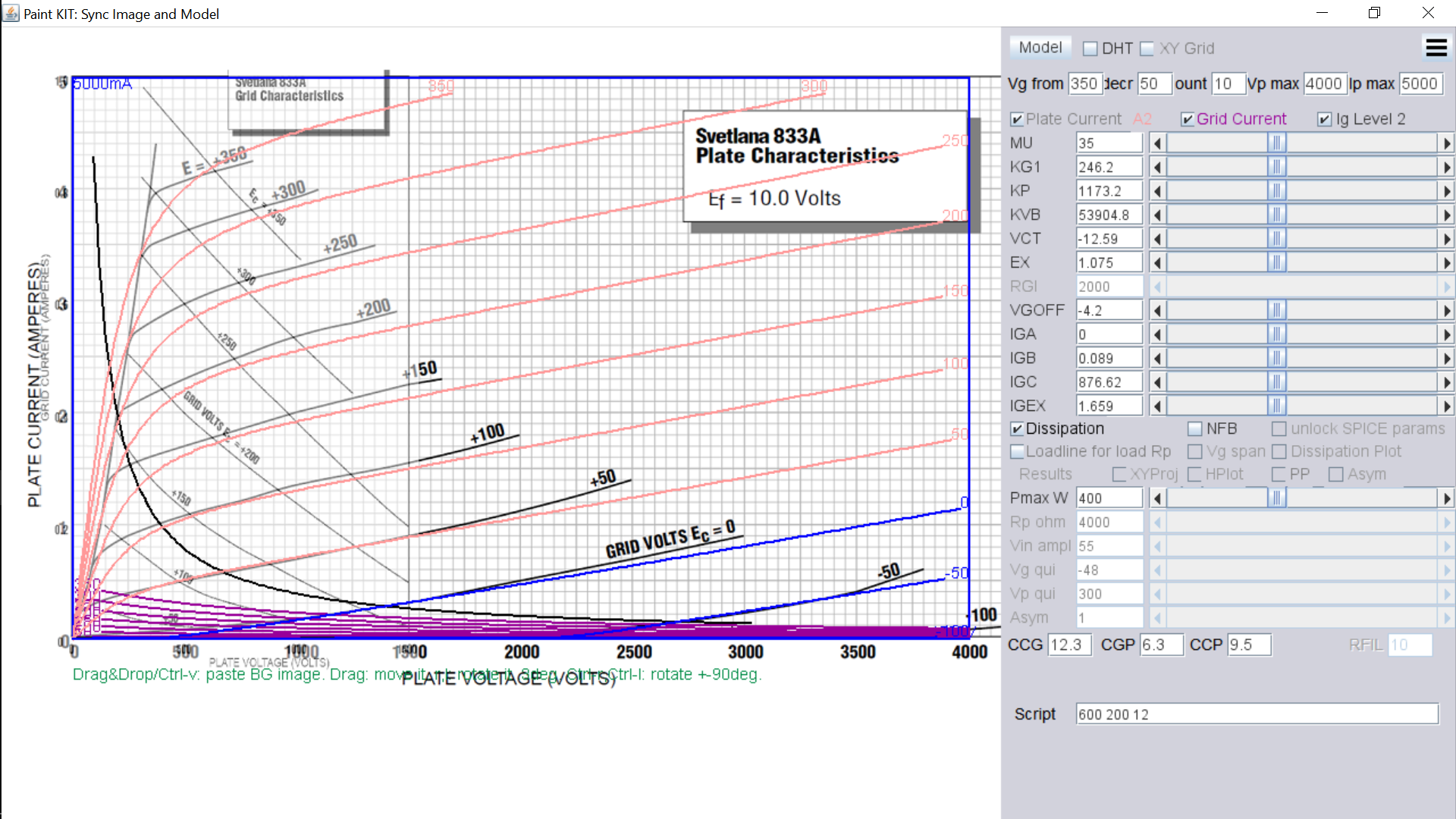

I remodeled GU-17 using the above more extended curve here is the updated model:
Code:
*** GU_17 ******************************************
* Created on 01/14/2021 17:29 using paint_kip.jar
* [URL="http://www.dmitrynizh.com/tubeparams_image.htm"]Model Paint Tools: Trace Tube Parameters over Plate Curves, Interactively[/URL]
* Plate Curves image file: GU-17.jpg
* Data source link: <plate curves URL>
.SUBCKT GU_17 P G2 G K ; LTSpice tetrode.asy pinout
* .SUBCKT GU_17 P G K G2 ; Koren Pentode Pspice pinout
+ PARAMS: MU=8.352 KG1=1802.71 KP=58.9 KVB=625.63 VCT=0.001082 EX=1.187 KG2=1800.08 KNEE=10.3 KVC=1.849
+ KLAM=5.88E-10 KLAMG=1.874E-4  KD=74.23 KC=5.645 KR1=7.67E-4 KR2=0.00384 KVBG=0.00825 KB1=2.58 KB2=2 KB3=2 KB4=0.3074 KVBGI=0.28 KNK=0.04211 KNG=0.01824 KNPL=0.04894 KNSL=12.94 KNPR=89.4 KNSR=68.45
+ CCG=6.2P CGP=2.6P CCP=1.9P VGOFF=-1 IGA=5.2E-4 IGB=0.27 IGC=13.92 IGEX=1.44
* Vp_MAX=350 Ip_MAX=170 Vg_step=5 Vg_start=20 Vg_count=11
* X_MIN=167 Y_MIN=33 X_SIZE=486 Y_SIZE=595 FSZ_X=1296 FSZ_Y=736 XYGrid=true
* Rp=1400 Vg_ac=20 P_max=6 Vg_qui=-5 Vp_qui=300
* showLoadLine=n showIp=y isDHP=n isPP=n isAsymPP=n isUL=n showDissipLimit=y
* showIg1=y isInputSnapped=y addLocalNFB=n
* XYProjections=n harmonicPlot=y dissipPlot=n
* UL=0.43 EG2=200 gridLevel2=y addKink=y isTanhKnee=n advSigmoid=y

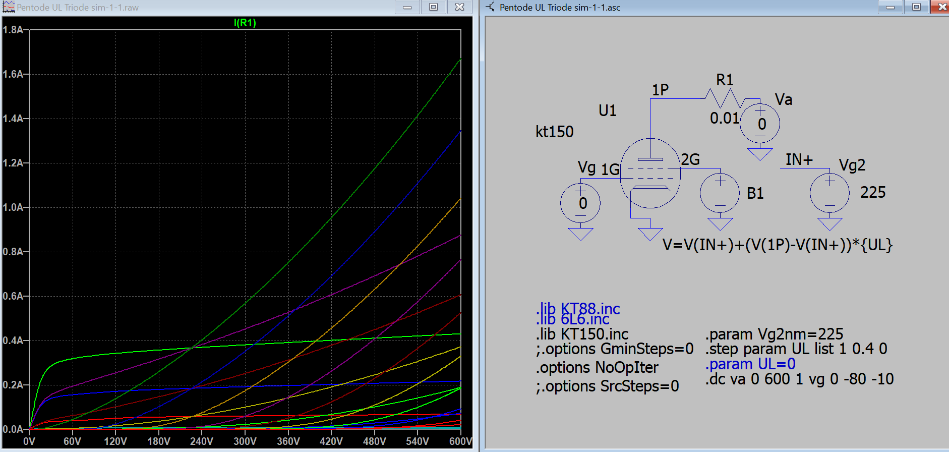

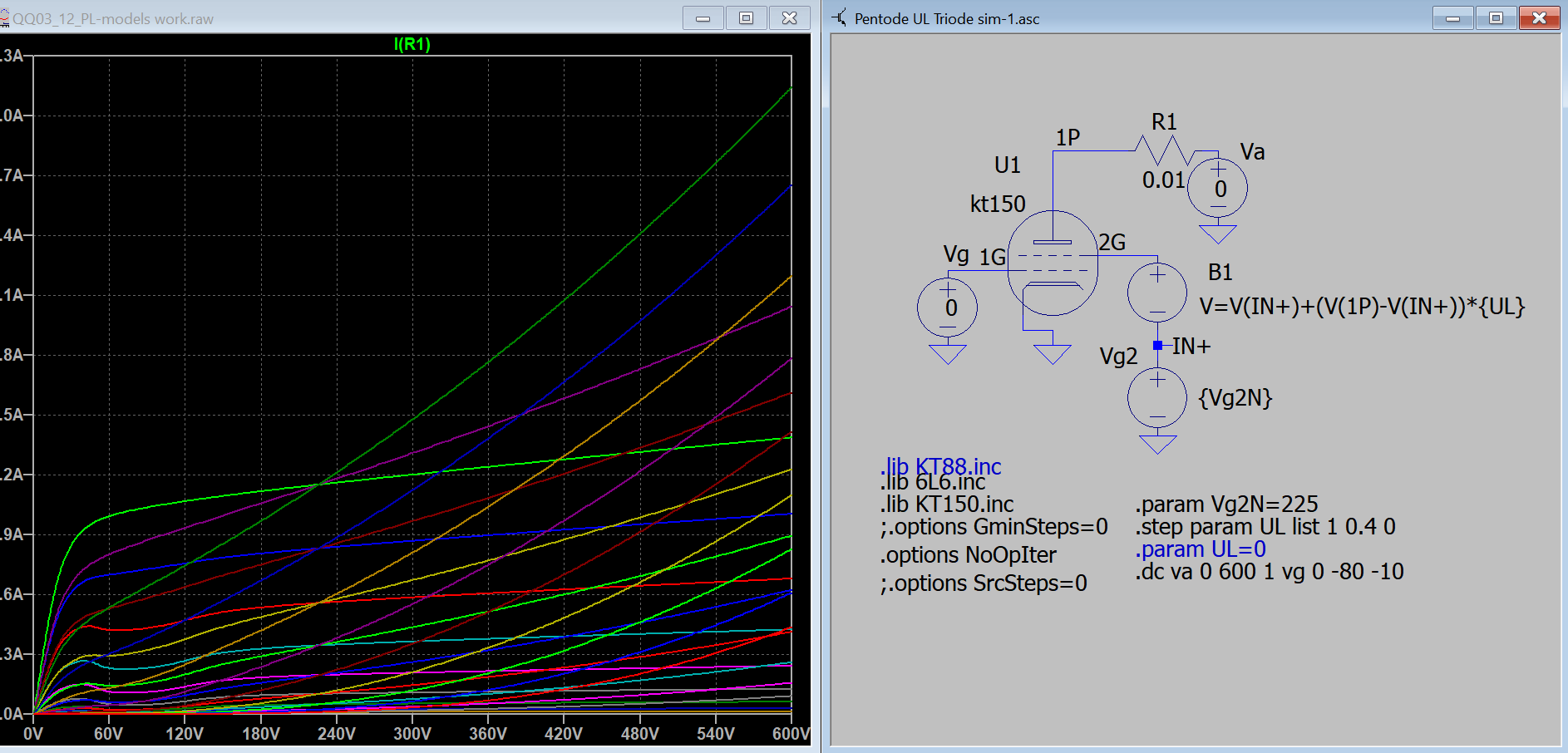

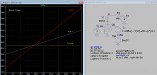

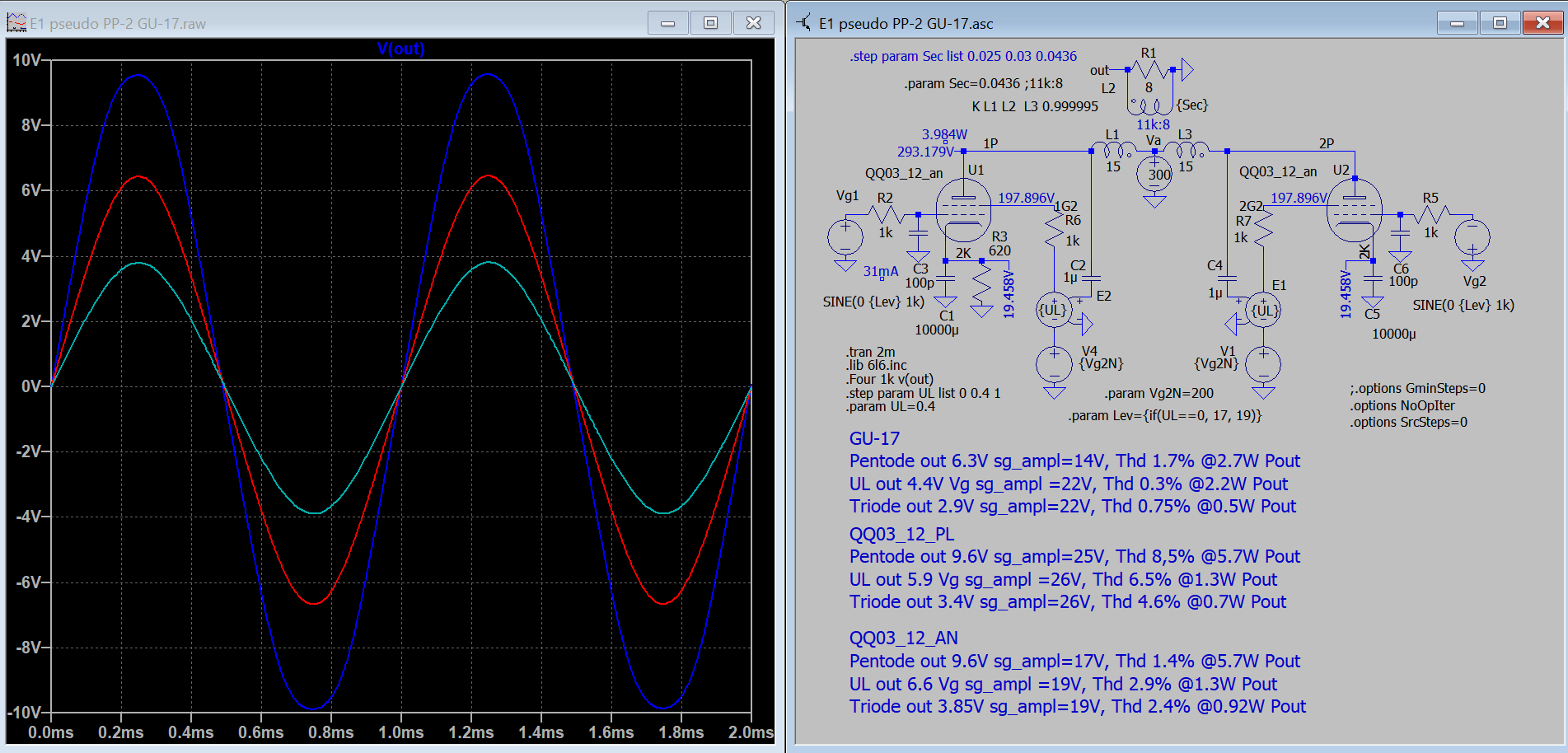

Thank you very much. I have modified my simple circuit for taking ultra-linear curves, as well as in the pentode and triode. Now it not only works accurately, but also captures curves with cathodic feedback too.
  • Curves in pentode triode UL with cathodic feedback.asc
Disabled Account
Joined 2013

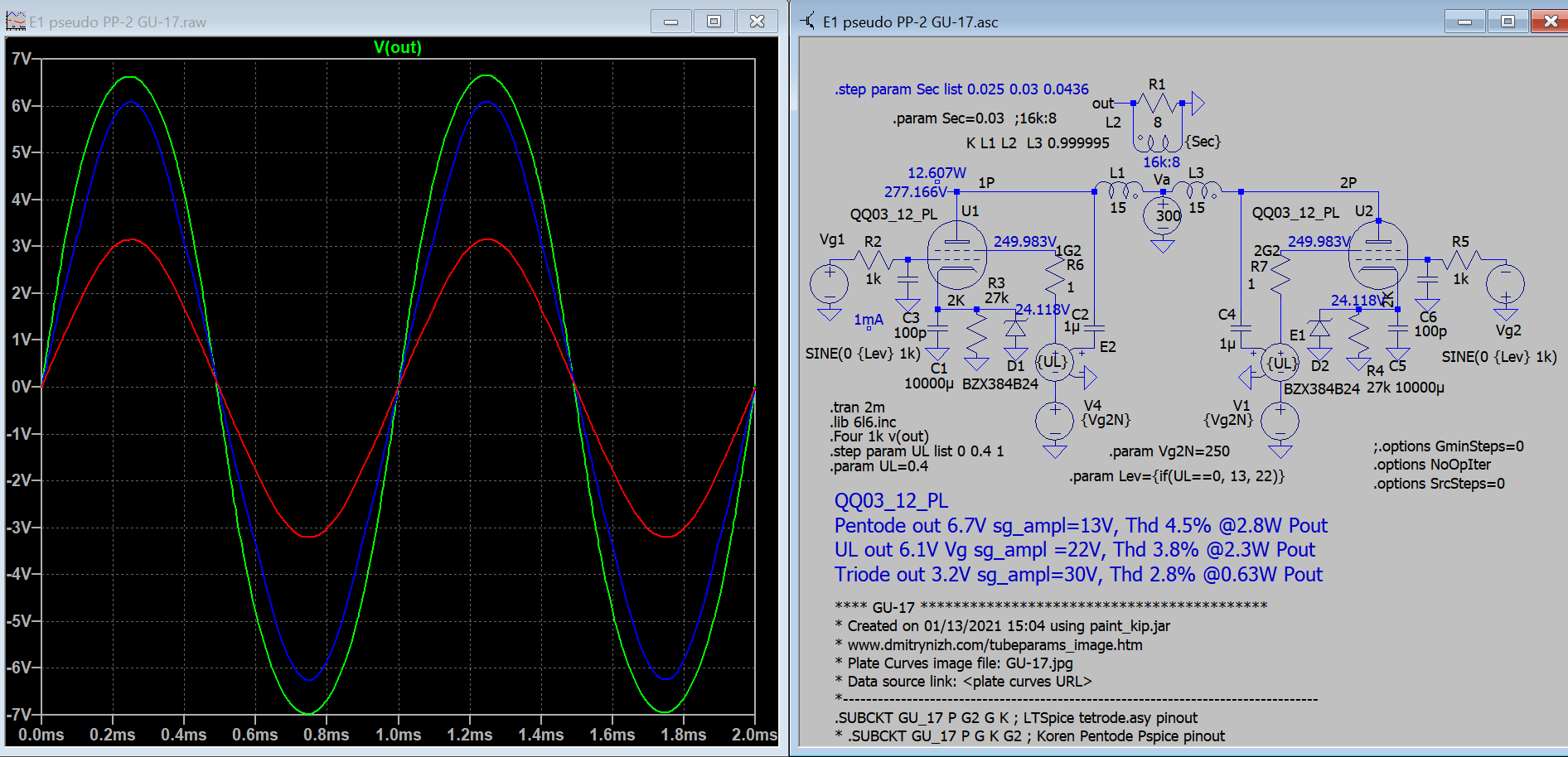

I modified my version using BV source it works too. Thank for the good work.

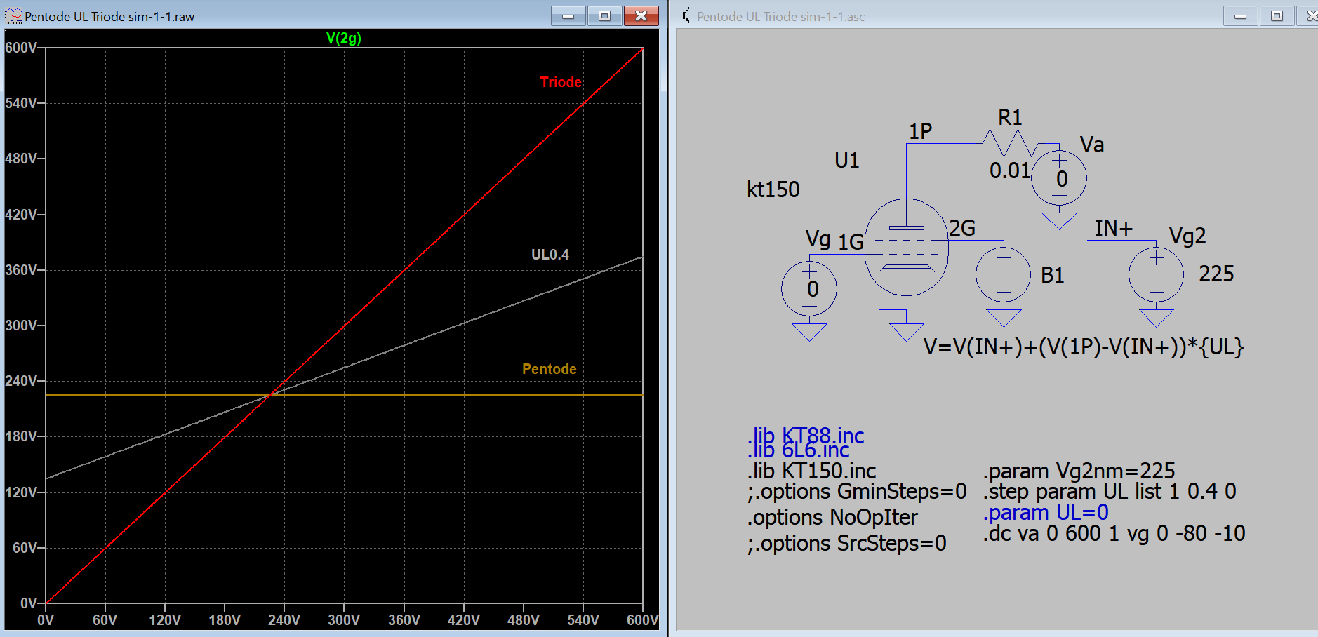

The mod is to subtract V(IN+) from Plate sweeping source, is the same as when E1 ground is connected to the top of Vg2 in your sch.
V=V(IN+)+(V(1P)-V(IN+))*{UL}
  • Pentode UL Triode sim-1.asc

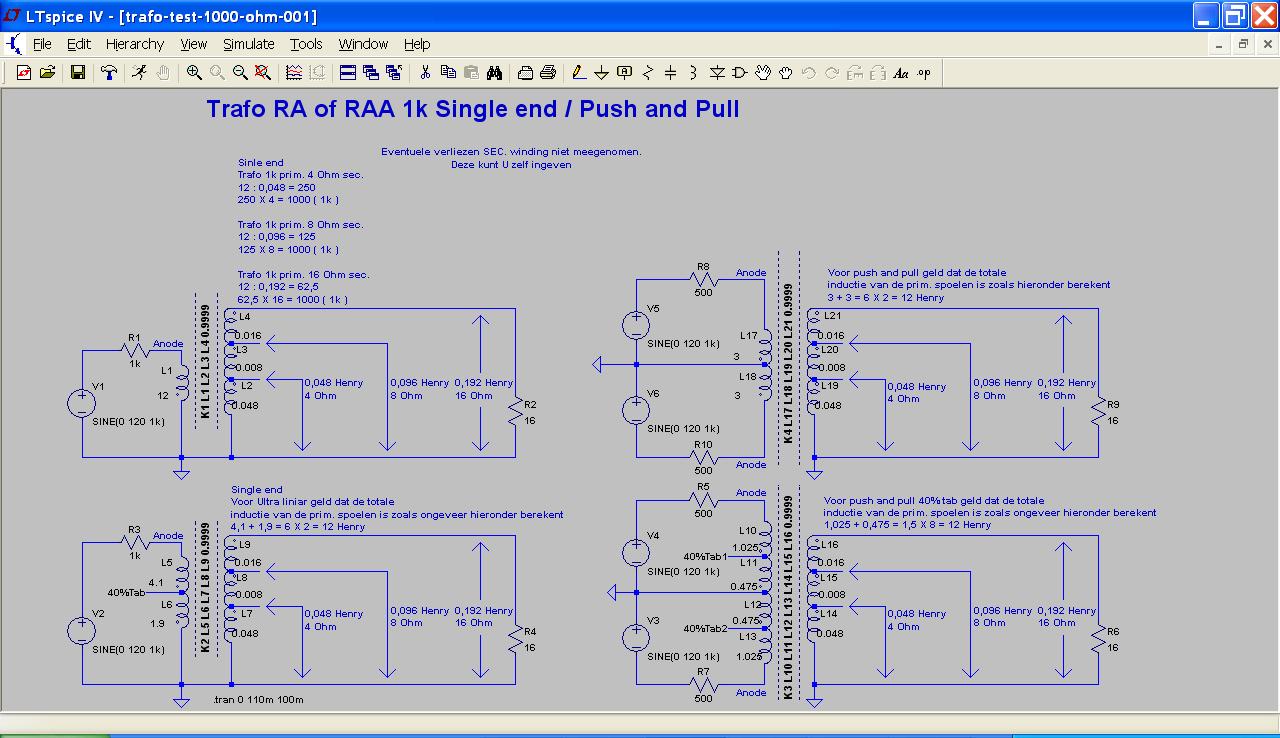

There are a variety of output transformer models for different applications.
Could you improve these models? For example, it would be much clearer and more convenient if the number of turns in the windings and only then their inductance were indicated.
  • ugt's.zip

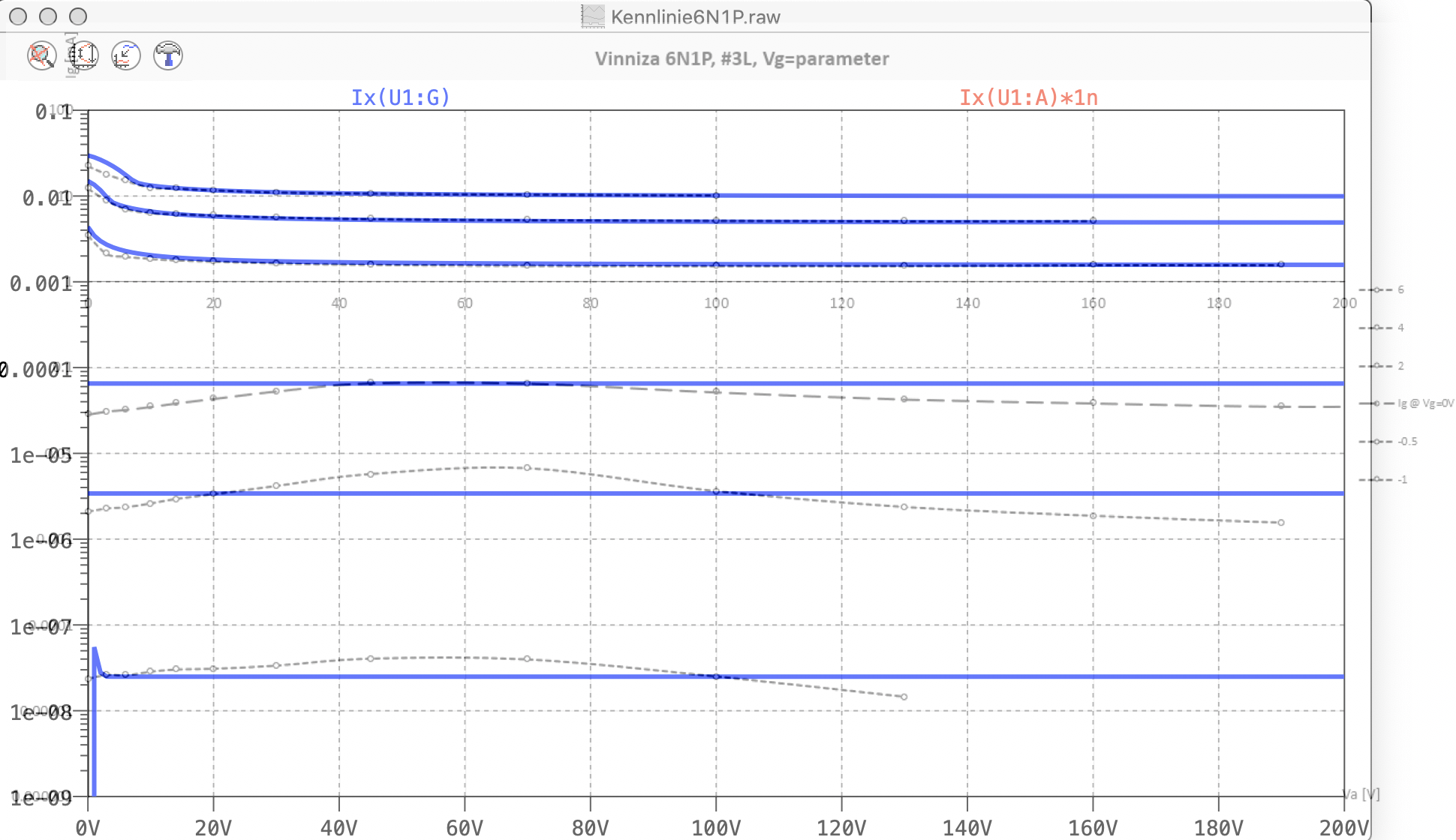

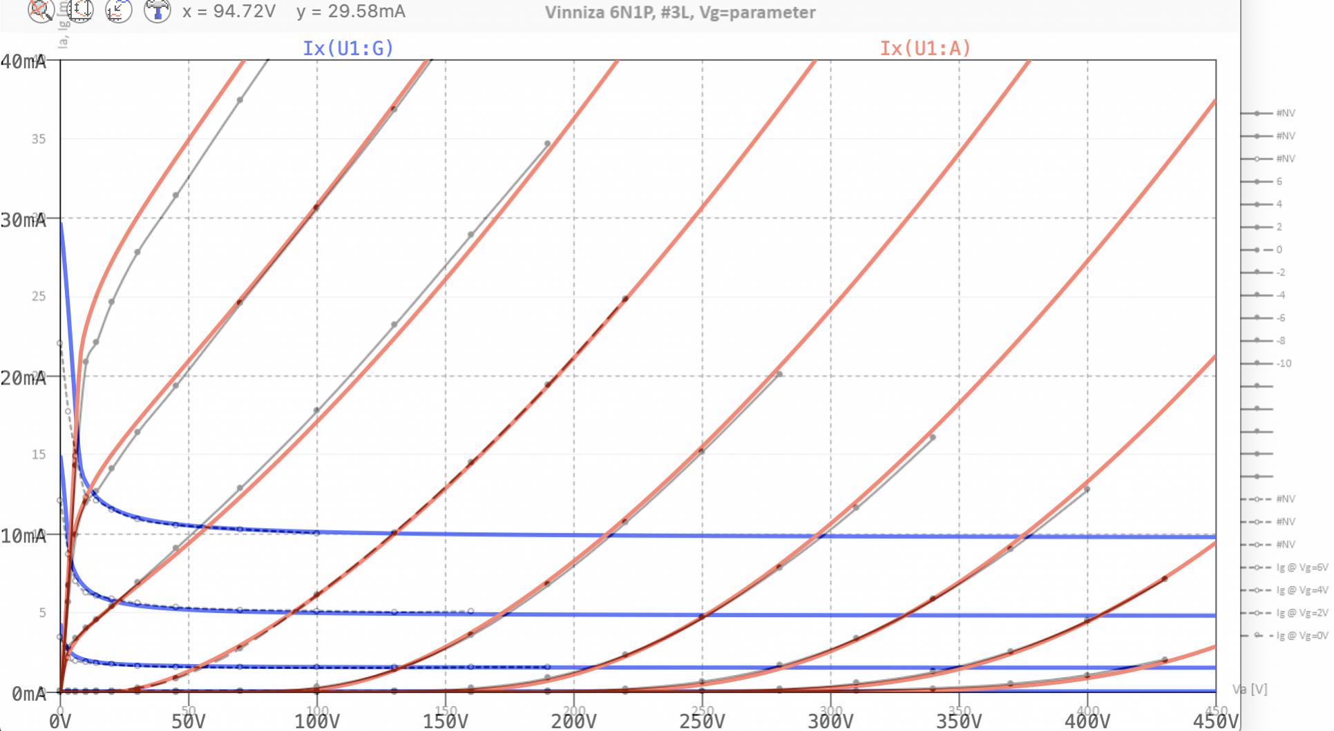

A 6N1P model from Adrian will be great to have. Looking forward to that. (...)
Hi rongon
Here it is...
My 6N1P model is based on a "golden sample" out of 10 triodes, each burned in for 100 hours. The bunch of 6N1P's had surprisingly tight manufacturing tolerances (the closest I recognized ever), especially regarding plate resistance.
Note that real 6N1P samples behave significantly different compared to what the data sheet claims:
- mu tends to be larger in real samples (typically 42 instead of 35)
- contact potential in real samples is 1.5-2V (!!) lower than the data sheet says
How ever, I really like this soviet "workhorse" - robust, tight tolerances, and well glowing :D.
cheers, Adrian

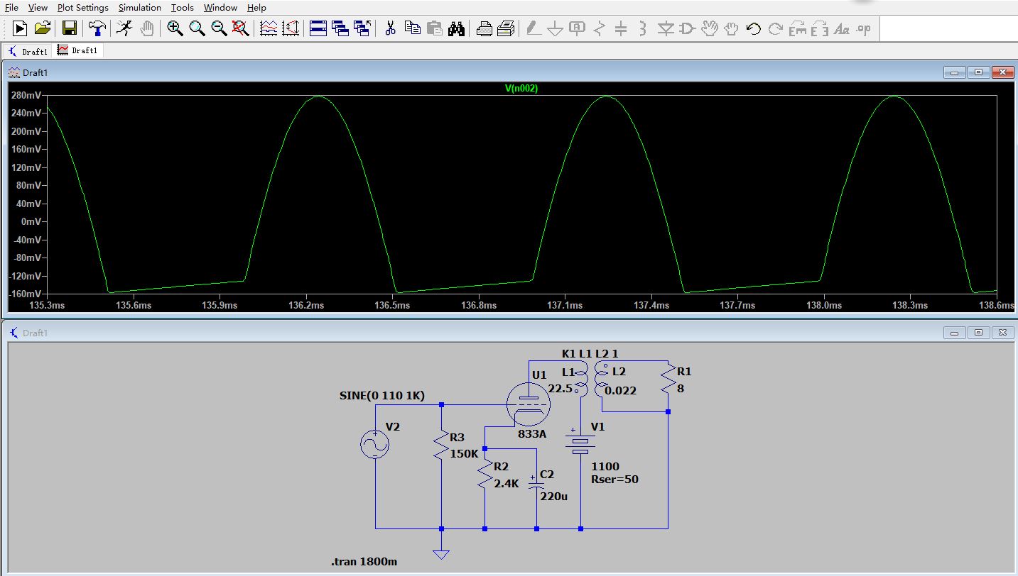

The 833a tube model provided by Koonw cannot be simulated correctly. What is the prob
Here is 833 model:

833a_sov model fixed (corrected the Ia scale on the left):
Code:
**** 833A_SOV ** Advanced Grid Current **********************************
* Created on 01/19/2021 12:24 using paint_kit.jar 3.1
* Plate Curves image file: 833a-sov.png
* Data source link:
.SUBCKT 833A_SOV 1 2 3 ; Plate Grid Cathode
+ PARAMS: CCG=12.3P  CGP=6.3P CCP=9.5P
+ MU=35 KG1=246.2 KP=1173.2 KVB=53904.8 VCT=-12.59 EX=1.075
+ VGOFF=-4.2 IGA=0 IGB=0.089 IGC=876.62 IGEX=1.659
* Vp_MAX=4000 Ip_MAX=5000 Vg_step=50 Vg_start=350 Vg_count=10
* Rp=4000 Vg_ac=55 P_max=400 Vg_qui=-48 Vp_qui=300
* X_MIN=63 Y_MIN=43 X_SIZE=788 Y_SIZE=493 FSZ_X=1296 FSZ_Y=736 XYGrid=false
* showLoadLine=n showIp=y isDHT=n isPP=n isAsymPP=n showDissipLimit=y
* showIg1=y gridLevel2=y isInputSnapped=n
* XYProjections=n harmonicPlot=n dissipPlot=n
E1 7 0 VALUE={V(1,3)/KP*LOG(1+EXP(KP*(1/MU+(VCT+V(2,3))/SQRT(KVB+V(1,3)*V(1,3)))))}
RE1 7 0 1G  ; TO AVOID FLOATING NODES
G1 1 3 VALUE={(PWR(V(7),EX)+PWRS(V(7),EX))/KG1}
RCP 1 3 1G   ; TO AVOID FLOATING NODES
C1 2 3 {CCG} ; CATHODE-GRID
C2 2 1 {CGP} ; GRID=PLATE
C3 1 3 {CCP} ; CATHODE-PLATE
RE2 2 0 1G
EGC 8 0 VALUE={V(2,3)-VGOFF} ; POSITIVE GRID THRESHOLD
GG 2 3 VALUE={(IGA+IGB/(IGC+V(1,3)))*(MU/KG1)*(PWR(V(8),IGEX)+PWRS(V(8),IGEX))}
.ENDS
