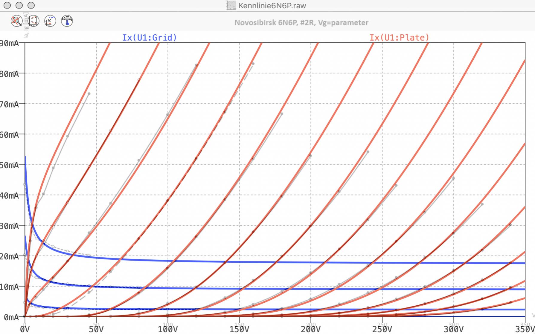

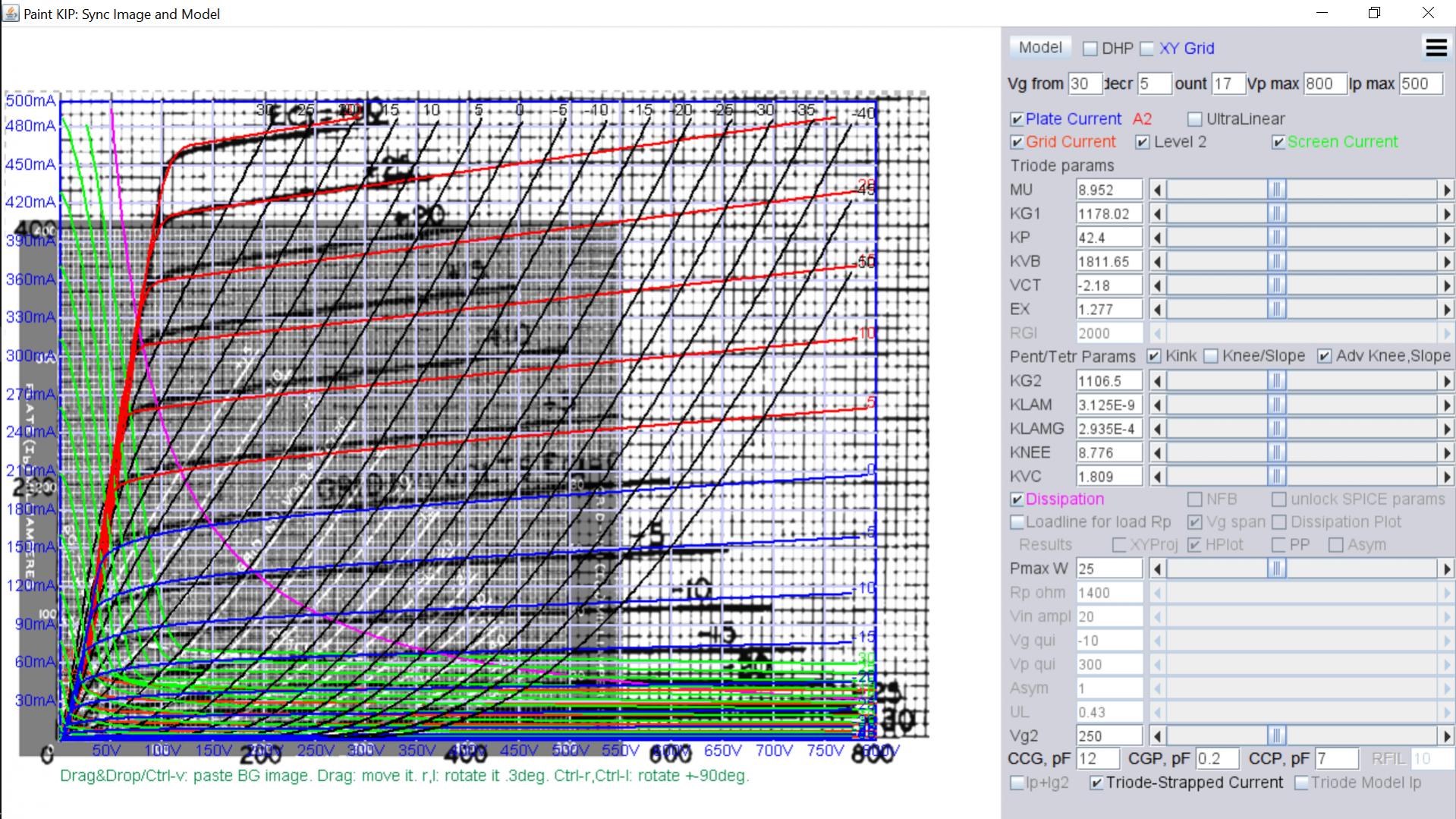

I derived a triode model for EF12 using Dmitry Nizhegorodov's curve mapping tool. I could only manage a close match, after spending a long time on finding a correlation. I like this empirical approach to validating designs, and I am interested in how people build confidence in the models they are using.
The pentode EF12 model I posted in #2810 incorporates g2. However the datasheet only shows curves for Vg2 = 100. I did check the triode connected curves and they looked reasonable to me, but this is a case where a specific triode model may be better.
Here is 807/1625 RCA model, 807 heater is 6.3V, 1625 is 12.6V and pin-out is different. Also attached is Extract V3.000 1625 model but the positive range is somewhat out. These models are similar to 6L6 but more extended Vg1 range.

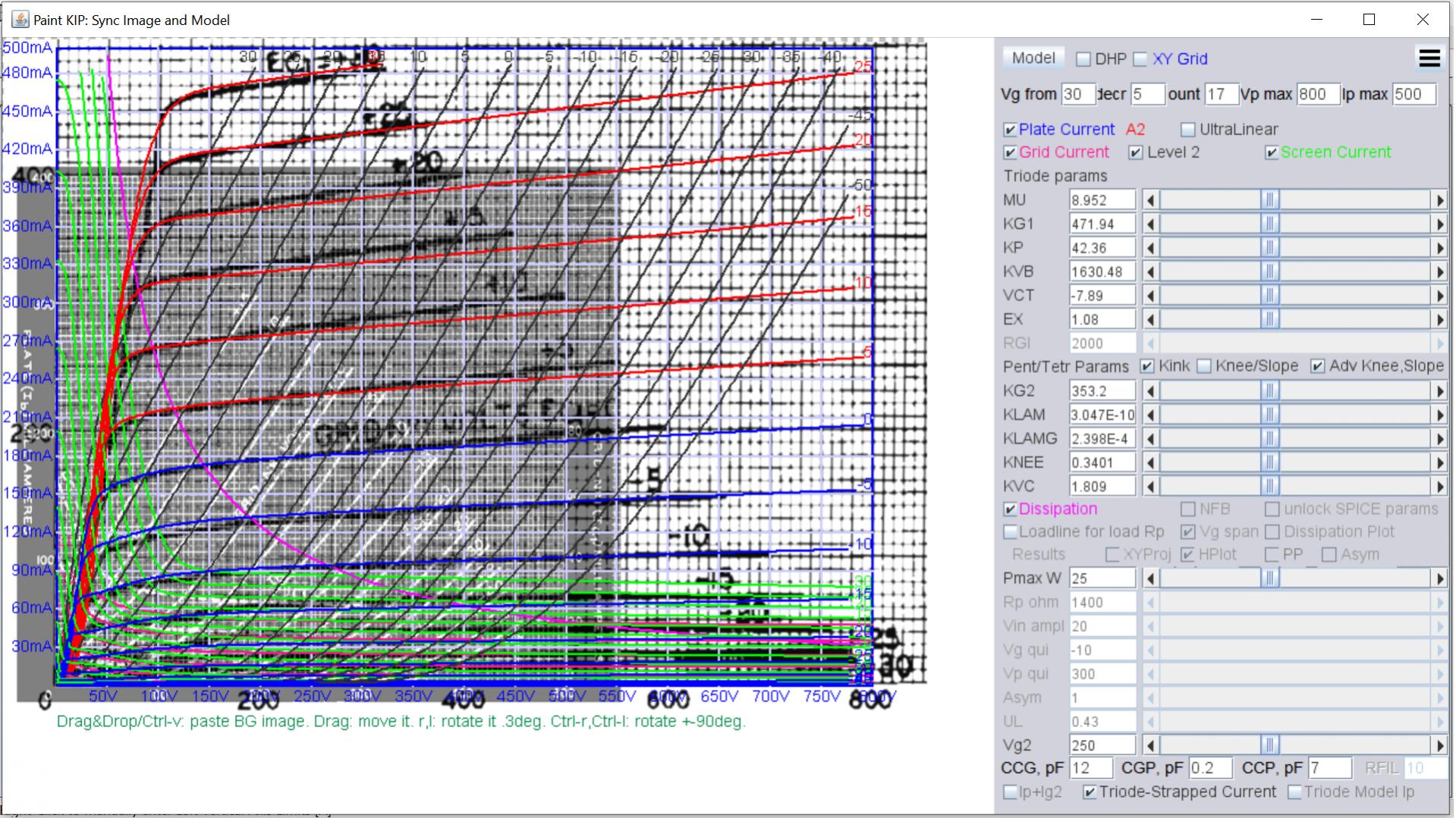

This 807 model is more robust than the previous model as it can be ran in more schematics. I disable some of the options like making KB1, KB3 =0 in Advance Knee Params. The makes the model less complex and easier to be handled by Spice software. Also I recommend using the following option in LTSpice:
.options GminSteps=0
.options NoOpIter
.options SrcSteps=380000
This will make the source steps very small and allow Spice to have sufficient step to complete simulation without premature quitting. It'll take a little longer but it will be completed.

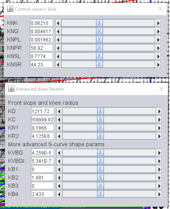

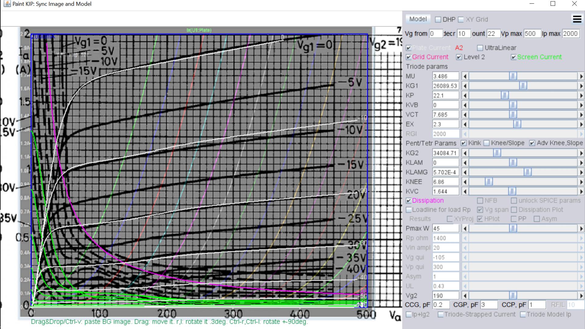

This PL519 Philips has been remodeled again, it runs with following options:
.options NoOpIter
.options SrcSteps=20
Code:
**** PL519_P ************************L1-3******************
* Created on 02/13/2021 20:13 using paint_kip.jar
* [url=http://www.dmitrynizh.com/tubeparams_image.htm]Model Paint Tools: Trace Tube Parameters over Plate Curves, Interactively[/url]
* Plate Curves image file: pl519_p.png
* Data source link: <plate curves URL>
.SUBCKT PL519 P G2 G K ; LTSpice tetrode.asy pinout
* .SUBCKT PL519 P G K G2 ; Koren Pentode Pspice pinout
+ PARAMS: MU=3.486 KG1=26089.53 KP=22.1 KVB=0 VCT=7.685 EX=2.3 KG2=34084.71 KNEE=6.86 KVC=1.644
+ KLAMG=5.702E-4  KD=0.02666 KC=9.92 KR1=0.001573 KR2=0.1656 KVBG=0.005306 KB1=1.027 KB2=1 KB3=0.0756 KB4=2.387 KVBGI=11.84 KNK=7.629E-7 KNG=0.002511 KNPL=8.043E-4 KNSL=8.257 KNPR=181.28 KNSR=55.94
+ CCG=0.2P CGP=3P CCP=1P VGOFF=-1 IGA=0.001 IGB=0.3 IGC=7.44 IGEX=1.3

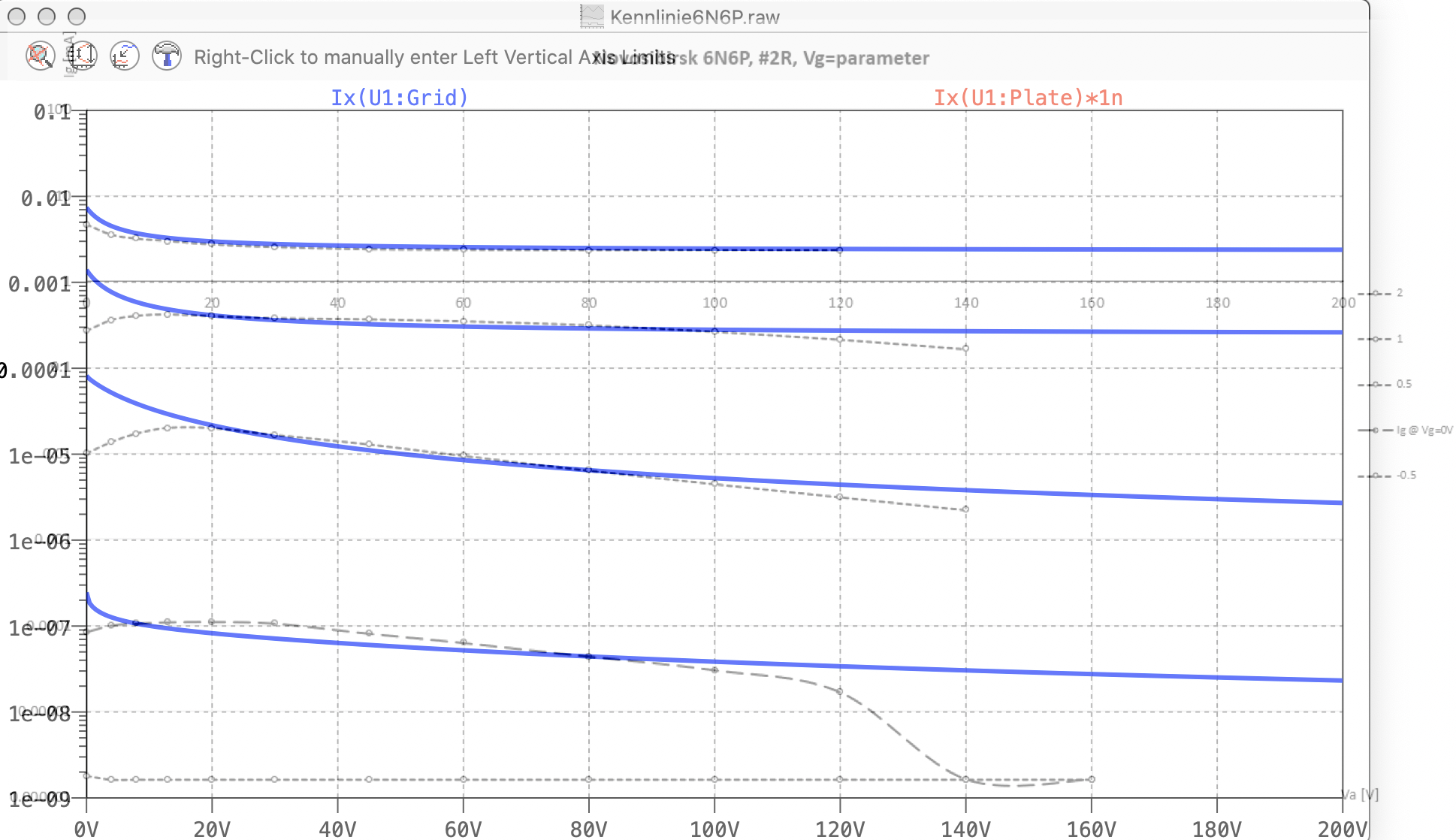

... and here it is, the freshly baked 6N6P model! 😀
Based on the most representative triode out of 4 tubes, all burnt-in for 100 hours.
next tube will be the 6N15P, but it will take a bit more time as I have first to buy some 7pin sockets for the burnin.
cheers, Adrian

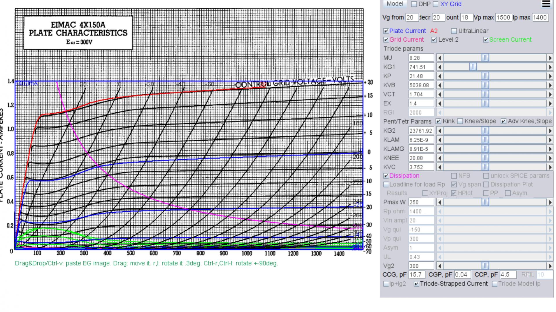

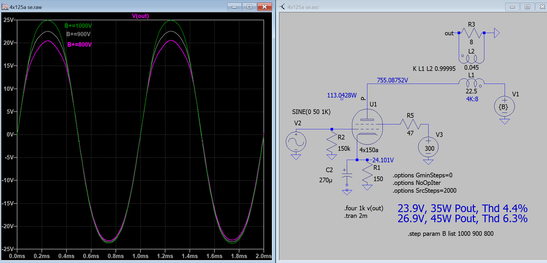

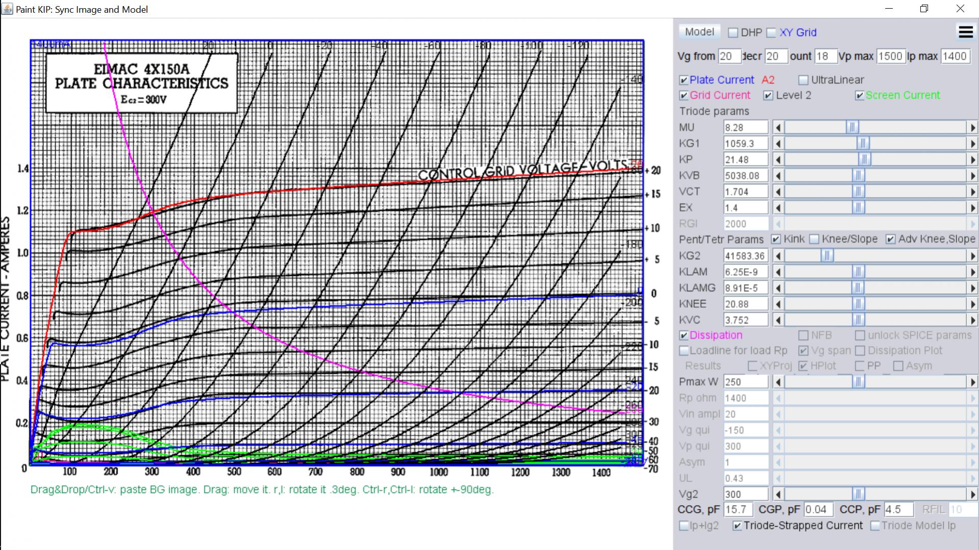

Here is Svetlana 4X150A/7034 model and sch if you need it.
options GminSteps=0
.options NoOpIter
.options SrcSteps=200
The Knee/Slope is sharp and is sensitive to accuracy of the sch in sim.

  • 4x125a se-2.asc
    4x125a se-2.asc
Ia in left side scale of the above model is wrong, now corrected and it's Eimac 4-150A model.
Code:
**** 4X150A *********************L1-3*********************
* Created on 02/16/2021 14:25 using paint_kip.jar
* Plate Curves image file: 4x150a.png
.SUBCKT 4X150A P G2 G K ; LTSpice tetrode.asy pinout
* .SUBCKT 4X150A P G K G2 ; Koren Pentode Pspice pinout
+ PARAMS: MU=8.28 KG1=741.51 KP=21.48 KVB=5038.08 VCT=1.704 EX=1.4 KG2=23761.92 KNEE=20.88 KVC=3.752
+ KLAM=6.25E-9 KLAMG=8.91E-5  KD=1.589E-4 KC=0.01676 KR1=0.002223 KR2=0.0576 KVBG=0.006022 KB1=5.84 KB2=1.34 KB3=0.73 KB4=0.162 KVBGI=0.00118 KNK=0.091 KNG=0.00233 KNPL=3.225 KNSL=46.25 KNPR=278.16 KNSR=86.77
+ CCG=15.7P CGP=0.04P CCP=4.5P VGOFF=-7.5 IGA=7.1E-4 IGB=0.084 IGC=15.52 IGEX=1.84
* Vp_MAX=1500 Ip_MAX=1400 Vg_step=20 Vg_start=20 Vg_count=18
* X_MIN=40 Y_MIN=196 X_SIZE=801 Y_SIZE=390 FSZ_X=1296 FSZ_Y=736 XYGrid=false
* Rp=1400 Vg_ac=20 P_max=250 Vg_qui=-150 Vp_qui=300
* showLoadLine=n showIp=y isDHP=n isPP=n isAsymPP=n isUL=n showDissipLimit=y
* showIg1=y isInputSnapped=y addLocalNFB=n
* XYProjections=n harmonicPlot=y dissipPlot=n
* UL=0.43 EG2=300 gridLevel2=y addKink=y isTanhKnee=n advSigmoid=y
RE1  7 0  1G    ; DUMMY SO NODE 7 HAS 2 CONNECTIONS
E1   7 0  VALUE=  ; E1 BREAKS UP LONG EQUATION FOR G1.
+{V(G2,K)/KP*LOG(1+EXP((1/MU+(VCT+V(G,K))/SQRT(KVB+V(G2,K)*V(G2,K)))*KP))}
RE2  6 0  1G    ; DUMMY SO NODE 6 HAS 2 CONNECTIONS
E2  6 0  VALUE={(PWR(V(7),EX)+PWRS(V(7),EX))} ; Kg1 times KIT current
E4   8 0  VALUE={V(P,K)/KNEE/(KVBGI+V(6)*KVBG)}
E5  81 0  VALUE={PWR(V(8),KB1)}
E6  82 0  VALUE={PWR(V(8),KB2)}
E7  83 0  VALUE={PWR(V(8),KB3)}
E8   9 0  VALUE={PWR(1-EXP(-V(81)*(KC+KR1*V(82))/(KD+KR2*V(83))),KB4)*1.5708}
RE4  8 0  1
RE5 81 0  1
RE6 82 0  1
RE7 83 0  1
RE8  9 0  1
RE21 21 0 1
E21  21 0 VALUE={V(6)/KG1*V(9)} ; Ip with knee but no slope and no kink
RE22 22 0 1 ; E22: kink curr deviation for plate
E22  22 0 VALUE={V(21)*LIMIT(KNK-V(G,K)*KNG,0,0.3)*(-ATAN((V(P,K)-KNPL)/KNSL)+ATAN((V(P,K)-KNPR)/KNSR))}
G1   P K  VALUE={V(21)*(1+KLAMG*V(P,K))+KLAM*V(P,K) + V(22)}
G2   G2 K  VALUE={V(6)/KG2*(KVC-V(9))/(1+KLAMG*V(P,K)) - V(22)}
RCP  P K  1G     ; FOR CONVERGENCE
C1   K G  {CCG}  ; CATHODE-GRID 1
C2   G P  {CGP}  ; GRID 1-PLATE
C3   K P  {CCP}  ; CATHODE-PLATE
RE23 G 0 1G
GG G K VALUE={(IGA+IGB/(IGC+V(P,K)))*(MU/KG1)*
+(PWR(V(G,K)-VGOFF,IGEX)+PWRS(V(G,K)-VGOFF,IGEX))}
.ENDS

This 4X150A RCA model, work without any options:
Code:
**** 4X150A *******************RCA-7***********************
* Created on 02/17/2021 15:16 using paint_kip.jar
* [URL="http://www.dmitrynizh.com/tubeparams_image.htm"]Model Paint Tools: Trace Tube Parameters over Plate Curves, Interactively[/URL]
+ PARAMS: MU=5.913 KG1=2283.64 KP=19.38 KVB=5038.08 VCT=-5.253 EX=1.669 KG2=6032.41 KNEE=1881.54 KVC=1.954
+ KLAM=4.043E-12 KLAMG=6.77E-5 KNEE2=50.56 KNEX=4.795E7  KNK=0.1336 KNG=0.001604 KNPL=0.04744 KNSL=176.92 KNPR=243.07 KNSR=91.92
+ CCG=16P CGP=0.03P CCP=4.4P VGOFF=-7.5 IGA=7.1E-4 IGB=0.084 IGC=15.52 IGEX=1.84
* Vp_MAX=2000 Ip_MAX=1600 Vg_step=10 Vg_start=30 Vg_count=17
* X_MIN=60 Y_MIN=27 X_SIZE=718 Y_SIZE=574 FSZ_X=1296 FSZ_Y=736 XYGrid=false
* Rp=1400 Vg_ac=20 P_max=250 Vg_qui=-50 Vp_qui=300
* UL=0.43 EG2=250 gridLevel2=y addKink=y isTanhKnee=y advSigmoid=n
RE21 21 0 1
E21  21 0 VALUE={V(6)/KG1*ATAN((V(P,K)+KNEX)/KNEE)*TANH(V(P,K)/KNEE2)} ; Ip with knee but no slope and no kink
* Alexander Gurskii screen current, see audioXpress 2/2011, with slope and kink added
RE43 43 K 1G ; Dummy
E43  43 G2 VALUE={0} ; Dummy
G2   43 K  VALUE={V(6)/KG2*(KVC-ATAN((V(P,K)+KNEX)/KNEE)*TANH(V(P,K)/KNEE2))/(1+KLAMG*V(P,K))-V(22)}
RE23 G 0 1G
.ENDS
