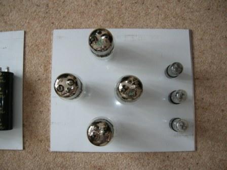

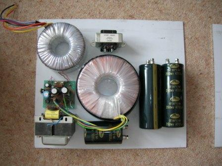

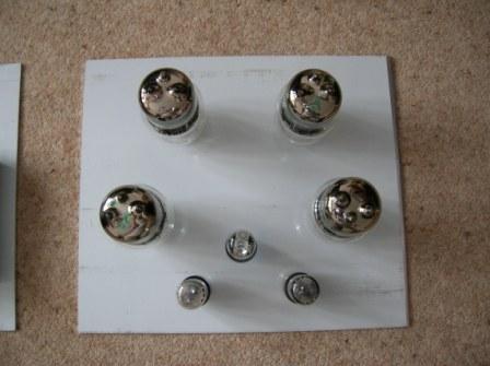

Just for interest,
A few ideas of layout.. I'm not slacking. 🙂
Still a lot of thought to go into it!
