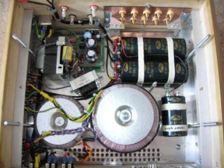

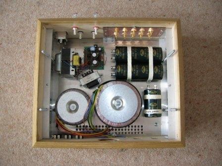

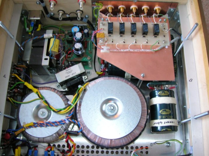

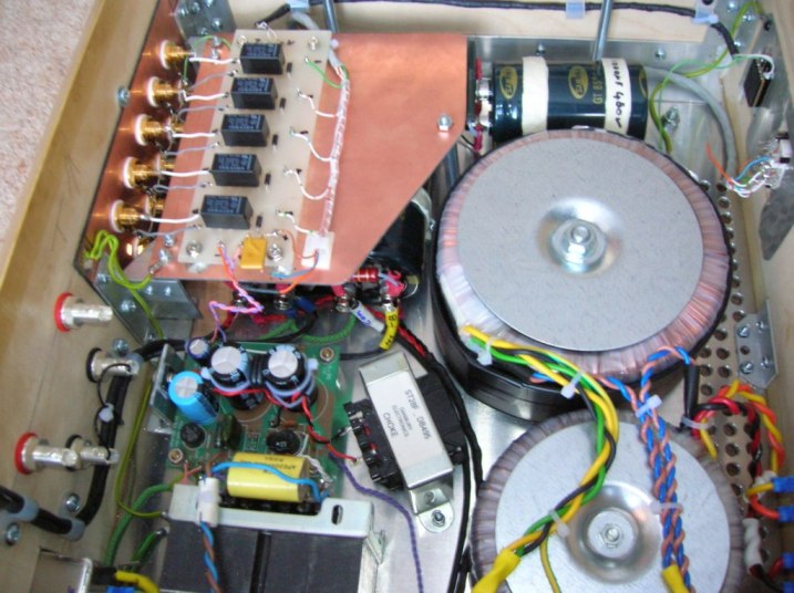

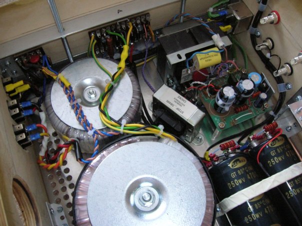

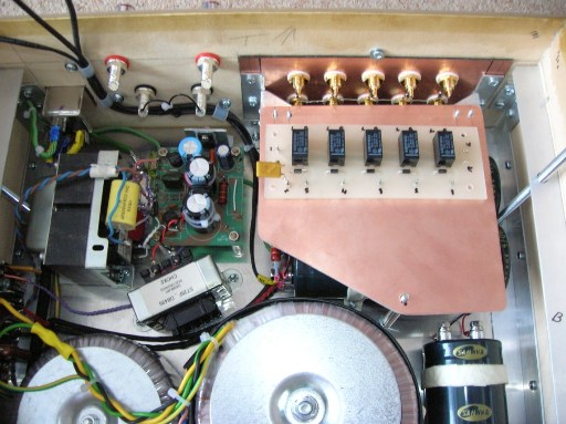

Just for interest,
PSU wired giving +/- 180V off load.
Ultra fast soft recovery diode bridge.
PSU for preamp & driver tubes.
Polyswitch fusing.
Also a picture of the relay select board in mounting position.
Regards
M. Gregg
Polyswitch fusing.
Regards
M. Gregg
Coming along really well!
I think though, with 180V you may need to increase the value to the 6C33C Cathode-Resistors, up to say, 220-300 ohms....
Check the current, and set to around 180-200mA....

Relay input board connected.
Just for interest.

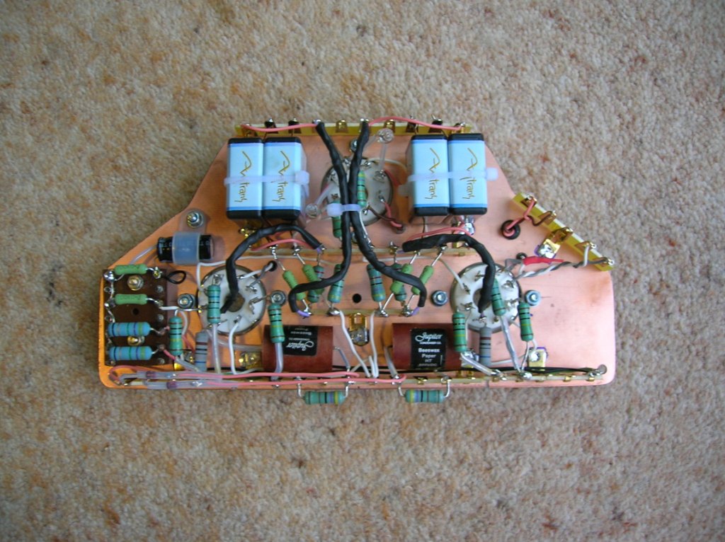

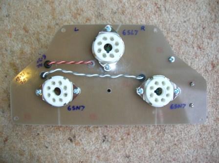

Just some more progress,
Just for fun.
Driver/preamp board.
I wanted to compress it into a small area away from the 6c33c's.
So point to point wiring.
Just connections for the IRF710 to do.
Feedback is via PTFE home made screened cables.
Bias supply cap is Rubycon HV.
Coupling cap is Jupiter, Amtranz.
Takman resistors.
Heaters should be DC for the pre/ 6SN7's if all goes well!
and AC for the 6SL7.
Heater cables run across the back of the board to shield them from the pre circuits.
The board only provides screen no signal transfer. star Gnd.
Still on going, lots to do!
Regards
M. Gregg

Regards the 6SL7,
Neon protection for the DC coupled stage.(grid cathode) has been fitted!
Just for interest the top plate shields the tubes from the Heater cables.
Alastair,
What voltage do you have on the anode of the driver tube?
(6SL7) in my circuit. So I can check the bias point, thank's.
