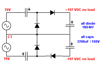

Regarding the power supply for the output tubes, most need bipolar 150VDC.
I have an good offer for 70-CT-70 VAC power transformer. With only a simple full wave rectifier i will only end up with approx 70*1.414 = 98 volts at no load, this is not enough. However, is a voltage doubler out of the question? Something like shown on the attachment.
With that doubler, i will get 70*2.828 = 197 VDC. I am allowed to drop 197-150 = 47VDC when amplifier is making 25W at output rms current of Ipeak 2.5A / 3.14 = 0.8A. So..
Electric Charge (Coulomb) = 0.8 * (1/50Hz) = 0.016 C
Capacitor size (Farad) = 0.016 / 47 = 0.00034 F or 340 uF. Since i'm charging two caps per rail, then i need at least 340 x 2 = 680 uF for one channel. Since i'm running stereo, i will need 680 uF x 2 = 1360 uF. I think 2200uF would be a good size then?
Can anyone immediately see if there's something wrong with my calculation and my schematic?

You are allowing something like a 47V sawtooth ripple on a 197V supply, is that the idea? Sounds like a recipe for quite a lot of hum. Not to mention a lot of heating through losses in the capacitors.
I don't have a good answer for how to drop the excess voltage in a satisfactory way. As far as the voltage doubler idea is concerned, I should have thought you would be better off just connecting the transformer secondaries in series, grounding one end, and half-wave rectifying the top end (140V rms). That is two say, two half-wave rectifiers, one for the positive supply and the other for the negative supply. (So there would be approximately a current balance between the positive and the negative half cycles in the transformer.) Your voltage doublers are in any case half-wave rectified, so you would be no worse off. In fact I think you would be better off, not needing the doubling.
You would still have the problem of the excess 47V on each supply. I don't see a good way to drop that. I certainly don't think it would be a good idea having a huge sawtooth ripple on the capacitors.
Chris
Do you mean getting TWO transformers and connect them in series? This kills the wallet. Also 140 VAC half wave rectified would only give me 140*0.707 = 98 volts.. Not to mention the offer is for only one transformer 🙁

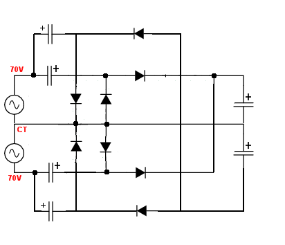

That 47V ripple will only emerge when i pull 25W from the amp. When idling it would be much less since the current demand is also smaller. I'm thinking of how class AB doesn't need as good filtering as class A. Am i thinking correctly here?
The attached schematic, assuming it works, should have even lesser ripple since it uses fullwave rectifiers for each rail.
No, 140 VAC (rms) will give 140 * sqrt(2) when half-wave rectified, which is about 197 V, on no load. (Assuming, of course, that you use a smoothing capacitor after the rectifier!) What happens when it is loaded will depend on the size of the load, the current supplying capabilities of the power transformer, and the size of the smoothing capacitor. Essentially you will get a sawtooth waveform. Each time the 140 V rms sinewave reaches its positive peak (at about 198 V) the voltage on the smoothing capacitor will be replenished to this level (minus the voltage drop across the diode). It will then decay down until it is replenished to about 197 V again in the next positive cycle. (I'm assuming here for simplicity that the power capabilities of the transformer are not limiting the ability to recharge the capacitor to the peak voltage again.)
The full-wave voltage doubler is certainly another option. I'm not sure if that would be better or worse than a half-wave without doubling, as described above.
Chris
