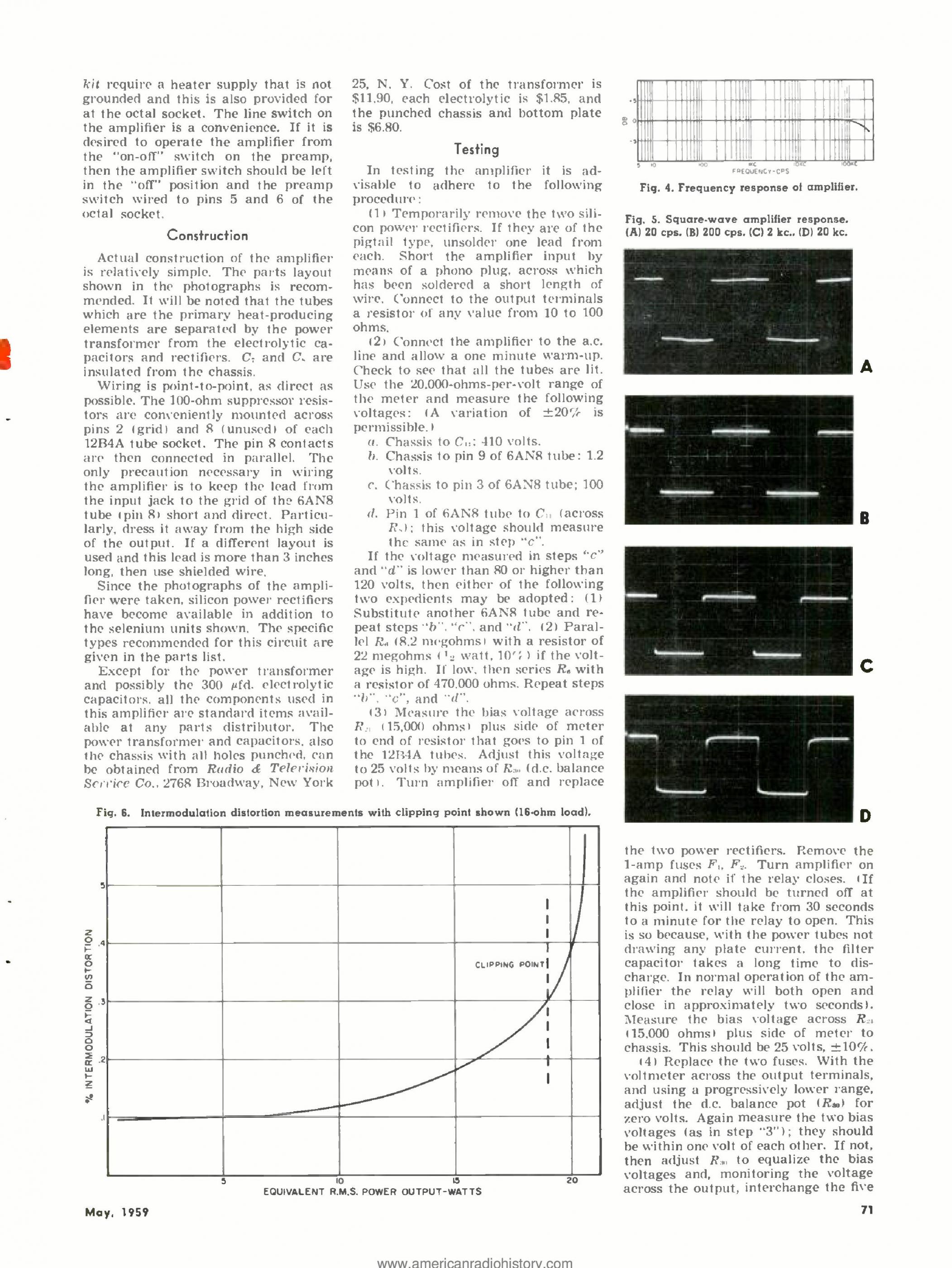

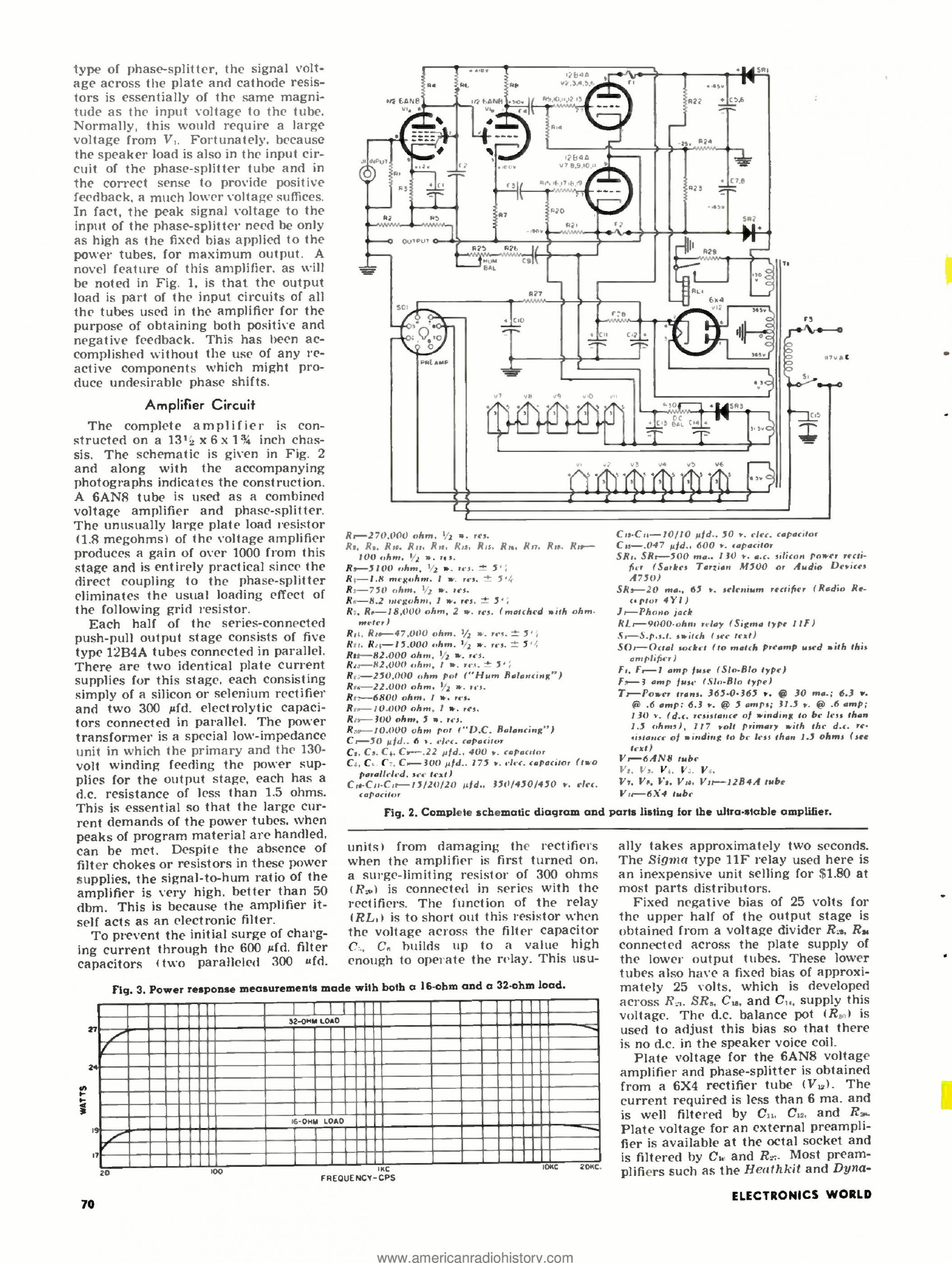

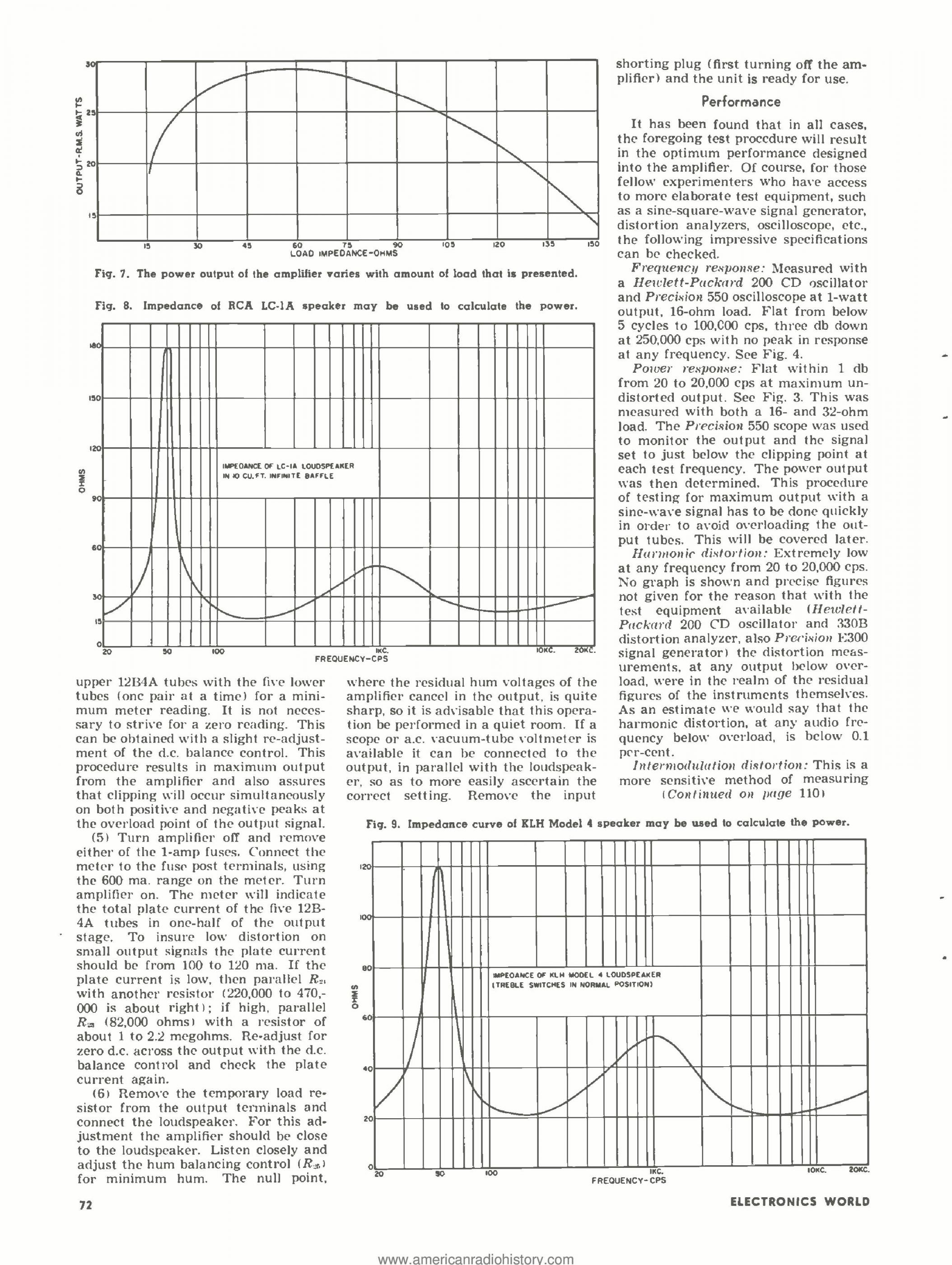

B+ for split load phase splitter need to be around 400VDC to achieve good output swing .
BTW , for your information read this attached old OTL article from J.Futterman , and if you have chance read AudioXpress magazine , issue from May 2014 , OTL article from Mr.F.Camorani & M.Pagogna .
( and yes , my personal opinion is that Circlotron OTL is much easy for DIY . )
Best Regards !
Best Regards !

Thanks a lot for that article. Reading it now..

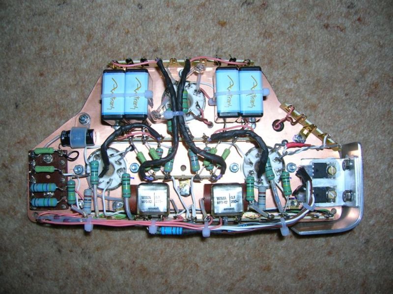

here's where i am so far..
nearly finished the front end. just waiting for some 2-watts resistors to finish the job (thanks to suggestions to raise the cathodyne's voltage).
6N2P gets regulated 6 volts from 7806 while 6N6P's heaters are connected in series for 12 volts coming from cheap ATX PSU.
Here's the all-important speaker protector for when the tubes decided to short-circuit. Didn't bother making this since it's only about USD 2 completed.

Why didn't you use plain PCB and solder tag strip to it, instead of perf board..😕..you need to remember this is about current not just voltage.
EG. in the picture..
If your coupling caps fail you will red plate the 6C33C..what voltage rating are they?
Make sure you have a very thick earth to the speaker Gnd..
You need to think very carefully about the heat in this amp..
EG how hot is the regulator going to get?
And whats the voltage rating of the resistors you have used? Please be very careful...
Your safety is up to you..however please don't underestimate the heat and supply power. 🙂
