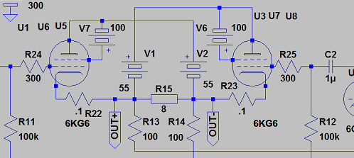

If you want to go low voltage Ua, don´t forget PL519 in enhanced triode mode(or whatever you want to call it), see example. Works well with something like Ua 60-70V and Ug 100V floating on top.
Yes - and this is a good example of passing Ig2 through the load, rather than having it lost, so it works like a triode. The circuit does present some challenges as to naming 🙂 - one could call it 100% UL too 🙂
Full pentode would have a local regulator for each G2 referenced to the cathode of the same tube (regardless that the actual G2 current comes from the other cathode).
BTW there was a brief aside on G2 drive. A lot of swing is required, far more than the output signal - a couple 100 Vpp is not unusual. It's often dealt with by having a class B or C driver to prevent needlessly driving the G2 of the output tubes into hundreds of negative volts while the outer PP side gets full drive. G2 drive is also generally very linear, one could almost say too linear, thus best suited for class B amps, provided good control of the crossover region (biassing may be 'fiddly') - the crossover region is very small and needs to be fairly tightly controlled to avoid gm doubling-like effects (very similar to a BJT output amp).
Since we'd be passing a lot of current through the tubes, their net gain WRT Ug2 would be far below 1, so it's a rather 'bad' follower. Still, consider a build like in the pic above (except with drive to G2 and G1 at a fixed (slightly positive?) voltage - at zero output, the tubes are in the middle of the crossover area and there is no feedback to the drive voltage, so this still needs to be well controlled for bias and offset stability (note that some sweep tubes need quite a lot of time to stabilize and have quite big tolerances to begin with). However, at full swing, especially for tubes with low G2 voltages (and these would be preferred in such an application) there is considerable feedback as the cathode tries to follow Ug2. This mechanism does make the bias setting a bit more 'soft' and more manageable WRT a transformer coupled amp with G2 drive, but one still needs to provide hundreds of V, sourcing current, and at negligible distortion...
