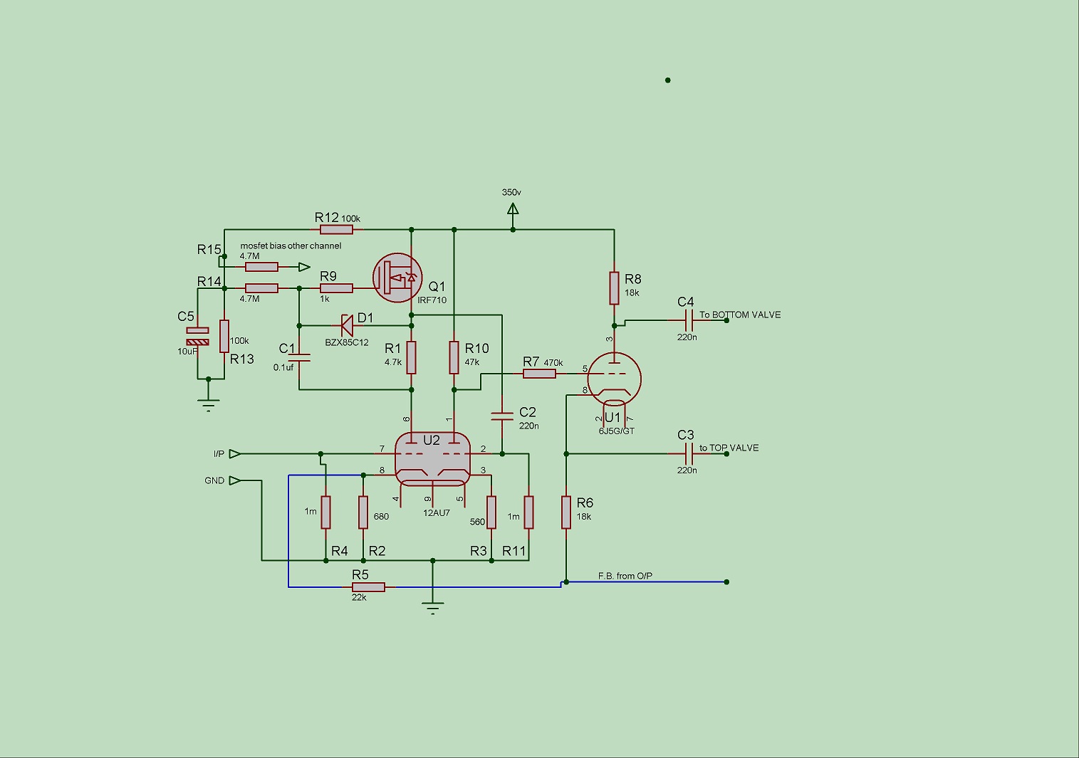

Here you go.....
--Its a complete re-draw, so the part references will be different....

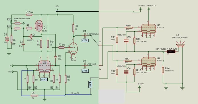

A few questions!
U2 = 12AU7?
I guess this is 6SN7? 🙂
R12/13 only has value of 2X100K not total 300K a before?
C5 is now 10uF not 1uF?
Q1 IRF710 not 830?
C4/C3 220n not 470n?
LOL just checking.

You're sharp tonight!--Well spotted!
12AU7 was used in the schematic as I havent a 6SN7 'part' in the library, and didnt update its reference....
6SN7 used in real-life though, just check its pinout when you come to wire it up--Not the same as a 12AU7!....😉
R12/13 are just potential divider, so long as they are equal in this version, no probs, as we are wanting approx half +B for the MOSFET Bias to the first half of 6SN7.
The previous input stage had this voltage at approx 1/3 of +B, to set bias on phase-splitter--That now comes from the second 6SN7 common-cathode stage feeding it.
C5 can be anything around 1-22uF, its not a critical part, just additional smoothing for the MOSFET Bias--You could add a film cap across it too if you like.
--This same MOSFET reference voltage is used for both channels.
Q1, IRF710 has lower Gate-Capacitance than the IRF830, but in the simulations Ive done, it makes very little difference. The breadboard still uses the IRF830 as I havent got the IRF710 yet. Open loop bandwidth is well over 100KHz anyway.
--Works happily with the IRF830, so if you have those, they'll work fine.
C3 and C4, Should be 0.47 or 470N. The 'default' on my Proteus schematic capture is 220N, My error for not correcting...

C3 and C4, Should be 0.47 or 470N. The 'default' on my Proteus schematic capture is 220N, ...
Alastair,
Your help is very much appreciated...I think it's great that you have overcome the feedback issue. 🙂
Just me checking that I use the correct parts!

No 470K in the FB loop. Its joined directly, so that the 18K on bottom end of phase-splitter sits on the O/P line....
C2 is 0.22 or 220N I'm using and works well....
If you wanted to pull up the LF pole, you could reduce its value to 0.1 or even 0.047....
Ok thank's,
Just short out the 470K..OK

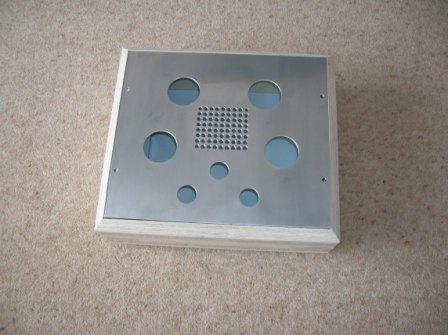

Started building the chassis..
<<<< always takes a while!

Chassis work is always a time consuming process!

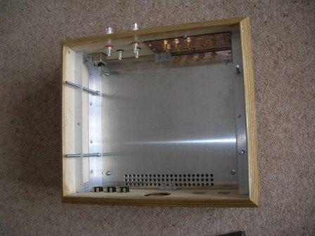

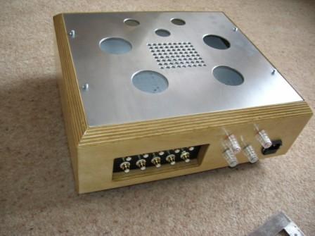

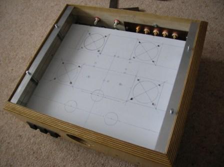

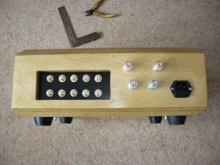

More slow progress.. work is getting in the way..LOL
I can start the internal build now the chassis is strong enough.
I will add more vent holes as I build, so it's still pulling the air from the front and around the top via the tubes and cathode resistors.
Inputs mounted! Lots to do.
Regards
M. Gregg
Regards
M. Gregg
