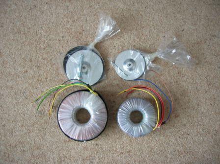

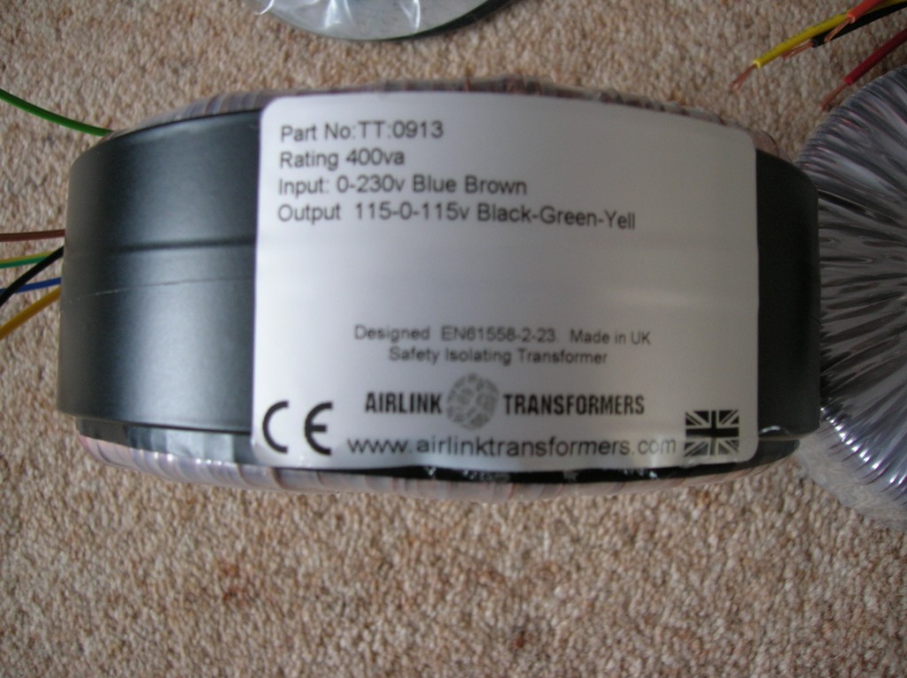

Alastair,
Regards power Tx's,
Looks like: from AirLink Tx as suggested,
TT0913
VAL 1601
0300225 <<< no hum with a bit of luck. 🙂
Do these look OK?
Regards
M. Gregg

Yes, This is the spec from their website --
VA: 400 VA.
Power: 400VA Toroidal Transformer
Secondary: 115-0-115vac Bifilar wound connected in series (200mm flexible leads 16awg)
Primary: 230vac (200mm flexible leads 16awg)
Core: Unisil: M089-27N
Copper: OFC 99.99%
Dimensions: 145 x 65 (mm)
Faraday shield: Electrostatic screen with earth lead
EMI/RFI Shield (2 layers of GOSS steel band)
Standard: EN61558-2-6
Fixing: Standard Hardware 2 pads + steel dish washer
It does look a great Tx, Might even get one myself for a Mk II one day....
I guess there's scope with this Tx to supply 4 6C33C per channel if you wanted to go bigger, definately fine for just the two per channel!....
--But then you're getting Bigger and Hotter, adding complication, something I'm thinking you are trying to avoid!
Ive found that a good, stout power-supply for the O/P stages for Any OTL is one of the deciding factors for good sound...
Weak saggy supplies need not apply!
The 'HT' trans (+B) you're looking at their 'VAL1601' Guess you could use this, although its rectified voltage would be well over 400, and its current rating well higher than you'll ever need for the pre-amp stages--Guess you can 'lose' some volts over CRC filter and maybe a valve rec though....
I use the simple 'Pre-Amp' 250V 100mA and 6.3V 3A from 'Maplin' This gives me 350V rectified, (SS rec.) which is fine...

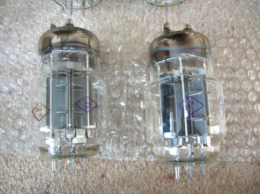

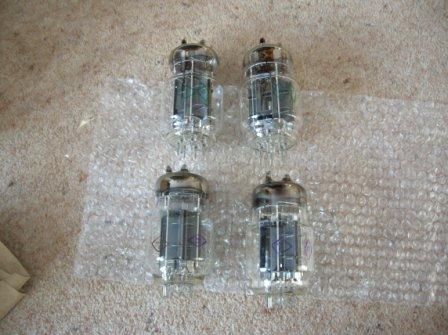

Just a pic,
Got the 6C33c-B's today from Russia. Only took 2 weeks!
Starting to collect the parts..going to take a while.
Just for fun 🙂
