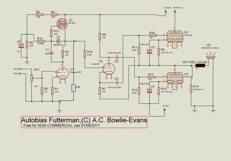

So the PSU is Bi-polar + / - 150vDC, and 350vdc.
ss rectifiers?
What transformer have you used, current rating / voltage -make...LOL

PSU is completely standard. a SS Bridge-rec, after a large toroid I had floating round, I think it was an Isolating transformer...
I do have large 'RIFA' screw-term 3300uF 200V leccy-litics in each 150v rail, de-coupled by a couple of 10uF plastic caps...
The 350V supply is from a separate 'Maplin' mains Tx with CLC filtering....

Thank's Alastair,
I may take this forward just for fun.
Is the SS rectifier just a standard bridge / or Hex ect?
Any snubbing used?
I guess no regulation?
With CLC filtering any Ideas on value of L you have used?

Yup--standard ss bridge, no 'snubbing' and no regulation
The choke on the 350V line is 10H and 100uF caps, and SS rec.....

Personally, I wouldnt bother with PCB's --especially if you're using 6C33C tubes--WAY too hot for 'em!
Nah, its all p2p wiring, no PCB for mine...

Alastair another quick question,
What is the distance you have between the 6C33B's / distance to any Tx.
DO you use series heaters for each tube and parallel the two in the left and right or series all heaters in left channel / same in the right?
Each in series would give approx 4A per tube? 8A parallel.
I have seen someone mention neon protection for the speakers, do you have any thoughts on this?

All 6C33 heaters series-wired, supplied by 25V 5A, x2 Tx, a two-secondary toroid supplying them.... The three Tx are mounted down the centre of chassis, on top of case, I had to run a strut under them, with a 'leg' down to the bottom to stop the cheapo case sagging!
--As I said, It aint pretty, Hence no pics! but its a reasonably safe and usable machine
There's about 2.5" between any 6C33 and any other tube/item. There's spacers under the sockets leaving a small gap between them and chassis, there's also a PC fan in the case, running from rectified 6.3V, running under the 6C33 sockets. Its very quiet, only running at half-speed or so, the air can pass through the gap by the sockets up the sides of the valves....
--Ive mounted the caps under the chassis, inside the 'box' feeling that these should be kept as cool as is possible.
Heat doesn't seem to be a problem, although I certainly wouldnt grab a tube after an hours playing!
Not heard of the 'neon' thing, but wouldnt have thought a neon would protect a speaker. The 1.5A a/s fuse is sufficient IMO. Ive never had it blow--Yet, and Ive done some daft stuff with it....

Few more questions..LOL
Did you twist the heaters cables?
Next question,
U1 is 6sn7 "strapped" I assume you mean using both sides of the 6sn7 as one triode. ie. Anode to Anode, grid to grid cathode to cathode?
Not one half on each channel?
One more question,
What are the hottest components in the circuit "not the tubes"
R9, 10, and 14 come to mind. Any special precautions you have found with position?

Yes, the heater runs are a twisted pair...
The 6SL7 is connected A-A, G-G, C-C,--ie, Paralleled out...
--Its a 6SL7, not SN7....
R9, R10 are the highest dissipation, I used standard 17W WW resistors.
R14 from speaker out to earth doesnt really get warm even.
The Phase-Splitter resistors need to be 2W at least as these get pretty hot, Nothing much else except the MOSFET gets warm really, and that is mounted on the case which is fine...
--Just noticed, Ive omitted a resistor in the schematic---😱
Need a 22K from top end of R3 to earth, (Joint between R3 and R16 to earth).....🙄

LOL, 🙂
Like this?
Do you start the heaters first then time in HT or all togeather?
6SL7 --ECC83 did you try an 83 or do you prefer the octal?

Yup--Thats correct on the resistor placement...
No, +B and heaters all on from stone-cold....
