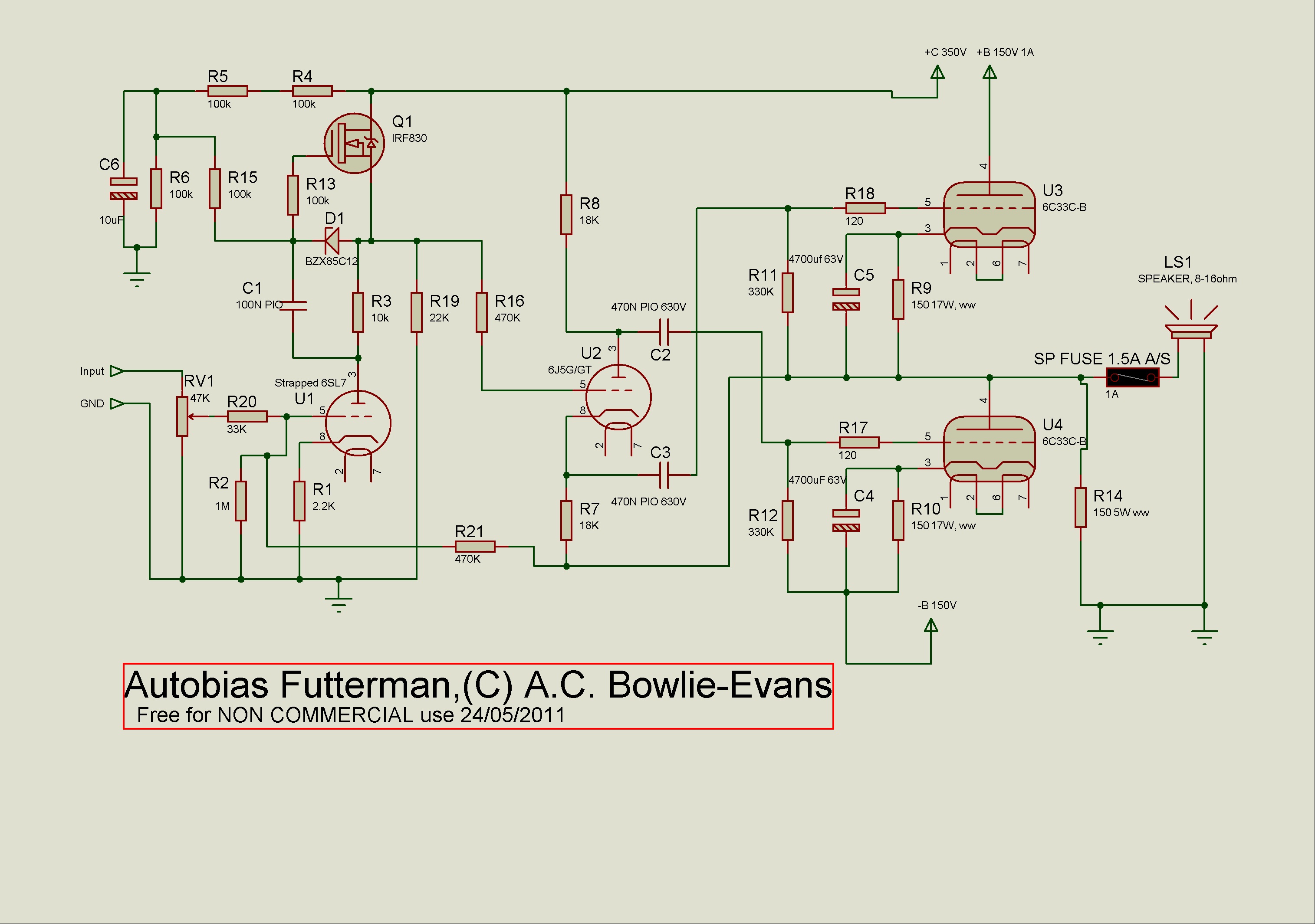

Hmm....
Thats not a bad plan, but a little concerned about the cathode-idling-current, May be a little high for just one cathode--may also need to change/make switchable the cathode-resistor to compensate...
Dunno---
My 'breadboard' of this still usable (Although gone through more variations than a Ford Transit) so I'll play around with the 6C33 valves and one cathode only....🙂
Dunno---
Hmm--Then again thinking about it, I didnt change the cathode-resistors when changing from the 6C33 to the 6C41C, so will Probably be OK....
I'll check and let you know what I find anyway...

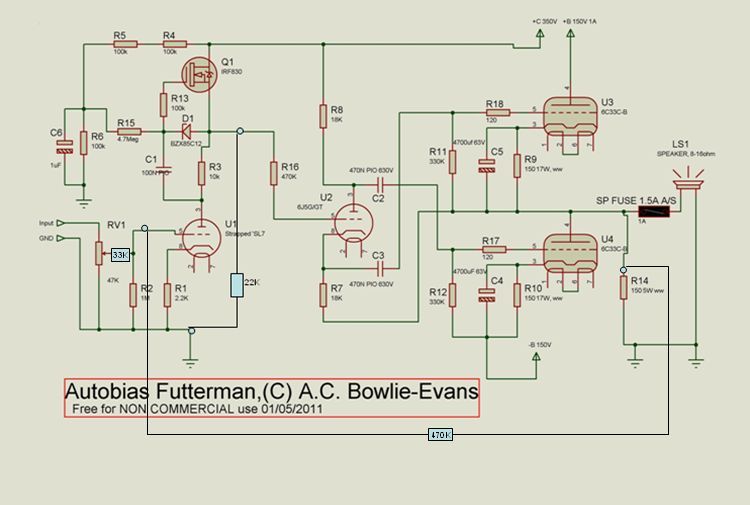

If you want to reduce the effects of single-cathode operation and lower the O/P impedance, a nominal amount of global-feedback can be applied into the grid of the first stage, a la Tim-Mellow OTL.
Use a 33K in series with the vol-pot wiper to G1, and a 470K from O/P to the G1 of the first-gain stage.....
Ive tried this, and although it does reduce the overall gain somewhat, it will minimise the effects of a higher o/p impedance using 6C41C or single-cathode 6C33C operation at lower powers
Try it with, and without GNFB, Vary the amount even--See which you personally like the best, Thats the great thing about DIY-Audio....
Personally, I think I prefer without, but I'm giving it a few days listening now with to decide....🙂
Here you go, Ive re-drawn the scheme, tidying it slightly and including the 22K omitted and the nfb loop....
--Just noticed, during cleanup, ive not put correct value for R15. This should be 4.7Meg, not 100K
