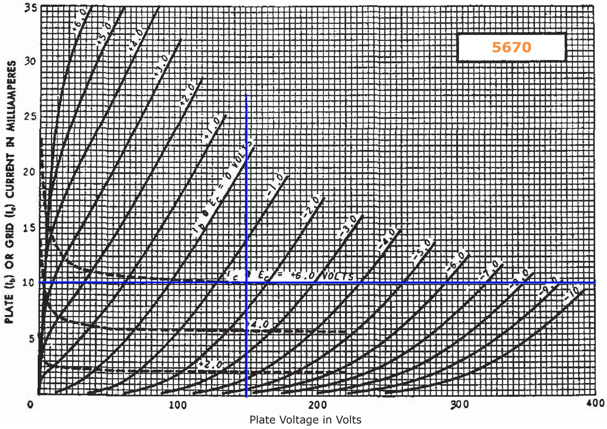

Yes the E88CC that's interesting I will have a good look at its datasheet. It is very similar to the 5670. Here is a characteristic curve for the 5670 showing positive Grid values:

This method of bias was also specified for "wideband" or "baseband" amplifiers, designed to carry the information part of microwave links and other analog era long distance comms. High Gm pentodes were more commonly spec'd, with +9VDC commonly seen for G1, and and appropriately large-ish cathode resistor to give a stable cathode current.
Yes the 5670 was an US manufactured tube specified for military use so I guess they used it for all kinds of jobs including microwaves. I plan to say more about bias later on below, thanks.

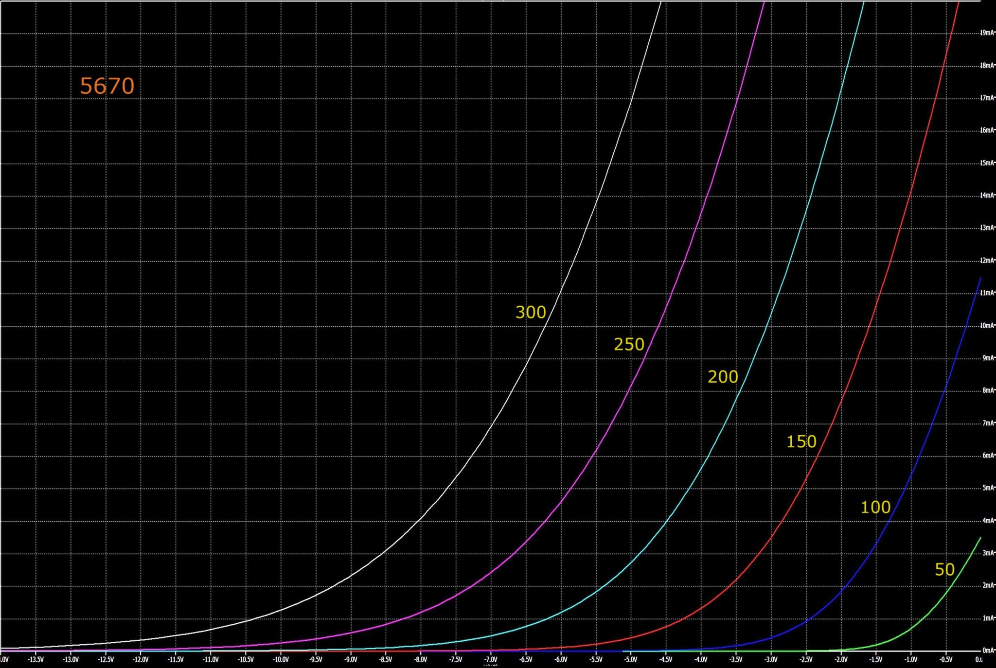

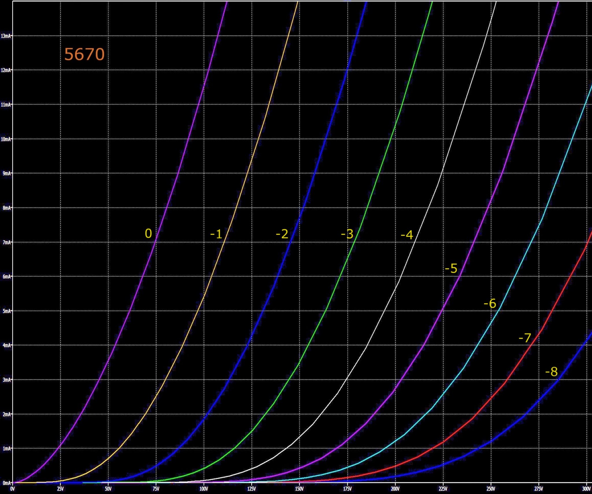

I'm not saying this is useful but its possible, then you get a graph of Anode current versus Grid voltage at constant Anode voltages. Here is the graph of Ia vs Vg at a few values of constant Va 50V 100V 150V 200V 250V 300V for the 5670 Triode:
What it says to me is that the relationship between Grid voltage and Anode current is very non linear at low Anode currents. This graph is the main reason I choose an operating point at 8.192 mA Anode current and 131 Volts Anode voltage. You can see that this point would be as linear as most. You can't go up from here for DC bias because if you choose say 12 mA at 200 Volts yes its linear but it dissipates too much power in the valve/tube. Its 2.4 Watts whereas the Absolute maximum dissipation for each Triode in a 5670 tube is 1.35 Watts.

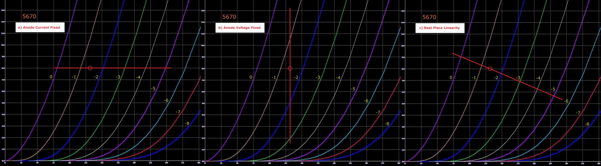

But what else can we do? Here are some of my options as far as I see:
- Hold Ip constant - Anode current never changes, Vp the Anode voltage (from Anode to Cathode) at DC bias is fixed but changes as input signal changes.
- Hold Vp constant - Anode voltage (from Anode to Cathode) never changes, Anode current at DC bias is fixed but changes as signal changes.
- Vp and Ip at DC bias cannot change but Vp and Ip can both change as signal changes.
I still have three bias options, Constant current a) Constant voltage b) or Freestyle - best place for linearity c):

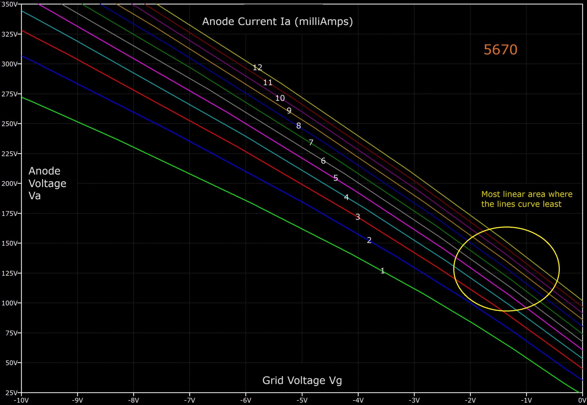

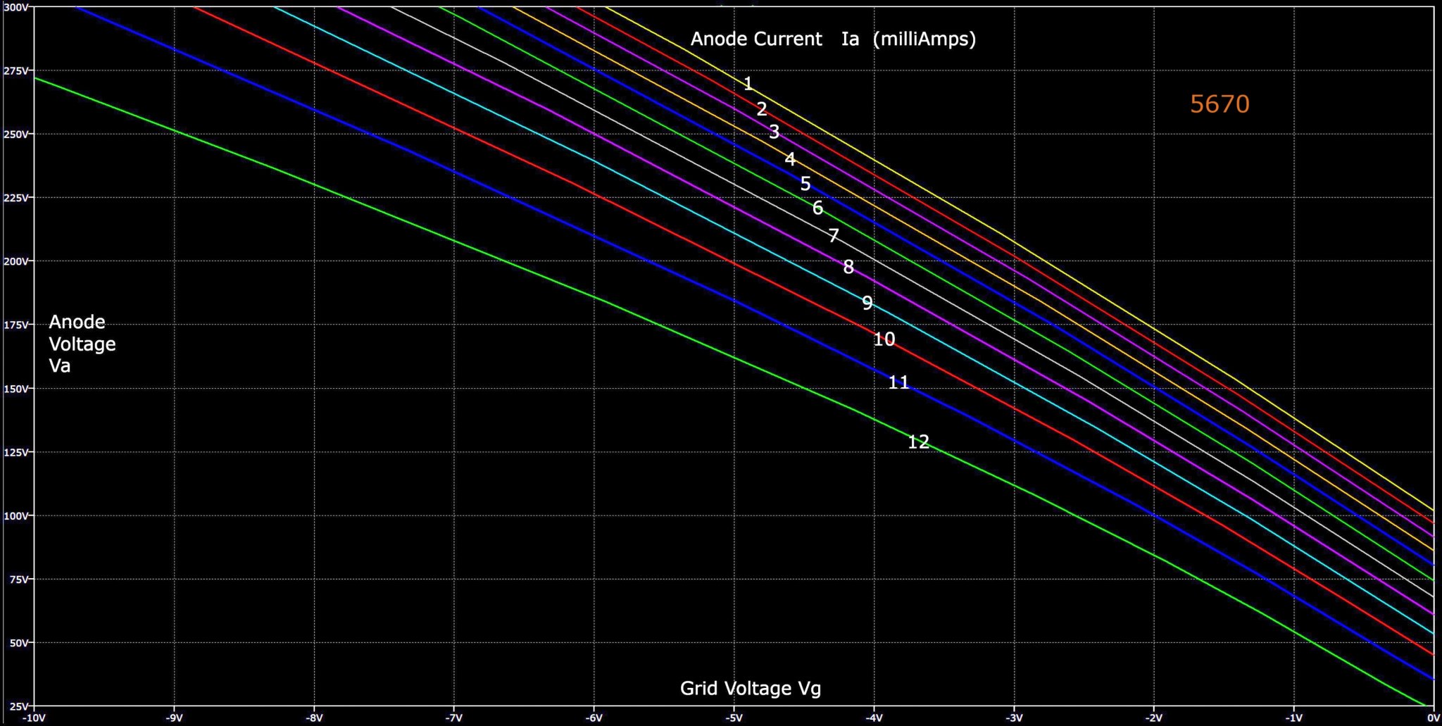

Some of you say that constant current is best that's a) above. So I asked, assuming constant current is the relationship between Grid voltage and Anode voltage linear and the answer is - no its non linear. To show this I realised that I needed to plot a third graph for the 5670 tube and the graph is Anode voltage against Grid voltage for lines of constant Anode current for the 5670. So here are the three graphs for the 5670 starting with:
Va vs Vg:
The non linearity is the curvature of the constant current lines, they all curve. Looks like the best places are where Va is between 75 Volts and 200 Volts also where Vg is in the 0 Volts to -3 Volts range. The 12 mA line bends a lot.
Ia vs Vg:
Va vs Ia:

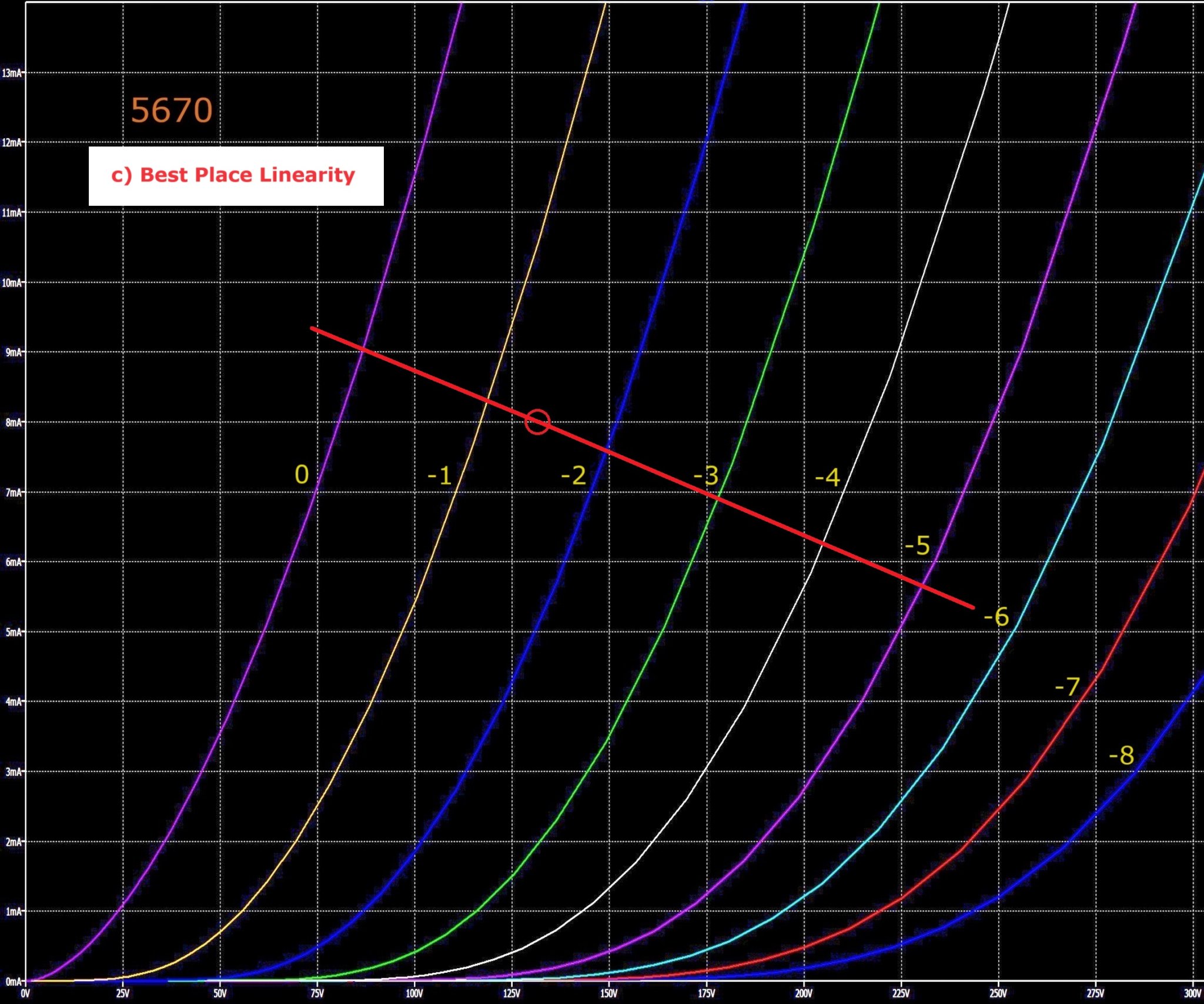

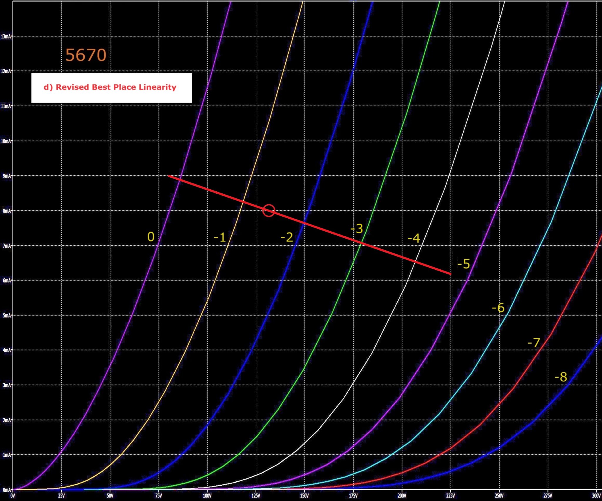

So I still think that this load line is the best place linearity for the 5670 tube:
What you think please?

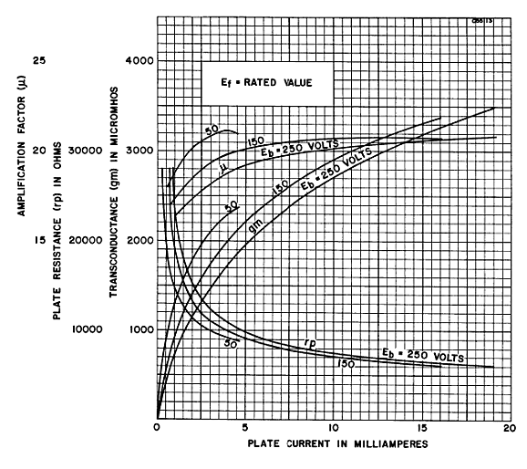

I've always found these curves more useful.
Yes, more useful than what?
To be honest I don't understand what the gain and transconductance curves are saying about linearity. Other than to say that a fixed value of gain would imply perfect linearity.
The 5670 has modest gain but using local negative feedback to reduce distortion seems like a good idea, even then there is still some THD left over.
As an example for the Transconductance at Va of 100 Volts, Vg of -2 Volts the Transconductance is 2500 microMhos. That's like saying the resistance between Anode and Cathode just there is 400 Ohms.

Not in that form, but you are indirectly potting the constancy of mu. Such graphs were very occasionally published (6SN7):PS I never saw this on any datasheets! Did tube manufacturers ever plot this into datasheets?
I agree with you but the graph of Va vs Vg for lines of constant Ia current is more graphic and useful especially if you plan on using constant current.
I don't yet accept that constant current is the most linear.

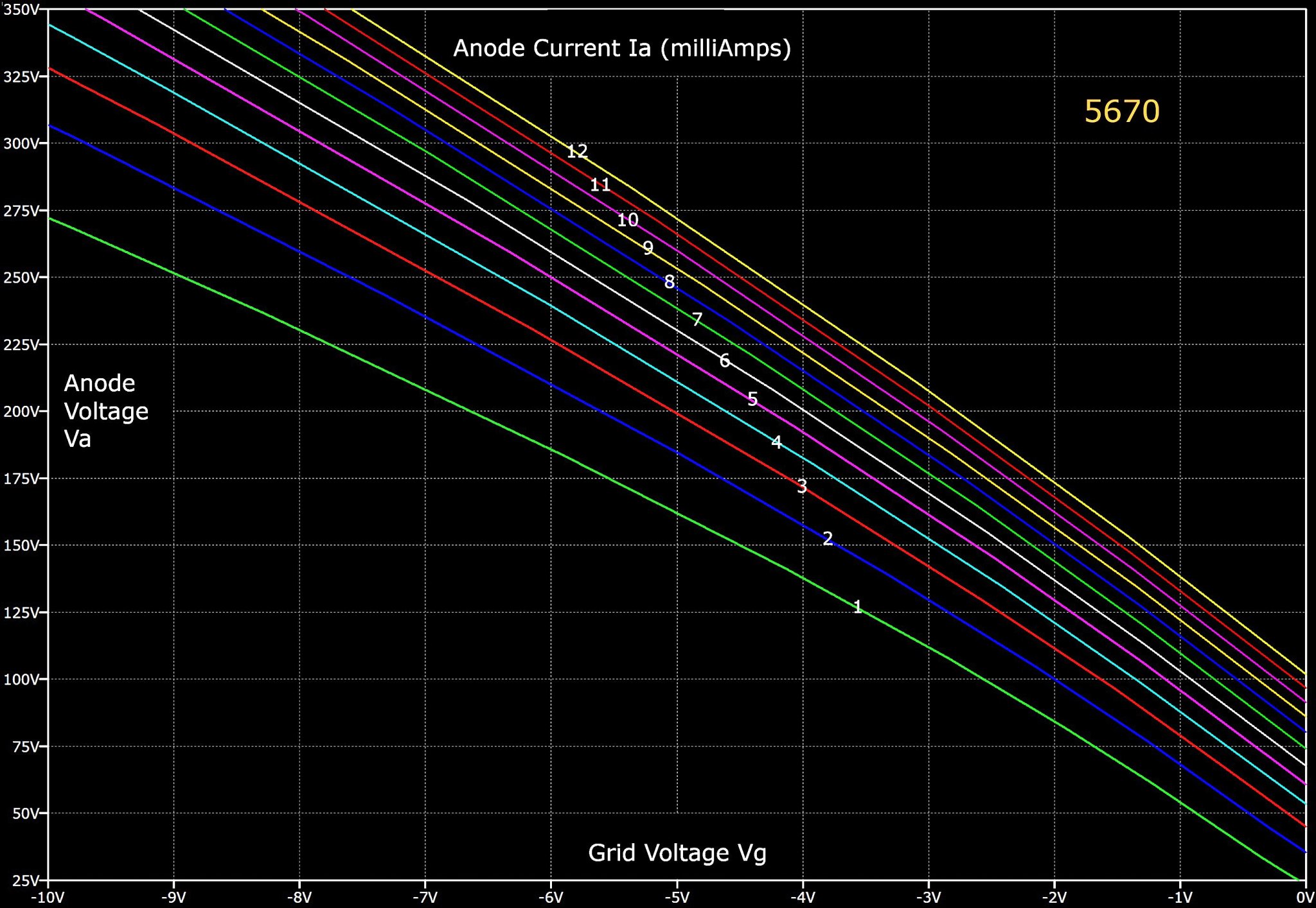

Your curves appear to be labelled backwards; the 1mA curve should be the 12mA curve. When the labelling is fixed we see the same conclusion: linearity increases at higher constant currents, and smaller bias voltages.
I will check this and replot it. Thanks. I'm just trying to prove or otherwise (maybe to myself) that constant current (constant current at DC bias and when there is input signal) is unconditionally the most linear configuration for a typical Triode. Please bear with me!Your curves appear to be labelled backwards; the 1mA curve should be the 12mA curve. When the labelling is fixed we see the same conclusion: linearity increases at higher constant currents, and smaller bias voltages.
Thank you @Merlinb I have corrected the graph of Va vs Vg with lines of constant Anode current Ia. The graph of Anode voltage versus Grid voltage for lines of constant current for the 5670 tube:

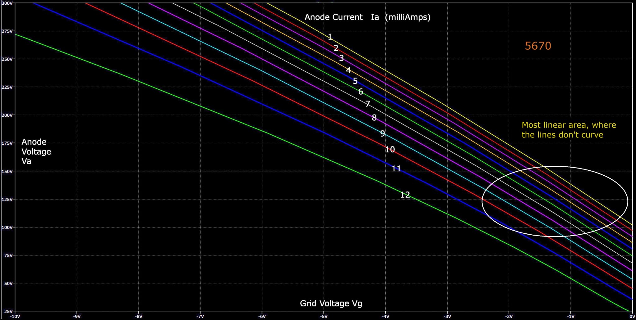

And here again the graph of Anode voltage versus Grid voltage for lines of constant current for the 5670 tube showing a typical most linear area:
