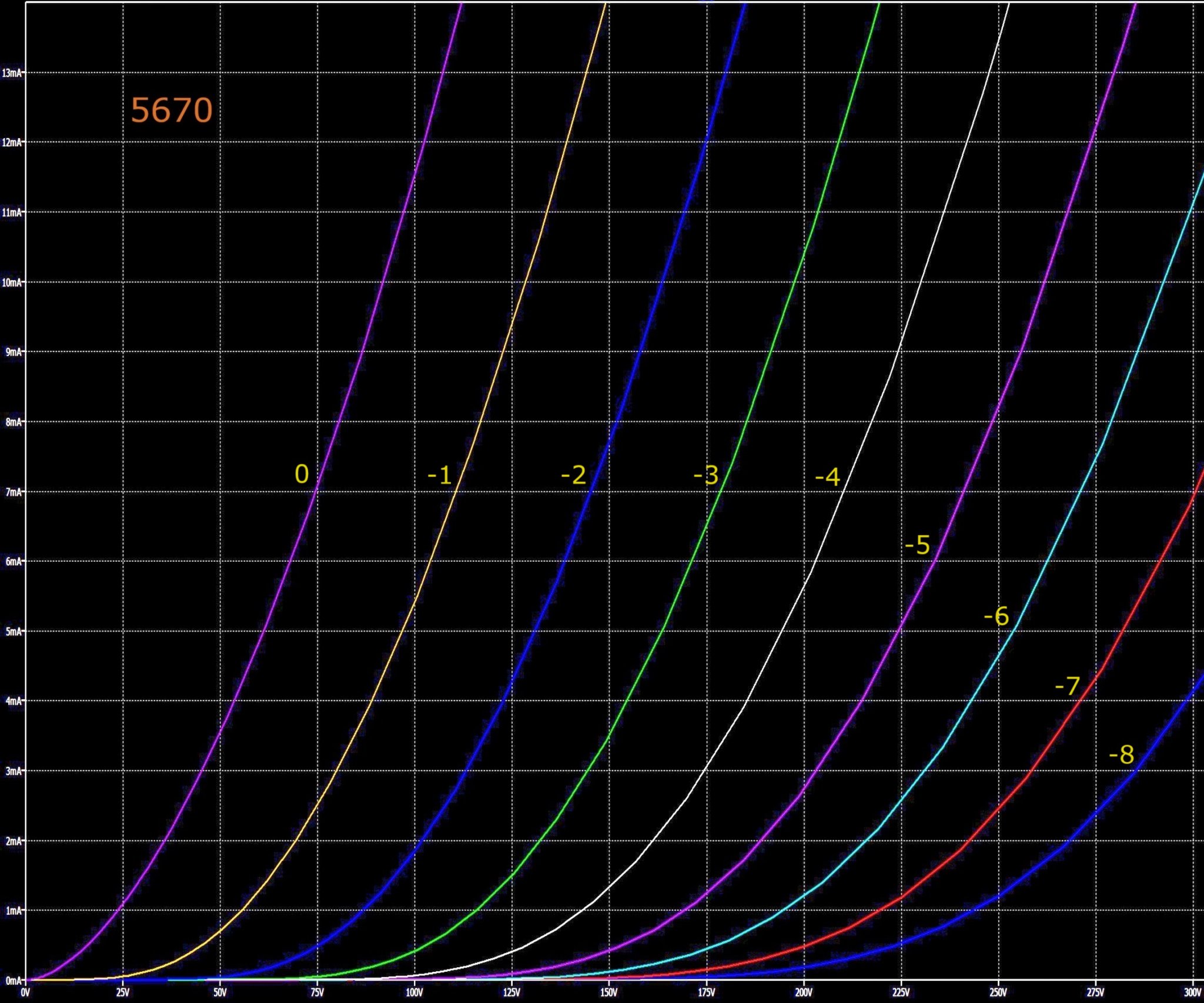

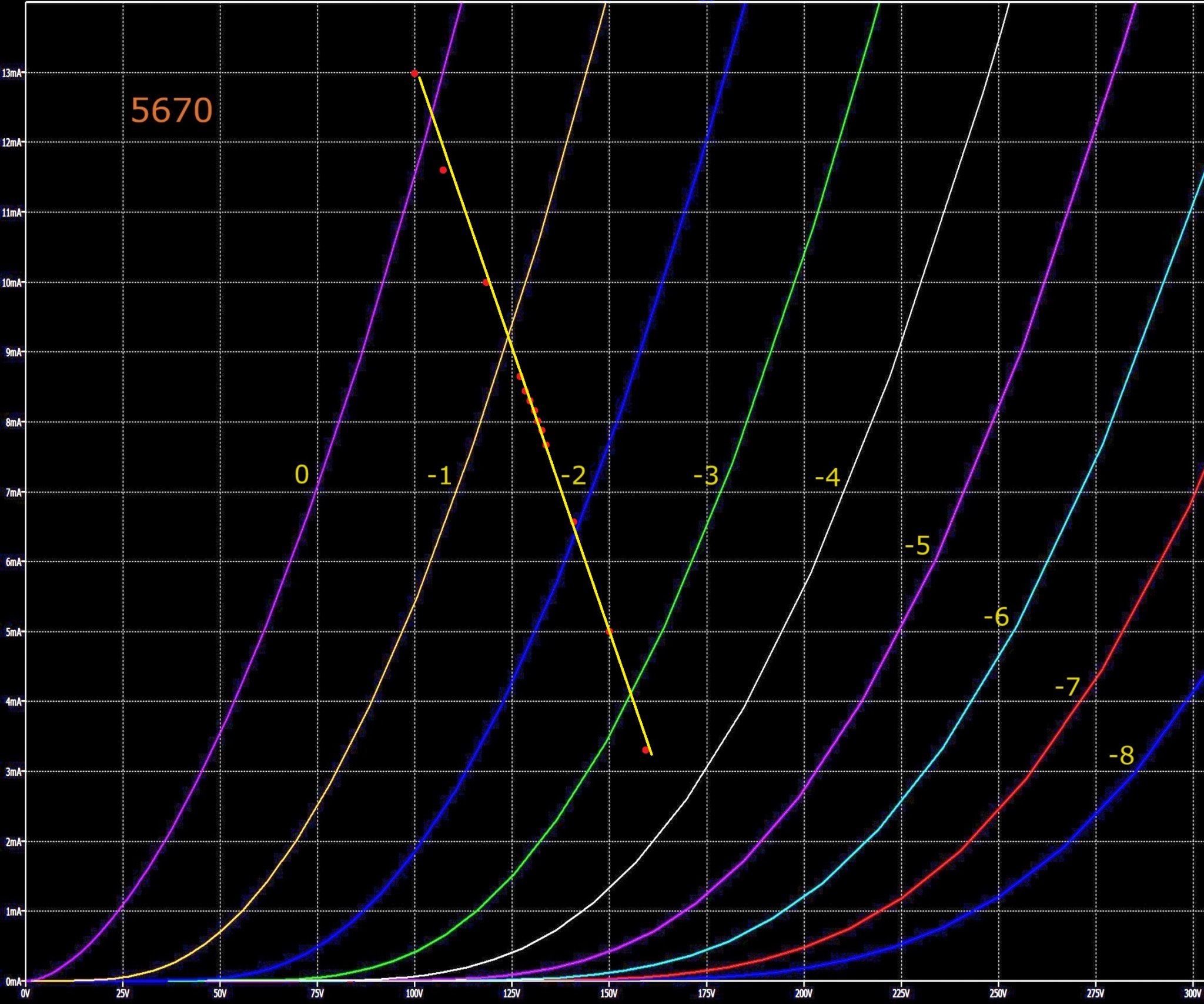

I was listening to your comments and I am rethinking my obsession with constant current.
The Triode Ip vs Vp characteristic curves are really difficult to understand (for me) but I got to thinking how to get the best possible linearity?
So here is what my existing circuit does:
But what else can we do? Here are some of my options as far as I see:

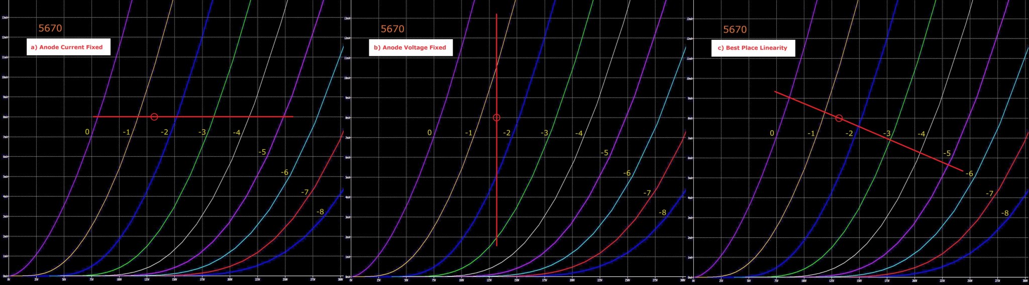

So that still lets me choose a "sweet spot" at DC bias and no signal but for those three options I can draw three graphs a) b) and c) as follows:
I'm saying that the circuit will be designed to keep the valve/tube at the same "sweet spot" whether its for a) b) or c). The sweet spot defined as a point where the Cathode current and Anode voltage are both high enough to stay away from non-linearity, keep enough current flowing to stay above noise and keep below the maximum power dissipation. For example if the valve has an absolute maximum Anode to Cathode power dissipation of say 1.35 Watts then I choose a sweet spot at 1 Watt.
Which one of a), b) or c) is best (or going to be most linear)? a), b), c) or something else please?

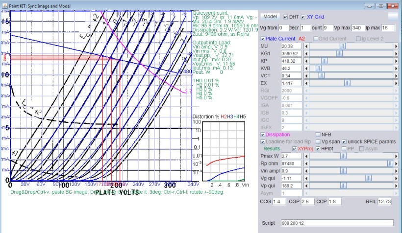

It not only makes Spice models, but you can also then overlay a plate dissipation curve and put a loadline and operating point onto it. You can then look at H2, H3, H4 curves for that operating point. Although this is just a mathematical analysis based on formulae and the model parameters you enter, it is a good starting point when looking at dynamics of how different non-linearities pan out, depending on where your operating point is and how steep your loadline is.
The real world will of course add its own real world complexity on top of this, so don't hang your hat on any one particular "truth".

That's very useful. In the real world of Triodes the square space of Ip vs Vp will be the same for a given tube type number. What changes is how Grid voltage curves map to that space.
Seems that mathematically it should be possible to calculate the most linear line the curves will allow.
Seems two things, how curved curves are and how uniform is the Grid voltage between curves.
Mathematics beyond me, something like finding the straight line of minimum gradient in two dimensions.
Then there is what happens if we want to go from Grid voltage signal to amount of power out.
Thanks for the advice.
Linearity in a single triode stage is quite straightforward. It improves as load impedance increases, and it improves as the bias is made hotter. The lowest distortion therefore occurs with a constant-current load at the highest current and smallest bias you can safely get away with.
Noise does not follow such simple rules, but that only matters in the input stage.
Yes so curve a) in my post #45. But curve c) looks better and it is close to constant current but not exactly. What do you mean by "highest current and smallest bias" ? I understand highest current as away from where the curves really curve but smallest bias?

Merlin is saying that linearity is highest when you have the flattest loadline, placed as high up and as far towards the left as possible, subject to your not running along the loadline into positive bias territory.
As an example, I've posted an operating point for the 3b7 valve with it biased with a quite high current relative to maximum plate dissipation, towards the left at -1v, as it is only ever going to see +/- 0.5v swing in its input and a relatively flat loadline based on the next stage's grid leak.
Note that both what is driving it at the input and what it is driving at its output are both constraints on "design".
It's just an exercise example. In the real world, you'll have to design to give yourself a margin for error and component tolerance, think about layout, power supplies....
kind regards
Marek
