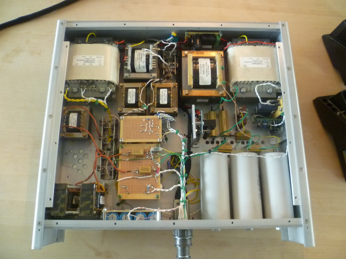

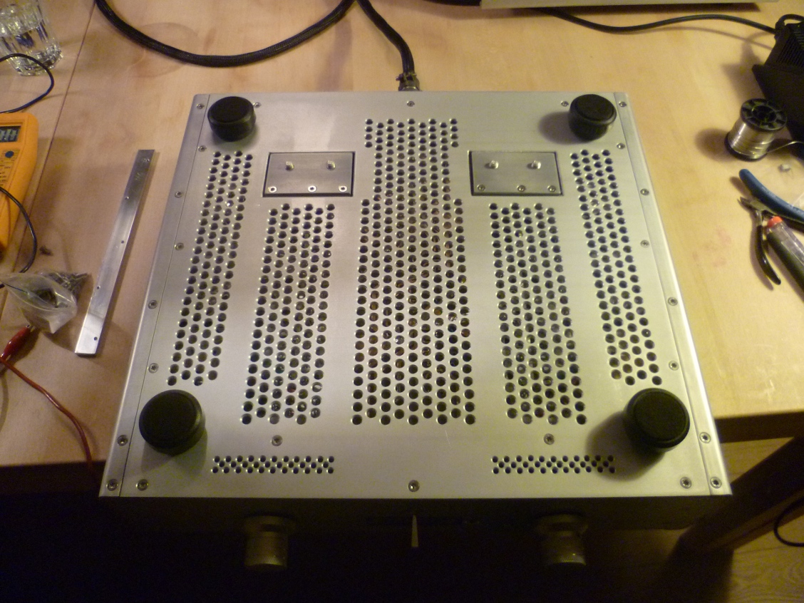

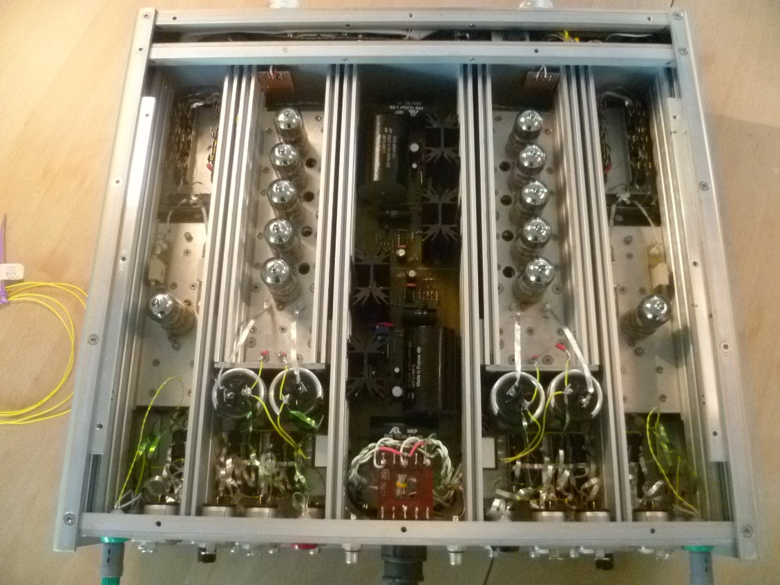

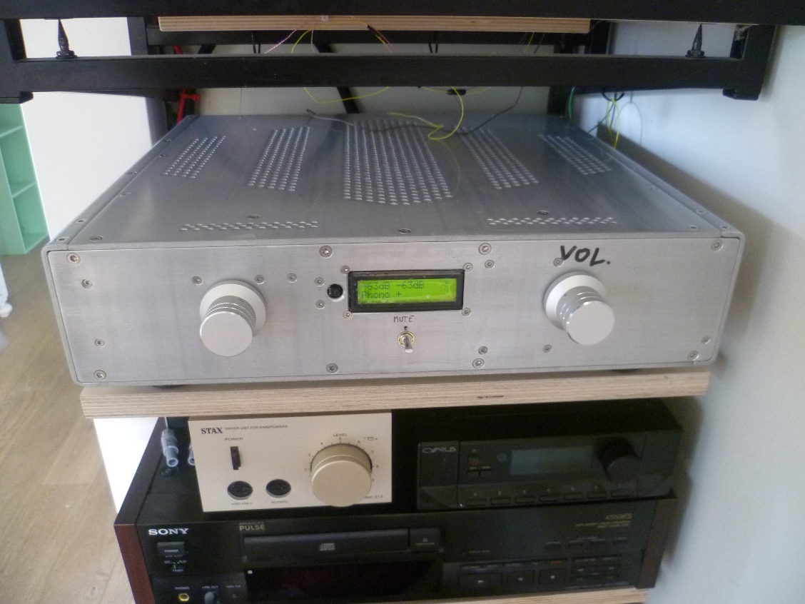

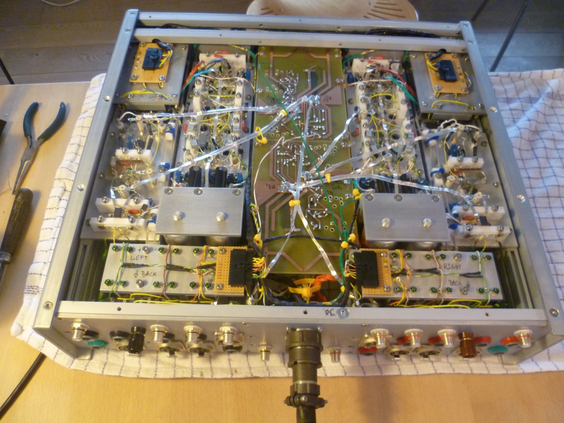

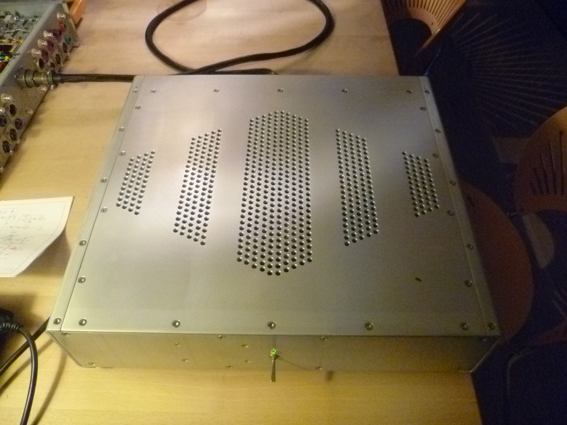

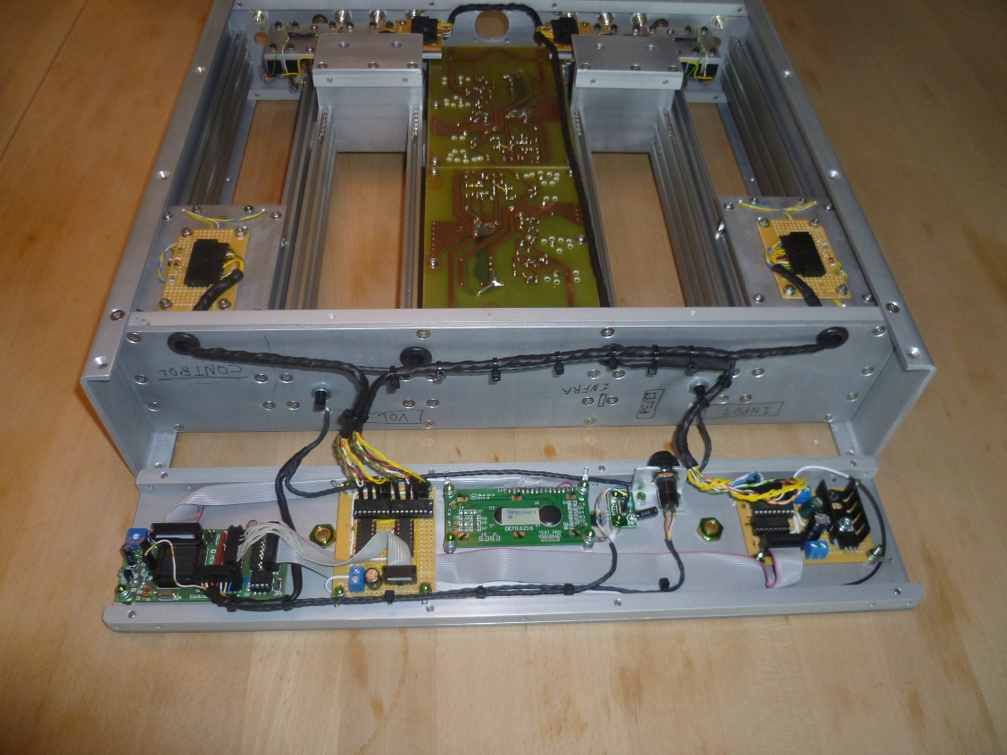

Remote controlled RTP
Hello folks
I would like to share my RTP-clone with You. I had a lot of inspiration from the thread (and Alex Meganns homepage, Thanks Alex!) and now its payback-time.
I have been building for more than 1½-year and one of the things that made the build take so long was that I made the cabinets myself in my garage with hobby tools - that's a one time only experience. The cabinets started out as a 1m x 2m x 4 mm raw aluminium sheet and admitted I had a little help cutting the sheet to smaller pieces and bend the side-sheets. I even learned to anodize aluminium in the process.
For the PS I had custom made (by a local firm) trafos and chokes. The areas where my PS differ from the original is (my guess) that I use a choke filter for the bias supply and I have a 9V logic supply.
The main area where my Preamp differs from the original is that it is remote controlled – haven't bought the remote yet thou. Input selection (including ground) is done with relays close to the back. The volume control is a 64-stepped relay attenuator – and to get the fixed 50k that the phono stage demands I have chosen the expensive route and ordered special value tx2575 for line resistors and to save a bit tx2352 for the ground/shunt resistors.
Firing it up I had a little problem with noise from the super reg in the channel where the elevation of the heater supply was connected and so I chose to put the elevation in the PS before the super reg and put bigger caps across the supply-legs on the AD797 up-amp in the reg and the problem was gone.
Now I only have to order a pair front plates when I have the funds🙂

Hi Roland and Jushua_G thank s for the kind Words.
Actually al the logic circuits is from Dantimax, but since the rest of the pre is hard-wired I have tossed the PCB's carrying the signal and hard-wired those – all the controlling logic circuits is placed at the front of my Pre.
Only problem is that there only is 6 channels available hens 3 input lines where polarity switch is possible – Luckily I only listen to phono, digital and tuner but an extra line input would bee nice.
And I would have loved to have latching relays but couldn’t find a diy kit that could handle that – amb.org came close but didn't have the right front controls.
@Jushua_G
I couldn’t find a suitable cabinet and I therefore made it myself from 4 mm alu-sheet, 10x10mm alu-rods and stainless steel torx head screws. All holes and treads is hand made. A lot of work that I wouldn’t recommend unless you have access to professional tools
And maybe I should mention that the pre is very transparent and coherent – I'm not going to look for anything else.
Stig

Hello folks
